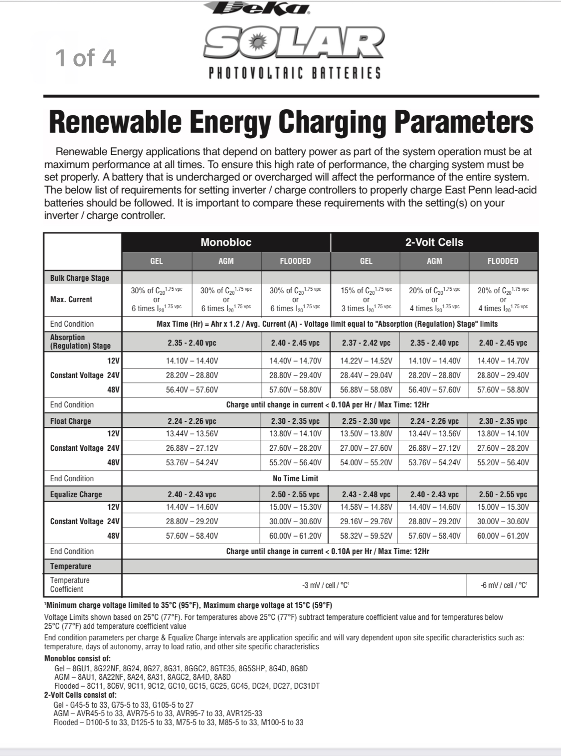

I just bought the X2 SLI 31AGM DPM. ON the top it says it requires a float charge of between 13.5 & 13.8. Anyone know what our alternators kick out?

They are temperature compensating alternators. On my truck I measured cold idle voltage at 13.85V and warm idle voltage at 13.4V but YMMV.
I think it is the bulk and absorption voltage you want, not necessarily the float. But I could be wrong.

for bulk charge >14V is ok but you need to float at a lower voltage or you’ll slowly cook the battery. Unlike a wet cell, you can’t add more water to a sealed AGM. (While they are sealed they can still vent if overcharged).

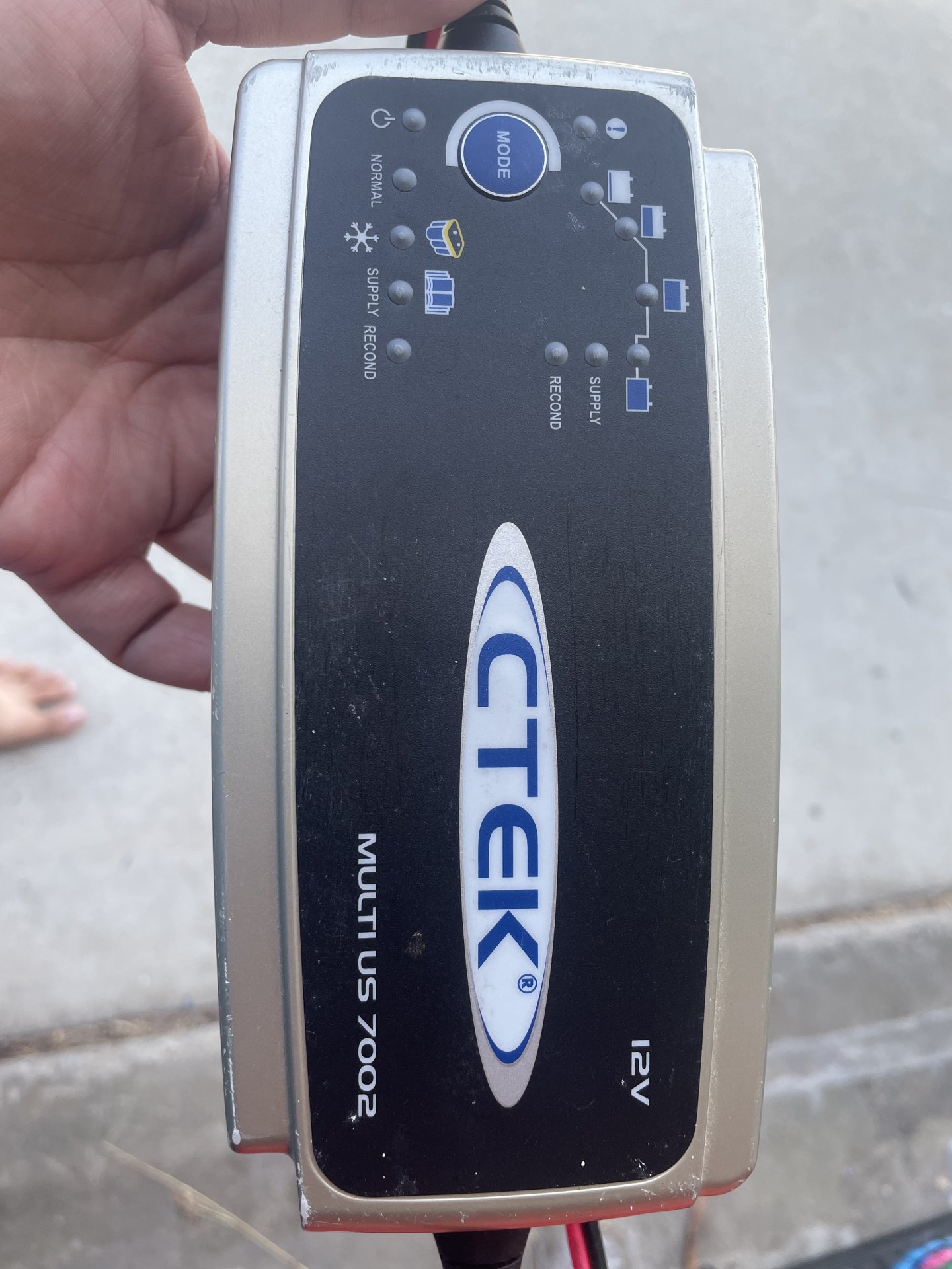

There is so much info that needs to be known before a concrete answer could be given. House battery? connections clean and tight, which CTEK charger and which battery isolator are you using etc.
Thank you for your help! See attached pictures (I didn’t want to say the wrong thing). I really don’t want to buy a new $300-400 battery every 3 years so any advice is greatly appreciated.
Just buy a cheap $100 wet cell. Our batteries are mounted upwards so the only advantages to AGM for us is that you get ~2x the number of deep cycles and you don't have to occasionally add water. The downsides are you need the diode hack to get the charging profile correct, if you overcharge and they vent you can't just add water to get them back to a usable state, and given they cost 2x as much so it's roughly the same cost to just replace your wet cell every 3 or 4 years than to try and maintain an AGM to get 6-8 years out of it.
Judging from that 12/18 sticker on your battery, you're within the 36 month free replacement period for that particular battery.
