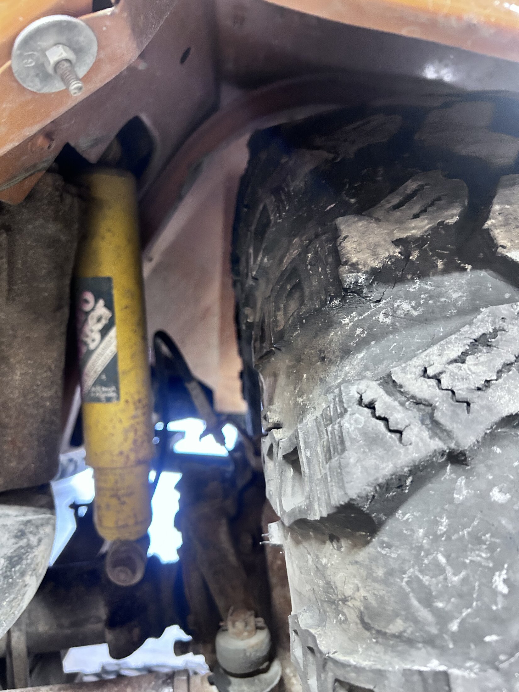

So I got them all mounted up for a test fit. The procedure is not to bad once you get the hang of it. They seem to hold air well. I still need to replace the hardware on the rims and put the balance beads in, but this is where I was trying to get.
I mocked up the wheel spacers and the wheel studs are way too short. This was expected, but I wanted to mock them up so I knew how long they should be for ordering new ones. Then I put the old tires under opposite wheels and “flexed” it out. Not surprisingly, the tires rub. Here’s the front first-
the contact point has moved from the inner fender behind the support to the outer lip. This is to be expected. Check out the clearance on the inside now.
So the plan here is to remove the fender when these tires come out. I have an old set of fenders that have the classic rot above the supports. I’m hoping to use these to give some support to the front clip and cut them back enough to allow the tire to move feeely through the travel. Hopefully it works…
Here’s the rear and no I’m not even to the bump stop yet.
As you can see the contact patch is the rear lip. It’s more than just a kiss. The lug is making solid contact with the body. This is not gonna fly. My hope of using a body lift to clear the tire is looking like a waste of time. A friend recommended a shackle lift, but I’m already running longer shackle in the rear. Not sure any longer would be advisable. This leaves cutting the fender more…
Forgive my crude photoshop mock up. If I carried the fender shape back I think it might work. I’ve already enlarged the opening, which eases the pain of cutting.
If I want to use these tire ( and I do), then something has got to give. Body lift doesn’t seem to be the answer. SOA came to mind, but I don’t want that much lift. The cost of linking is currently prohibitive. So body mods are more than likely the only real was to get these tires to fit.

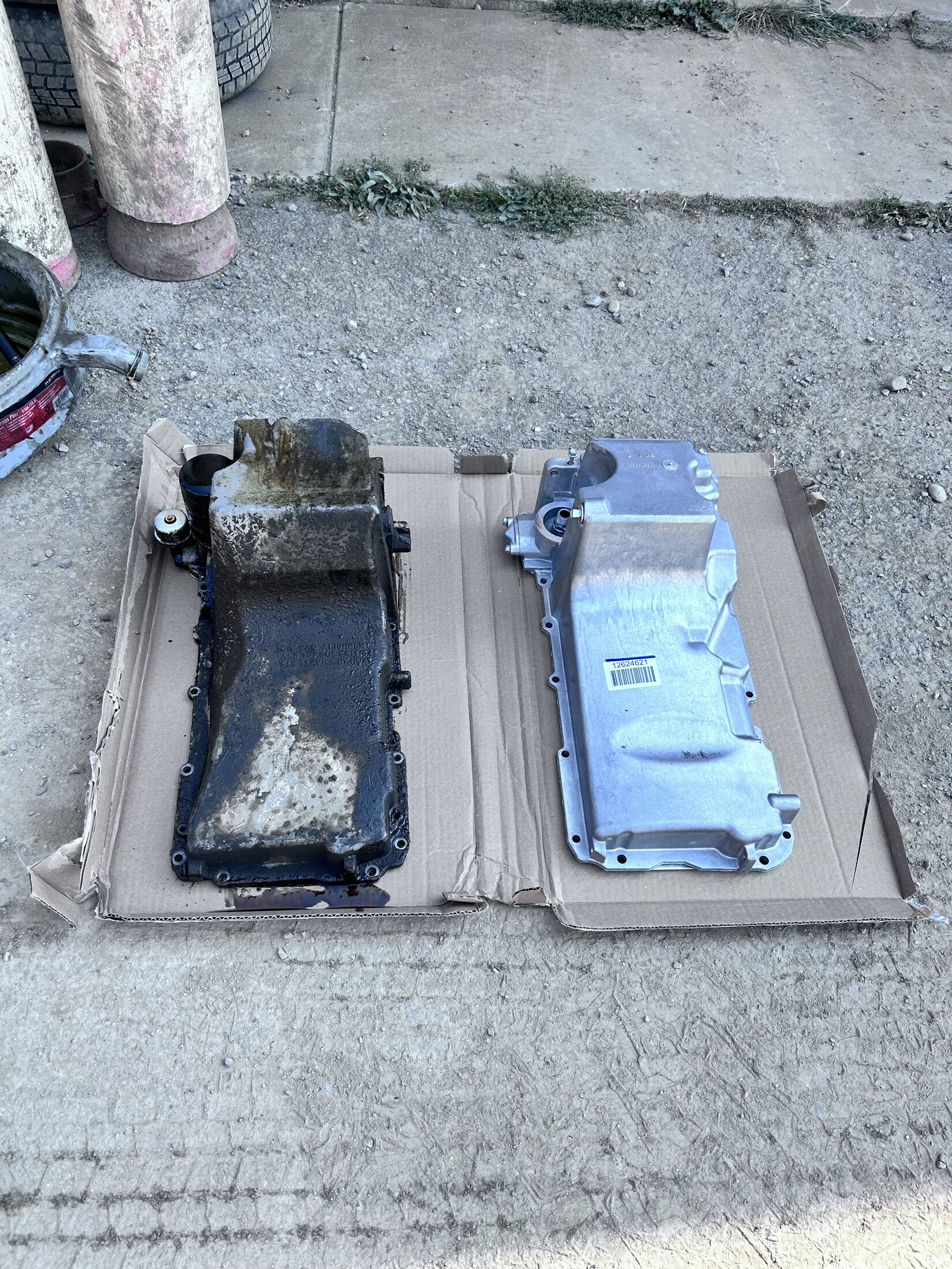

I’ve had a varying level of leaking oil from the what I hope is the oil pan on my LS. Initially I was just going to reseal the stock oil pan- it’s been fine, other than the leak. By fine, I mean just shy of ideal. I do get slight contact to the oil level sensor (unused) with the driveshaft. Mostly, it mashes the plastic- no real issue.
Since I was pulling the pan anyway, I decided to upgrade to the H3 (LH5) pan and pickup. It deletes the offending sensor and has a slightly lower profile. On the downside, this means it has a lower oil capacity.

Made it home tonight and no drips so far. Oil pressure is good while driving, but idle seems a bit lower than usual. I generally idle at, or just hair below, the middle line, but now the pressure seems lower still. While driving the pressure seem normal.
I used Quaker state synthetic, for the first time. I usually tend toward the Mobile 1. Might be a touch lighter? No ticking from the valve train, so I guess I got that going for me…

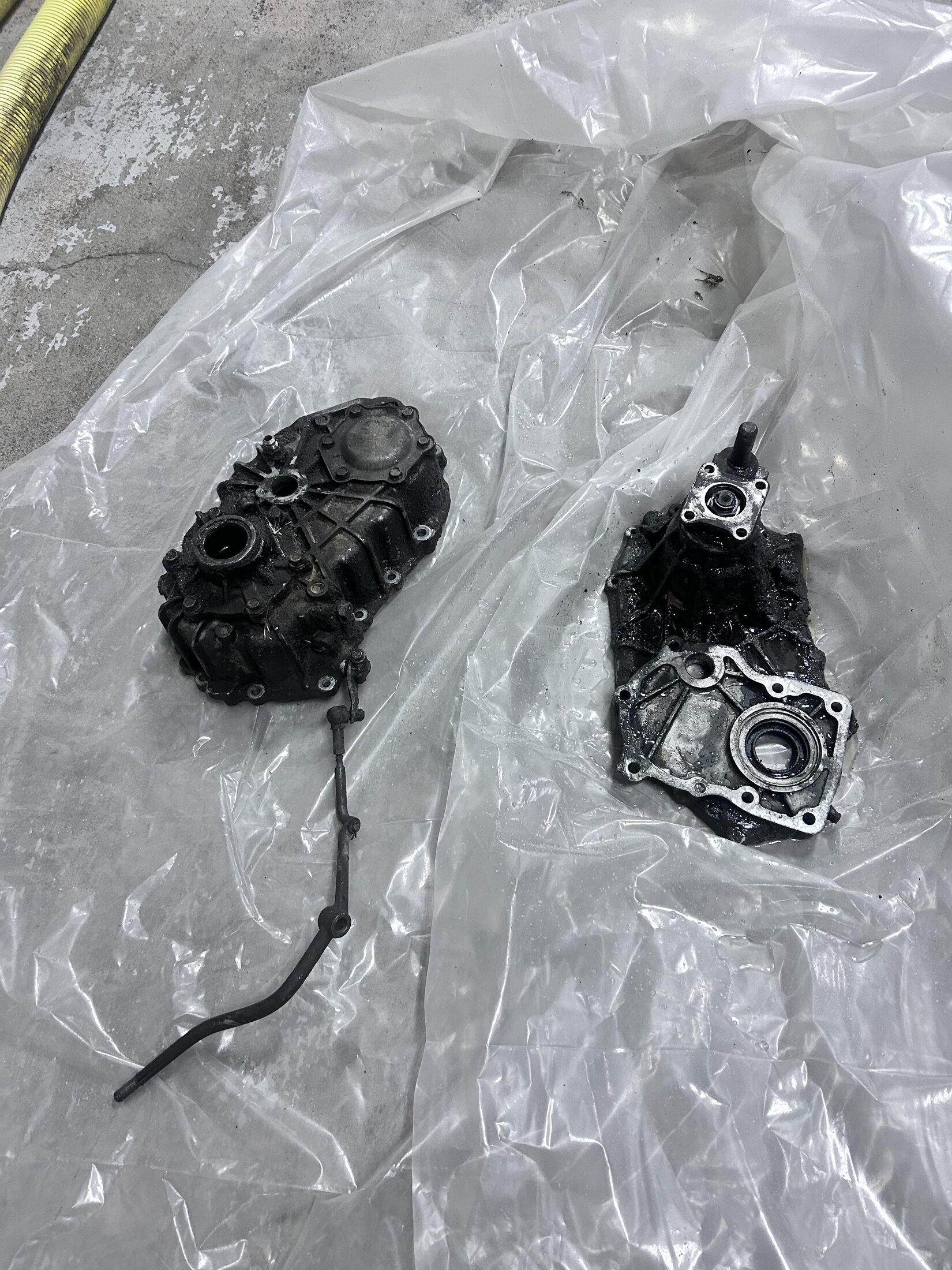

In other cruiser related news I came across an ad on marketplace for a splitcase for $100. I couldn’t pass it up and even paid an extra $50 for delivery to Pocatello on our way home from Salt Lake City.
The case is a pile of parts that need identification right now. My plan is to loosely assemble it for safe keeping. The Ottram video pretty well lays out the process. First thing is to degrease the case- it has about an inch of crud build up on the frontside and generous amount on the backside. Think cement. The oven cleaner is working, but it’s a process…
By all appearances, it’s an early case: 34mm, manual shift and lacking the oiler pocket for the h55. This isn’t a big issue for me, I’m guessing this will end up behind a 4l60e/NV4500. From what I’ve read the 38mm case is more desirable, but these hold up just fine as well.
We’ll see if the gamble pays off. It alway interesting when you buy something in this condition. Let me know if there’s anything I should look for in the cleaning and assembly (loose).

  • And lastly- I think I have the split case as clean as it will get for now. A can and half of HD oven cleaner, pressure washer and scraping implements has it mostly clean. At least I can touch it without my hand coming away dripping with oil. Now I just need to “assemble” it to find out what parts are missing.
I’m getting closer to my Moab trip and I don’t think the swampers are gonna make it on the trip. Every time I think I have a plan to make them fit, I shy away from it. They will wait until I figure out how to make them fit properly. We have couple rigs(brand new Bronco and a stock-ish CJ) for this trip that’ll likely keep us off any hairy trails anyway.
Splitcase is assembled- no pics, but it looks like any other. It’s pretty straightforward. Of course, I didn’t assemble it for use, but it shouldn’t be to much harder when I put it in service.
It’s always a gamble when you put something together that you bought as a pile of parts and pieces. Is it all there? Is it even usable? However, given the price, it’s shockingly complete. The major missing piece is the idler shaft retaining "clip". Worst case scenario I could just make a new one out of scrap.
I know this isn’t for anyone else, but it will give me a point of reference I when I try and use it in the future and need to know what it needs:

Anything else should come in a rebuild kit. No visible cracks or damage to the case. The gears all looked to be in good shape- no chips or excessive wear patterns. Now to find a place to put this thing…

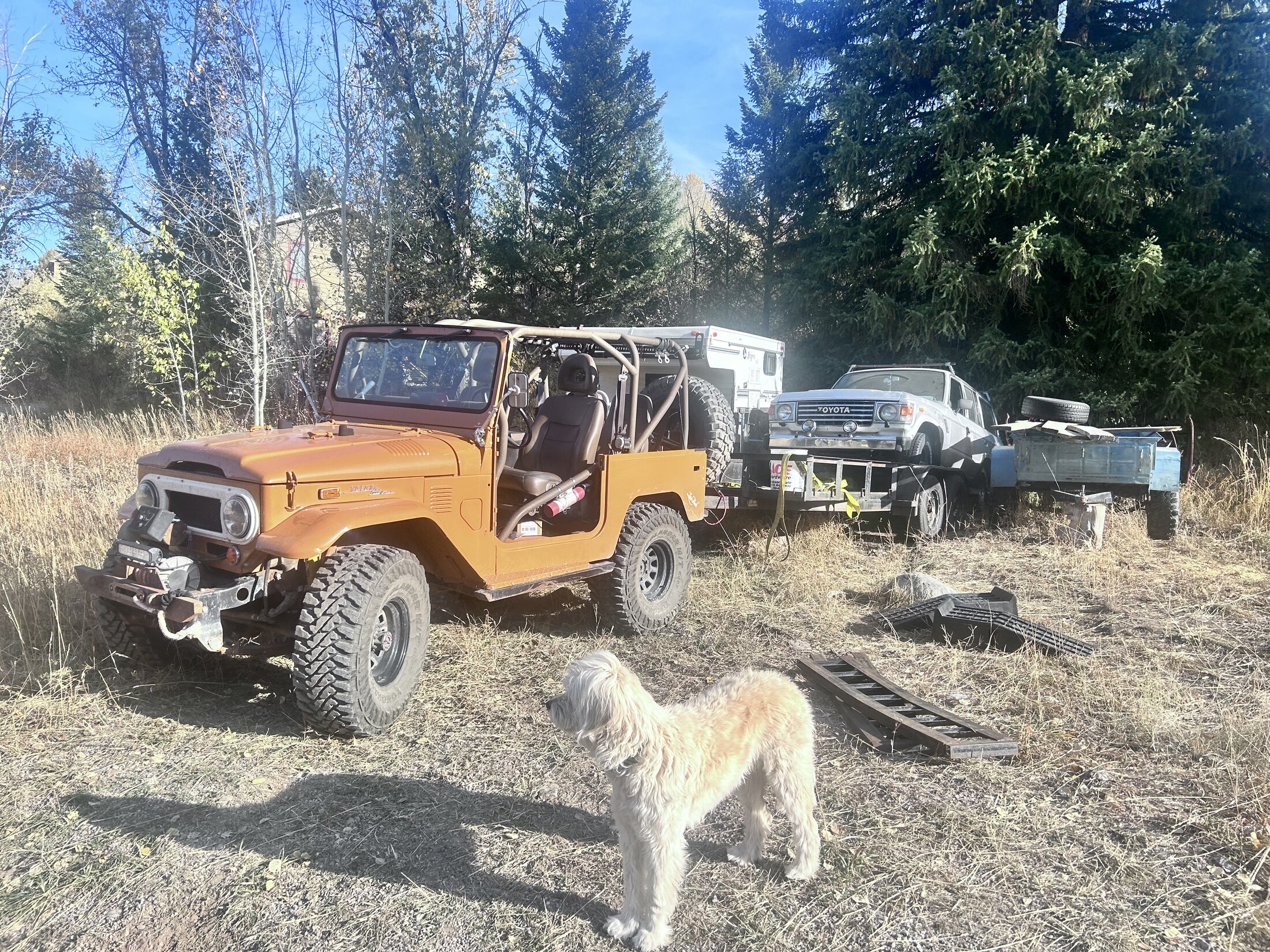

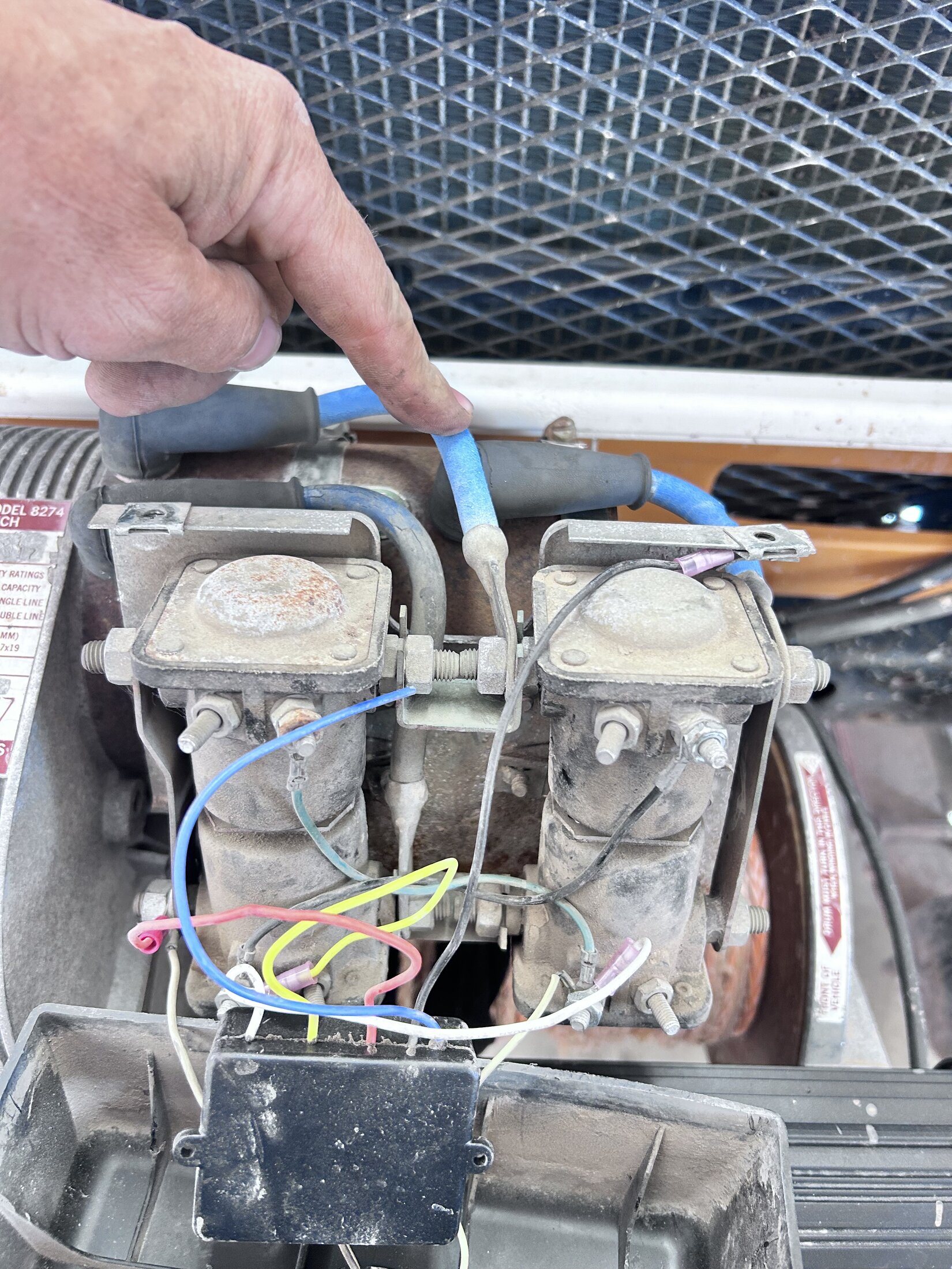

I took the trailer and winch out to get it. Winch suffers from neglect.
So the wiring on the winch needs help, but not today. The jumper cables and jump box are missing from the pickup. s***e!!
I used a ratchet strap to help the winch on the load and eventually I won.
It’s not exactly a cherry survivor, but it’s not as bad as some. It has rust and dents. If you squint it’s not bad. It was well used. There was a PO, he had foam. He also was able fashion a tailgate repair. I’m not pointing a finger at this one, it’s functional.
But it turns over. Slowly. That was extent of my investigation so far. Getting it running (or not) is the next step. I have a plan for both eventualities:
A) If it runs well enough to drive- sell it. I don’t need another project distraction or yet another rabbit hole.
B) If it does NOT run, strip the axles, springs, Tcase, transmission and steering for a future project. (More on this at another time). Sell the rest. I’d hate to scrap it, but honestly my wife will only tolerate a derelict vehicle for so long. And I’m more found of her than it.
So for now it’s tucked away, but I need that trailer in a little over a week to go to Moab…

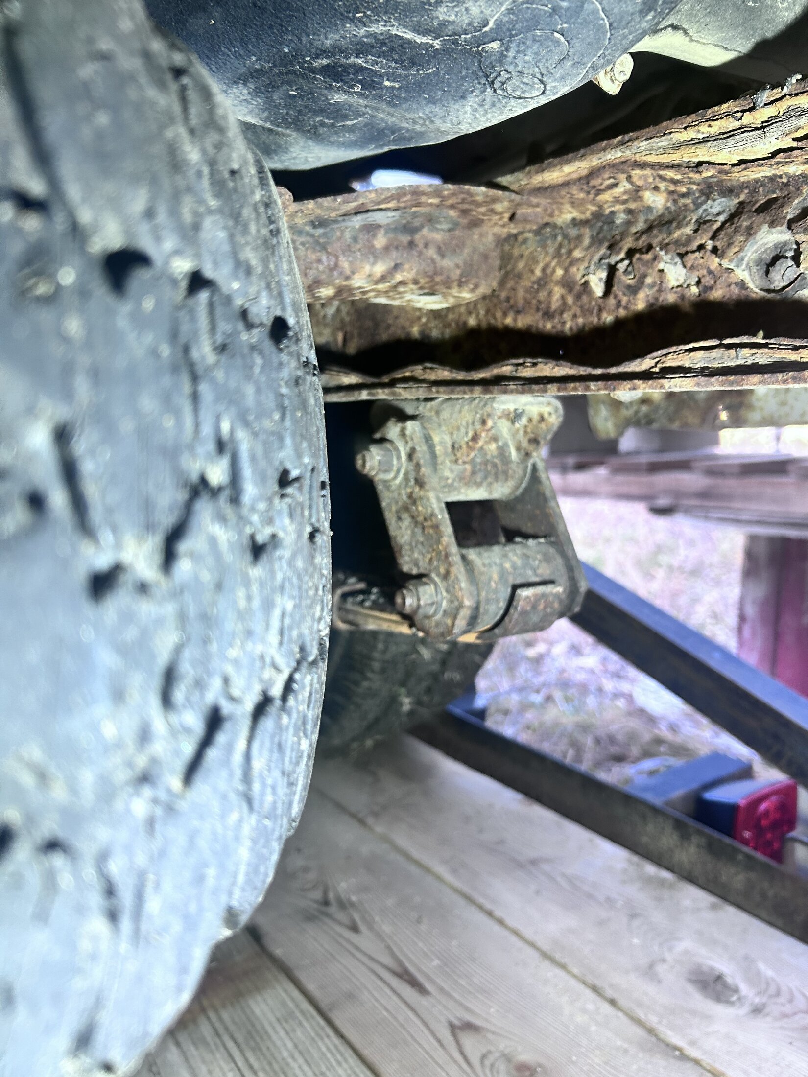

I got off the trailer today.

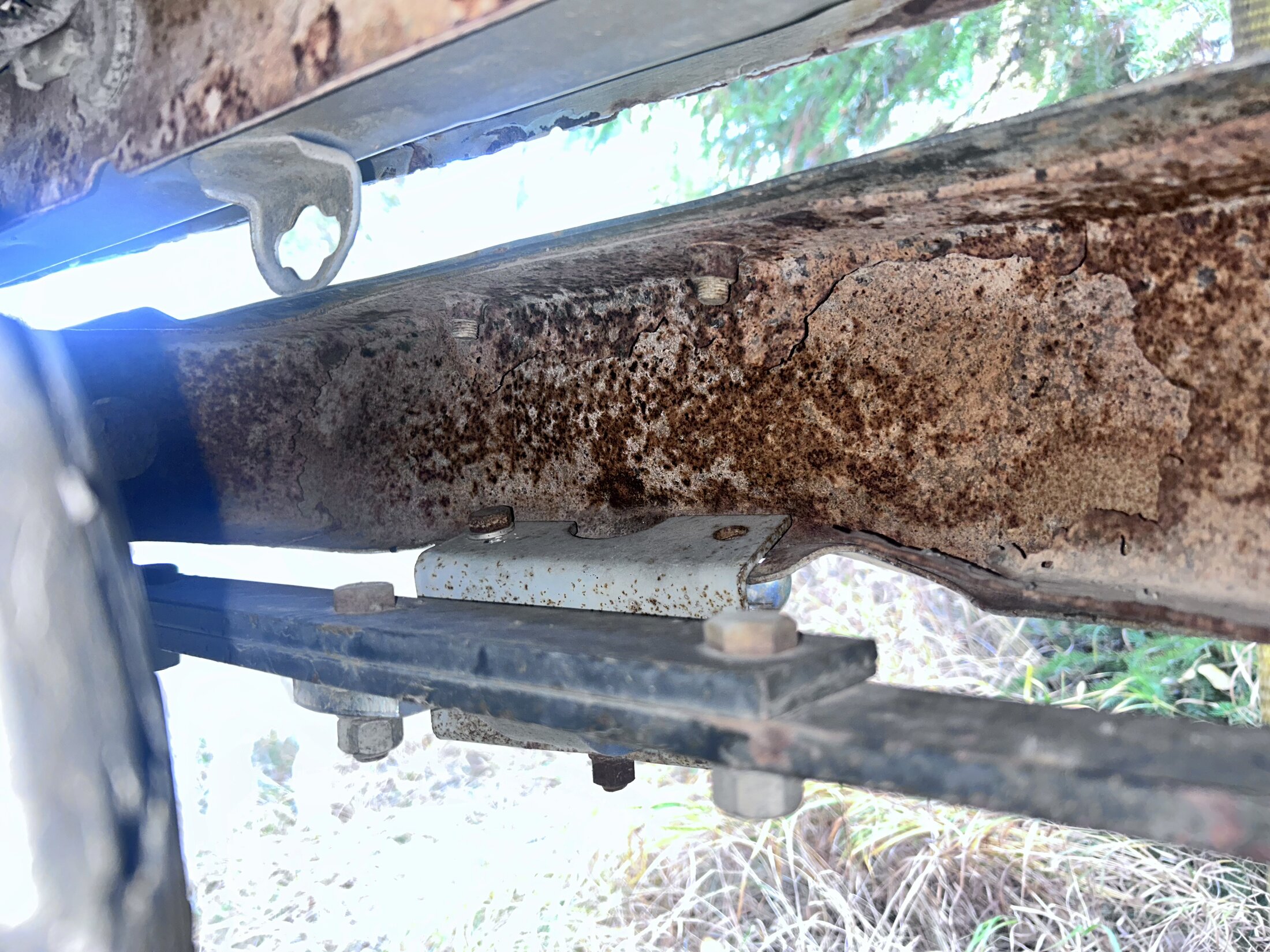

I got under it and the frame is toast.
The mid section doesn’t look any better. I thought maybe the leaking oil would have preserved the frame, but no.
I poured gas down the carb, it pours out the bottom onto the manifold. I tried to get to start just for giggles. Nothing.
This thing is officially a parts rig. I’ve got dibs on the axles, springs, transmission, transfer case, driveshafts and all the steering components. Not sure what that leaves, but if anyone has a desire for the rest I’ll put an ad up in the classifieds when I get around to stripping it.
