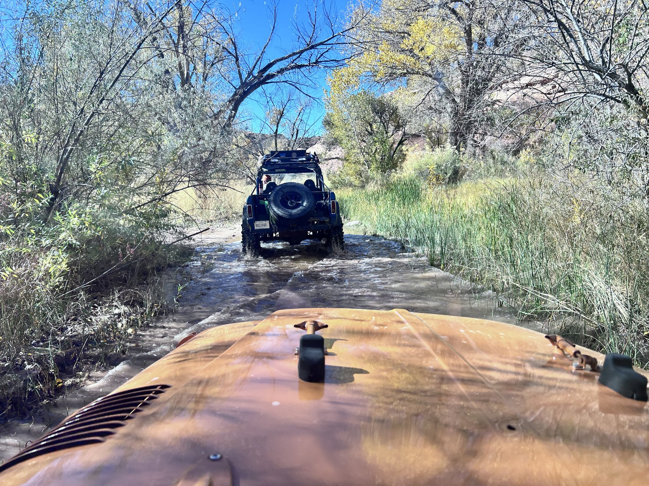

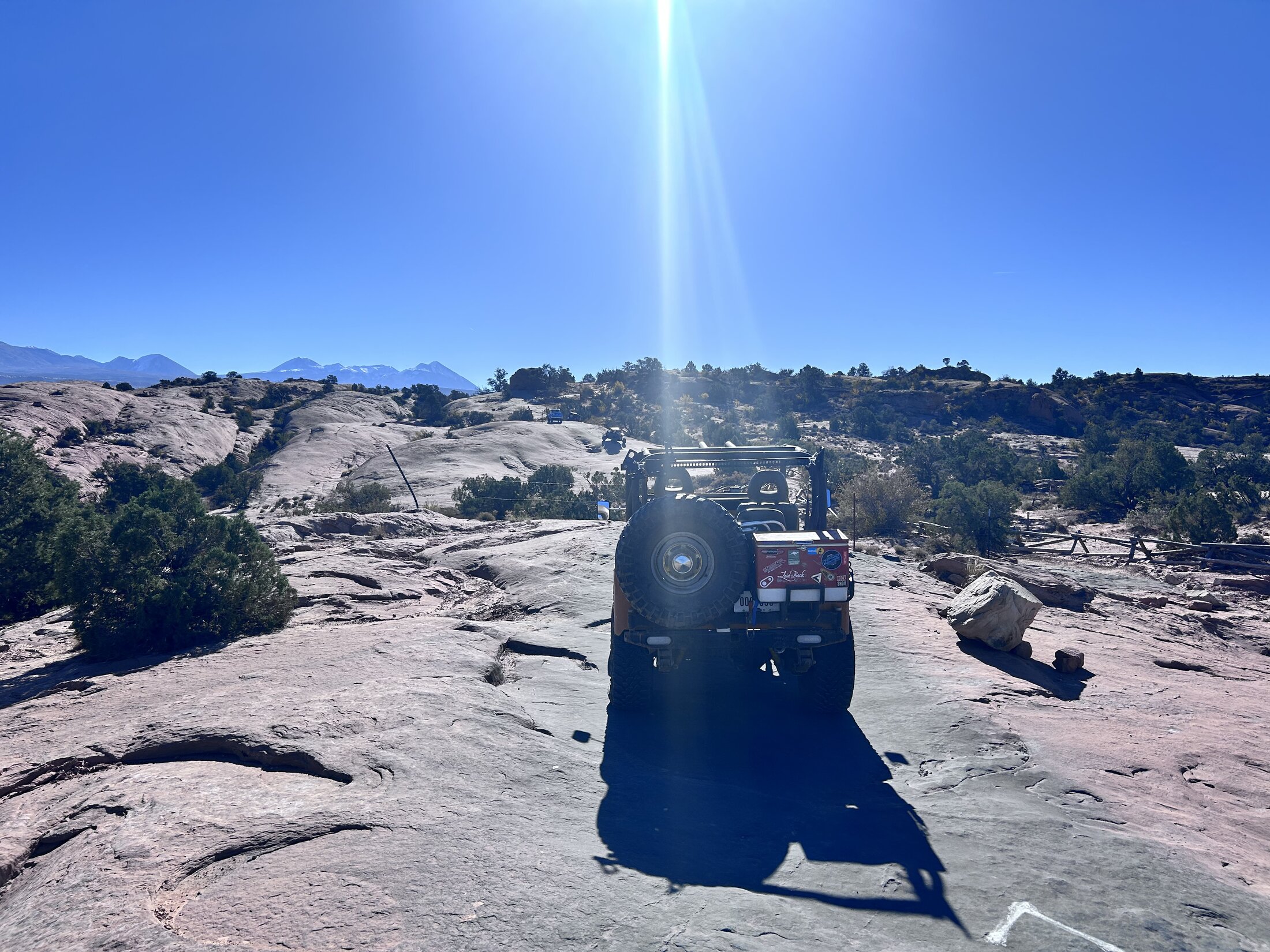

Last big trail ride was Kane Creek. For the most part it’s a scenic trail, but it has one good pucker section. At least when you do it backwards. I don’t know why we keep doing these trails backwards, but I’m honestly glad we did on Steelbender- I really don’t want to do that drop.
Like I said, super scenic trail
You drop into this canyon and its gorgeous vistas in every direction.
(I’m a terrible photographer, but once in a while I find a nut.)

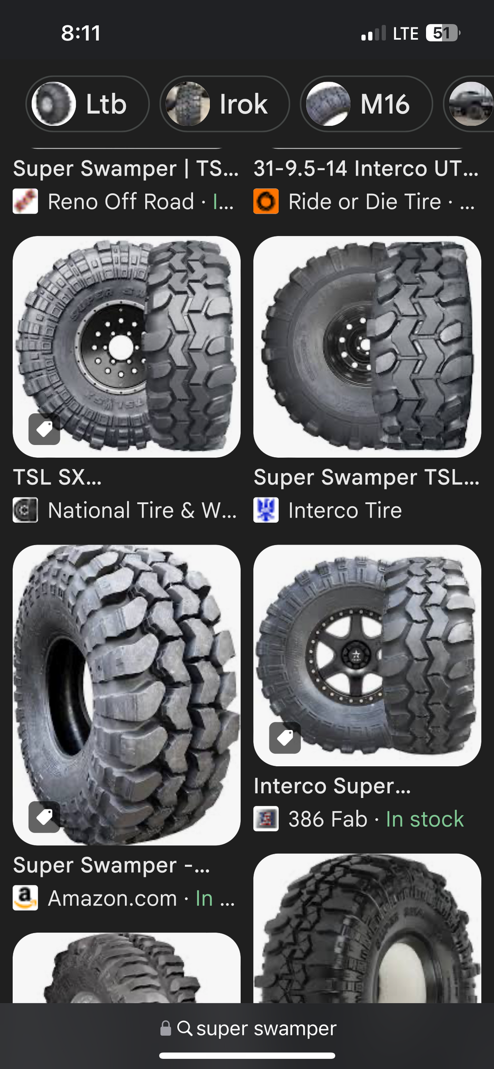

It’s hard to beat swampers. Proven old school traction.

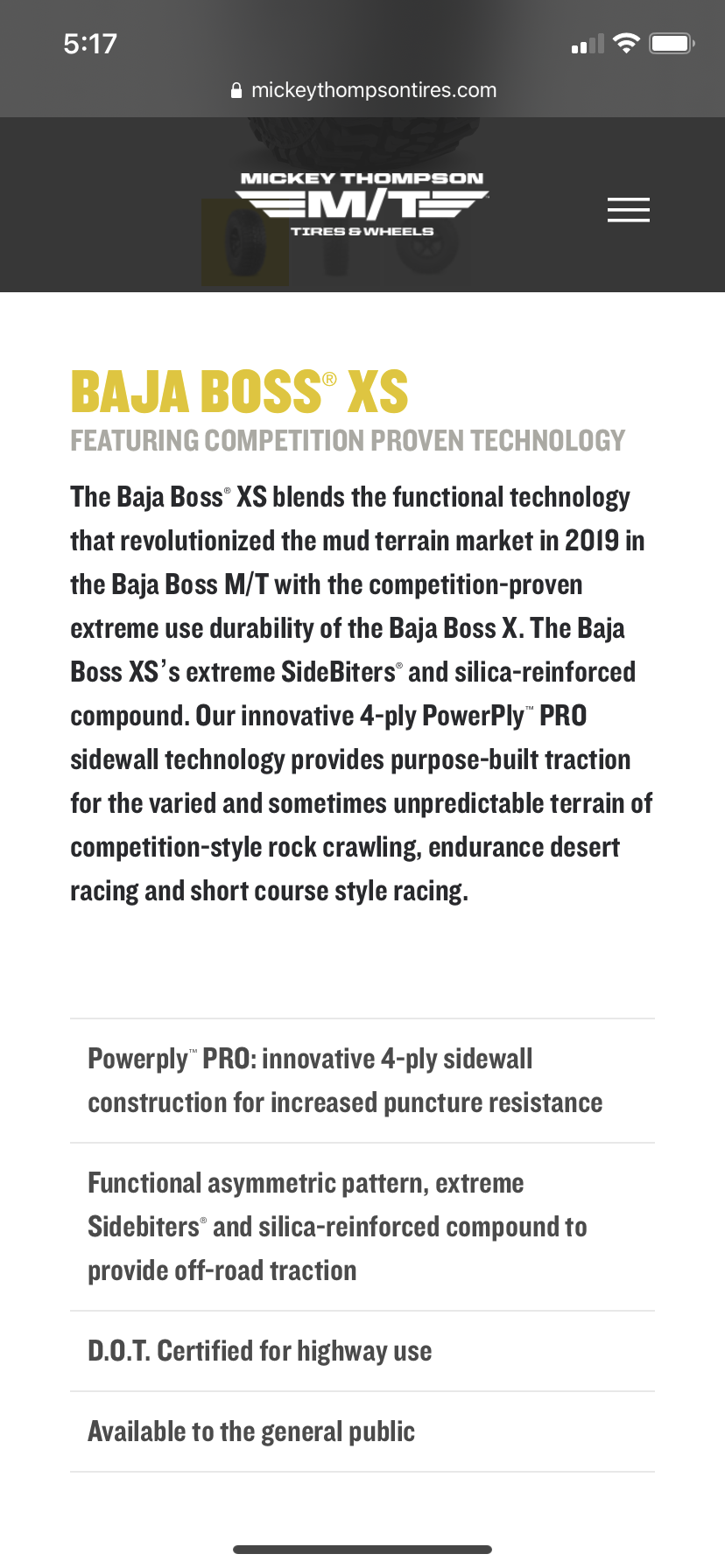

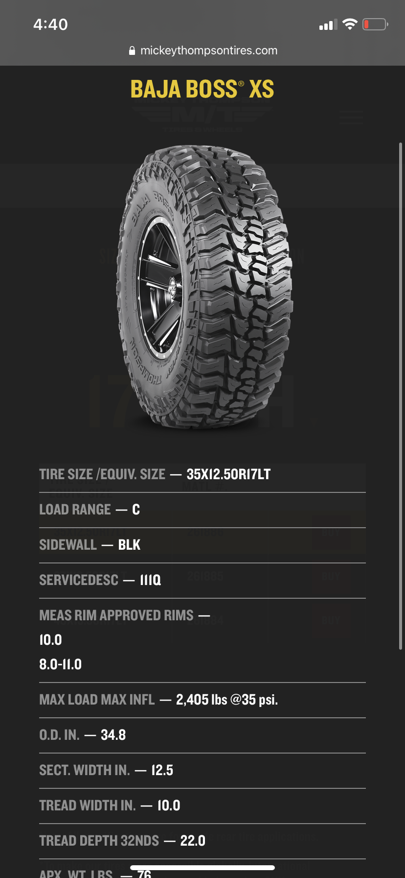

Those Above mickeys are competition blended compound. Not trying to sell you on them, but don’t rule them out. Readily available, good street manners.

I hadn’t noticed they were comp compound. That makes them more interesting. The other hard truth of life is that I’ll be buying used. I can’t justify the cost of a new set of tires that will only be used on wheeling trips twice a year.

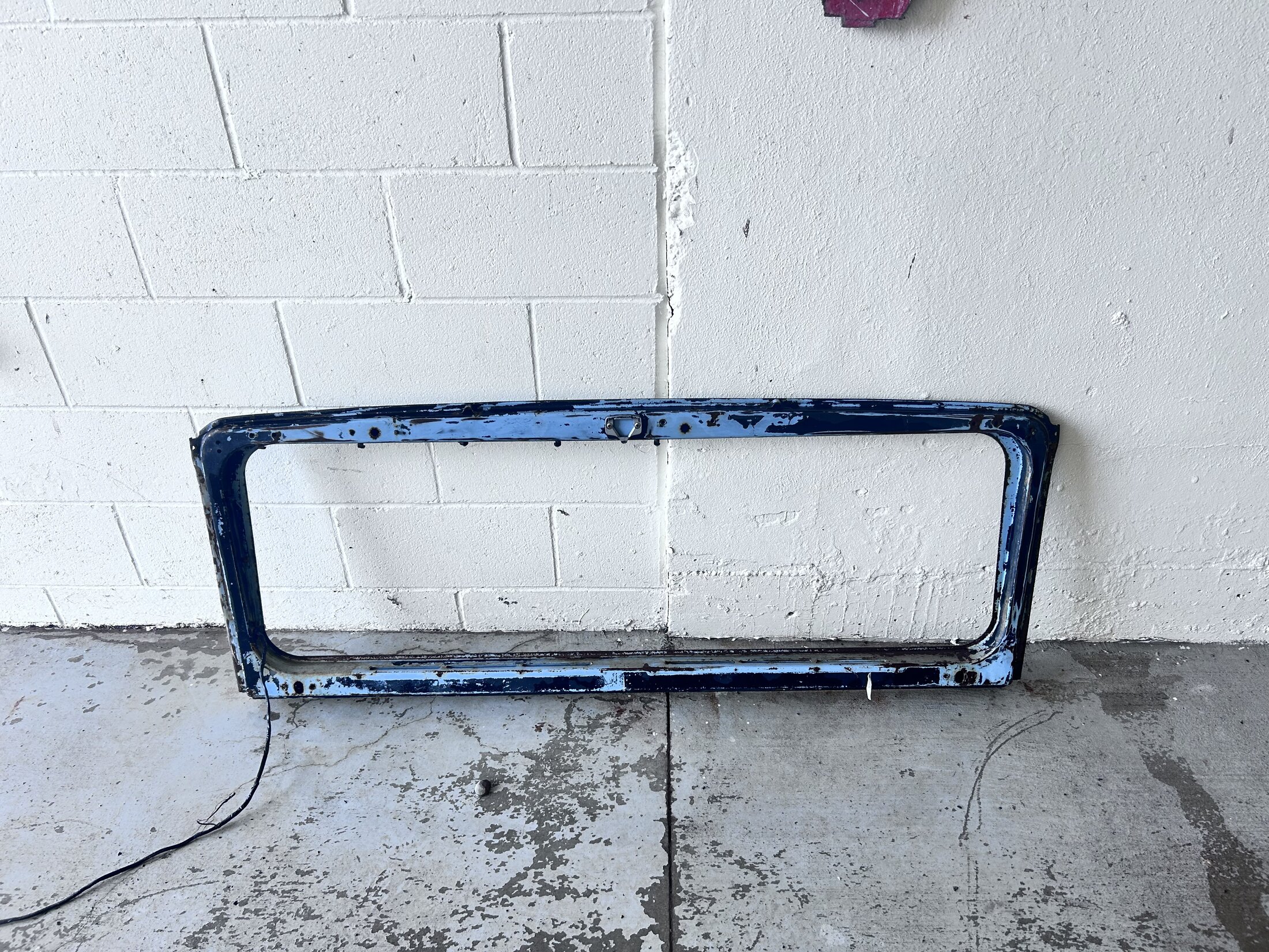

So last year I tweaked the windshield frame beyond my metal skills. I got it back to a reasonable shape, but it’s not straight. Real problem is I see the wrinkle when I drive it. I can readily ignore the passenger side, but this is directly in the field of view when driving. A month or so ago, I picked up a replacement from @R.K. for a very reasonable price. It’s not perfect, but neither is my rig.
It came with some extras: half the wiring for the wipers, mirror bracket, the clips to hold the wire in place and half of the passenger side hinge. As expected, it’s got a couple broken bolts to get out. One is the dreaded hinge screw. I tried the impact screwdriver, nope. The Map torch, nope. Time for the mig, nope. The nut I welded on just popped off, twice. After grinding it back down, I gave the screwdriver one more shot. I was pleasantly surprised the extra heat had broken the bolt free.
Unfortunately, the other broken bolts resisted the welding, they had broken off too deep to get them cleaned up enough to weld. Shame, this is so much faster than moving up through drill bit sizes and retapping the hole. So that took some time, but I got them both cleaned up and functional. Since I had the taps out, I chased all the other captured nuts.

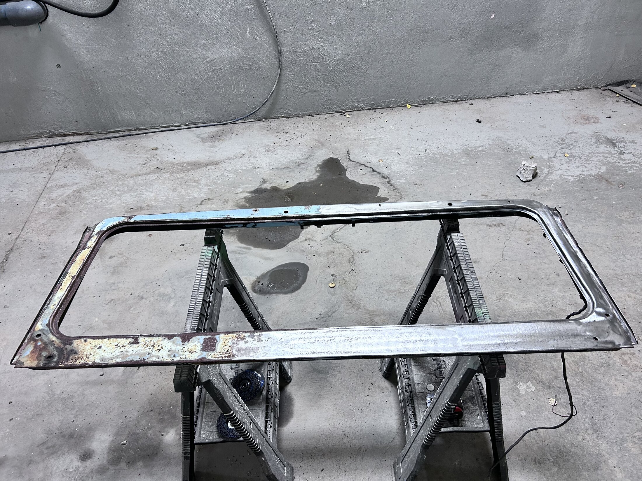

It’s got a couple coats of paint. The black came off pretty easy, but the oem blue put up a fight. I probably went through 6 batteries on the grinder between the wire wheel and the stripping discs.
I still need to get the tight areas. Maybe a dremel will work, but the ones I had on hand were super cheesy. They blew apart the first time they touched the metal. I’ll look into better ones.
There’s some very light pitting here and there. I’m thinking of hitting those areas with POR-15 and then the primer. I’d rather not grind down the pitted spots and create large low spots. This time I am avoiding any body filler on this project. I’m no body guy, so I’m open to suggestions.
Maybe spot putty or coats of high build sandable primer.
I got a solid coat of POR15 on one side of the windshield frame. Thankfully, I live in a dry environment, so the bare metal is holding up fine. When this side dries I’ll flip it and do the other side. I’m being kinda sloppy to get it into the nooks and crannies. I’m planning to block sand it after it cures. My hope is it’ll treat the low areas that stripping didn’t reach and then the painting process will protect the rest. Sorry no pics.

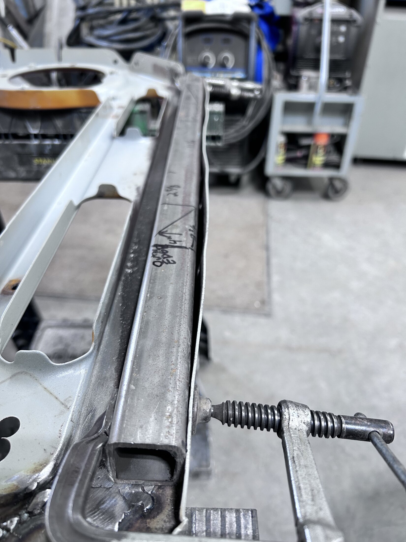

While that cures I spent way too much time working out my game plan for the bib “reinforcement”. Like a lot of people here I spend an inordinate amount of time just looking at it to come up with a game plan. Then it comes time to start scrounging together metal and cutting it “just right”. I found a couple sticks of 1” square tube. One of them was even basically straight. The other had been used as a lever one to many times, but sufficed for the short sections. The goal here is to be completely hidden behind the bib, so it doesn’t have to be pretty. I does need to be strong though.
First order of business was straightening the bottom edge.
The rust had put a decent ripple in the straight edge. I clamped a nicer section of 1.5” tube on the inside and persuaded it back into a straighter edge with some light taps. Next was the reinforcement frame. This took some head scratching with the scraps I had on hand.
So this is where I’m at -

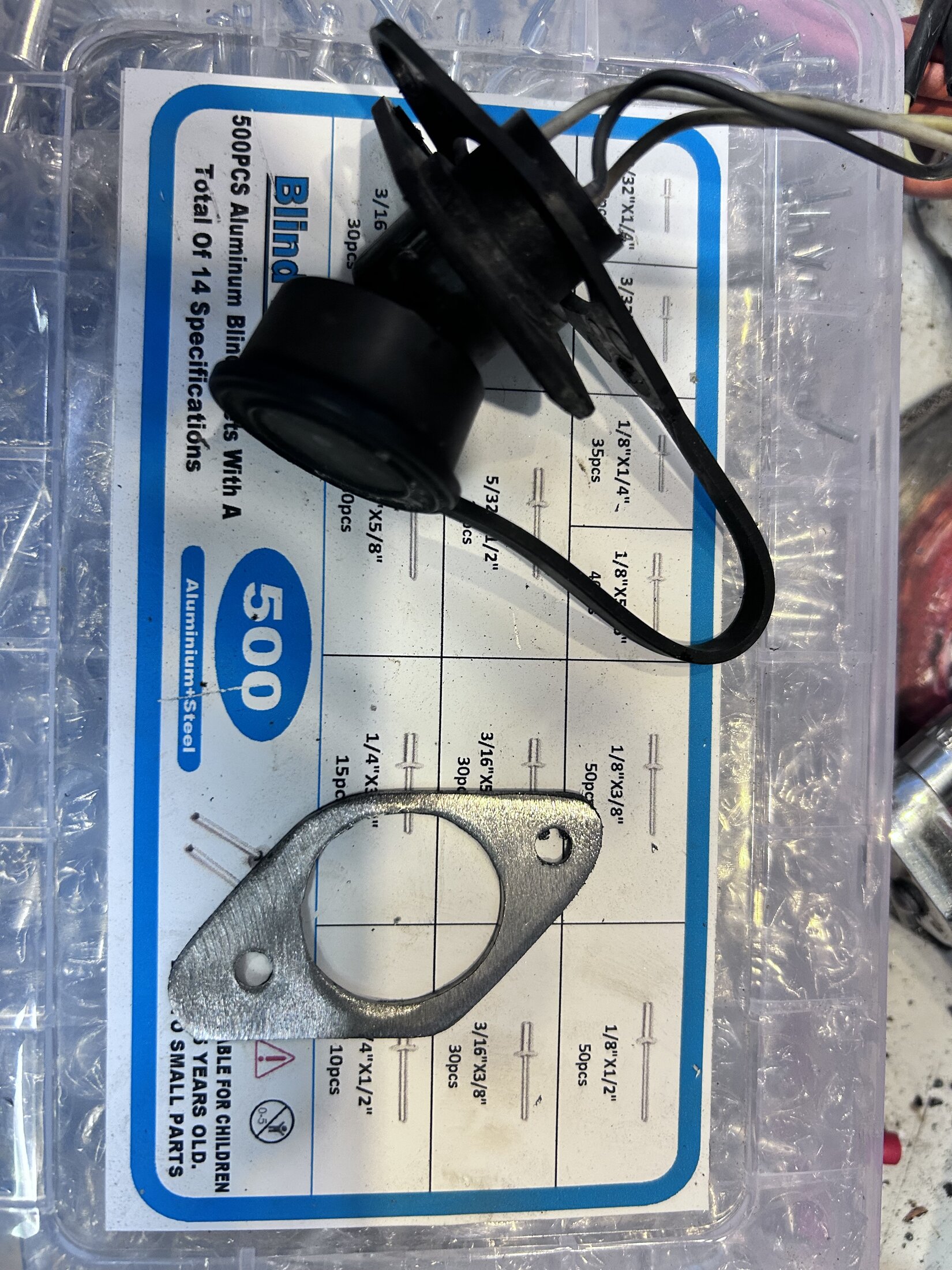

  4. Install lights in bib.

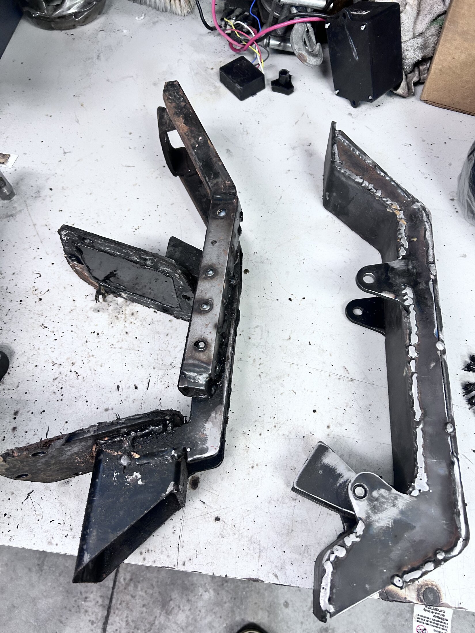

Couple years ago I made a crossmember to replace the AA propeller mount. It replaced the pto (?) plates on the SM465 with weldable 3/16 plate. This I welded directly to the cobble fabbed crossmember I had whipped up. It wasn’t pretty, but it held up for a year or two. This summer I was having trouble shifting in & out 4wd. Turns out the cobble fabbed xmember had failed. What’s one to do? Cobble it back together.
I rosette welded some angle on and carried on. It held, but I knew I had to do something more.
Enter the plasma table. I drew up a x member and cut it out of 3/16 plate. It (right) seemed a little beefier
Nothing is ever as easy as you planned, but with time it’ll get done.
