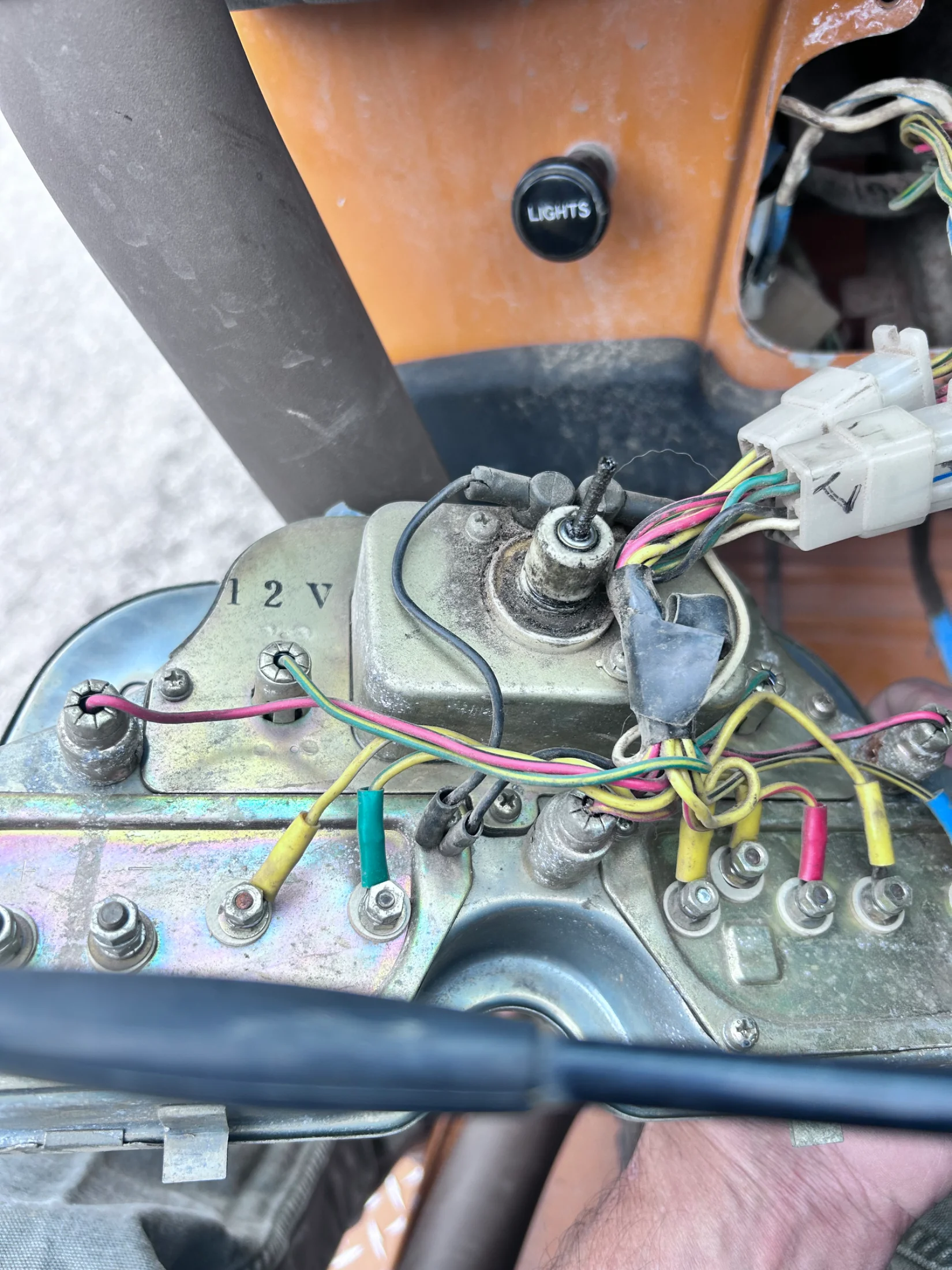

A little pre-text- I am running 100 amp alternator, so I bypassed the oem amp meter and tied the two leads together. Another symptom that may or may not be related is I’ve been blowing the 20 amp fuse for the instrument cluster. I don’t have the wiring diagram in front of me, but as I recall the amp meter feeds the fuse box in a 1973? My immediate assumption is that I need to rewire what feeds the fuse block.

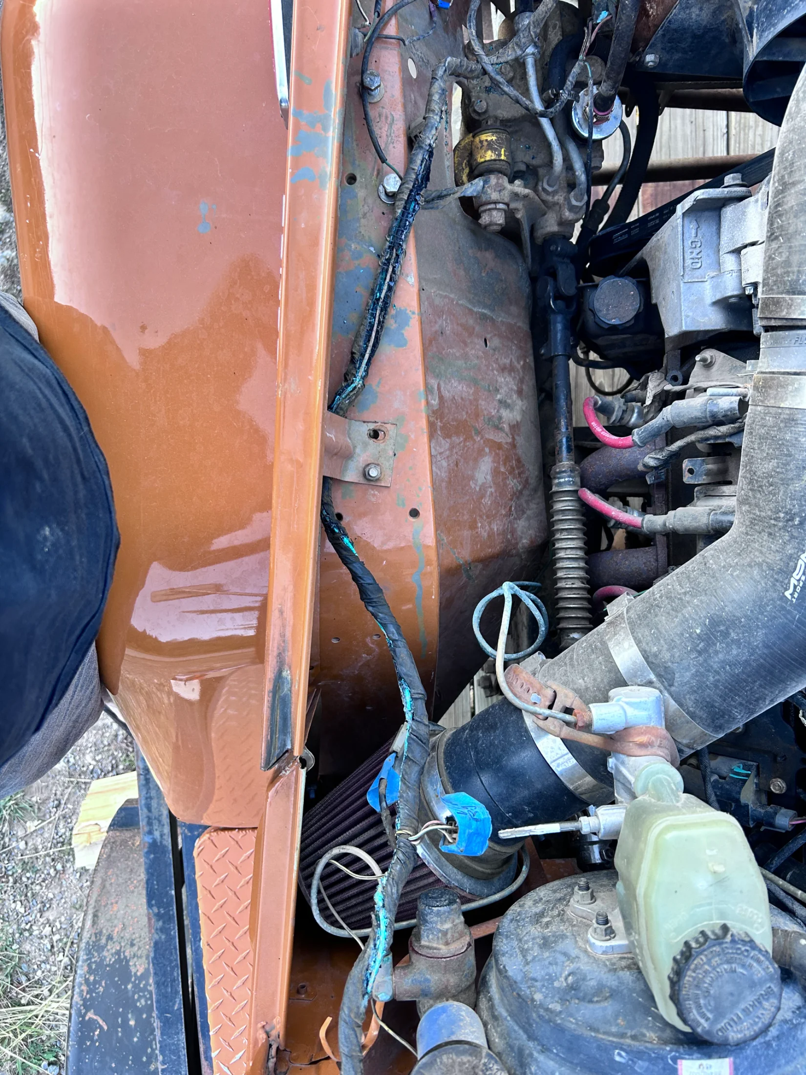

The OEM alternator ring terminal, which I should’ve more correctly terminated, grounded out on the steering box. Basically, the white and blue wire that @pb4ugo referenced got heated up throughout the harness. I haven’t pulled the full harness yet, but I have a pretty good idea of what I’m looking at.
Once again, I’m the only one to blame, I’m the only one that works on this truck.

Stock amp gauge wires are terminated together behind the gauges and taped up.

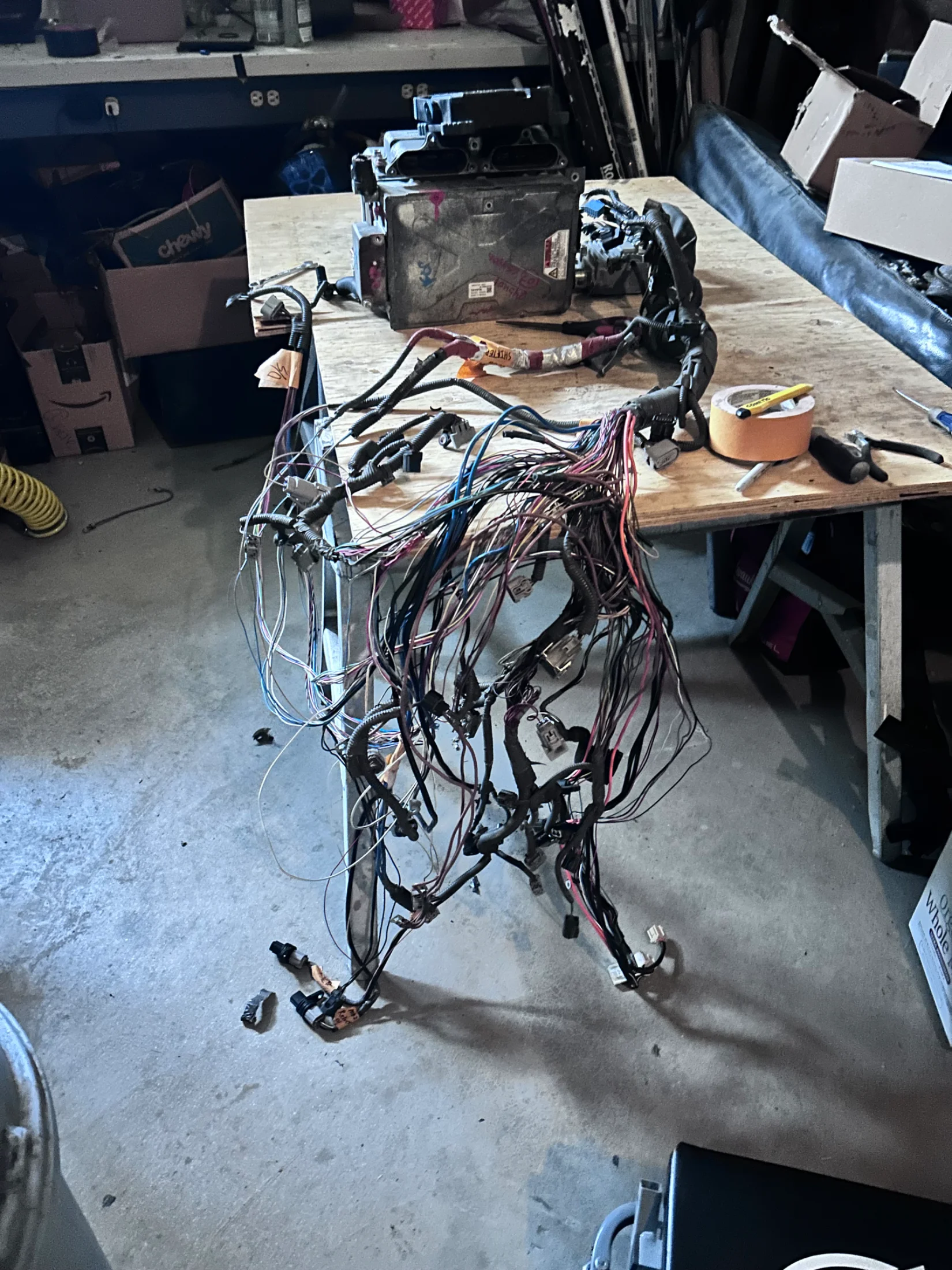

It happened, but it took a while. I mean there were fits and starts, but I did work on it- I swear. I took it on a work trip and set up shop in the rental.
I took it to work and laid it out in the office.
I cut the bad out (&there was plenty of it). I used some where around 25’ of wire, not including the upgrade of the main power supply (10awg) to the oem fuse block (somehow this still works- I think). I didn’t have the color code matched wires, but I did have a label maker and some printable shrink wrap.
Lots of splices. I was new to these splices, but after a couple they really are a slick way to do these splices. I mean if they work long term, they’re are definitely worth the effort.
So here it is in all it glory, wrapped up and it’s ready for install.
