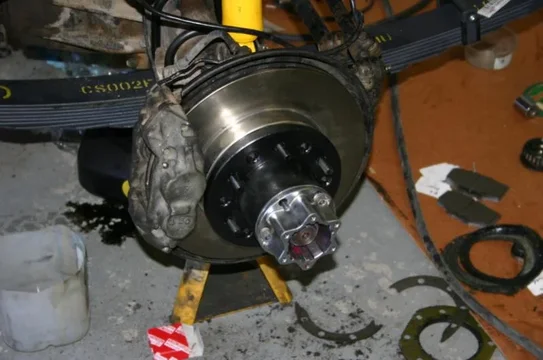

Yesterday and today Dan, Ali, and my father worked on rebuilding my axles. Besides having an issue with the birfields not fitting quite right it went well. Nothing a little grinding can't fix, though. I went back to stock Aisin Hubs that look much better. They need some paint, but so does my entire vehicle. Also Dan got some snapped bolts out for me, so I can finally not have to duct tap my rear lights. I learned a ton about my axles, and that I never want to break a birfield in the field, or ever in that case. The last two days have been very productive. So a big thanks to Ali and Dan.
Dan and I had to make sure everything was working fine, so we took the 40 for a little bit of a drive.
Everything works just fine. :cool:
