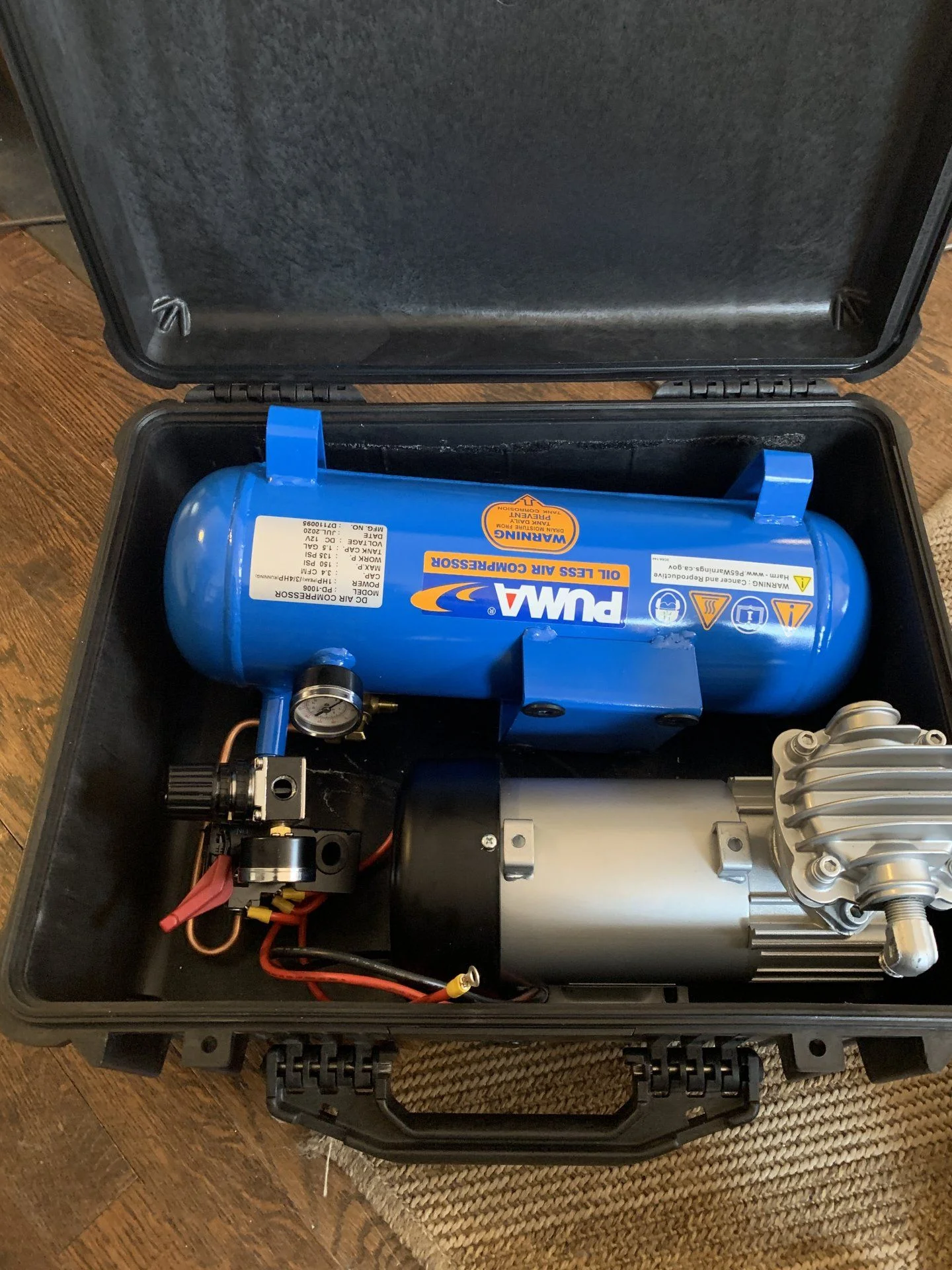

Take the PRV (pressure Relief valve) out and see if that hole is big enough for what you need.it’s got to be open to run anyway since it’s airtight closedAny suggestions on mounting a compressor into a Pelican case?
Not like it needs to be water tight but it seems counter production to drill through one.
Do you plan on running it in the case? I feel you’re going to burn it up with no air flow and being enclosed so tight. Just my thoughts maybe you’ve already researched otherwise. I was thinking on mounting one in a chest style toolbox and I’m not 100% sure that’s a good idea. Again just my thoughts on thisMaking progress on reconfiguring the Puma. Going tankless. Don’t mind the seltzer can.
Just need to figure out the threads and look for a few fittings. I know one is BSP or JIS. I think the rest are NPT.
I’ve been wanting to try Send Cut Send so I’m going to use them to make some mounting brackets. f it’s too pricey I’ll whip out the drill and grinder.
Still trying to figure out a way to avoid drilling the pelican. Maybe a large L shaped epoxied the the case. Not the end of the world if I have to drill it.
hope you guys don’t mind me thinking out loud too much
