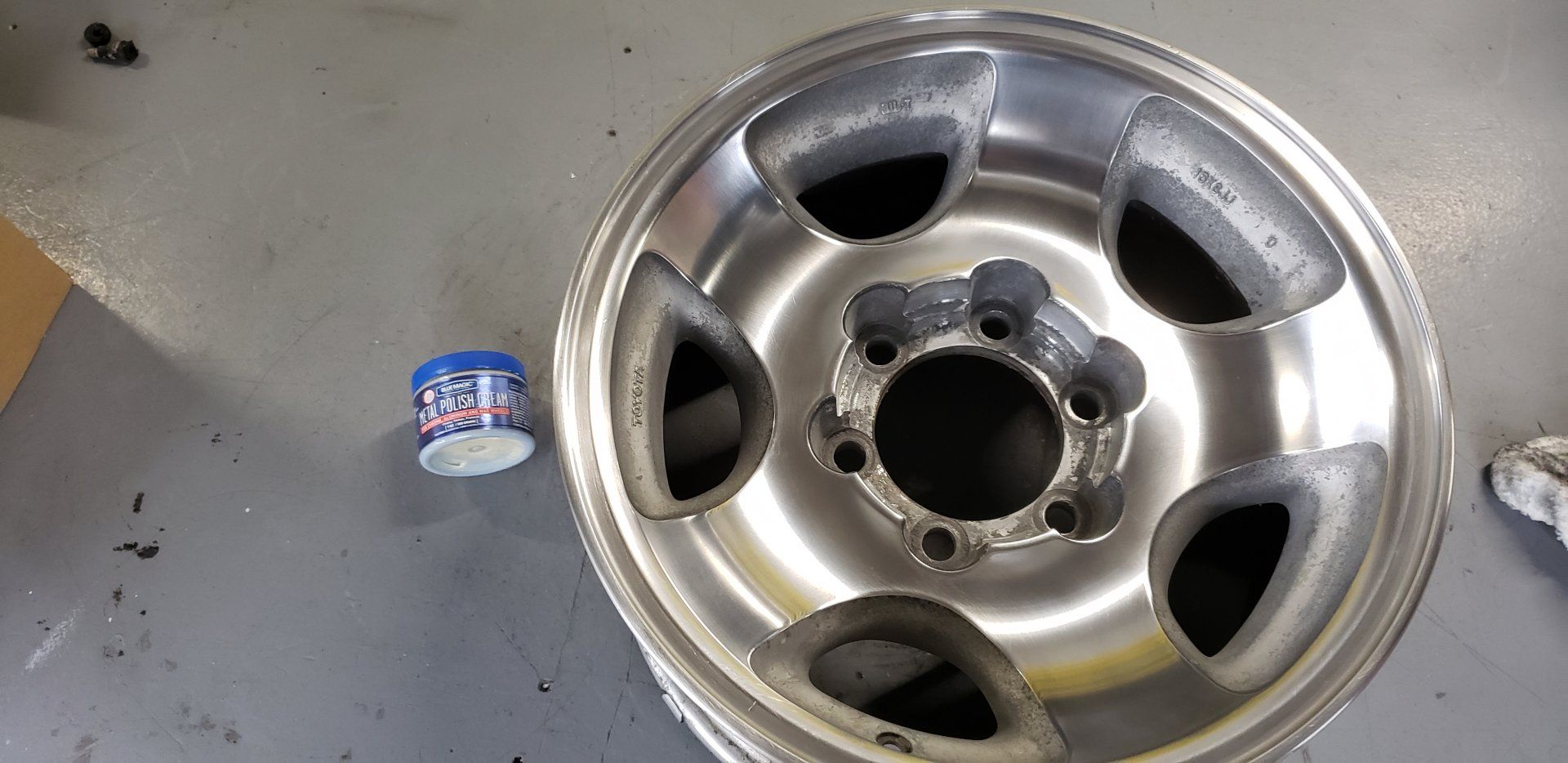

Refinishing my beat up wheel. After a sticker shock of almost $400 to refinish a single wheel, I took it upon myself to make it okay looking lol just have to paint the areas between the spokes. Used Citrus paint stripper to remove the clear then used 180 grit to sand down the oxidized areas. Finally used a series of 220, 300, 400, 1000, 1500, 2000 and 2500 grit sandpaper. Finished with blue magic polish to see how it would it turn out. Thinking satin black or the grey used on the LX450 cladding to paint the areas between the spokes. Total of 20ish$
What do you plan on using to maintain shine? I did the same thing on the Outlaw IIs on my Taco, but coated them with Collinite 845, a wax used by linemen of old to protect glass insulators on power lines. Also a great car wax. Worked well for one winter season, but not the ultimate protection. Perhaps a quality clear coat...
I was going to paint the areas inside the spokes then clearcoat the entire wheel. Not sure which clear would hold up to the heat and brake dust though.

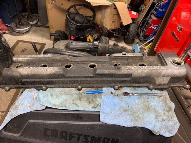

so after purchasing the new to me LX450, i did notice the valve cover gasket has been leaking for awhile. Started tackling that job in combination with TB cleaning, new plugs and oem wires and a couple new breather hoses which should be here today. cant wait to get in here with some degreaser and a power washer now that i know that its sealed up, It was nice to see how clean the valve train was especially since this is a 282k motor and small signs of OE parts usage is always a plus. Also install a OEM driver door belt molding
all put back together waiting on PCV valve, grommet, two breather hoses, and plug wires. all should be here today from Toyota

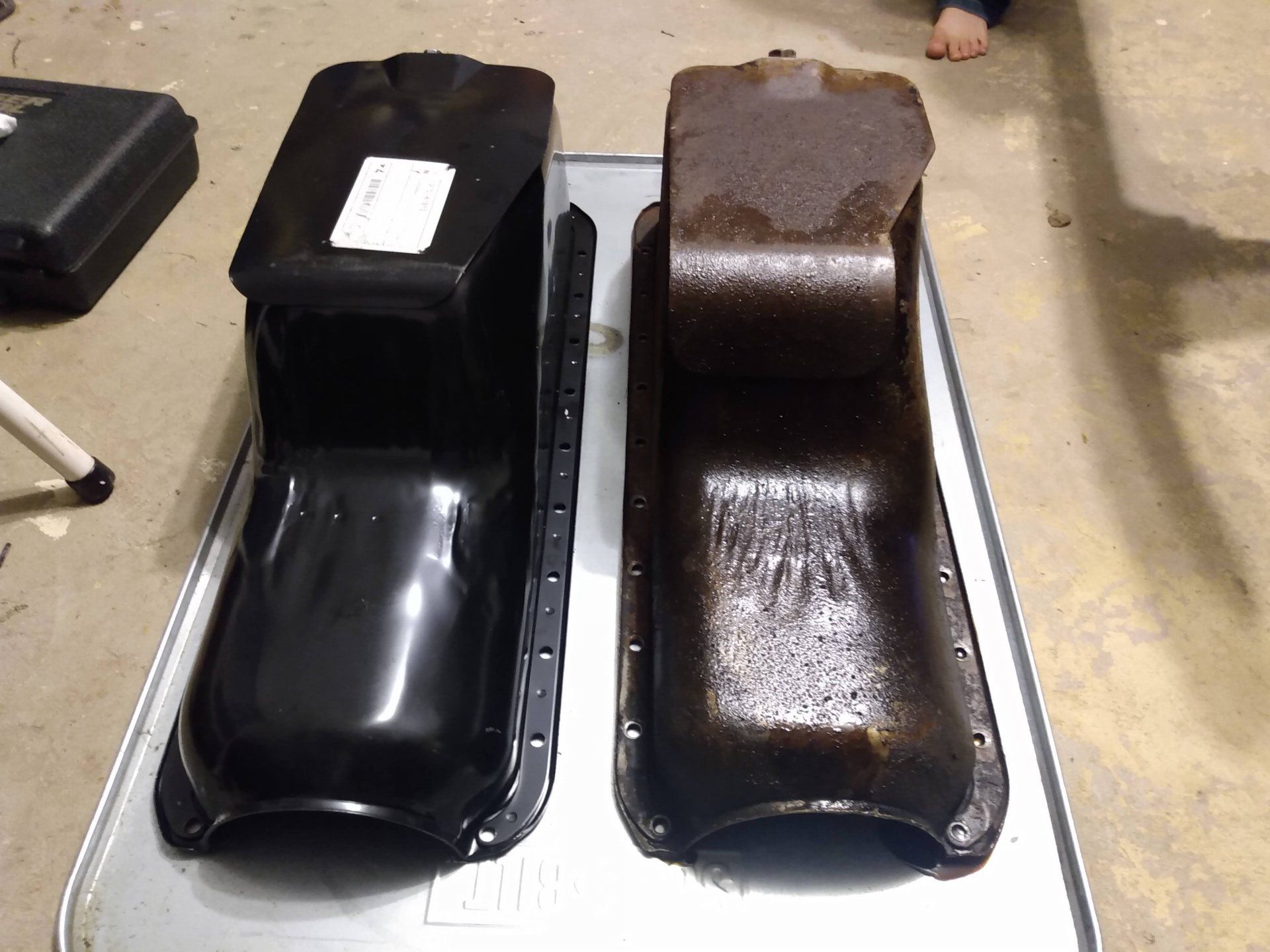

Got the old pan cleaned up, painted and went back on like a champ. Used some FIPG in the corners only and torqued the new OEM bolts down to 84 in-lbs. I think the last time I did this job was when I used my in-lbs torque wrench last because it was already set to 84. :rolleyes: I got some oil sitting in it now and if I don't see any drips by Friday I'll take it for a spin and see how it looks.
I used high temp engine enamel on the oil pan but also used regular Rustoleum primer. I didn't think about it until later that engine paint probably doesn't need primer. I guess we'll see how it holds up.
And just for grins here's the new oil pan versus the old pan side by side. Old pan skid mic'd out at .163 inches and the new one .066 inches.

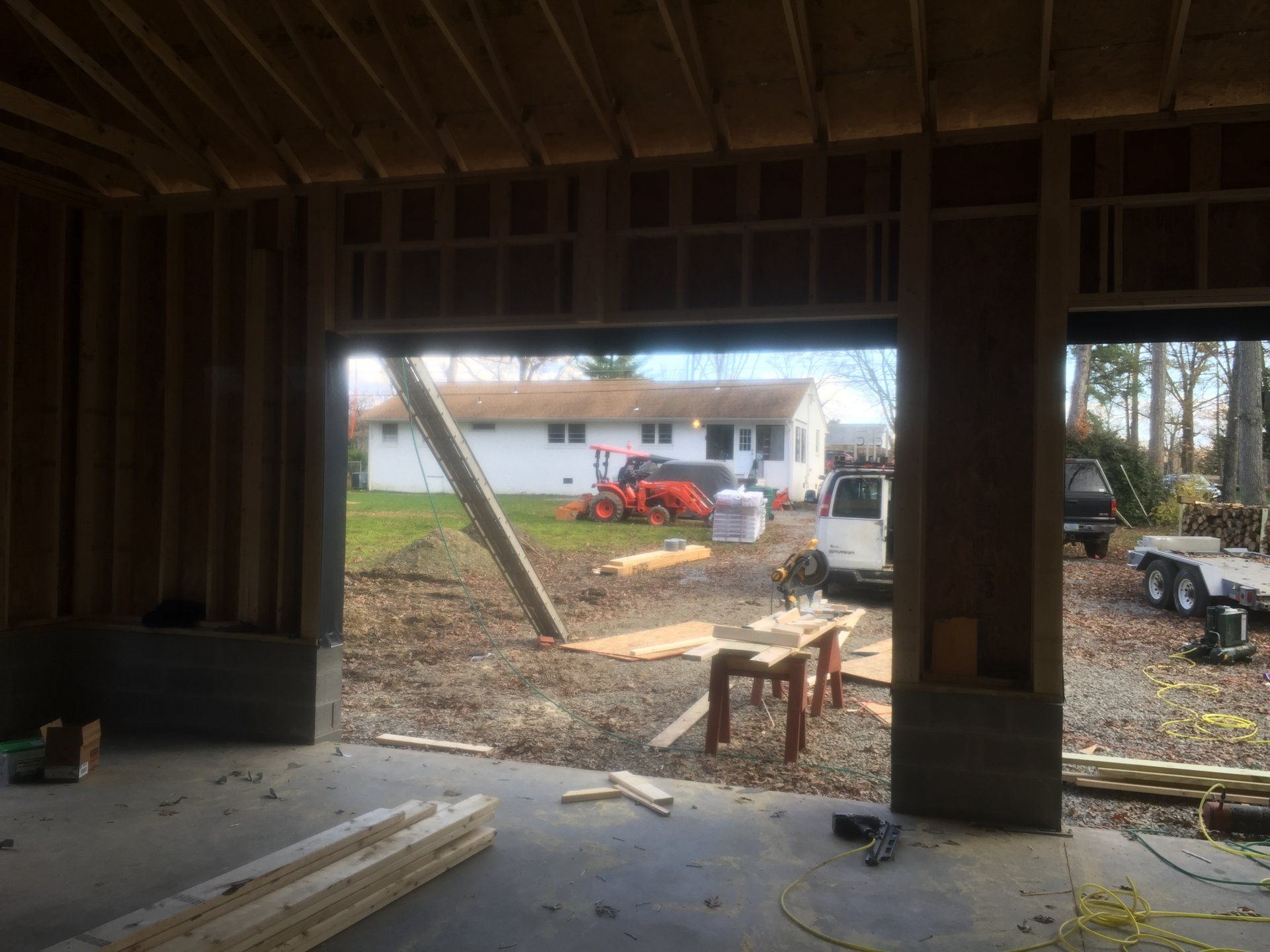

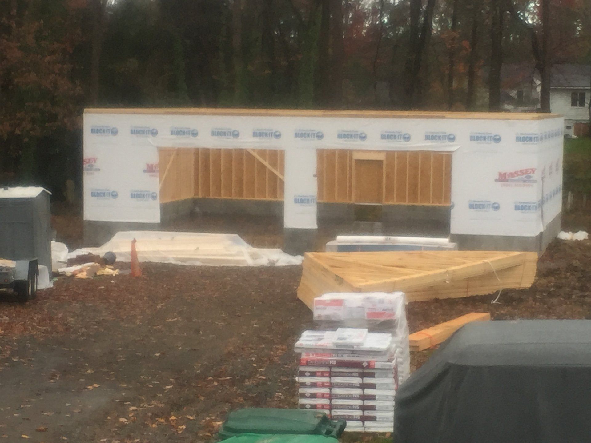

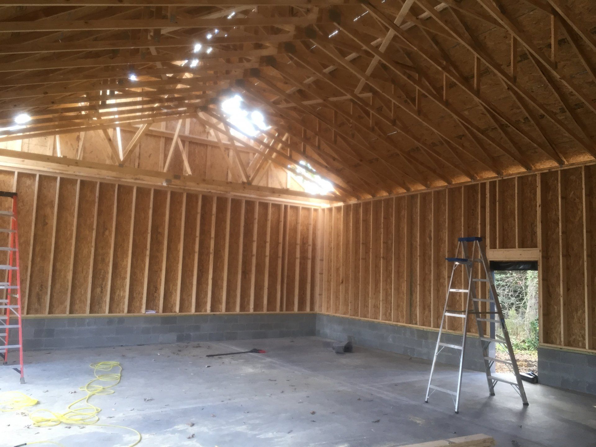

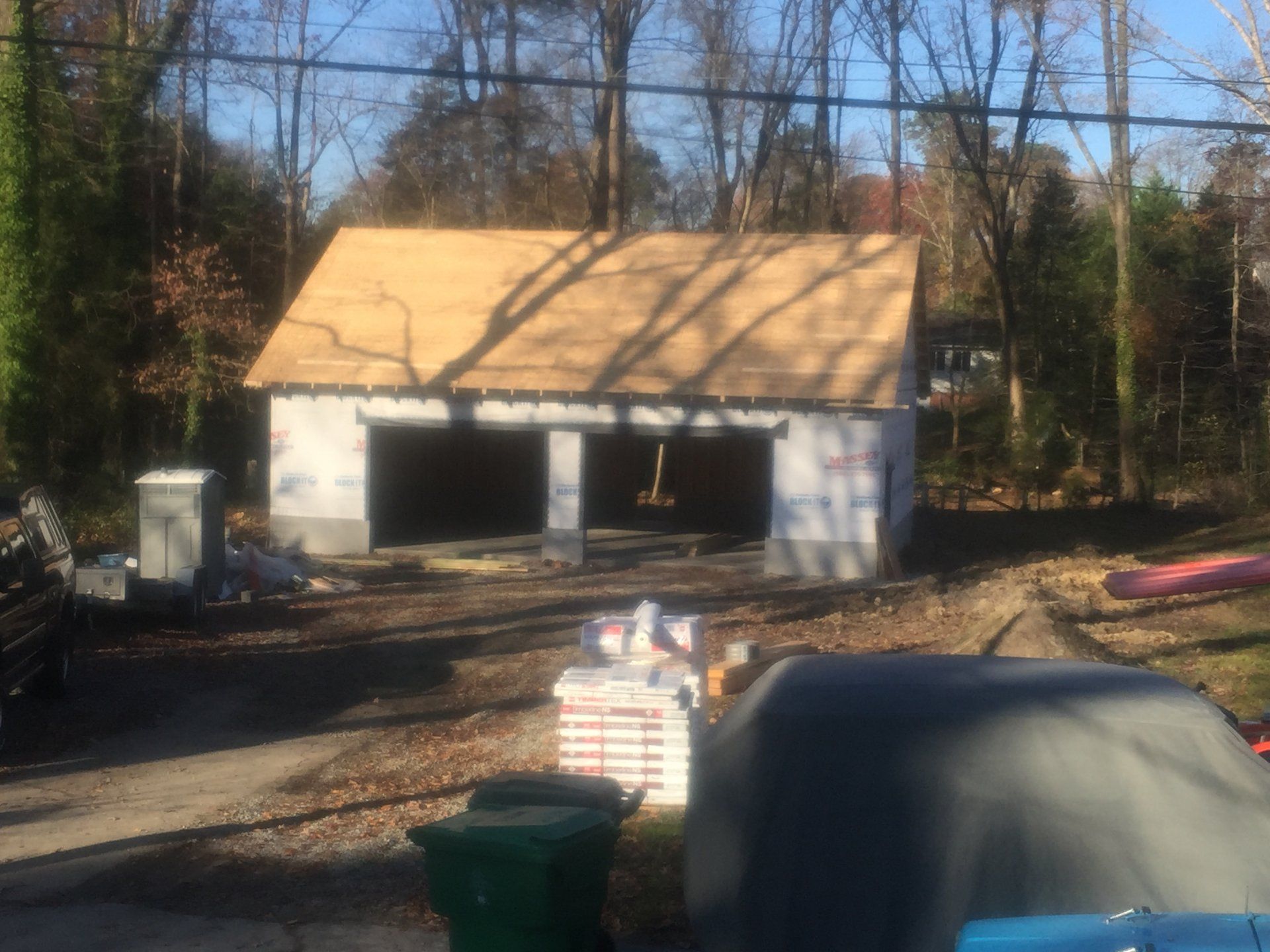

12'. And a 4/12 pitch inside, so about 15 to the peak.
Nice. I'm planning my 32x26 attached garage and am always scrounging for ideas and inspiration.
