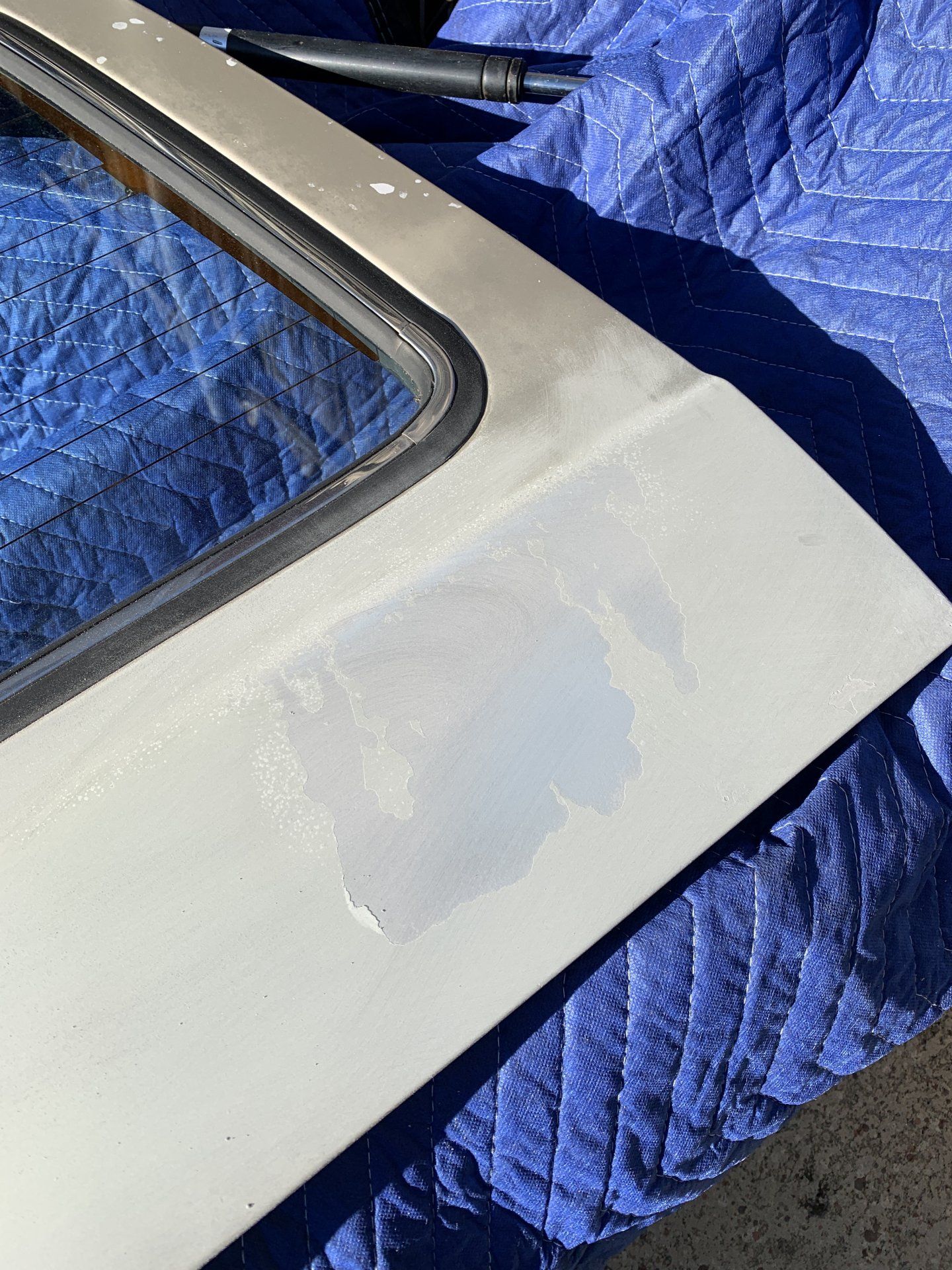

Finally started prepping the lift gate that @JohnVee and Jessica from ONSC helped me get from Asheville!
I’m swapping lift gates because the rust under the window channel on mine came back after attacking it last year.
it needed some very minor cosmetic and rust work. Hit it with a wire wheel and Ospho yesterday. Primed and then painted/cleared the top side today.
I plan to combine the best bits from my current lift gate and this one. I am looking for some parts but the crustiest ones are NLA of course. We’ll see.
I also plan to add an LED 3rd brake light from GoWesty
because dc/md/va drivers. I’ll also replace the rear window washer line while I’m at it.
Check out that super clean window channel. Hope it stays that way 🙏🏻

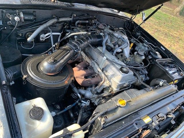

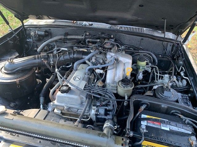

so got the engine bay all degreased and cleaned on the LX450, there was a bit of water in the car when i got it so got all that cleaned up, clean the sunroof drains and adjusted the glass. Well after all the heavy rain that we got in southern MD i'm happy to report that we still have a dry interior
and took it on it first test drive to the gas station, happy that the gas gauge works ( i thought it was broken but it was just running on hopes and dreams ) truck drove very well, temps all stayed in range, trans felt good, motor feels strong.
next on the list is a coolant flush ( it does have toyota red in it but idk how long its been in there ) fix the exhaust, and locate a front drive shaft for it

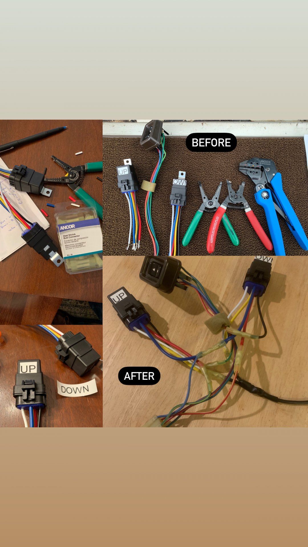

My wife decided to use the map pocket as a foot rest and then boosted herself off it while wearing #beanboots (😂😭) so I took the opportunity to do two other projects involving the door. Added sound/heat insulation from Noico and wired in two relays so the window moves faster than molasses. the label maker even got in on the fun.
the relays made a huge difference. Three more doors to go. The driver door already has relays for that window but you can add relays to help the central door lock switch.
Did sound deadening in the passenger rear door and after buying a bunch of wire to extend the relay pigtails attacked adding the relays. It came out wayyy cleaner this time.
The relays will mount down low out of the way of the window without putting any stress on the wires. Still plan to add some split loom and a ring terminal for the ground.
