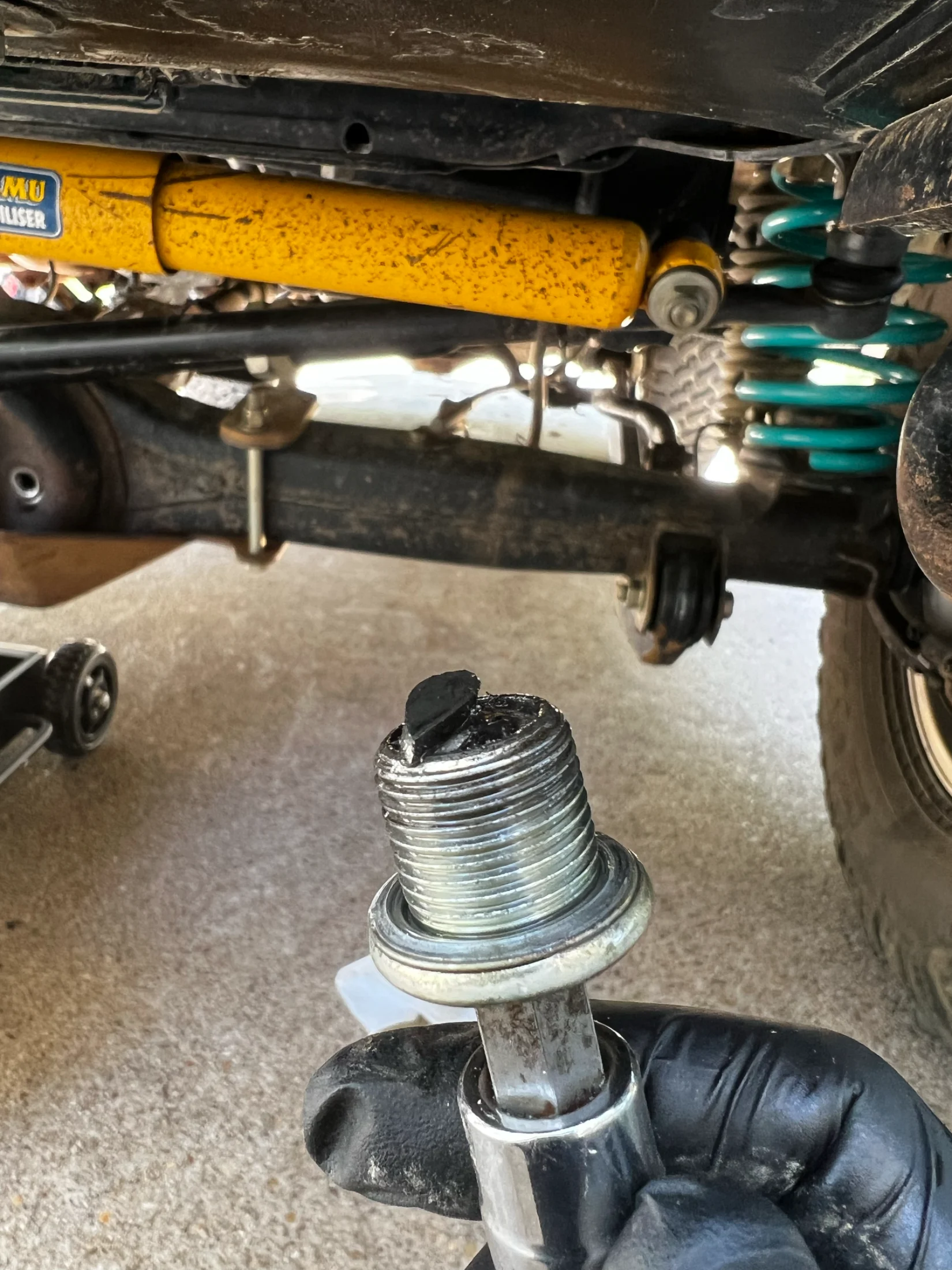

Now as far as what I am working on...I'm going to go by and see Paul today at World Tour to see if he's willing to rebuild my front 3rd member with gears and a locker. If he's good, I'll go ahead and order some parts. Thinking of going with the Eaton electric locker up front...I have the ARB in the rear and the compressor could handle the front too, but thinking of the e-version to eliminate some plumbing.
In case it wasn't seen in the GER thread, I munched up the gears pretty well up front....o_O

And a quick double check....this was on my mag fill plug, confirmed all suspicions!
That's just an iron vitamin.
