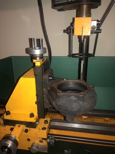

Trying to setup my bench top lathe/mill to remove what’s left of a broken bolt. The bolt snapped off while I was separating the exhaust housing from the rest of the turbo. The sooner I can remove the bolt, the sooner I can get it Cerakoted to finish rebuilding it.

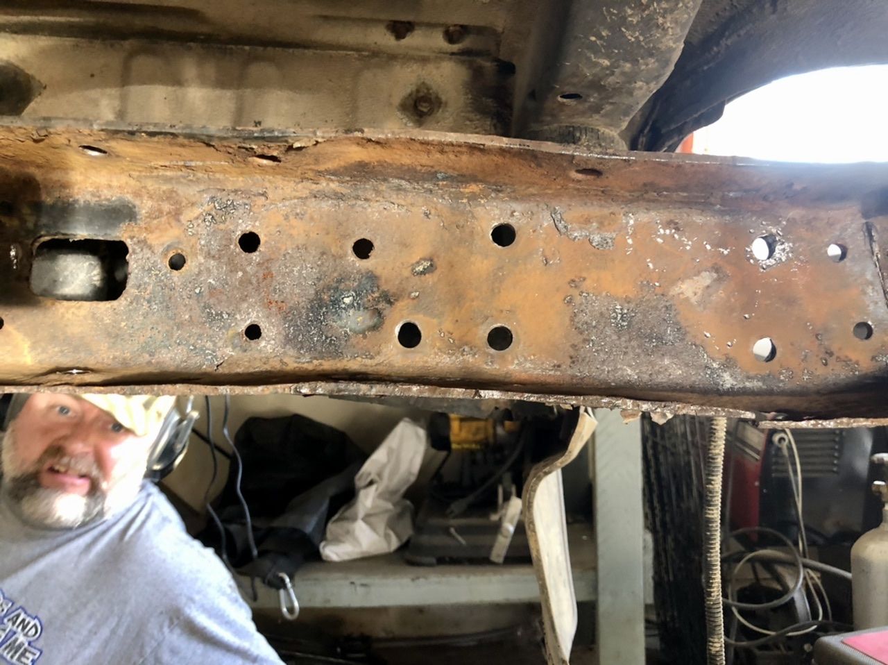

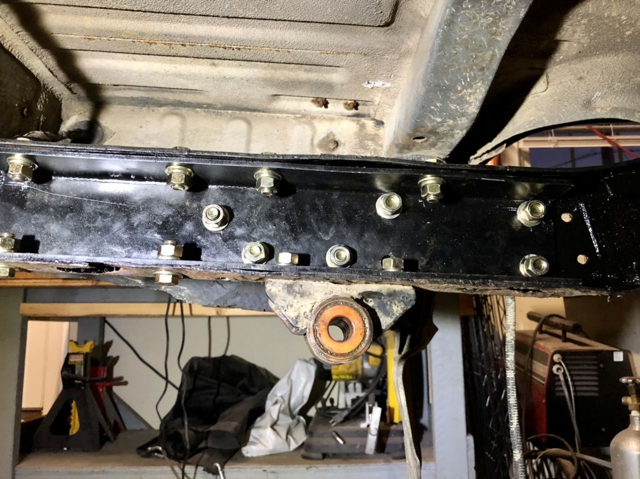

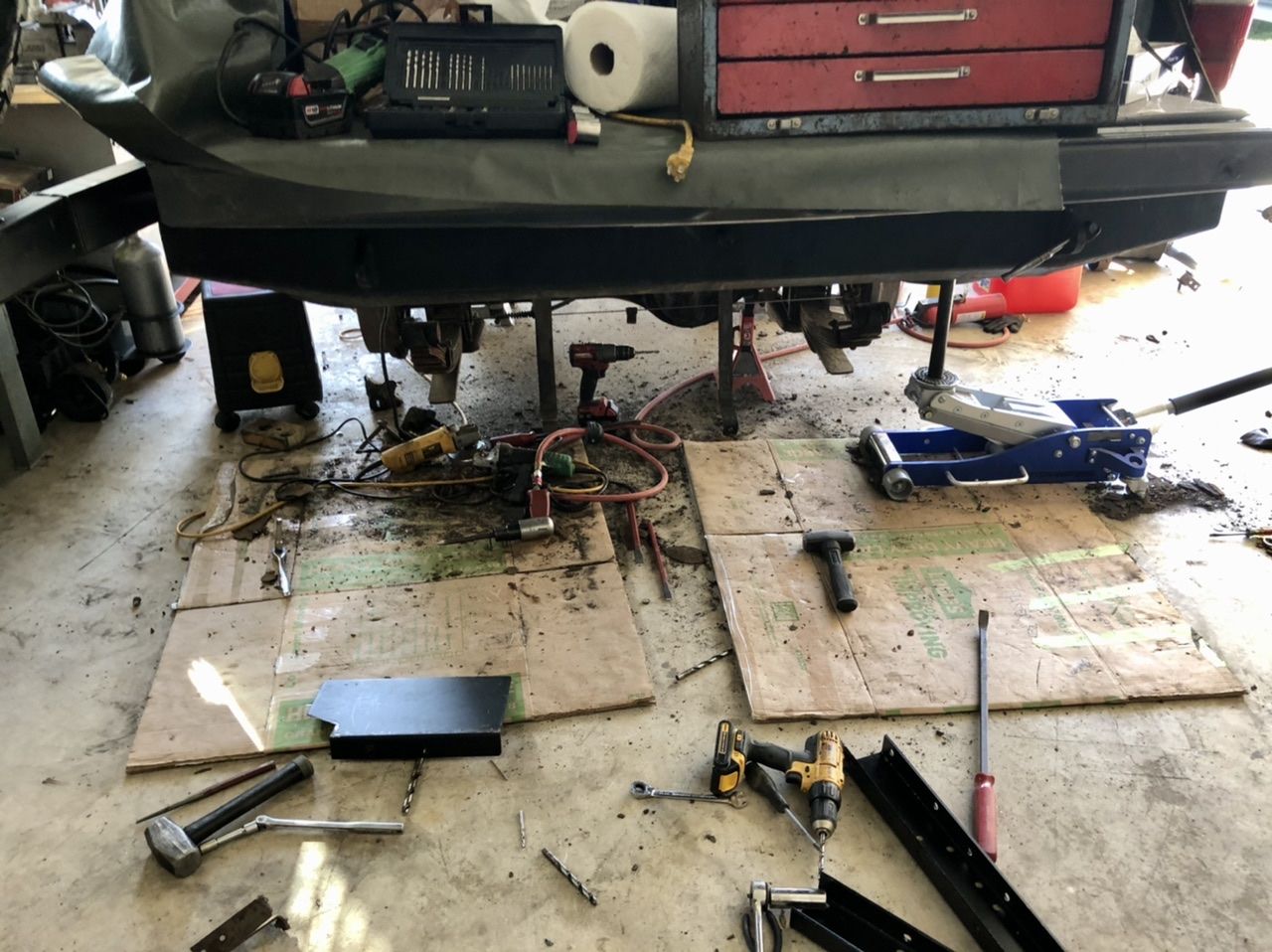

With tremendous help from @TRFCSUX, @Jakes40, and @jcj_78FJ40 we replaced the C-channels in the FJ62. The job is as atrocious as it is made out to be.
I ordered the plain steel kit!
I've been slowly knocking rivets out (over years) with a grinder and drill, I don't have enough air compressor to run an air hammer. Did you find an easy way to do it?
This was expensive, but made it easy: C-Channel Kit 60 Series
I will also warn you that the gas tank became as a big a project as the C-channels, and from what I can see it is a very common problem. Both hard lines coming out of the tank that are part of the fuel pump bracket were corroded so badly that they fell apart. That bracket is not available anywhere from what I can tell--Toyota doesn't make it and it doesn't appear anyone else does either. @Jakes40 and @jcj_78FJ40 drove to the parts store to get some new line in both sizes, bent it, and used JB Weld to hold it in. It is not an ideal solution, but it is one that works. See the photo here #3,799
If you are interested in buying a used fuel pump bracket, PM me and I'll give you the contact information for a guy selling one, but he wants $350.
Hey, if it makes you feel better, you’re not the only one with a JB welded inlet pipe. 40 fuel tank suction tubes are unicorns.
I purchased plain steel as well. It will likely outlast the frame. Grinder, drill, and punch were the tools. Air hammer did help quite a bit though.
