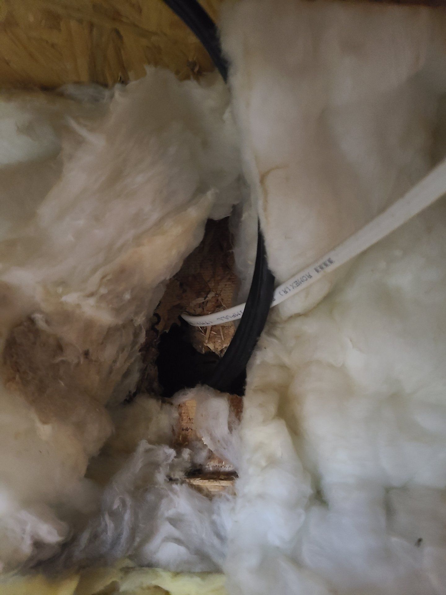

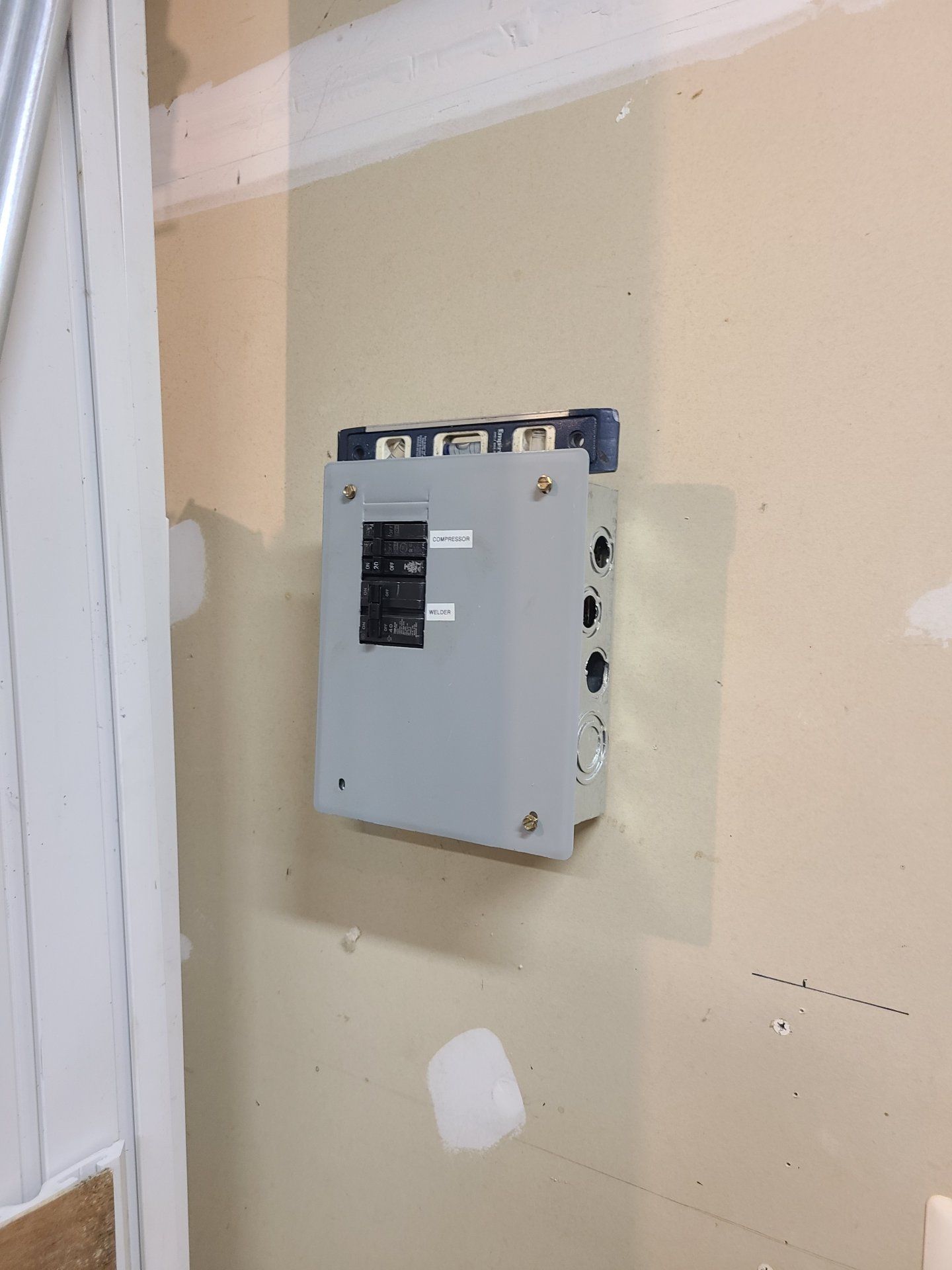

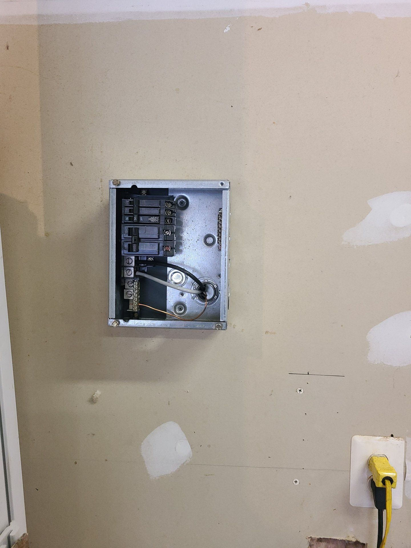

Got 240V/60A run to my garage so I can run the welder and compressor and additional 120V outlets.
The garage had 1, yes, 1 wall outlet. Cheap spec. house BS.
I ran 6/2 copper from the main breaker up into the garage wall and installed a 8 circuit sub panel i had from a previous project.
Next is to learn a new skill: bending EMT to install the circuits.

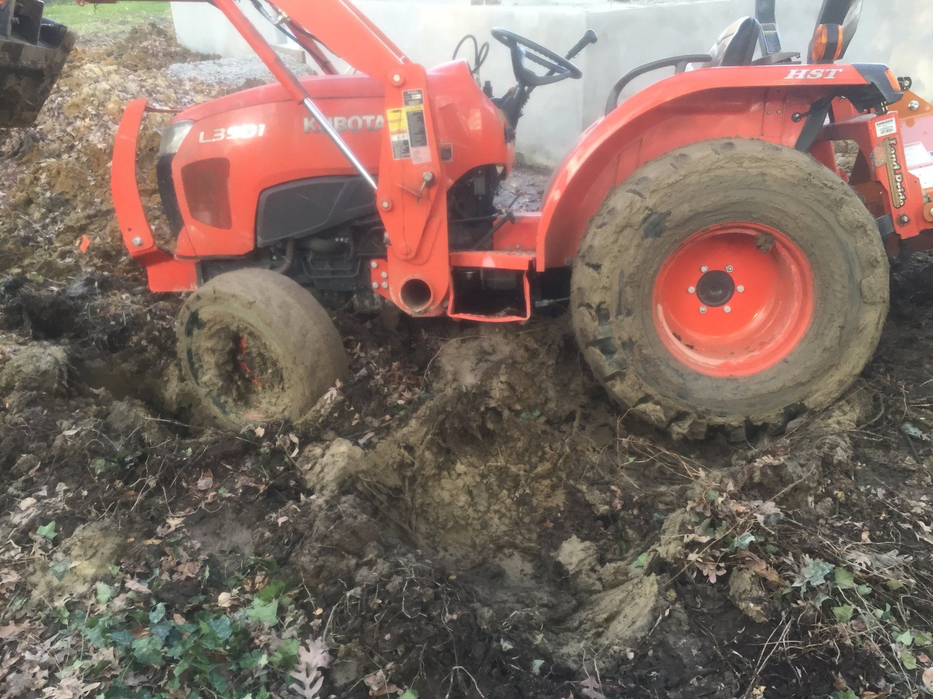

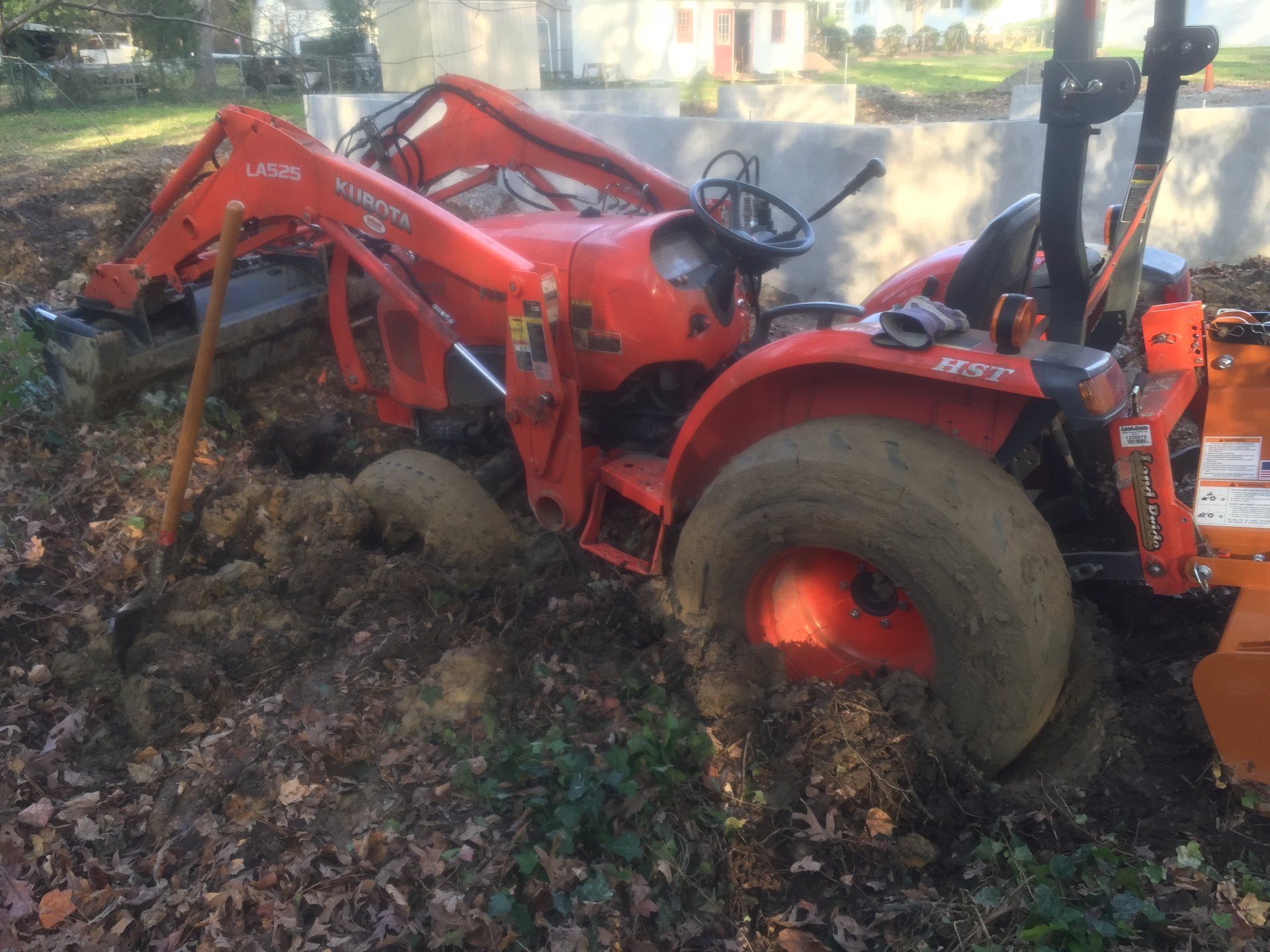

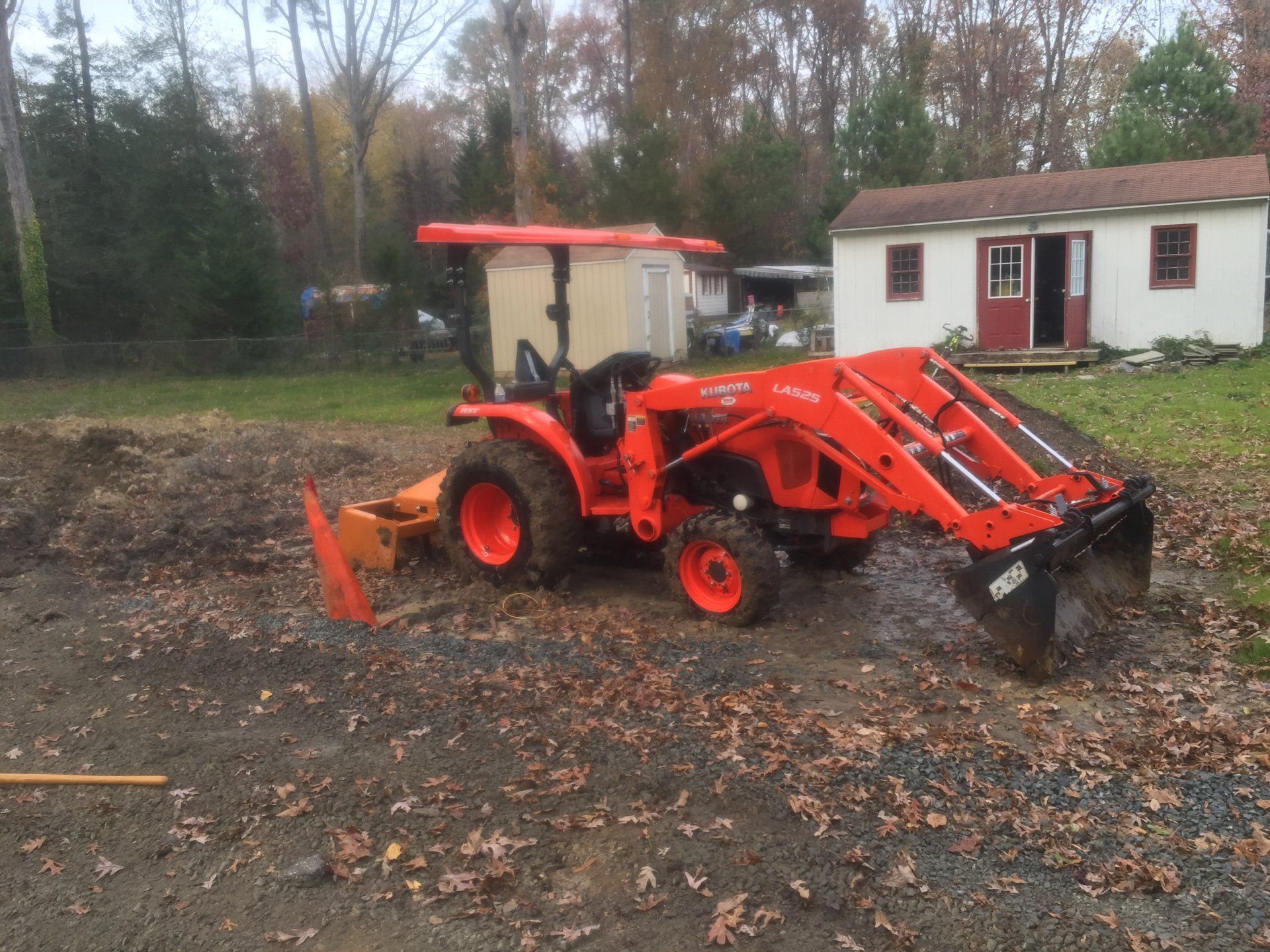

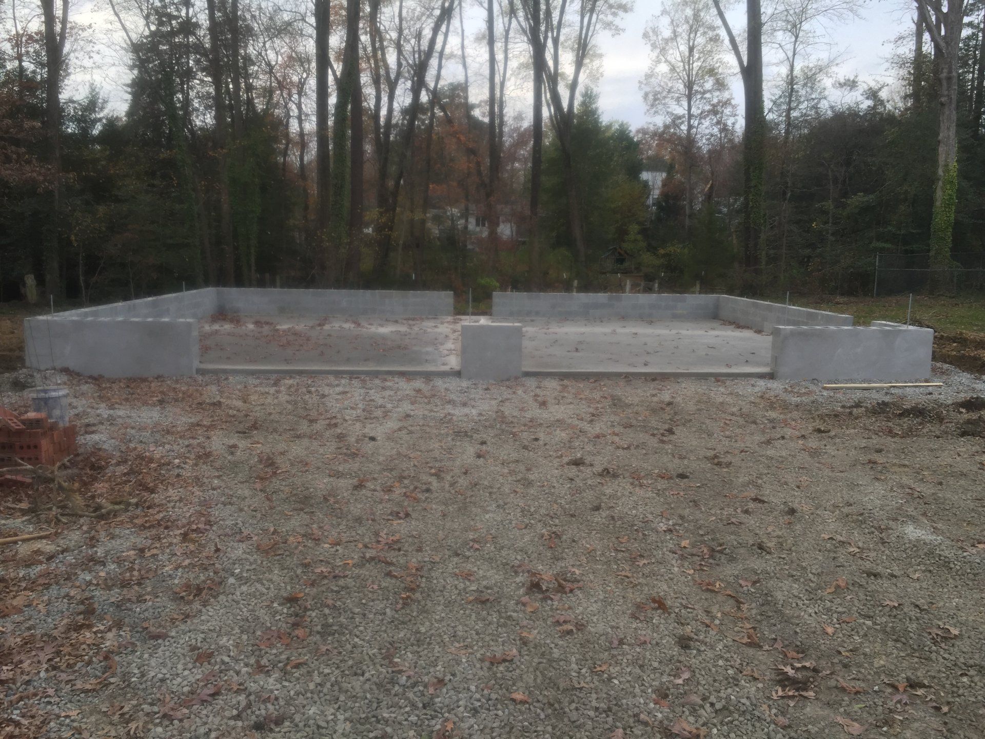

I tried to backfill the outside of my garage foundation. I ended up 4 wheeling and performing a winching recovery!
Needless to say I used my Carolina backhoe(shovel) today and did it by hand, then cleaned the tractor.
I've got to do this I have plenty of 110 outlets but need a couple 220. Just got to get around to it. I've got EMT benders if you need them. Bending ain't hard if you keep it simple.
I started bending box offsets in my 3/4", then realized no one has any 3/4" box connectors. It's crazy HD has 3/4 conduit but no connectors. And they have no 1/2 conduit but a bunch of connectors.
I'm making a run of 3/4 for my 2 conductors of 8 gauge wire for the welder and 2 conductors of 10 gauge for the compressor.
I plan to run a handful of 120v outlets using 12 gaug wire and 1/2" EMT.
