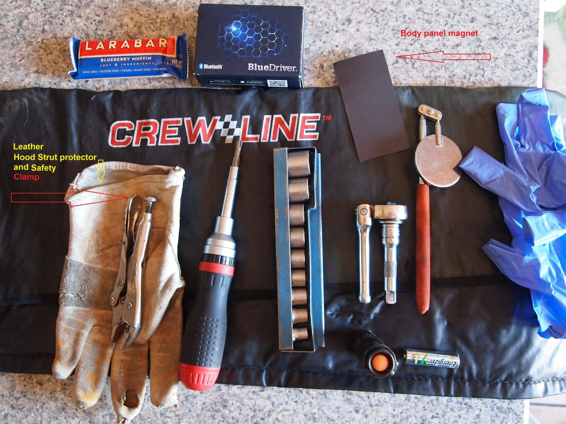

My inspection kit, fender protector, overalls and old ski parka fit nicely in small backpack.
