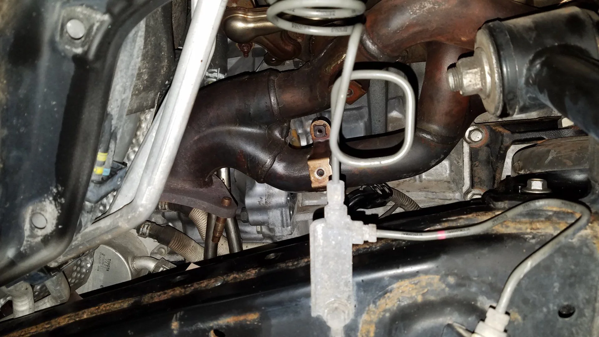

I drove straight home, hit the car wash and into my shop. All accounts of changing a starter is a PITA, requiring removal of the tail pipe, cats, exhaust manifold and heat shields, just to access the starter. We strategically skipped a few steps and left the manifold and tail pipe in place. It was tight but it worked! The original starters all supersede to a newer number that is actually a bit smaller than the original so that helped with the re-install. All in about 4 hours, could do another one tomorrow in 2 or so.

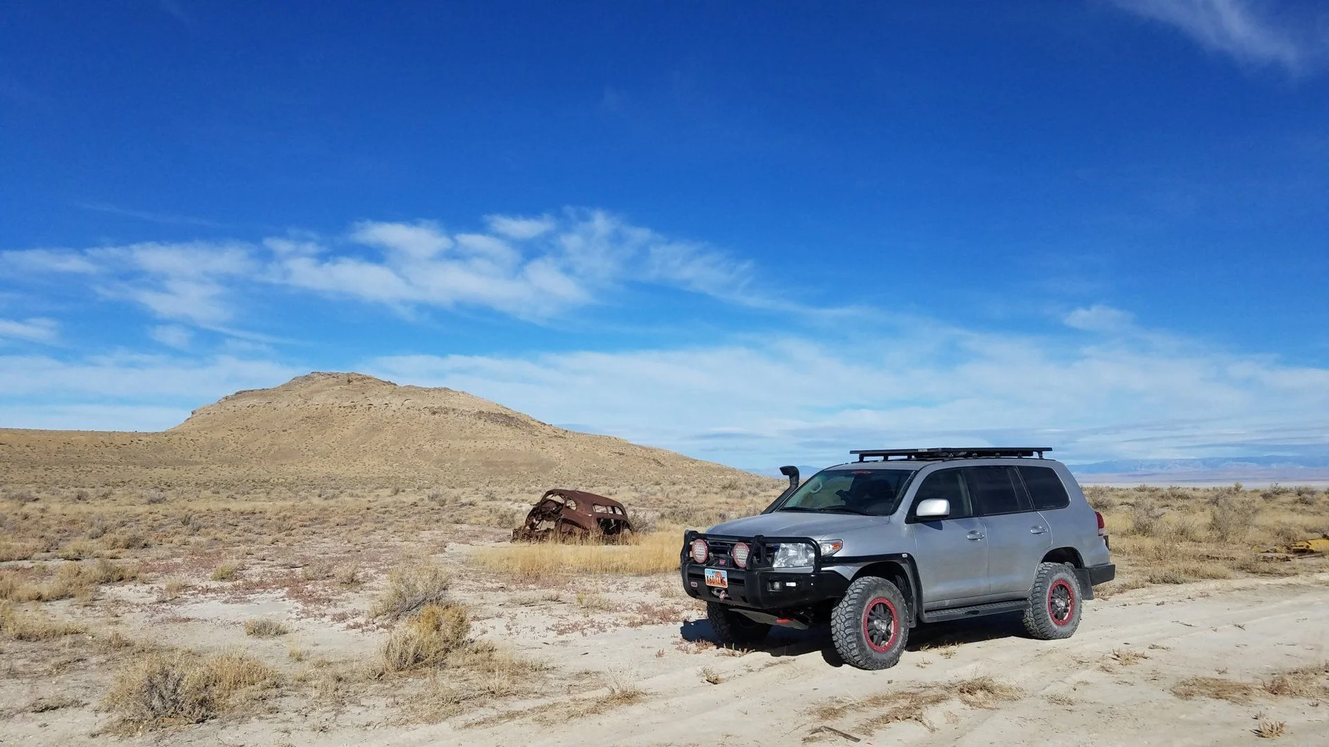

This is where she died, perhaps a bad place for vehicles?

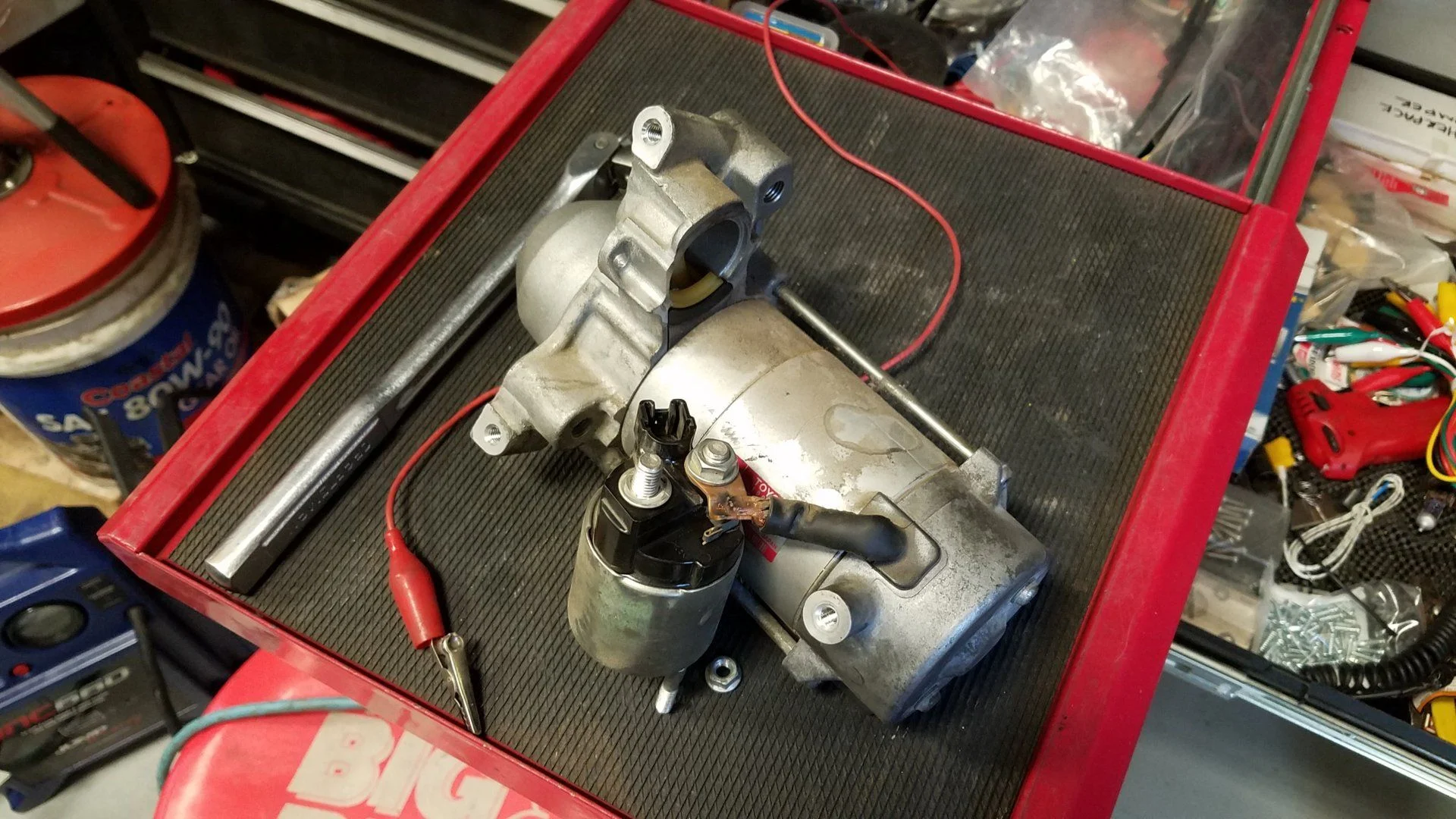

Tested, sure enough a bad solenoid

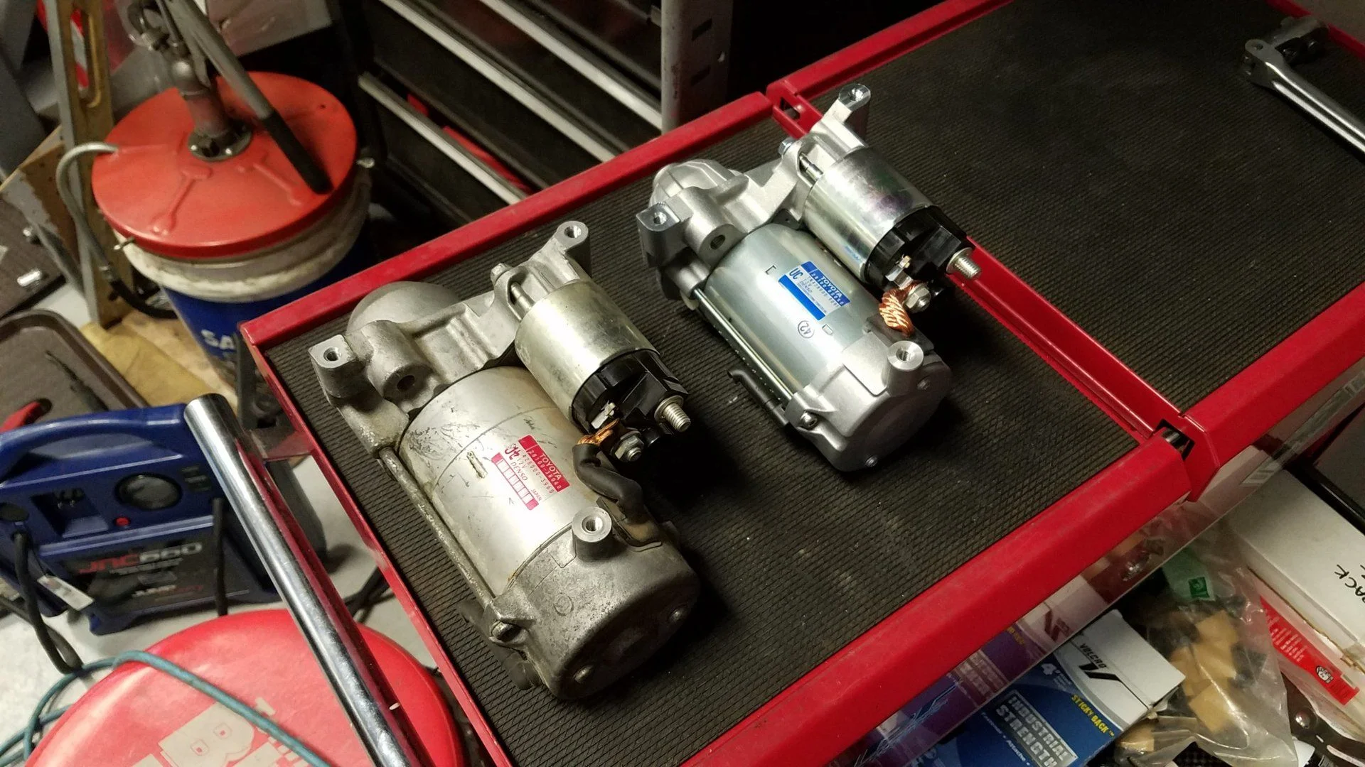

New vs. old starters

Great question. Zero warming, absolutely zero. Started fine 1000 times before and then we tried it another 100 and nothing. Smacked on the starter as best I could access and nothing. I'll tear the solenoid apart at some point in an attempt to identify the exact failure mode.

I replaced with a new OE and will rebuild the other for a spare. I doubt I'll pack it year round but on a big trip such as Baja we'll have 5-6 3UR trucks with us so it's not a bad thing to have along.
