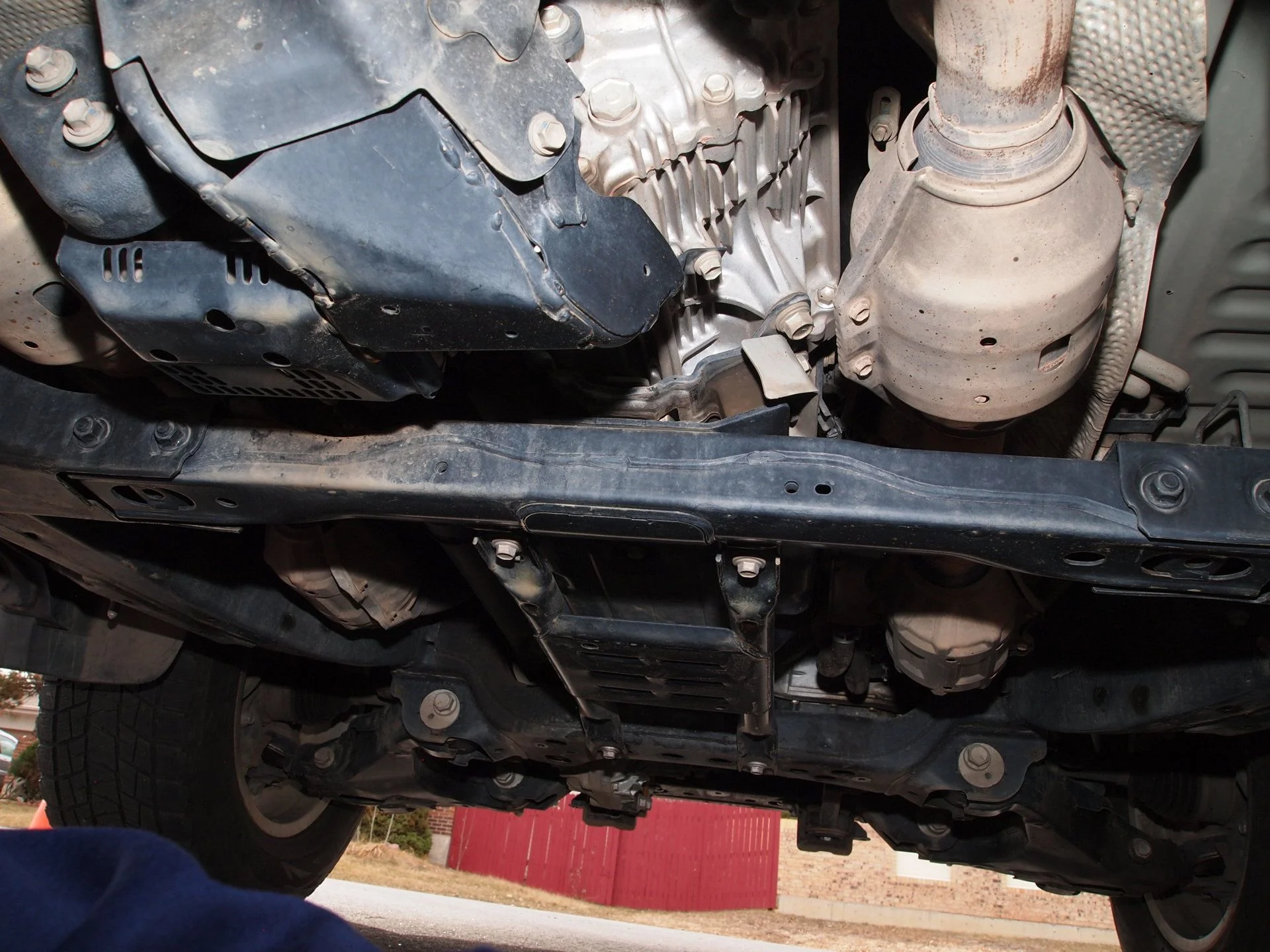

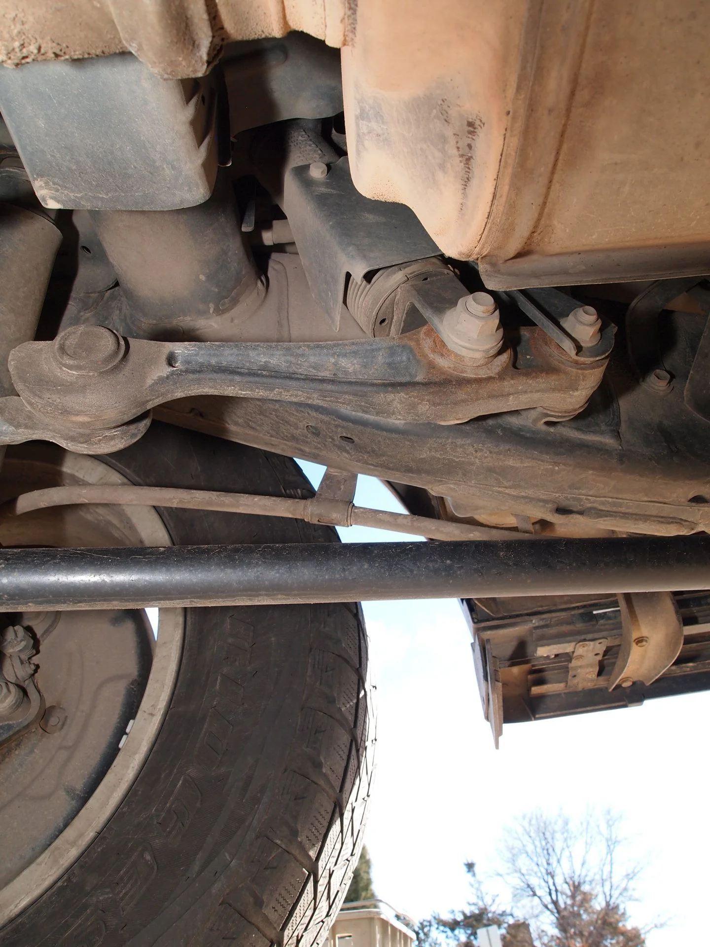

I started as usual, by photographing undercarriage while drity looking for oil spot, grease above lube points (clue to servicing history), missing parts & bolts and any damage. Then do same with engine.

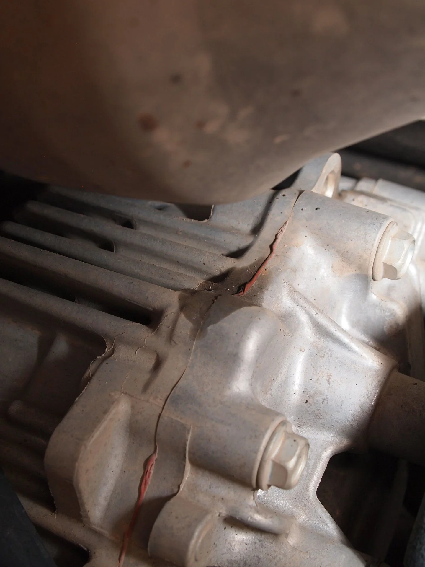

I found a very small spot on transfer case. This may just be a splash from something like and LOF or road crud. So once i've document/pictured I'll degrease, wash and keep close eye on for reappearance to ellimated (no leak) or pinpoint for repair. I've seen many misdiagnosed reports from even Toyota Dealer's on say a transmission leak, which only turns out to be flung grease from lubing propeller shafts & spiders. So washing and watching is second step in post inspection.

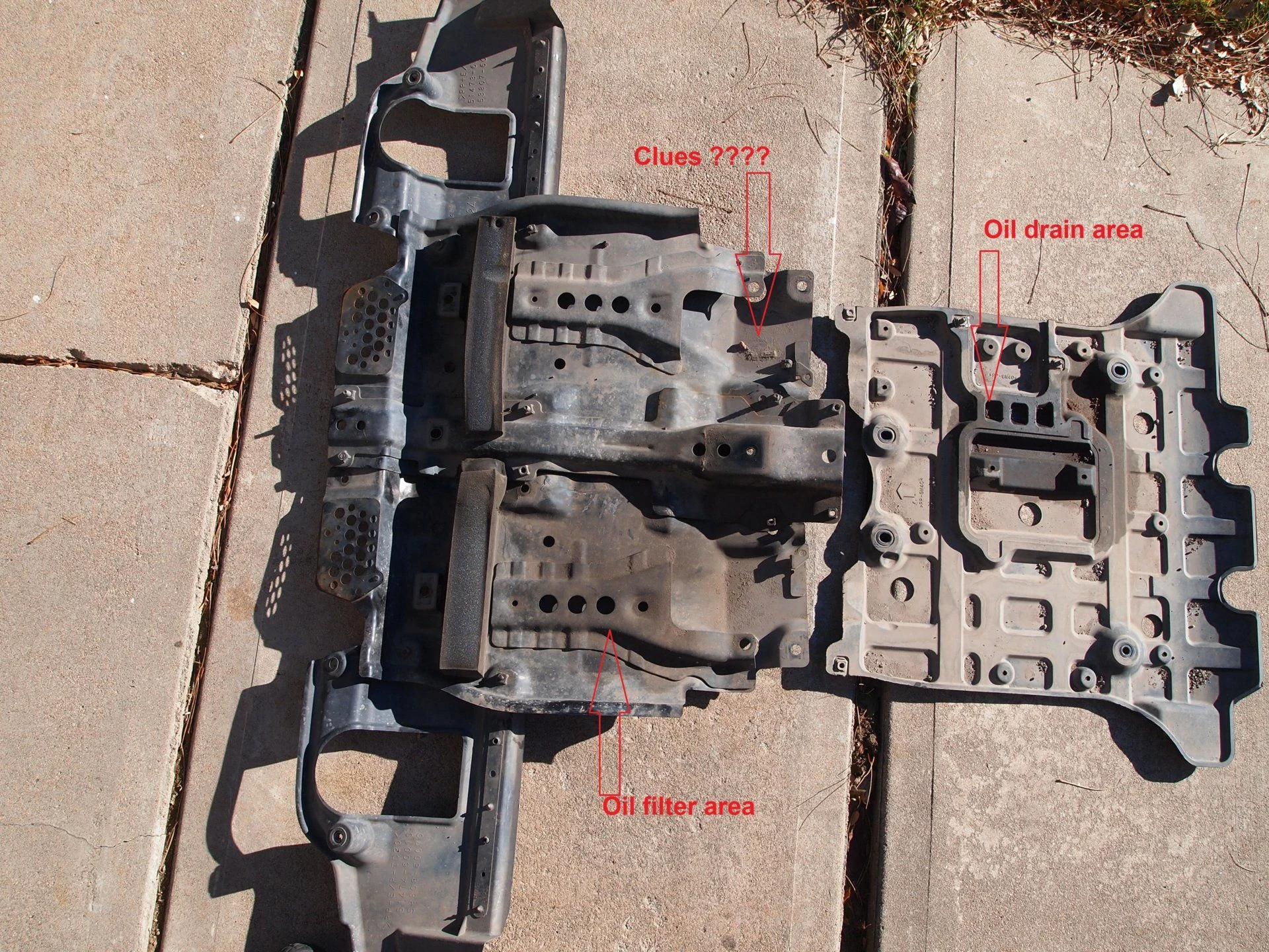

I found a missing bolt and a few none OEM bolts holding on skid plate(s) shielding. I'm thinking as I pull these covers "I saw nothing in history to indicate shield would have needed pulling". Then I realized I did not see an oil filter hatch. This means Toyota took out one of my favorite things, the filter hatch. Then i realized why bolt issues. They have three or four different bolts for shielding up front. So no wonder the missing and none OEM bolts. Thanks Toyota engineers for making :bang: easy difficult. Really please put back the hatch, even Dealer shops will mess this up area up.
While shooting undercarriage I inspect shielding (skid plate(s) & #2), for signs of fluid leaks. This gives clues to backup service history, PPI and possible leaks.
Above clue is below dipstick tube, more than a drop would produce from checking level.????

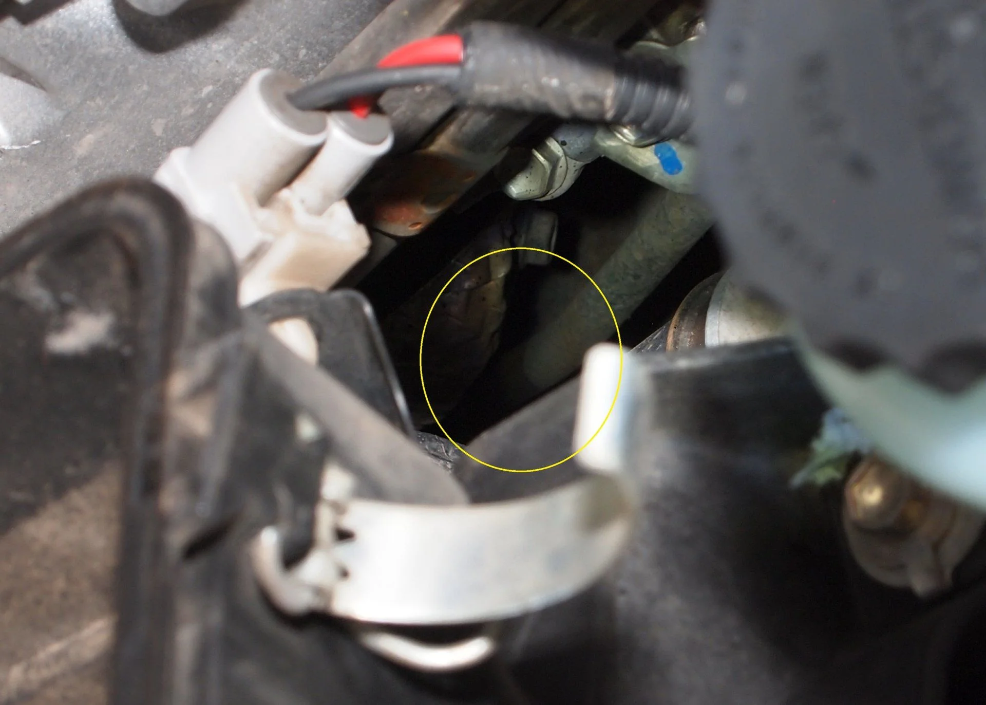

I mentioned early I saw something on dipstick tube. Looks like a dipstick tube O-ring leak, which I've easy way to spot now. I found this on every 06-07 100 series. I'll clean up and confirm, but I'm 90% sure on this one.
Could not a good picture (camera angle) from underside, where tube enters pan. But could see more build up oily grim by looking. This is often wrongly diagnosed as and oil pan leak in the 2UZ.
From Capillary action oil follows up the outside dipstick tube. Capillary action is why we check oil after warming engine and letting set for 5 minimum to 30 maximum minutes.

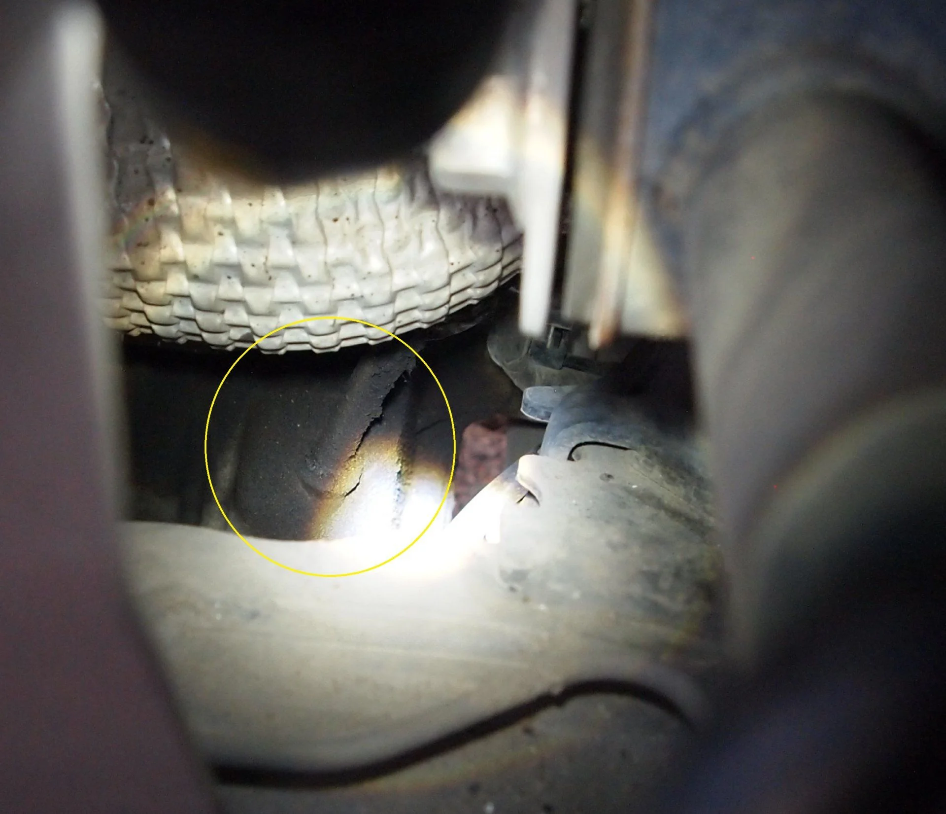

Through PS fender wheel well it was easiest to see and shoot where oil tube enters the pan. Why a 200K miles 98-02 2UZ didn't leak here and newer years do, I can only guess.

The dipstick was first noted during PPI as discoloration about half way down the dipstick tube. Kinda like a shadow seen with flashlight on it when no shadow was cast.
