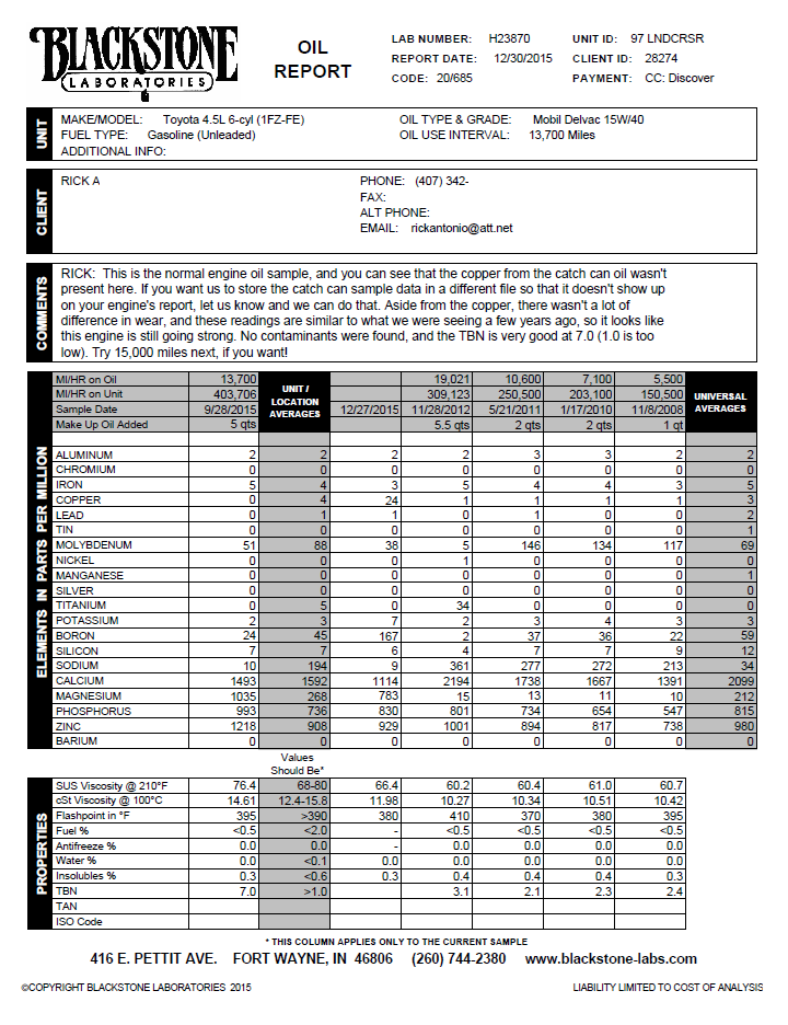

A bunch of mine (engine, trans, front diff and catch can)

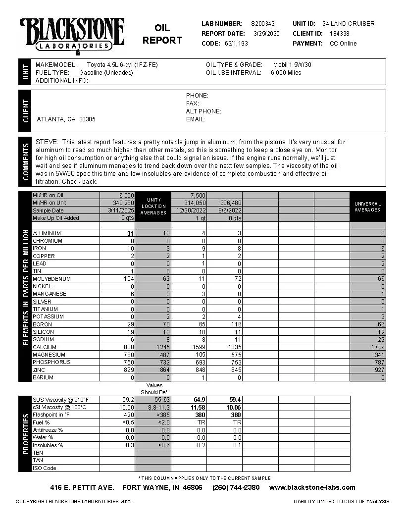

Here's my latest report. I plan to send a sample with each oil change for a while to see if the aluminum numbers come down. I'm not sure what may have caused that issue, but I have been using the truck a lot more - and probably pushing it pretty hard on the highway.
Whats your Guess on Source of Aluminum?

I am not sure the cause or source of the aluminum (Blackstone says pistons) but I plan to shorten the oil change interval and also change my air filter to make sure I'm not sucking in any abrasives.
Did you recently change brand, viscosity ,or type of oil?
I have consistently used Mobil 1 5/40 when I change the oil, but sometimes I buy the high mileage one, sometimes not. A couple oil changes ago I used Valvoline at a quicky lube near Glacier National Park in the middle of a giant road trip. I can't imagine changing brands would make that much of a difference, but that may be? One thing I need to verify is the 6,000 miles on that oil. I am 92% sure that's correct but the interval may have been longer.
I ask because the molybdenum, calcium, and magnesium have drastically different levels from previous samples. You didn't add any oil between, so that didn't change things.
The only place aluminum of that level can come from is the pistons. Have you been running hard, high RPM? If so, you may be getting some skirt slap. It's important that you keep your change intervals so the viscosity doesn't drop off. If you had been doing a lot of in town driving, then got on the open road before an oil change, the viscosity may be low to start, causing the issue. Then as the fuel burns out of the oil, the viscosity recovers a bit for the rest of the drive.
Definitely watch it and maybe shorten the interval on the oil changes.
The Valvoline will definitely have different additives than the Mobil 1.
