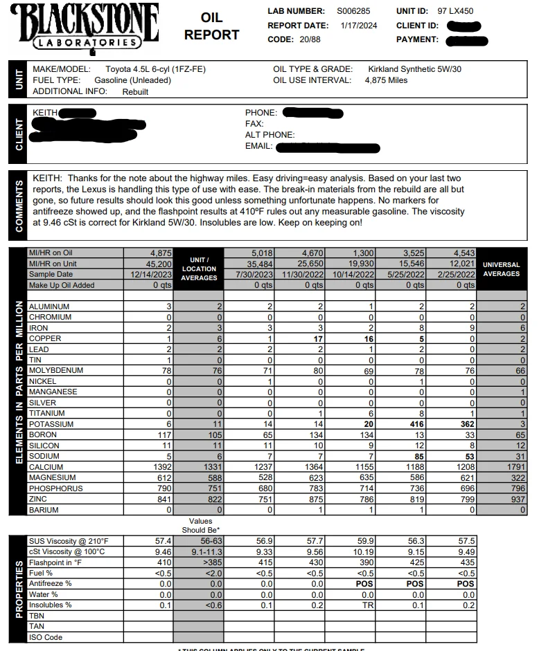

Anyone know what the "Flashpoint" property means? This is my third report, but the first on an interval of more than 500 or 1000 miles post-rebuild. I'm planning on 5,000 mile intervals from here on out.
Edited to add JPG.

Please post a .jpg of your report, so we don't have to all download it.
Flashpoint is related to amount of fuel in the oil as well as how much of certain compounds are still in it.
@truthdetector
"Technically speaking, the flashpoint is the lowest temperature at which a liquid will generate sufficient vapor to flash (ignite) when exposed to a source of ignition or fire. In other words, at what temperature do the vapors coming off your oil catch fire? For most gasoline oil samples, it’s around 380°F. For most diesel samples, it’s about 410°F."

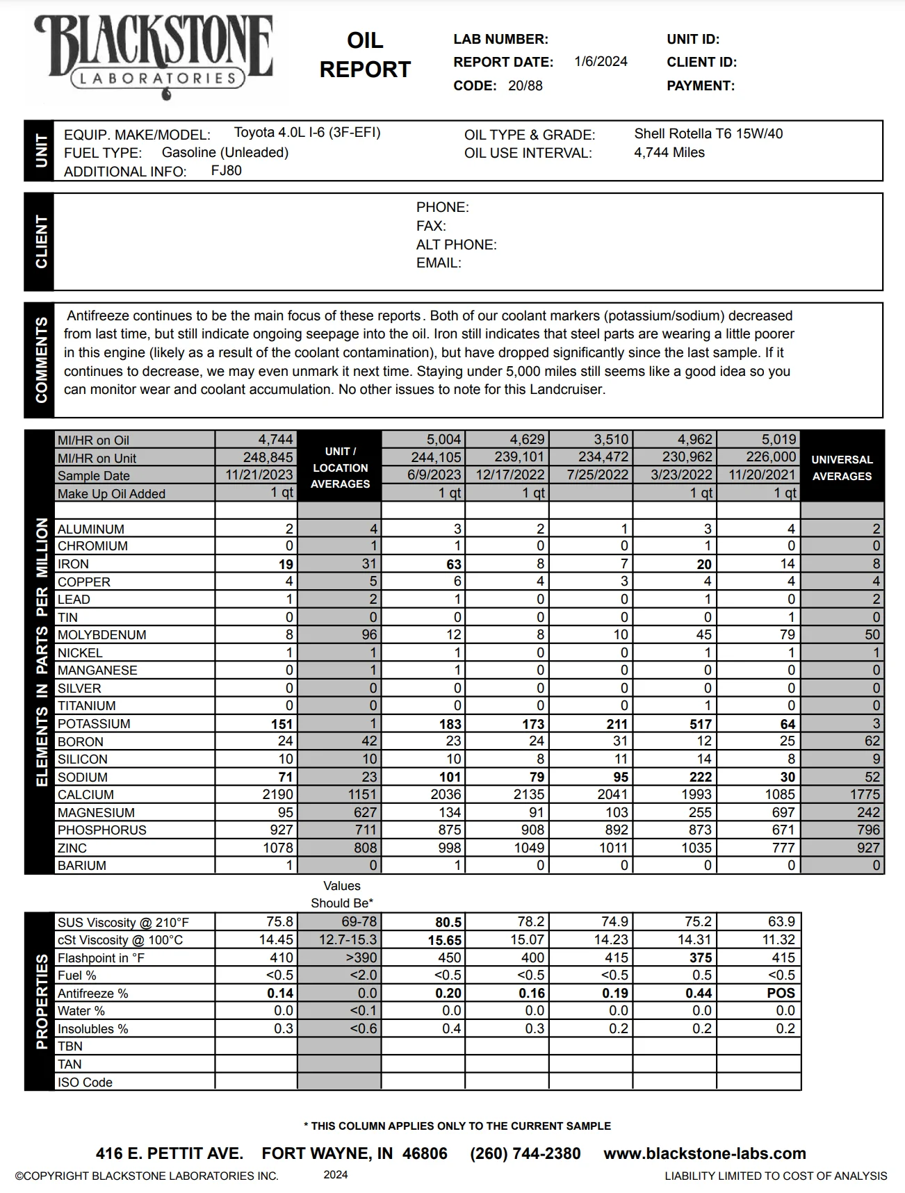

Report for last oil change finally came in. This consistent antifreeze contamination funny business is bugging me. Interesting as sometimes it's pretty high and sometimes it acts like it's going to decrease to unproblematic territory. Any ideas?

A thought...
I had a small amount of coolant leaking into the oil following a complete rebuild. Frustrating. Turned out to be the oil cooler. I replaced it with the cover, problem solved.
Head gasket???
Fingers crossed 'fer ya

I am leaning towards oil cooler. Head gasket leak test yields nothing. How would I diagnose oil cooler issue? Or should i just throw parts at it

not really sure how to troubleshoot the problem, unless of course you take it off and it's really obvious - that's doubtful. The amount of loss is likely drip drip. There are some seals and O rings which could all be replaced. I had enough frustration, so I ordered one from an online source; to end the problem. My next step was to replace the cylinder head :bang:

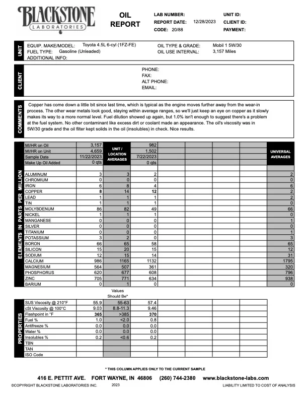

Have an updated Blackstone report. The oil use interval should actually be 1,689 miles. This motor was pulled by Onur before Christmas and a new one is going in shortly. Motor ran fine (not the reason for the new motor), but they called out copper is elevated. Not sure if that is concerning or not :meh:

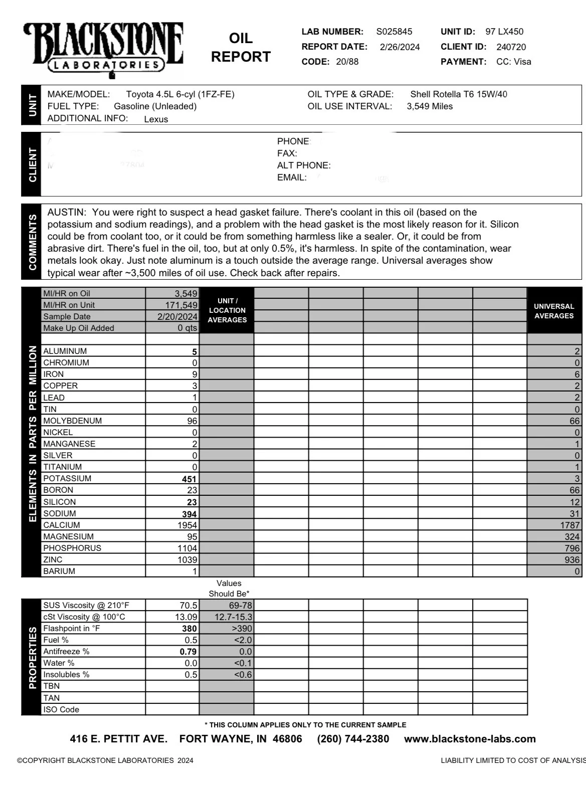

First blackstone report on my 170k lx450. Confirmed my HG failure but wanted to make sure bottom end was good before tearing into it. Going to replace HG and refresh the entire cooling system and hopefully all is well again.

Are you aware you have posted all your personal info?
If you read above, there's a way to remove it before you post it.
Watch that overflow tank, when I noticed that mine was slowly dropping I knew I had a problem. My truck was running fine but it was time for the HG. I never had temp issues, say anything above low 200's, so I think it just finally gave in at 238,500

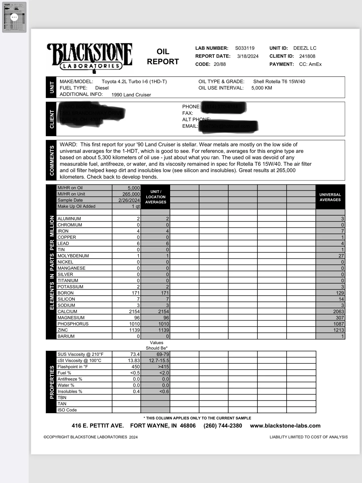

First Blackstone Labs report just came back. Shell Rotela T6 15w-40. Second oil change so far. Would changing the OEM filter every other oil change make any difference?
Didn't you read the third from last sentence explaining why you had good results? A filter cost is less than three gallons or less of fuel. Is that the risk of causing more wear in your engine. As cruiserdan says that's like taking a shower and putting on your dirty underwear back on.
