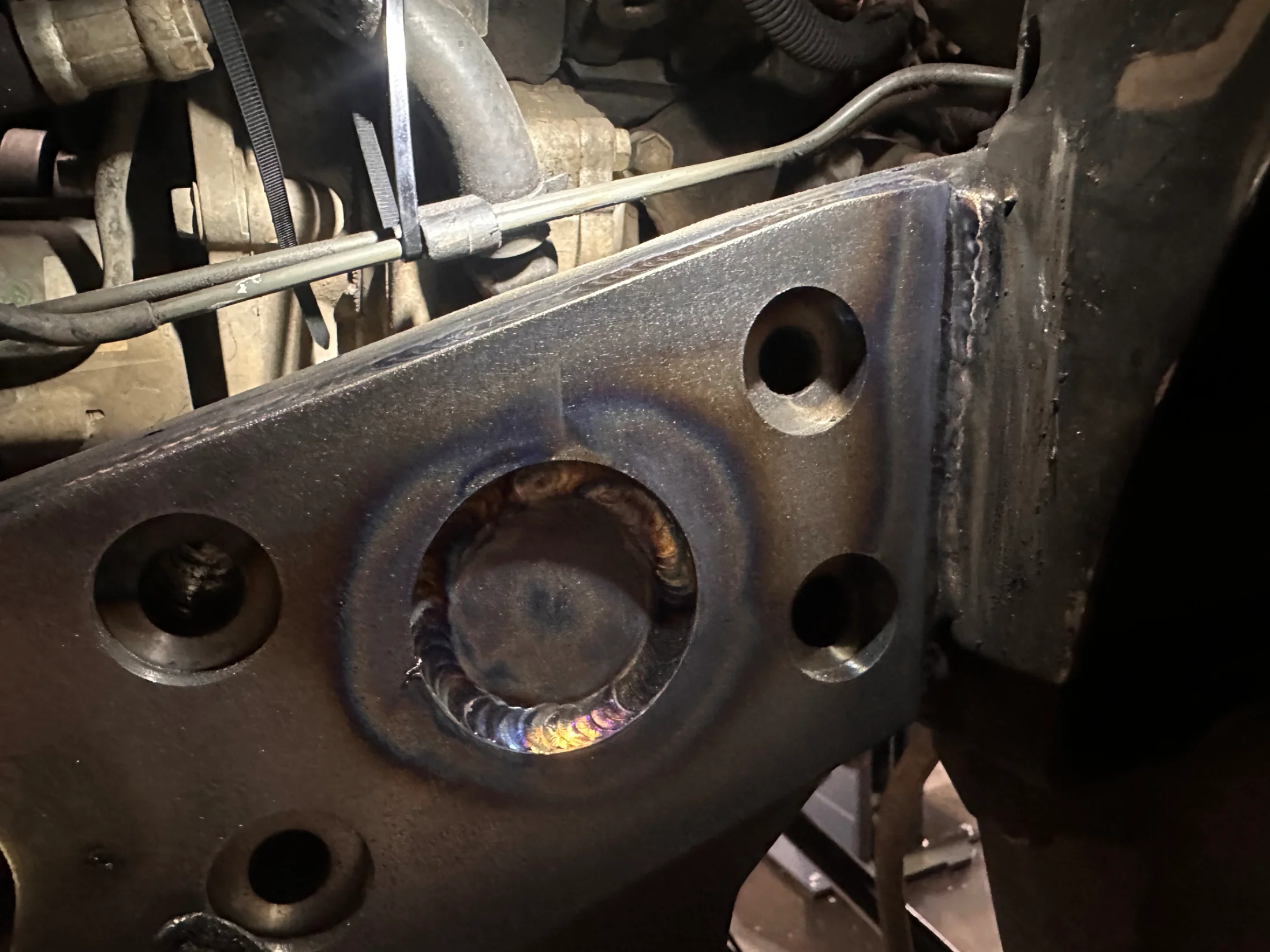

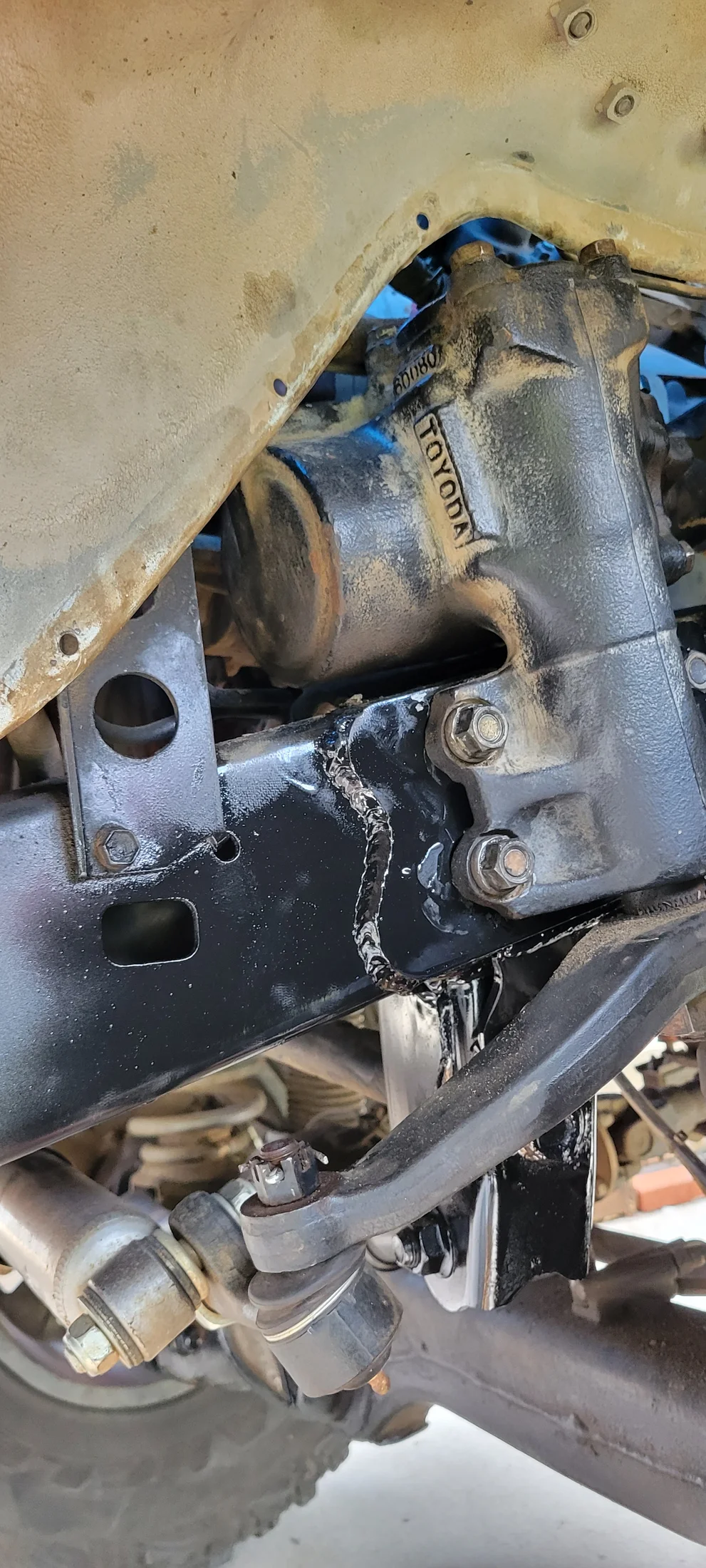

My truck was a pavement princess it's entire life until about three years ago. It's only done two trips on the Rubicon and I don't believe I'm especially rough on the steering system. I've also been fighting a bit of death wobble this past year and I'm now wondering if this is the culprit since everything else under the front end is new.

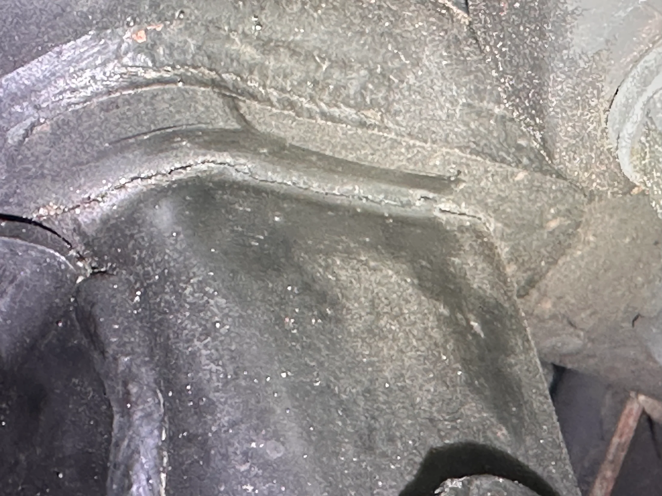

I first noticed this hairline crack while the truck was in the shop for exhaust fabrication.

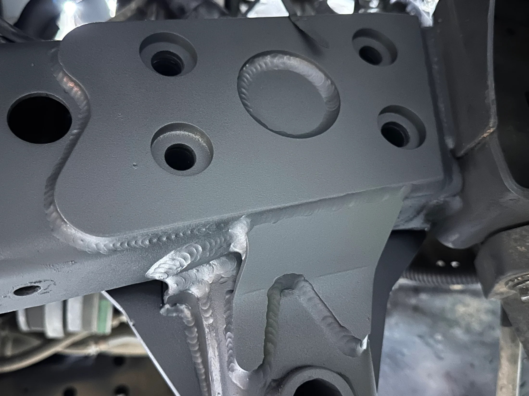

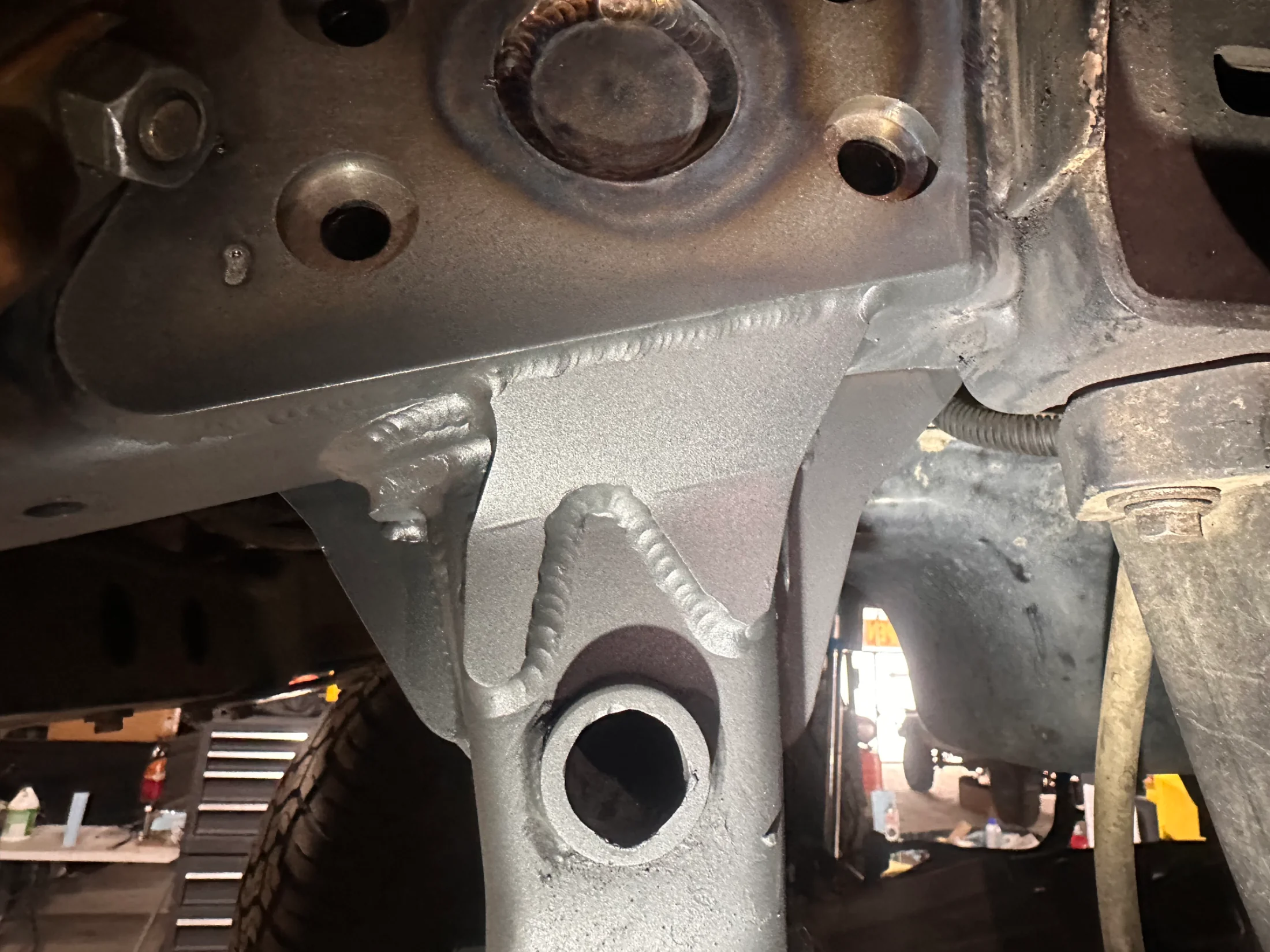

We ground out the crack and put a root weld down while waiting for the DVS frame reinforcement kit to arrive.

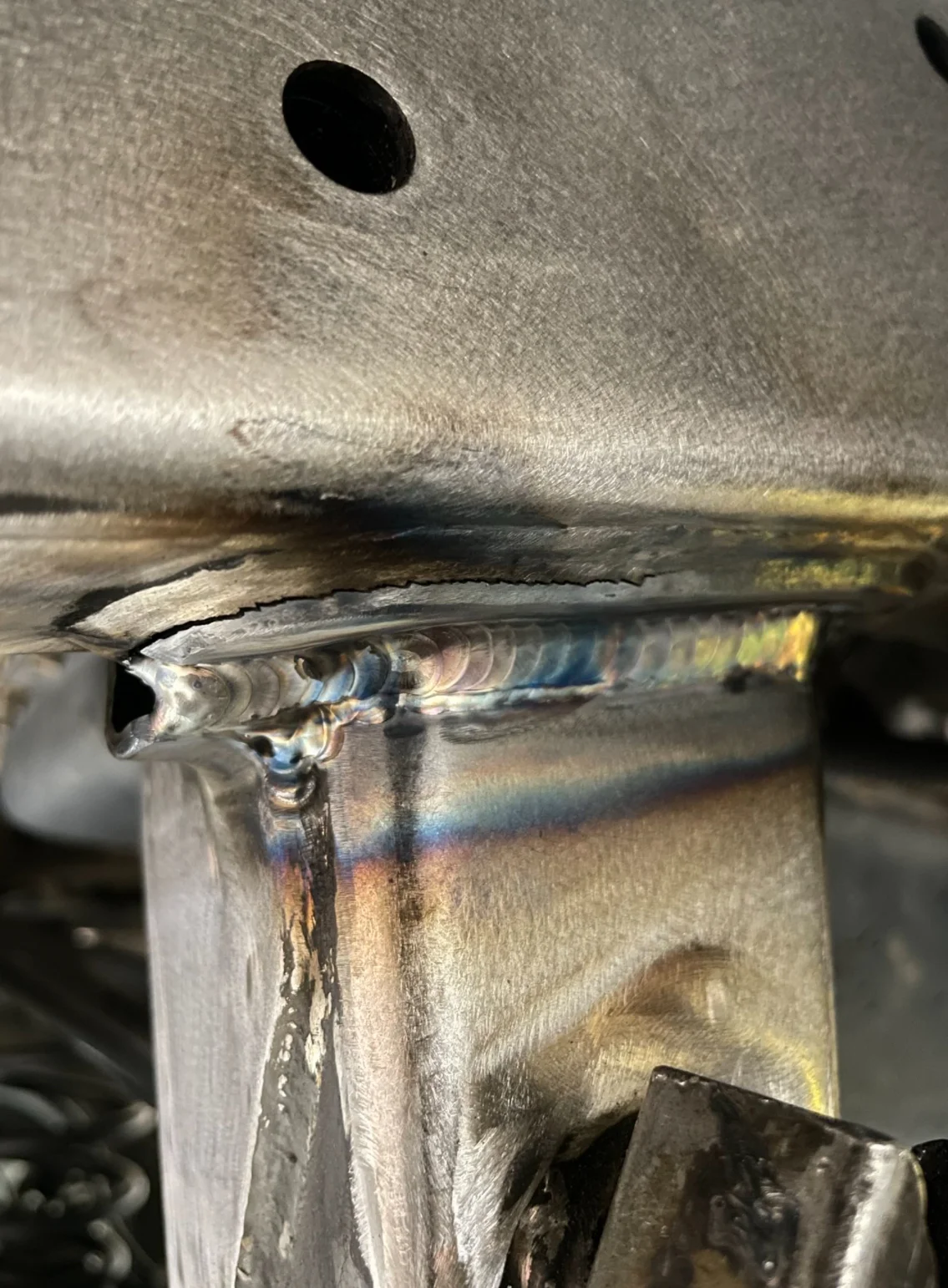

Well, this morning we came in and found this:
I'll bet there was some hairline cracking you weren't seeing.
Are you familiar with "non destructive testing"? One of the easiest methods for the average dude to do is dye-penetrant testing. You can buy the materials at any welding shop and there are YouTube videos on how it's done. There's a bit of a knack to knowing the difference between a crack and something that just trapped some dye in an odd spot, but I think it's worth it for a location like that that has seen 30 years of repeated stress.
Do you really ask the EOD guy if he's familiar with *NON* destructive testing? 😂
I need to check mine. Steering has been wander-y for a while and I’ve been chasing ghosts trying to stop that.

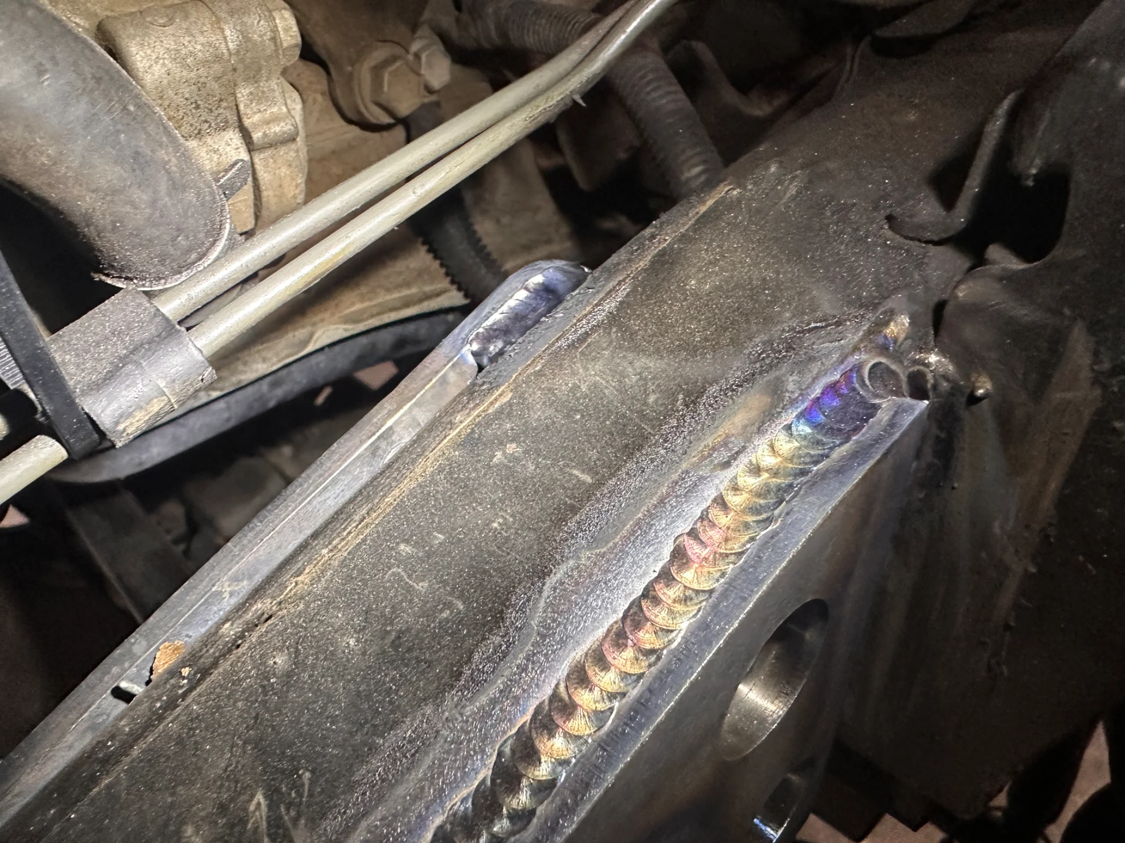

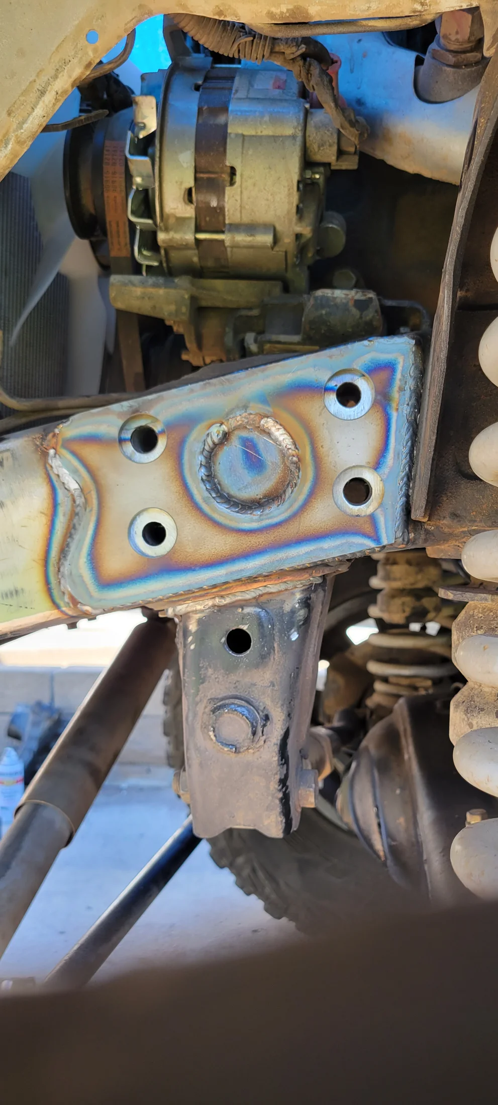

Came here to say exactly what the others said - THAT is the way to do it. That ain't goin nowhere.
Thanks!

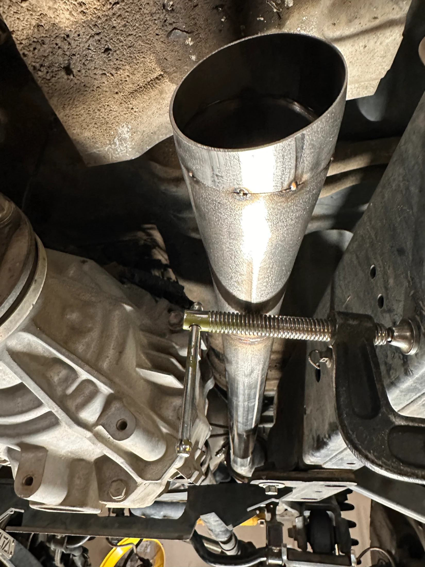

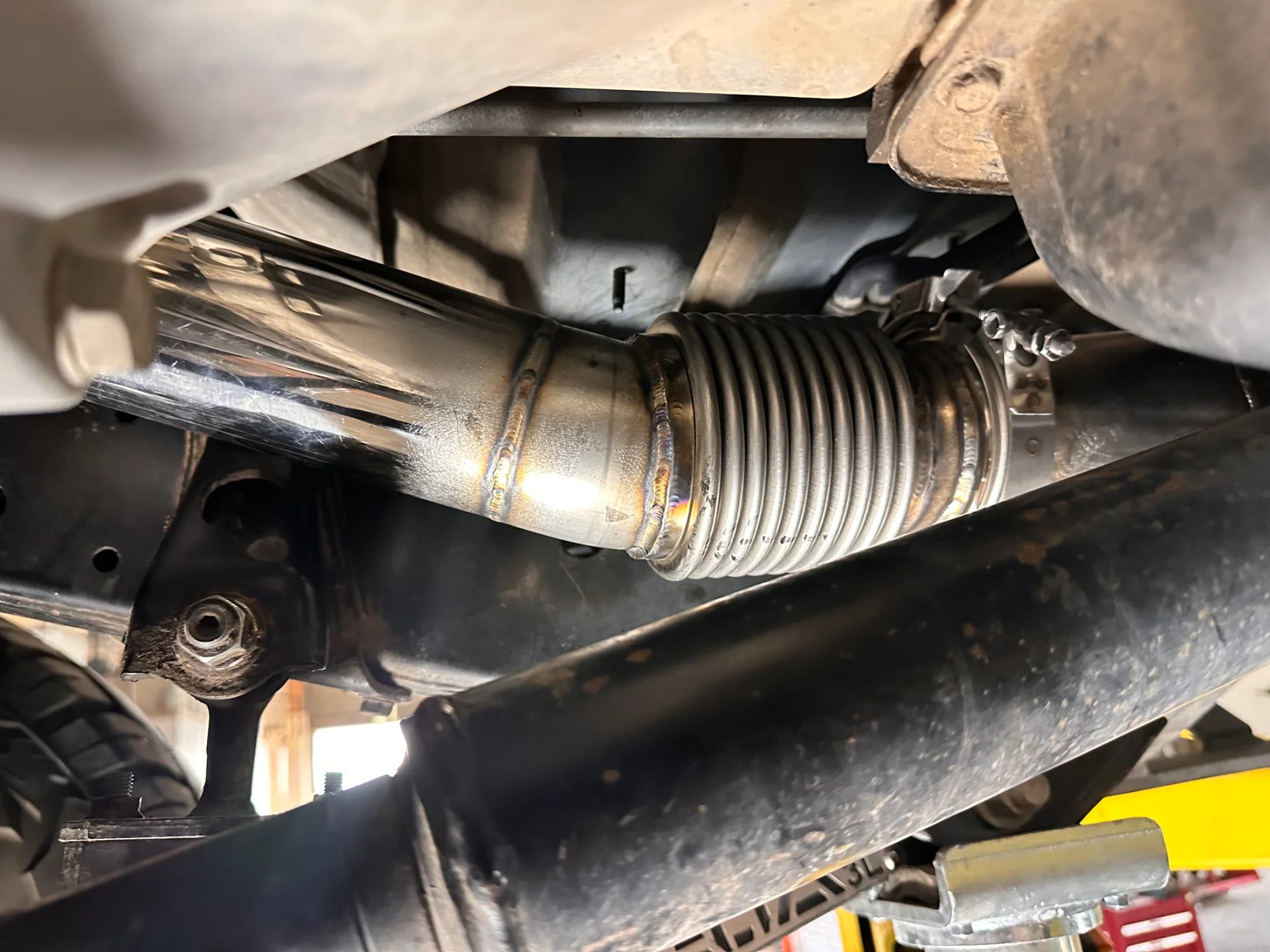

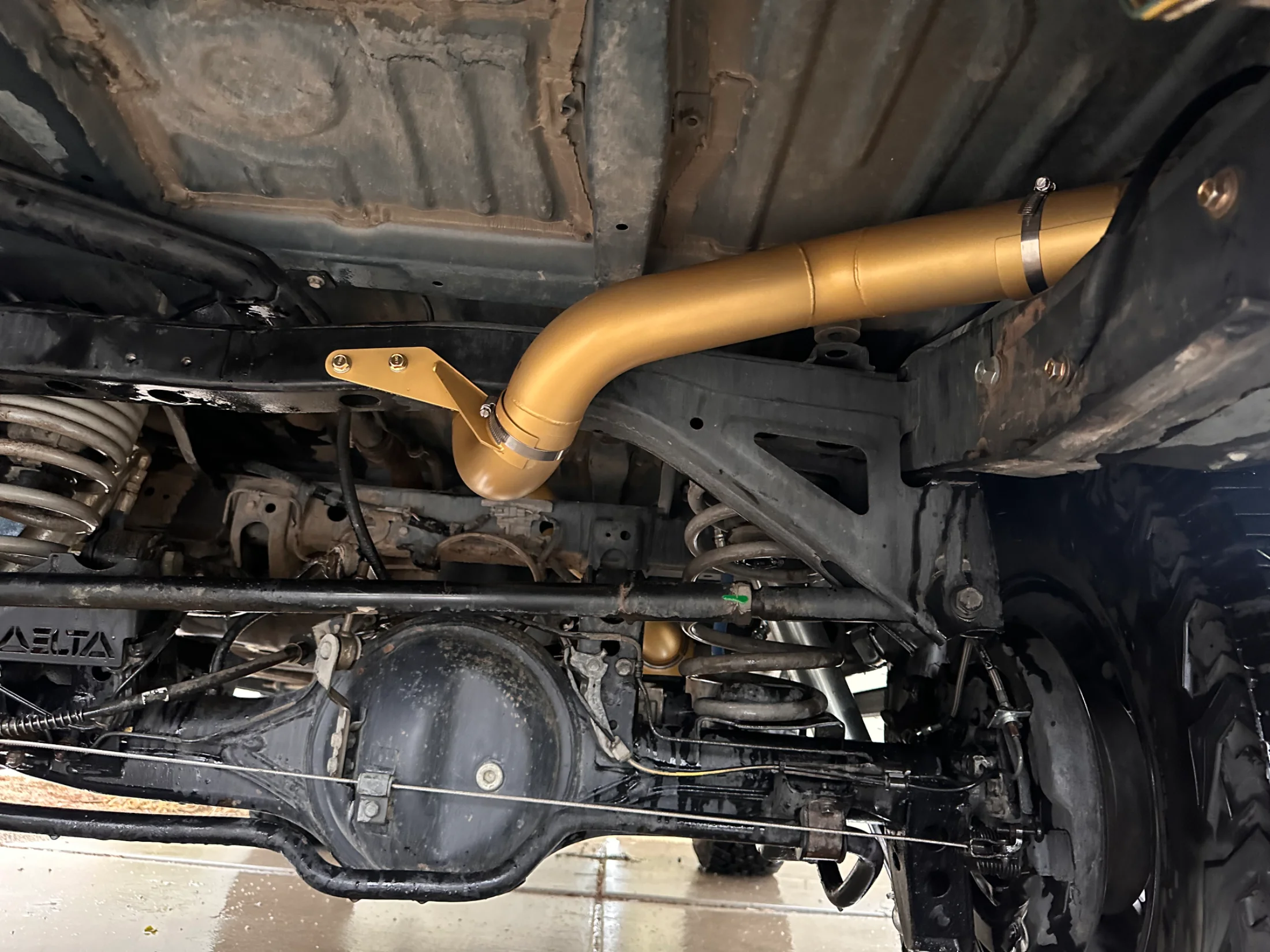

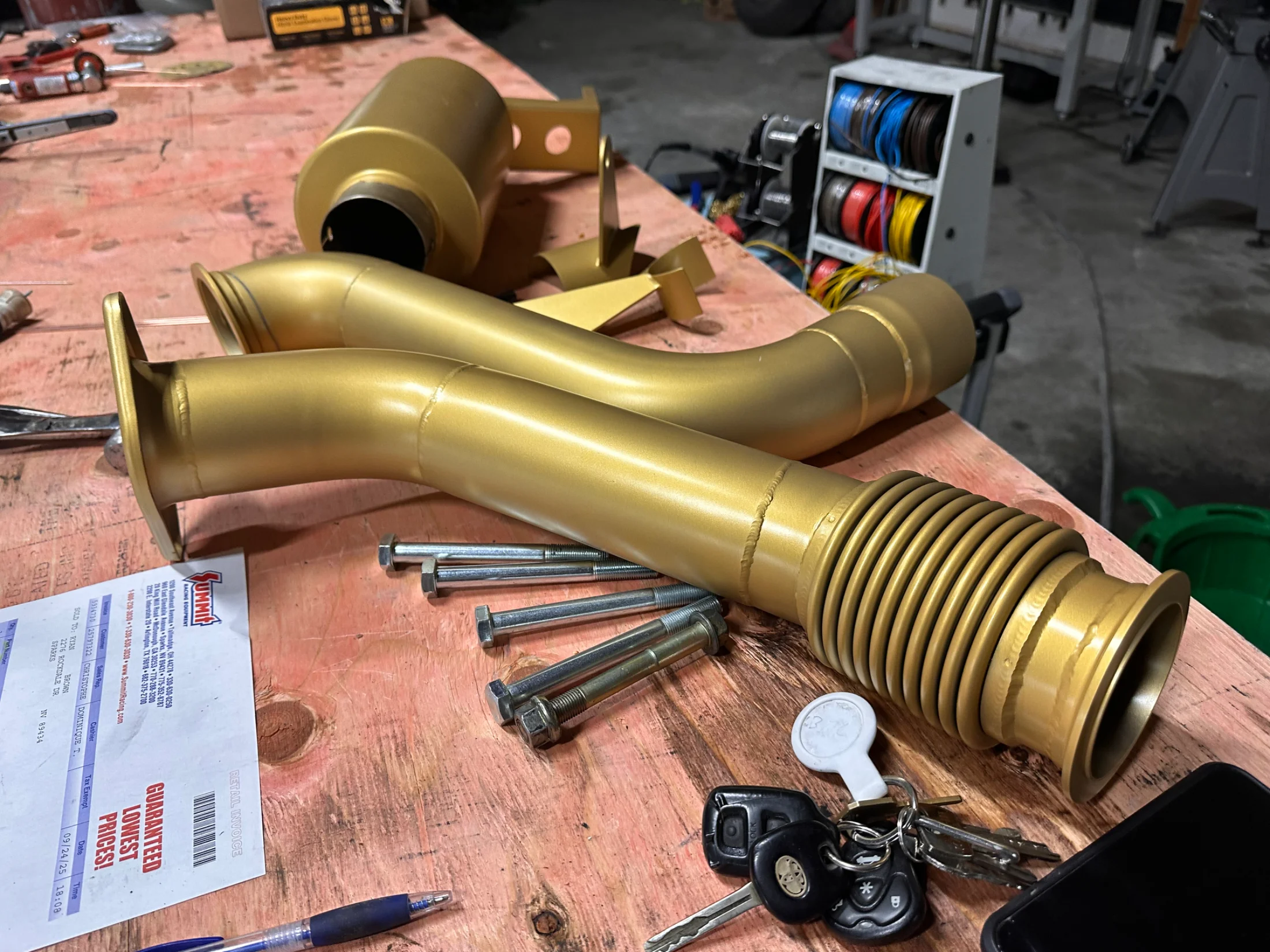

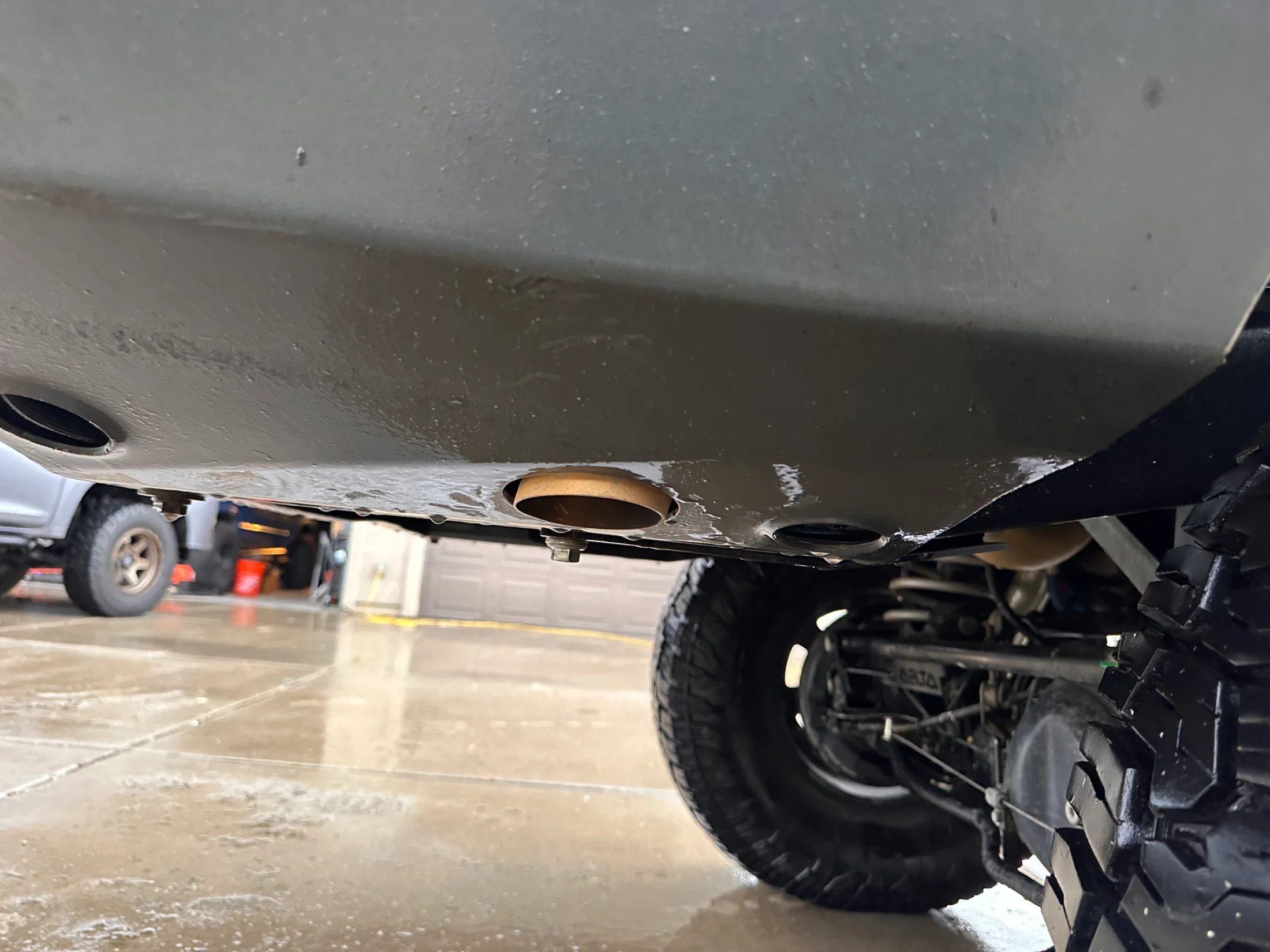

The new exhaust ain't lookin' too bad either!
...especially love the outlet:
Beautiful work. I'm a fan of the gold, and the exit location is bada$$

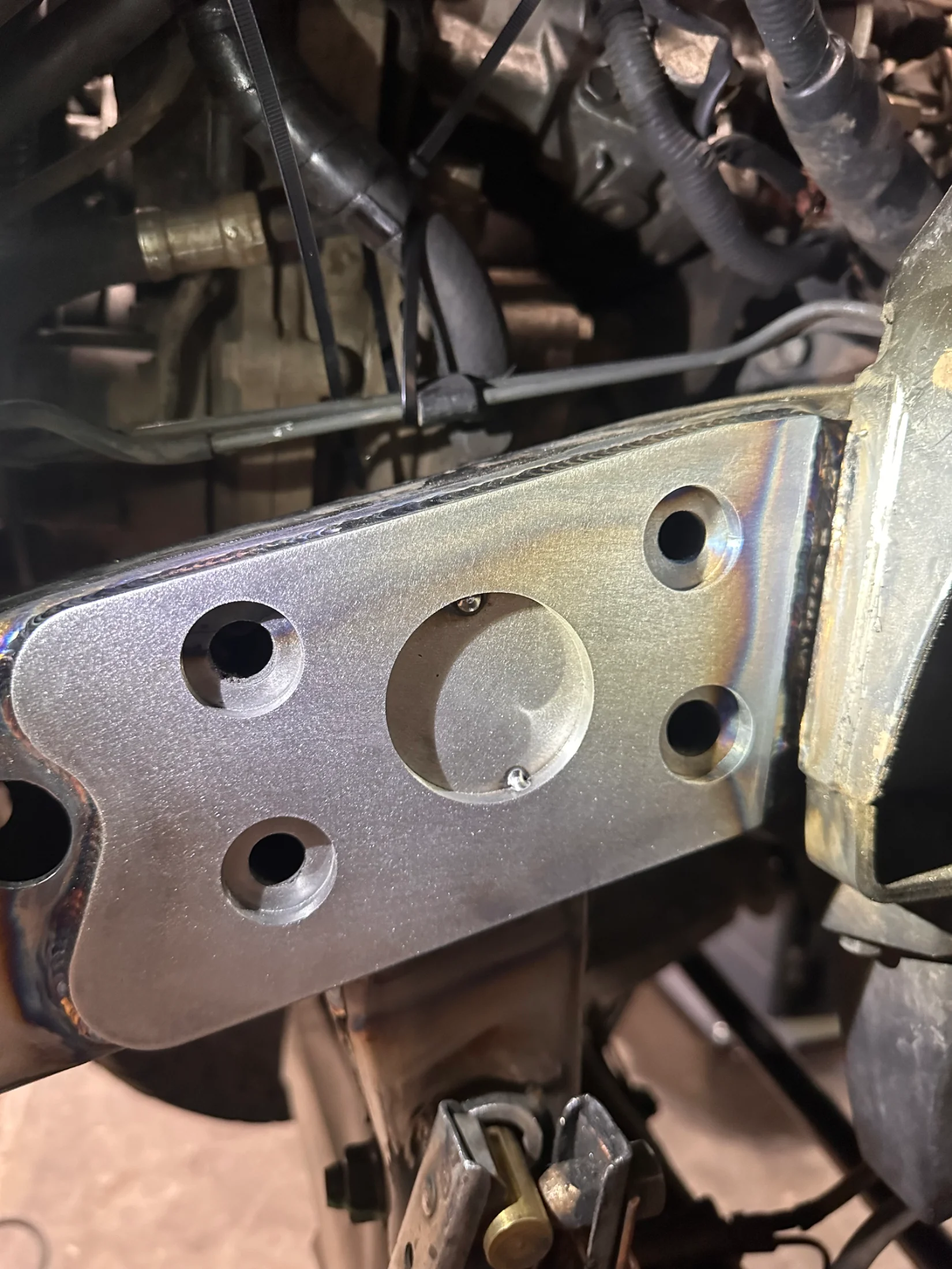

For anyone who's welded the frame reinforcement plates themselves (@lelandEOD ) would you remember which welding setup you used (Miller XXX, Lincoln, ---), Mig, Tig, wire, settings, etc,etc?
