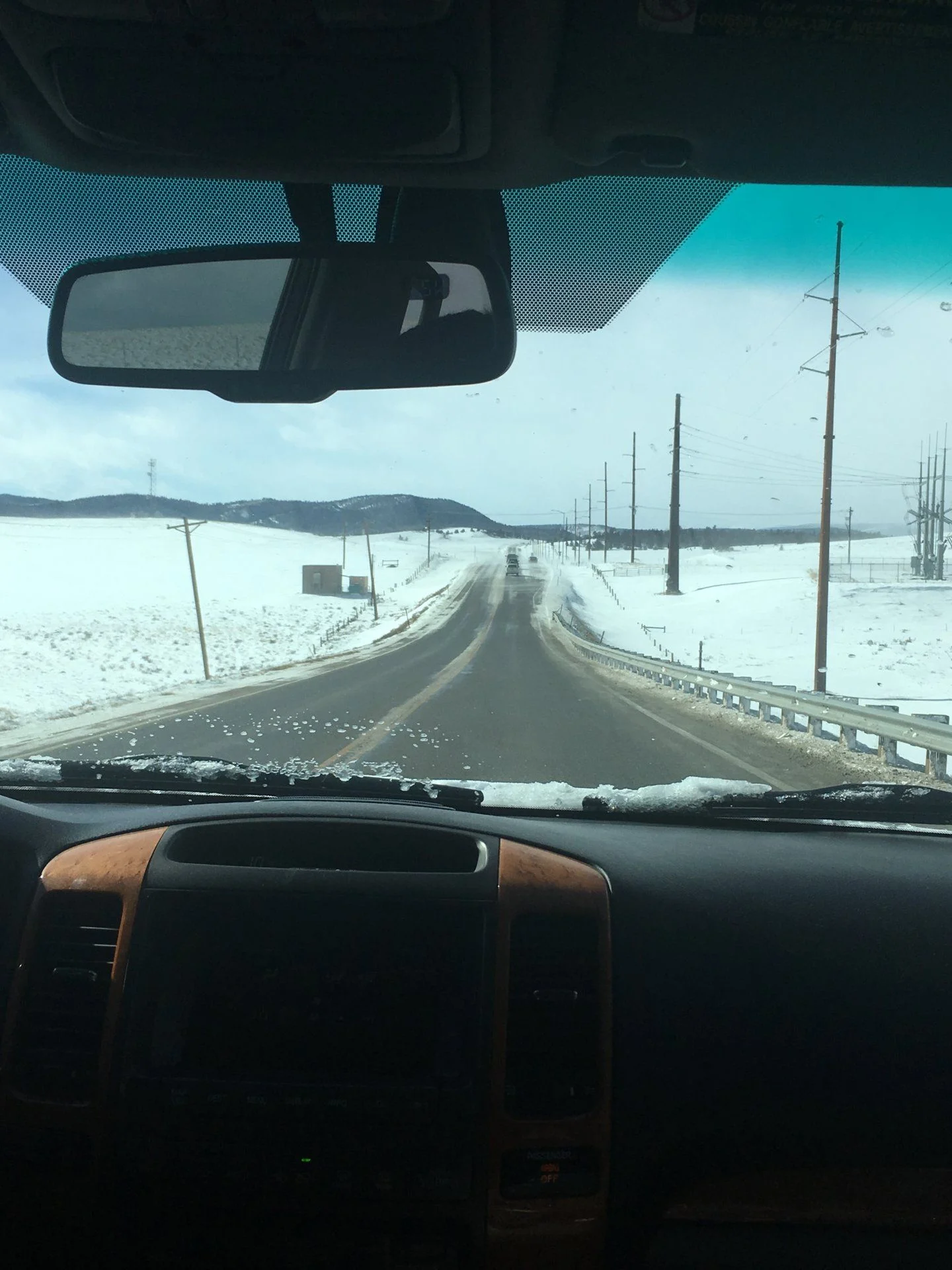

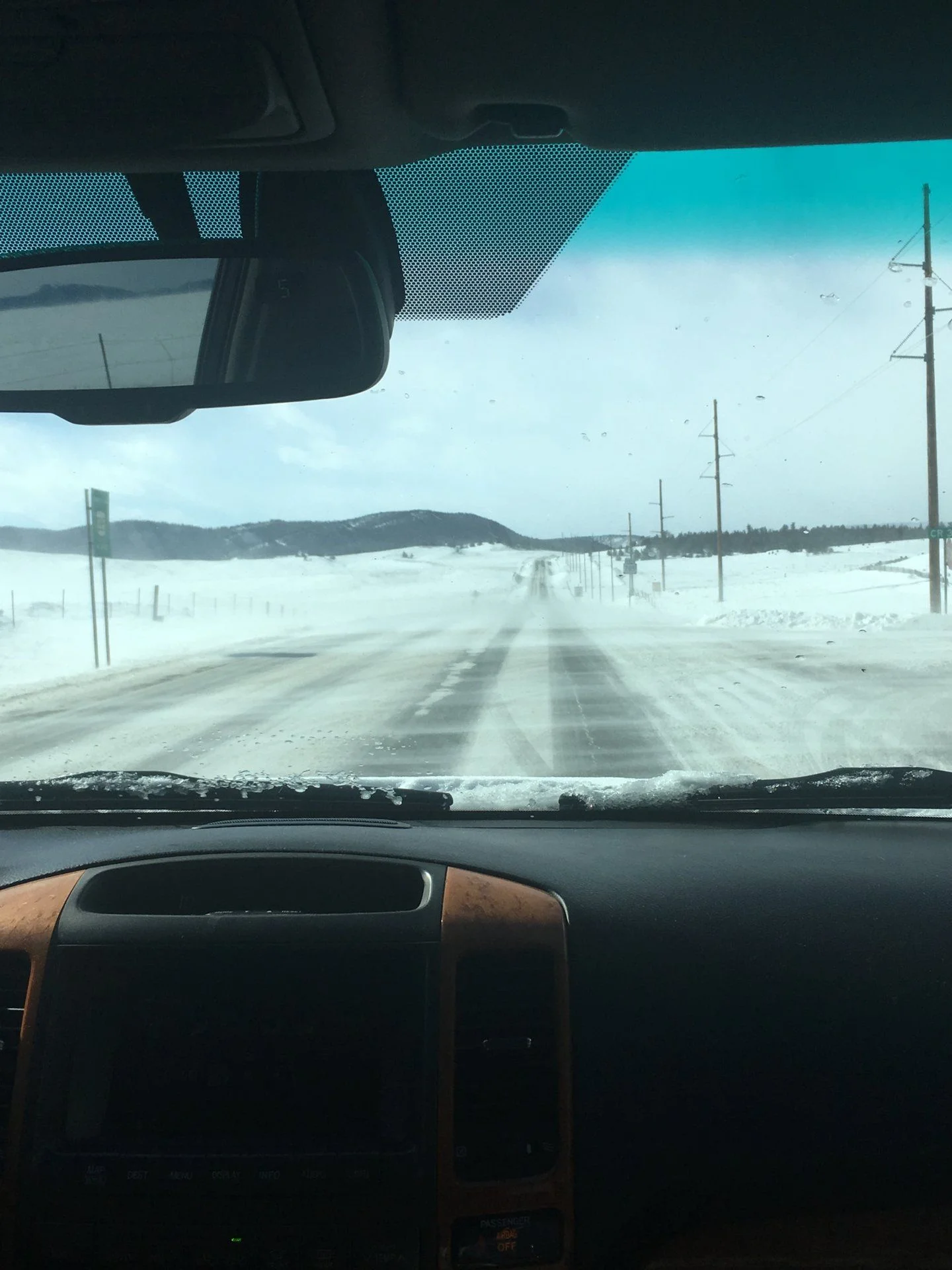

I was just traveling 60mph on paved highway. If I was driving the Cruiser I would not have had the 4WD engaged. Then this....40mph sidewind. What are you gonna do if there is potential to hit slick roads? Drive with CDL locked on curvy paved roads creating high stress and heat in the t-case for many miles, OR pullover at the drop of a hat to lock the CDL or even worse get out and lock the hubs before you even do that? If I had to do the part-time kit again I would think long and hard about it. It's not for everyone!
1899616
1899625
