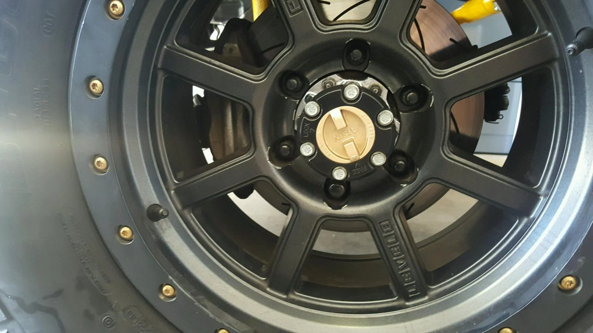

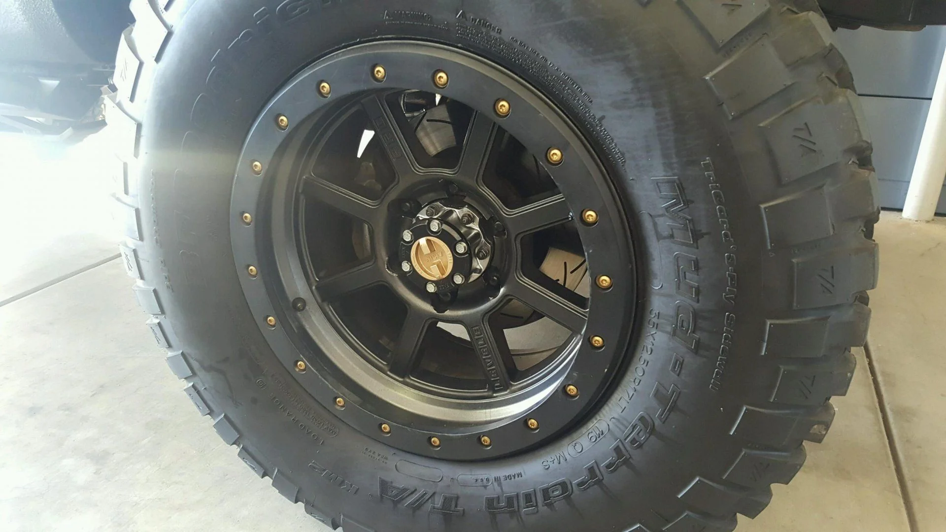

First of all no such thing as a stupid question on this forum. I will give my 2 cents. I am running part time mainly due to the fact that my 80 is lifted 4-5" and I get vibrations running the factory front driveshaft. I believe this is the number one reason to do it. I took the advice of several members and purchased a DC drive shaft for the front prior to my LS swap and that did the trick so I was happy. The DC shaft wont clear my 6L80E transmission pan so I went back to the stock shaft and didn't like the vibration so I decided to go to PT 4WD. THe advantages that I see are....
1) No vibrations unless you engage 4wd which is very rare for me unless out hunting / camping etc..and the vibes only occur at higher speeds.
2) Less wear on the front driveline parts since they are not spinning until the center diff lock switch is engaged and the hubs get locked.
3) Better gas milage (I have not tested but others have)
4) AISIN Gold locking hubs looks bad ass.
5) AISIN locking hubs are cool
6) Chicks dig AISIN Gold locking hubs.
I purchased mine from Cruiser Outfitters. Thanks guys I love them.
