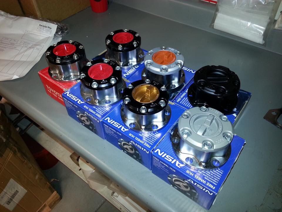

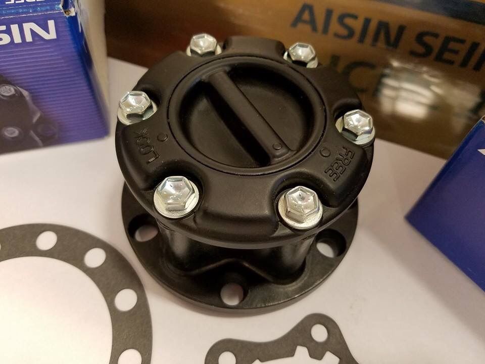

Excuse my ignorance but, what are the differences other than color? What makes the black hubs "HD"?
Great question. Chromoly inner gears and a double seal, paper gasket and o-ring against the hub body. The reality is the chromoly gears can be installed into any of the colors, we just pre-build them in black. They are also available with upgraded hub stud kits.
