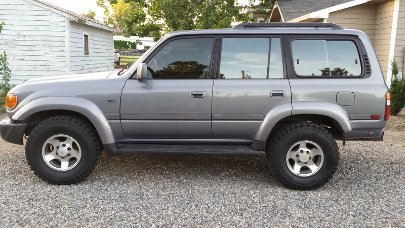

My door jamb says my paint code is 1A6. As far as I can see my paint is original. I ordered that at the local paint supply. Test sprayed a part today and it's not even close to a match. The 1A6 comes out a darker grey color and my cruiser is more like a bluish grey. Looking at this site 1997 Toyota Land Cruiser Colors of Touch Up Paint - https://www.automotivetouchup.com/touch-up-paint/toyota/1997/land-cruiser/
it really looks like my color could be code 1A0. Picture of my cruiser below.
Did the colors related to each code change at some point? I suppose that the shop could have messed up the color mix but I really have no way to confirm that. Honestly based on the web site above it looks like they got it close. At $25+ a can I don't want to buy too many of these to test the color. Any thoughts?

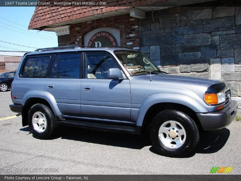

For reference the color I got looks very much like the color of the front bumper on this truck. It's a dark grey like that, not the blue color at all.
The paint color code on the jamb should be the body color; the (contrasting) bumper color was the same for all 95-97, which is not listed anywhere on the body (it's only in a special paint supplement for the body shops, AFAIK); if what you got was the bumper color (or near it) the paint shop screwed up.

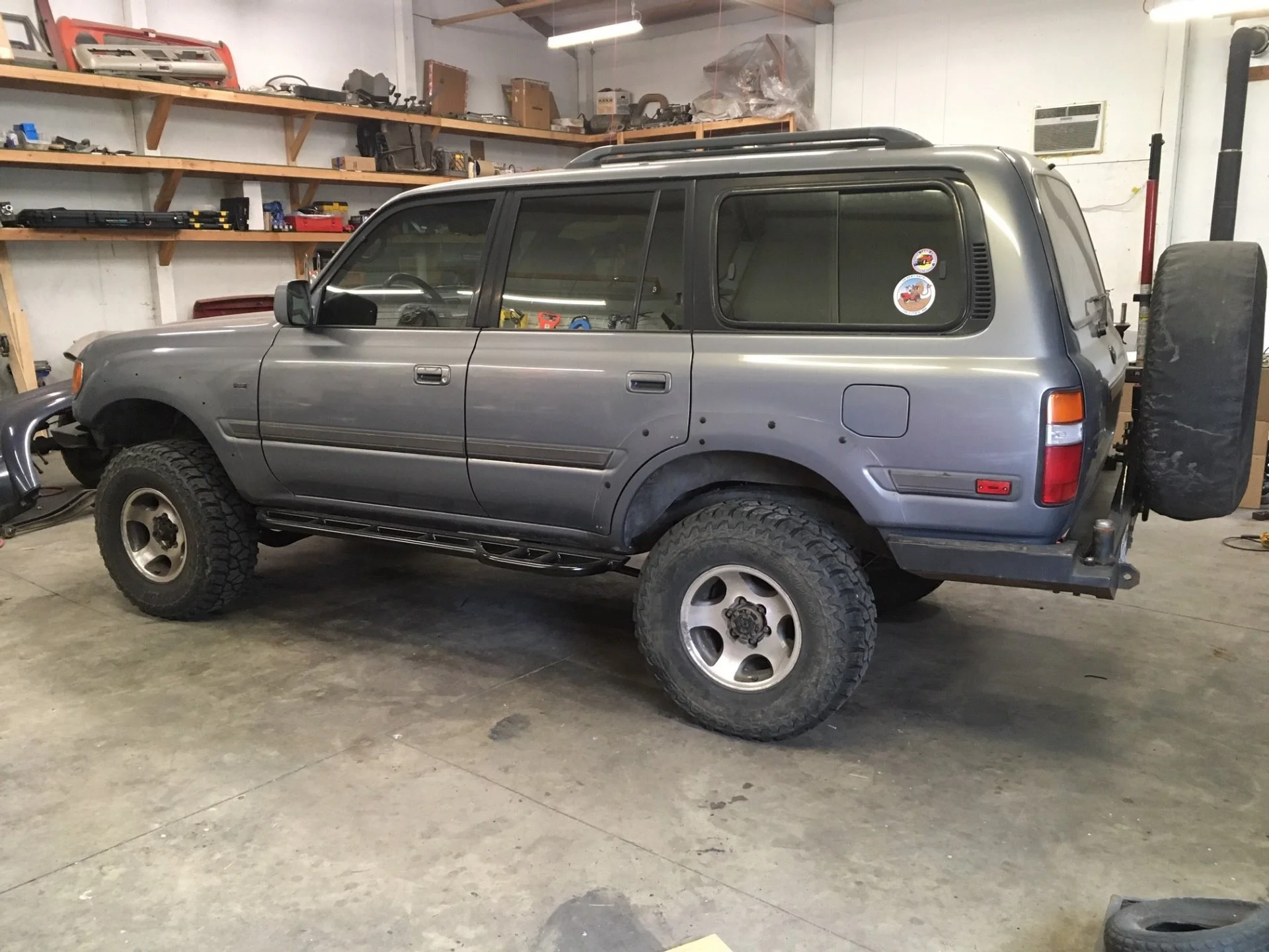

1A6 paint code is 'Moonglow Pearl' and it does spray out a blueish gray. But is subject to appearance in different lights. Here is mine (Moonglow) in bright light and lesser light.
IF mixed properly it should be a pretty close match to 'factory new' paint. But older paint will have faded...so if you are trying to match/blend for spot painting you would need to take the vehicle somewhere where they can computer match the condition of your paint. IF you are going to do a complete respray then settle on what you want and go for it.

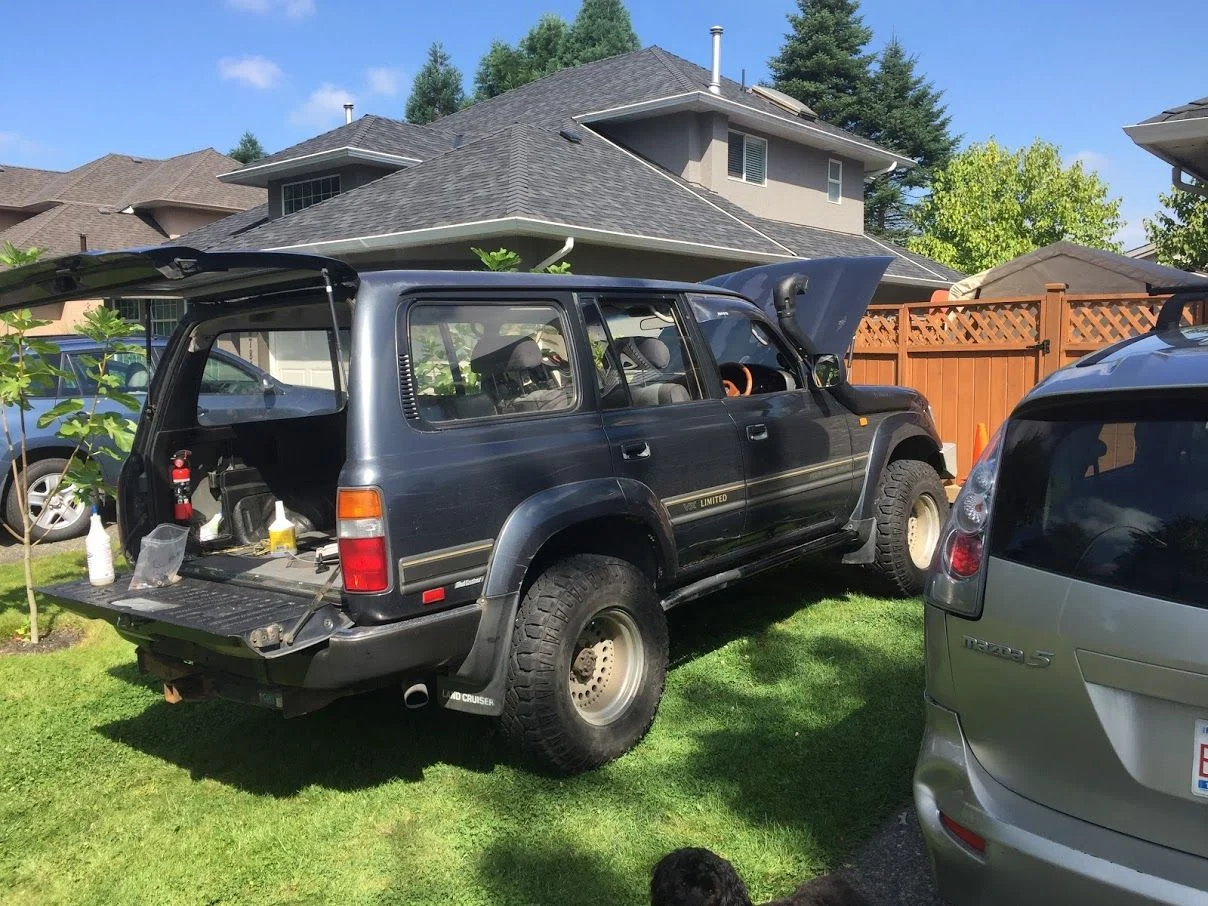

Autotouchup.com rattle caned hood, lower part of front finder and rear quarter panel.
Good from far, far from good but the color match is spot on

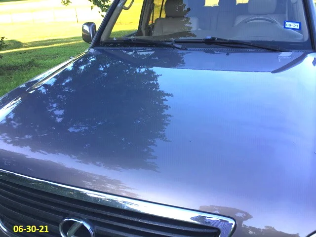

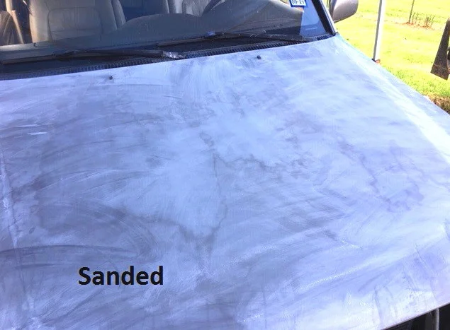

I repainted the hood on my 100 series recently and it was mixed strictly from the paint 'code'. It was also a very difficult color to get right and not an easy one to spray (metal flake), but it was a pretty darn close match to the rest of the vehicle, so it CAN be done.
