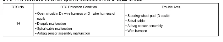

I am not really getting it...why not diagnose the issue behind the code?
There are tests to go through in the FSM for code 14, and none of it involves replacing the airbag ECM.
It is not uncommon to damage the spiral cable if one pulls the steering wheel and then doesn't put it back exactly. There is a procedure in the FSM, with a stern warning, on pulling and replacing the steering wheel.

All that information is in the FSM and EWD. Download free-fer-nothin in the resources section.
