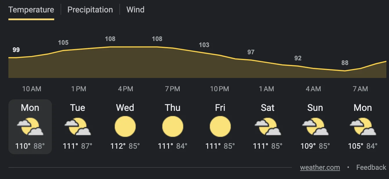

Probably doesn't help that Las Vegas is hotter than the surface of Mercury right now. :)

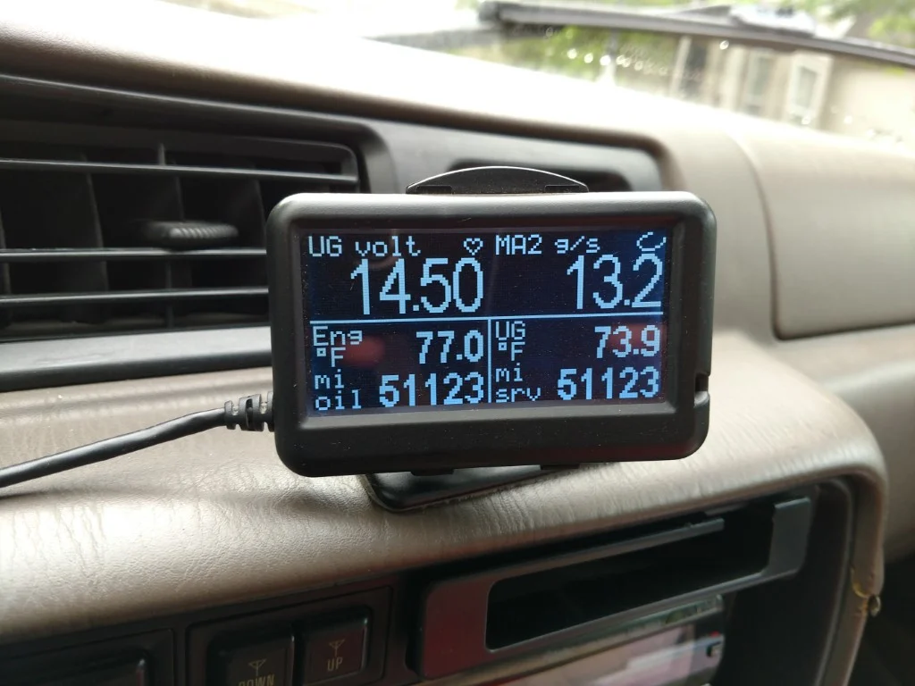

'll add that the built-in dash temp gauge isn't great and is slow to tell you what's going on. It's way better to run an odb2 sender to torque pro or to add a similar temp gauge so that you know what the actual coolant temps are. You can read up on this and may not be able to get a decent gauge in place while on a road trip but it's worth mentioning.
This sounds really cool. I've read a few posts about people doing this. Just need to set aside the time to get this done in Cali. Thank you for the tips!

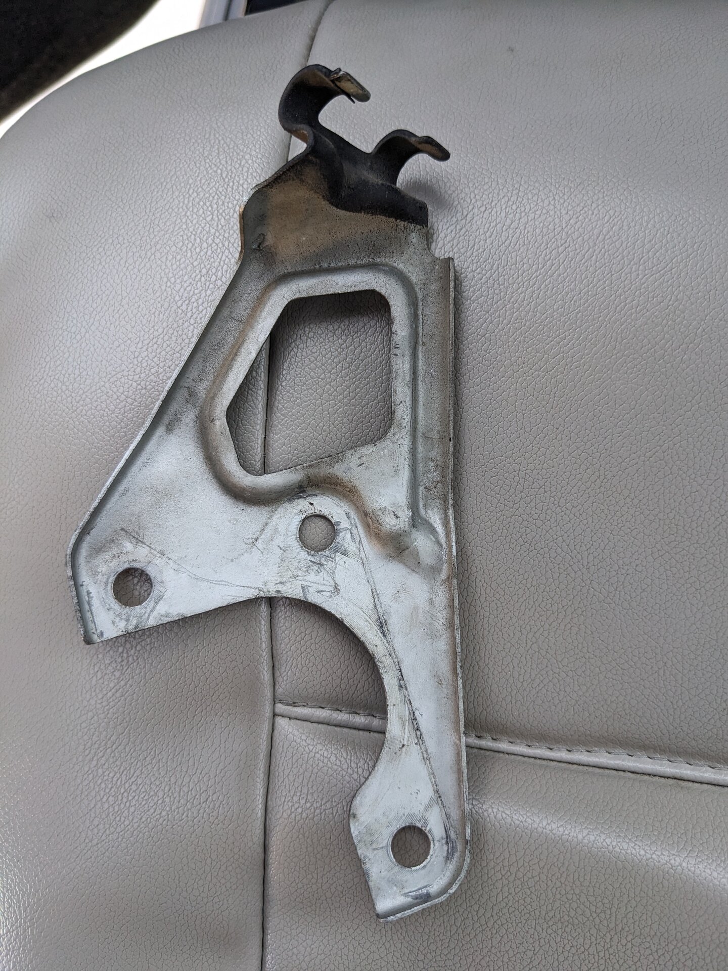

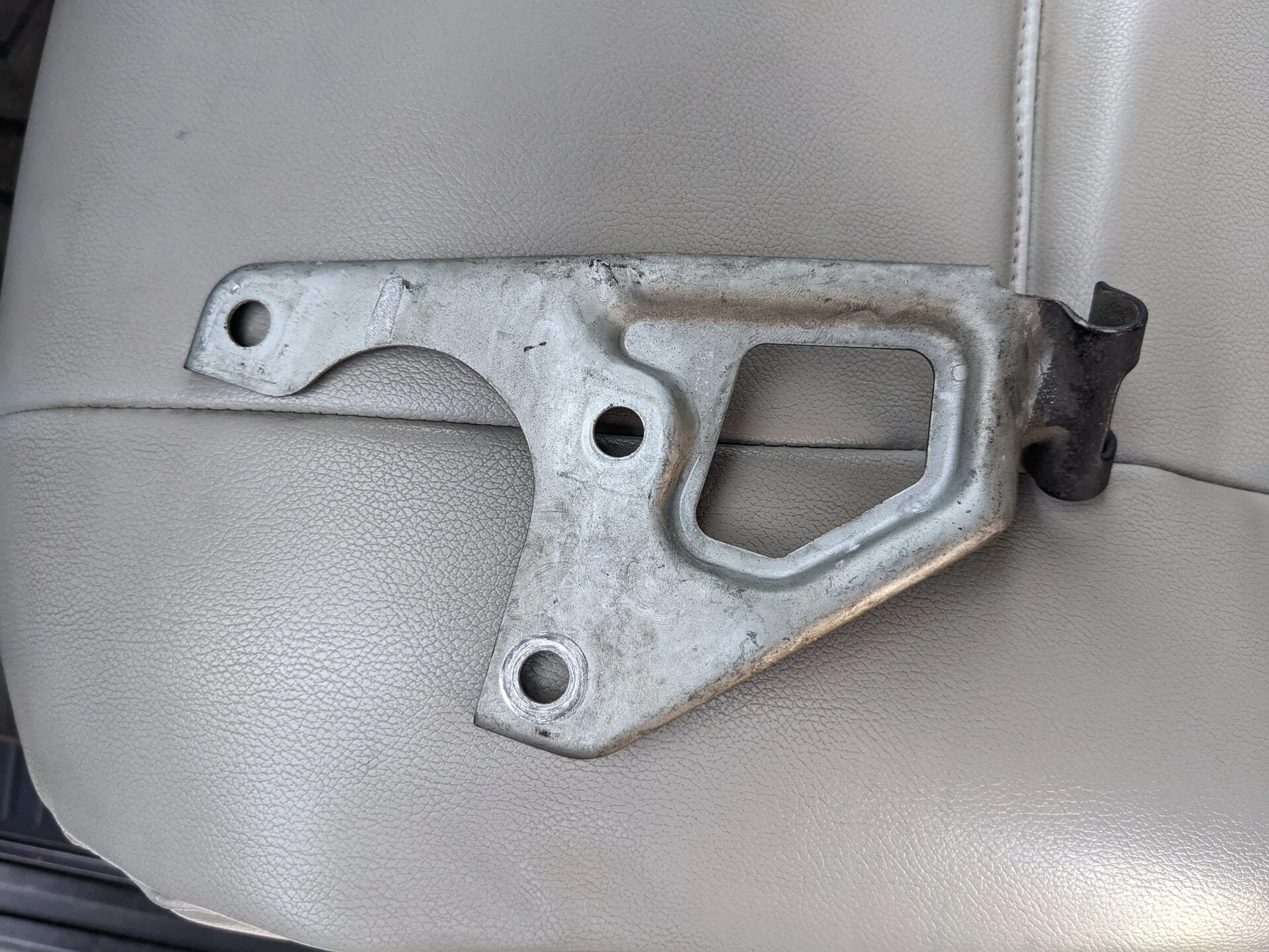

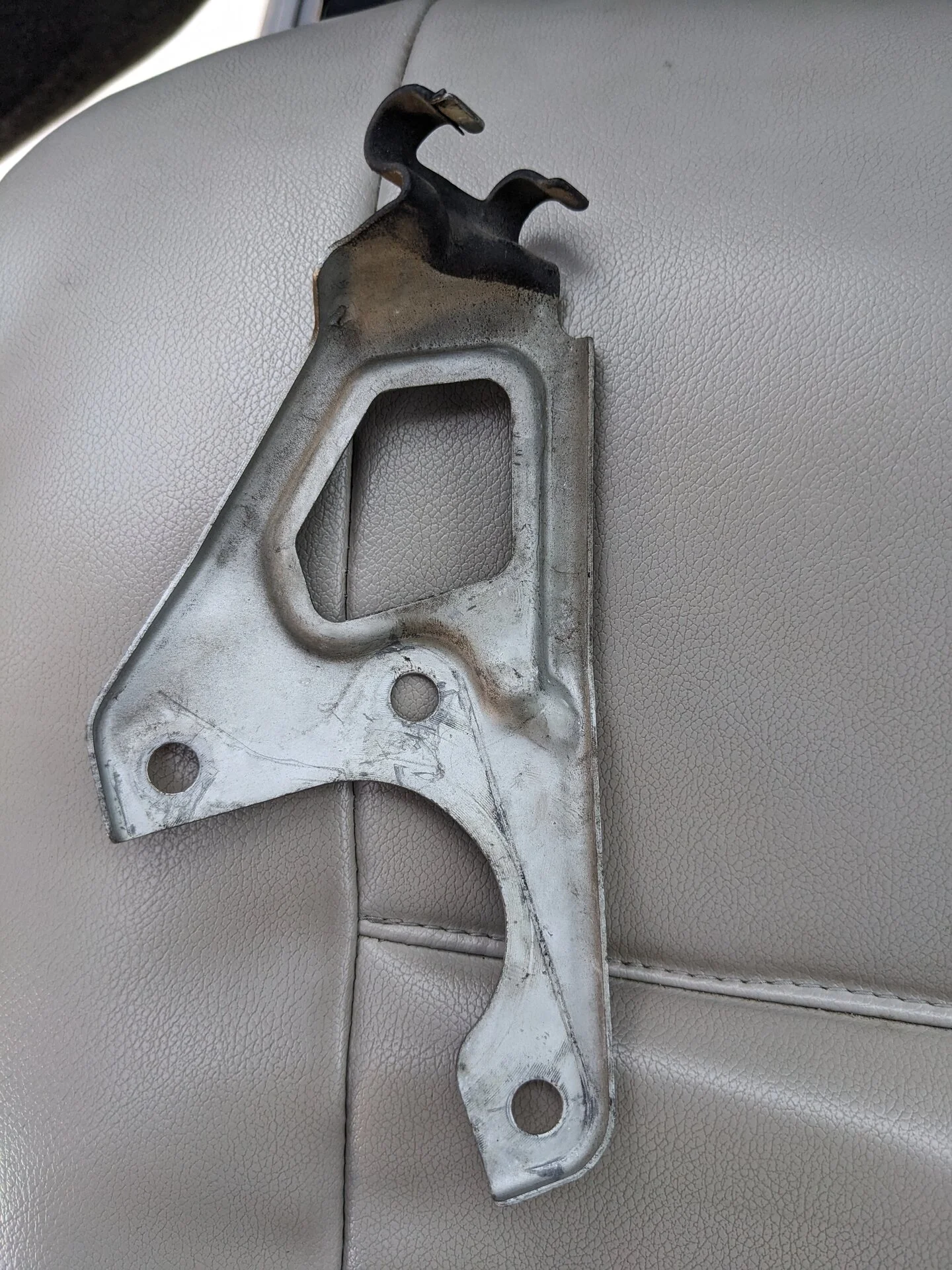

Also, I found the below piece in my battery compartment. The Toyota tech from today told me he found it in the little space above my right headlight and moved it to the battery compartment. I have no idea what it is, and I'm thinking someone took it off and didn't put it back on? Since I've been driving this car for 3 years, I've always cleaned every nook and cranny on this vehicle and I know for a fact that it's not something that's just been sitting there this whole time.

Other than that Utah in July will destroy your rig if it isn't sorted. 110+ temps and the steep hills are not easy on your cooling system.
That bracket mounts on the brake master cylinder. The black-coated clamp is oriented toward the passenger side of the vehicle and holds the throttle cable. It is one of four throttle cable clamps: master cylinder, charcoal canister, cylinder head, and intake boot. Not super-critical, but assume it was there for a reason and eventually re-install it.
Thanks for the update. It seems likely that the 80 will run cool enough the rest of the trip thanks to the new fan clutch. Hopefully you can ease into thinking of other things once you've driven it a bit more and gained confidence that it's staying cool.
I'd still consider picking up an IR temperature gun (they are pretty cheap) and a few jugs of water before setting out and I'd work through the many items listed in this thread, etc. once you land at home. You'll probably want to go with a sturdier fan clutch in the future, etc. but nothing wrong with running that OReilly's unit to get home.
Once you "baseline" your 80 and catch up on all of the deferred maintenance you should be able to drive it anywhere with little to no worries. We take our 80 on many trips short and long with no concerns about it beyond the fuel gauge. Hopefully you'll get your 80 sorted after this trip and have many more, much smoother, trips in the future.
Thank you!!

I'm thinking about picking up a scanguauge 2 from AutoZone today. We've been lugging around 3 gallons of water, 2 gallons of coolant, 5 quarts of oil, and some extra gas the whole trip. Can't wait to unload all this junk when we get home 🤣

I really like the UltraGauge in mine. It gives me many views of pages to set to what I want to see all the time.
