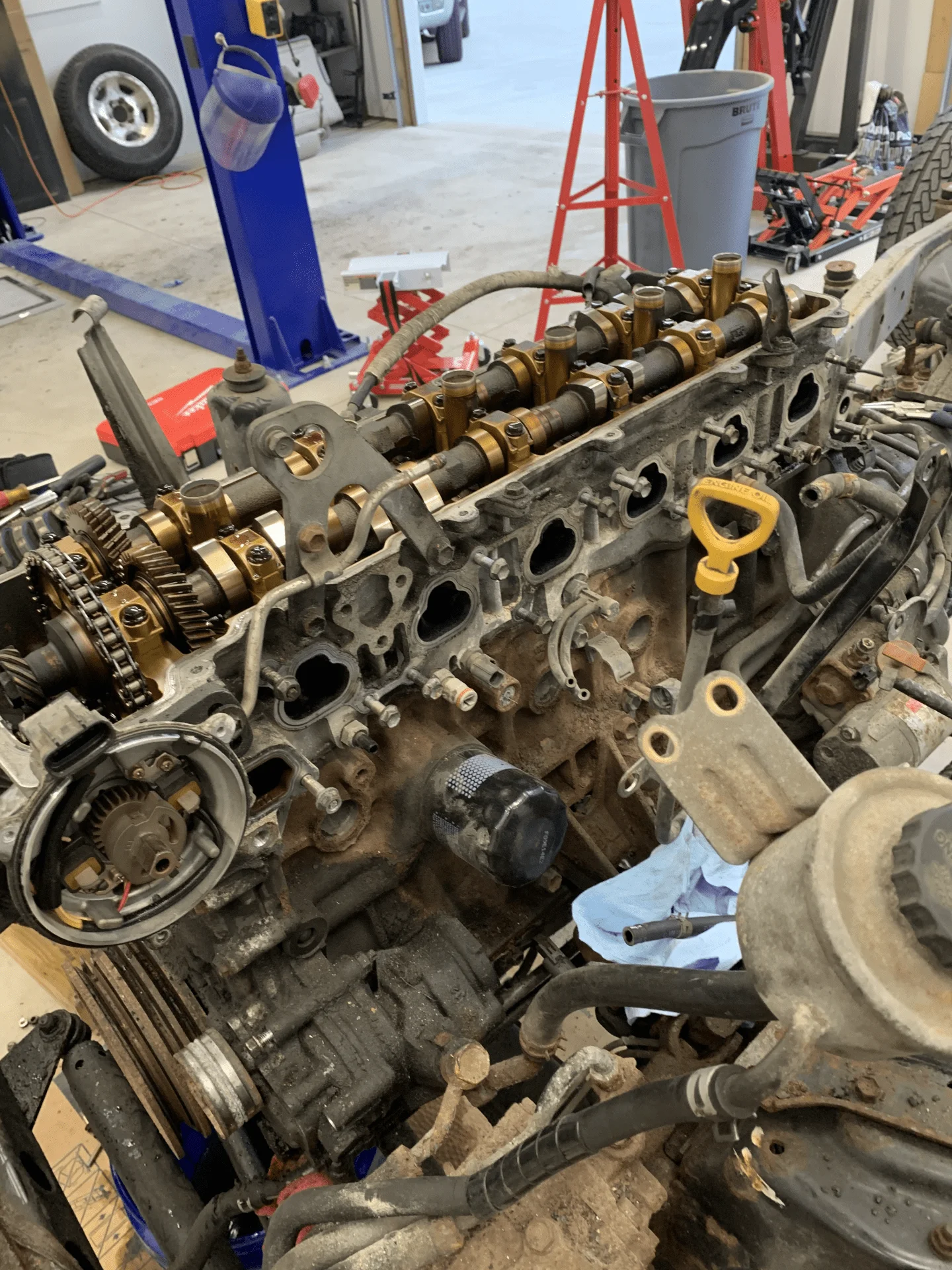

Dang, that engine is much cleaner internally and externally than mine was when I tore it down.
Yeah - it only has 205k, so on one hand I'm not surprised, but was still happy to see the condition when we took off the valve cover. Waiting on a couple more tools before we pull the engine and put it on the stand. Looking forward to seeing the condition of the valves and pistons. The engine ran fine, so I don't anticipate issues, but still am excited to see.
