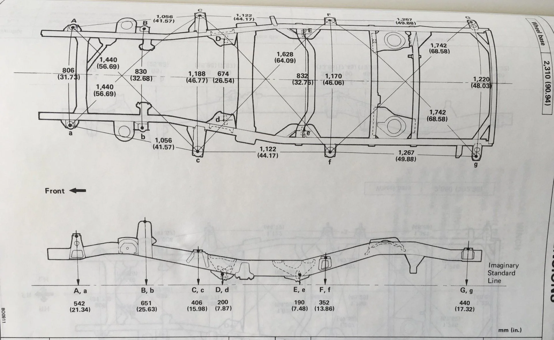

Hey all, could someone tell me the overall exterior length (nose to tail) of an LJ 70 and an LJ 73? I'm trying to figure out if I can fit a potential new purchase in a shipping container with another vehicle... or 2. 4x4 tetris, if you will.
If you have an aftermarket bumper on yours when you measure it let me know so I can factor that in.
Thanks!
Only way to fit two into a 6 meter container would be to back the first one in then build ramps and drive the other in forward.
The container is 40 foot but will have an 80 in it. I’m really just looking for vehicle measurements, since I just can’t find those kinds of specs anywhere.
Here you go.
