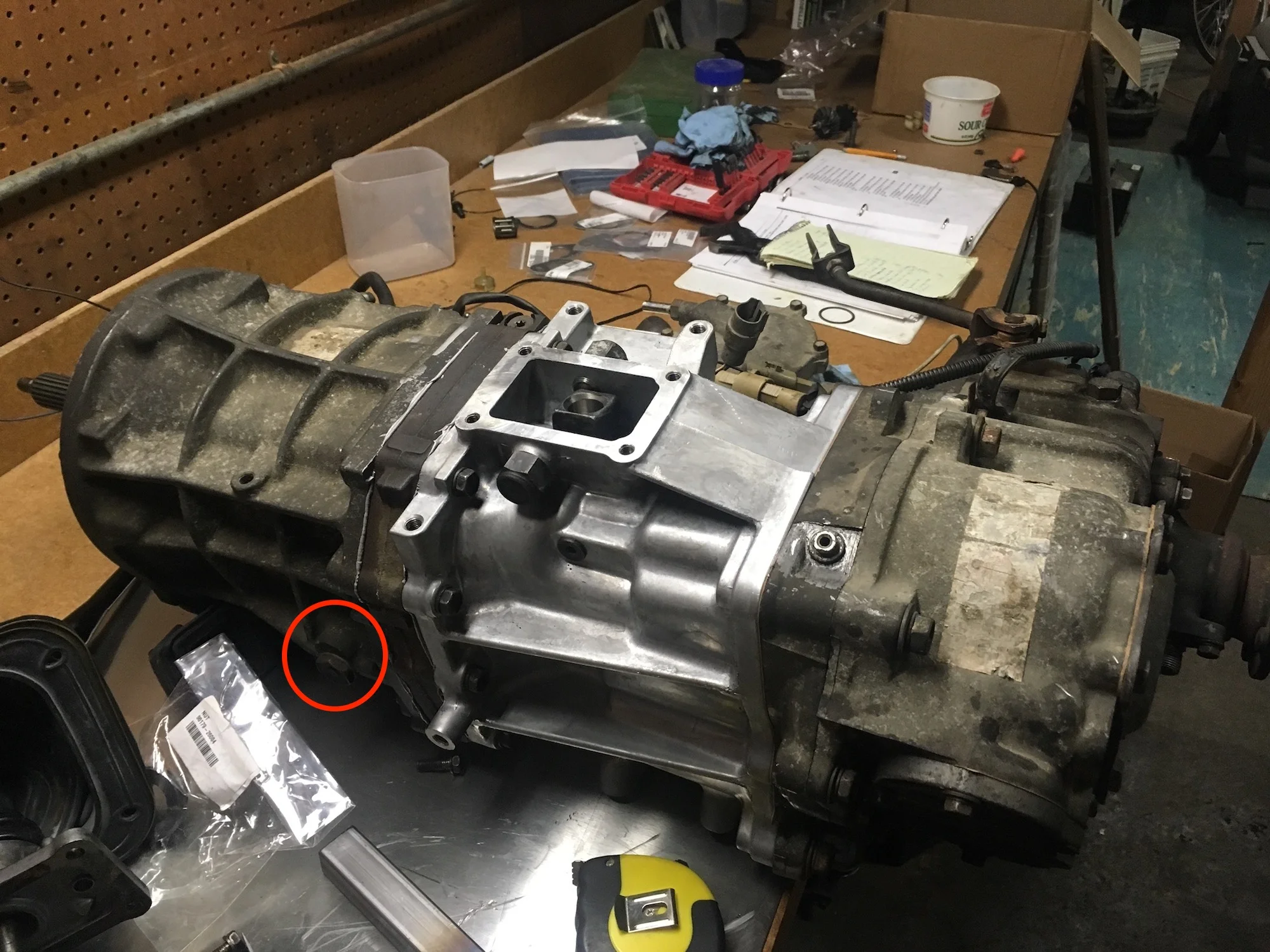

If you have the time, I'd like to see where the drain plug as well if you have a photo.
Hard to see in these photos unfortunately, but here is the location of the drain plug (RH side of the transmission):

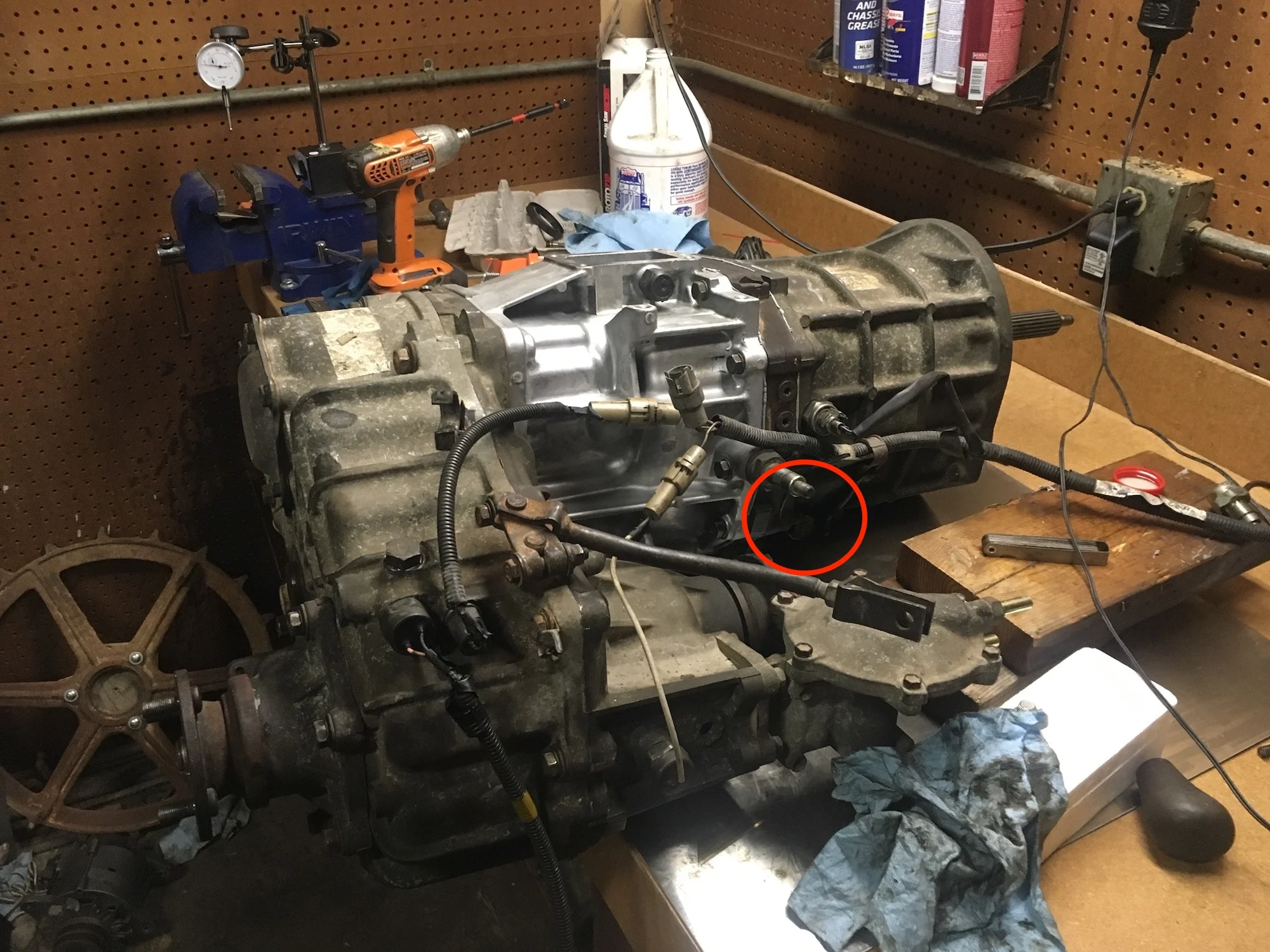

And here is the fill plug (LH side of the transmission):
Make sure you can get the fill plug loose before you mess with the drain plug, there's nothing worse than draining all the fluid out of your transmission only to find out you can't get new fluid in!
