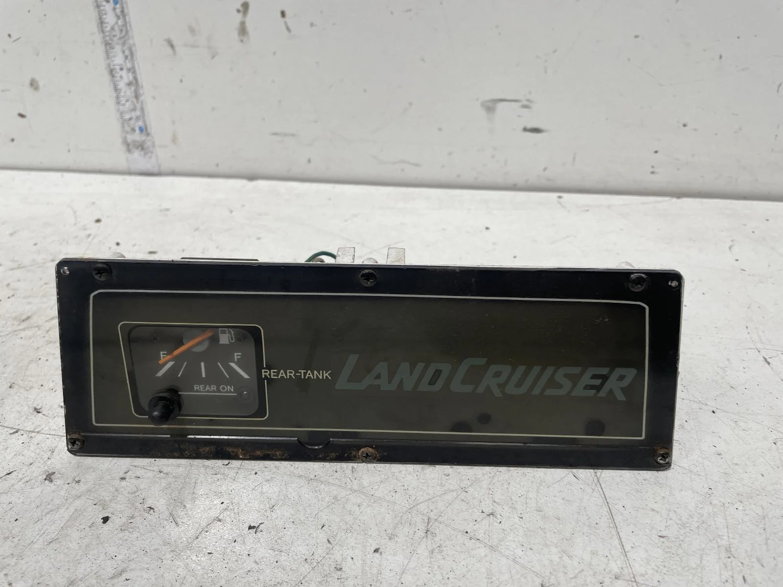

G'day everyone! looking for some dimensions for the 75 series landcruiser subtank gauge, just the insert. I have attached an image of what i need. Just need length, and height. Cheers!!!
Not sure if you still looking for the dimensions of the sub tank gauge as I only noticed your thread right now. So, in any case you still do, the upper (top) measurement is 220mm, the bottom is 238mm and the height is 85mm. Also wonder where you might be with the installation of your fuel dual tank system as I'm just thinking about it and need some advice on electrical set up.
