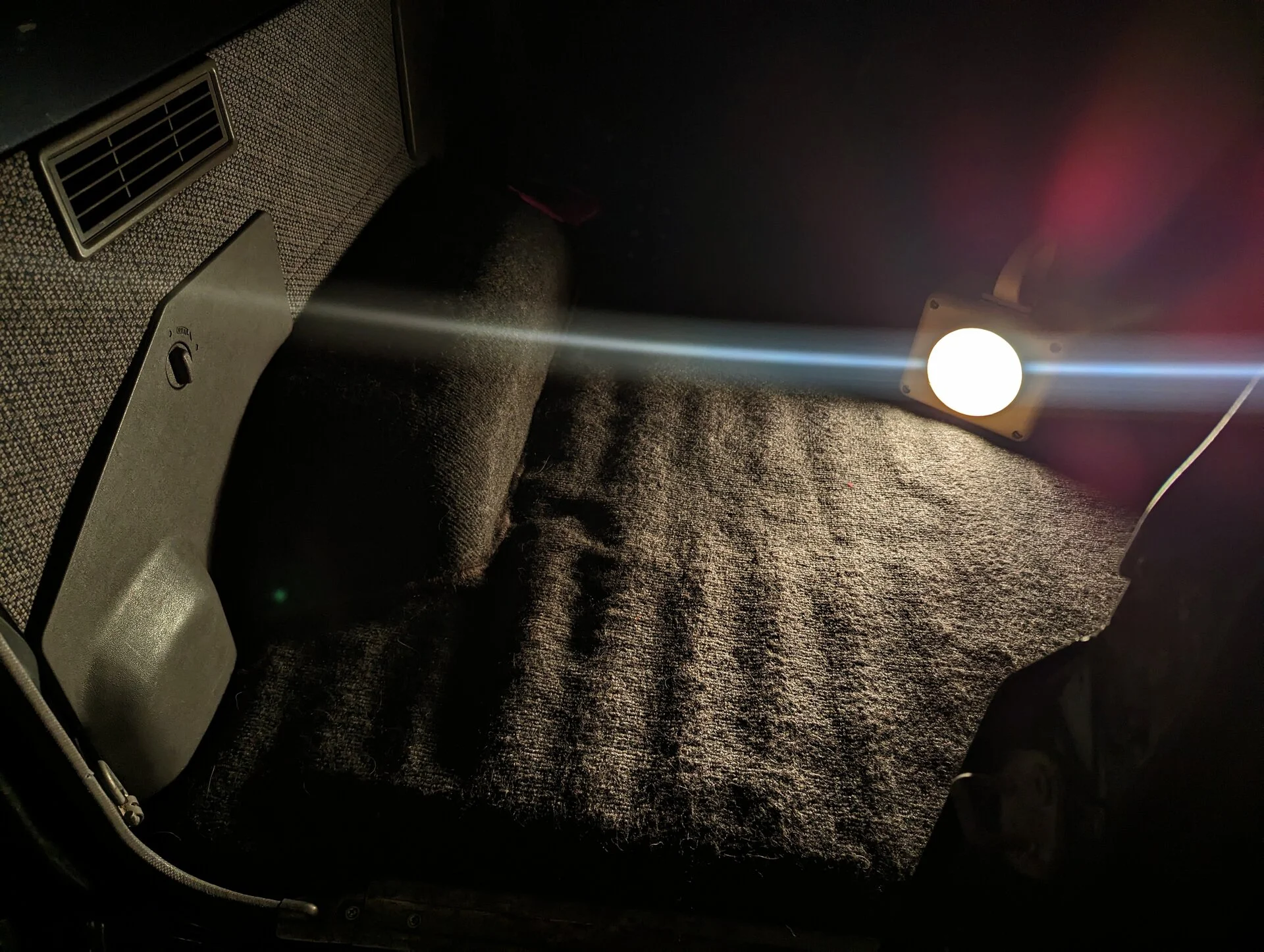

That's about all for today. Oh: I got my ridiculous yellow flashlight cube working...and it has what is definitively the worst beam pattern I've ever seen. It's a sketchy, dim spot surrounded by multiple halos of artifacts. It gives me a headache just looking at it. 🤣
Well, this actually turned out better than I expected...
Pictured: "Let there be marginally-sufficient lux." - God
I don't need to bore everyone with the details, but: the surplus battle lantern rebuild was a fun little diversion while I've been learning about various things travel-related, which is phrase that here means "radios that one can use near the Canadian border." In the midst of figuring out how to disperse and soften the light from the single worst bulb that Westinghouse ever designed - answer: throw it in a blasting cabinet - I did a lot of research on GMRS, MURS and several other services, and I've decided that adding some radio capabilities to the rig probably isn't a bad idea. I think cell service is still going to be the main form of communication, but I've already learned that it's incredibly easy to get out of tower range when you least expect it; the little handheld FRS radios that we carried on the cross-country trip were lifesavers through Kansas, Colorado, Utah and Idaho, when calls would drop completely without warning...and usually at the worst possible moments. I have several extra/unused spaces in which I could install a mobile radio or two, but I'm pretty sure I'll need to find some that work on 24 volts...which - I'm assuming - would also be true of the antennas. That might throw a cramp into the cotillion.

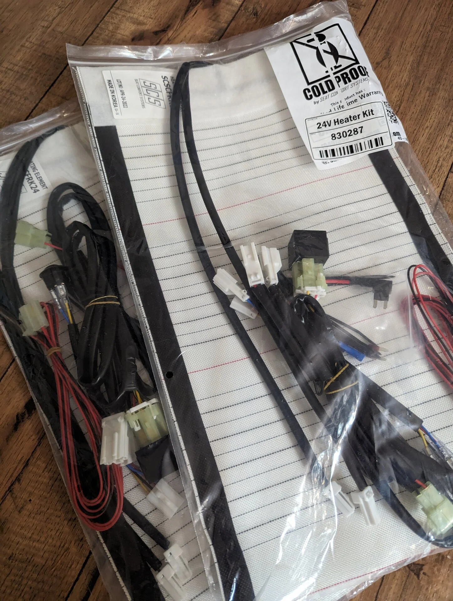

I guess that going to be tomorrow's project...along with looking for some seat heaters: I already have a set of switches in place, so now I need to find a set of heaters that's trimmable - the upholstery guru specified that quality - and which will work with the 24-volt system. I can power them with the auxiliary 12-volt system if I can't find 24-volt models, but I have two unused 24-volt switched connectors directly underneath the console, so it would be exceptionally nice to pull power from there. So... let's see how my Parts-Fu is holding up.
Edit: Well that was easy...
Update: Heaters are ordered; now I get to figure out how to wire them...and we all know how well I get along with wiring. 😑
Edit: So, here's a thought; bear with me while I noodle it out.
I have to run each pair of heaters from a relay, and each relay needs to be controlled by a switch. The switches are already installed, and I think the only thing I need to do in order to illuminate them is change the 12-volt bulbs to 24's and get a power and ground wire to each; I can pull that from the unused switched power locations under the console...but I don't think I have an unused relay anywhere at all. The heater units are already wired and have their own connectors, and they're set up for Low/Off/High on the included switches...so all I should have to do there is clip the supplied switches and repin them to the Toyota switches. The upholstery guru is installing the heaters themselves, so I don't have to consider that at all...but I'm still left with the relay situation.
Reading back through the product spec sheet: each heater kit comes with a fuse, fuse box adapter - that seems dubious, at best - and a relay...so I'm wondering if that relay is being housed in some kind of floating/inline relay mount. I know I won't need to add a fuse to the switches because the connections under the console will already have one protecting them, somewhere; I may need to chase it down, but it'll be there. So I'm still left with locating the relay itself, and fusing that circuit; that's the high-amperage draw - well, if you can call 4.8 amps "high" then it's pretty high - so that's where the protection needs to be. So, it looks like I need either:
  1. Two tiny blocks, each with one relay mount and one fuse slot.
  2. A slightly-less-tiny block with two relay sockets and two fuse slots.
  3. An auxiliary 24-volt block under the console, which can be of any configuration, so long as it has the provisions from Option 2.
Now, having said all of that: how do I actually need to wire this thing? 🤣
Second Edit: I could just mount the relay itself under the seat, and then connect to it...but that still leaves me needing a fuse. An inline breaker might just work. 🤔

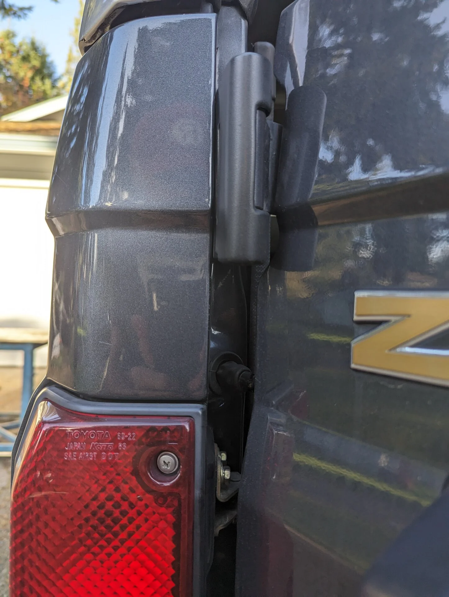

That's about all for now, although I did make an interesting observation about something, yesterday:
Pictured: There's a lot of room, right here...🤔
That hinge is made from...what, 5mm steel plate? And it's bolted to a rather significant chunk of structural sheetmetal, with lots of bends and corners and stuff...and there's access to the rear of that area from inside the rear quarterpanel.
Hmmmmmmm...

Pictured: The coziness has intensified.
First impression: these things are big. Like, way-bigger-than-I-expected levels of big; they're gonna reach all the way up the back into the shoulder area...and I probably should have realized that when I looked at them online, but I just didn't put two and two together.
I haven't unpacked them yet, but they look decent in the package; connectors and wiring look to be of acceptable quality, some decent slip-over looming is included, and for once I don't have to worry about finding the correct relay. And this is surprising: they're actually made from Koreanesium. I was expecting Chinese production, so... excellent!* Bonus!* Party on!*

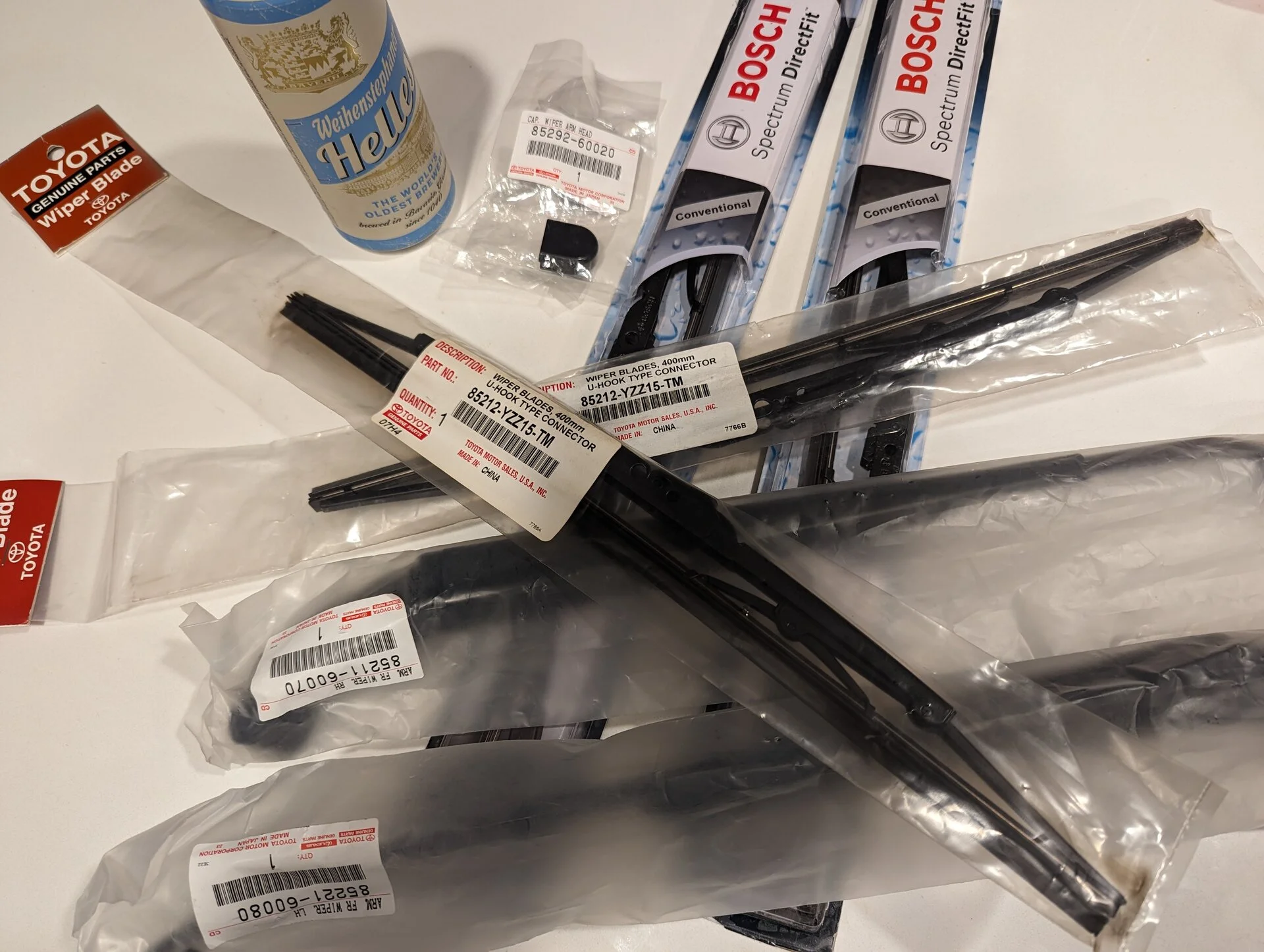

Pictured: More stuffs.

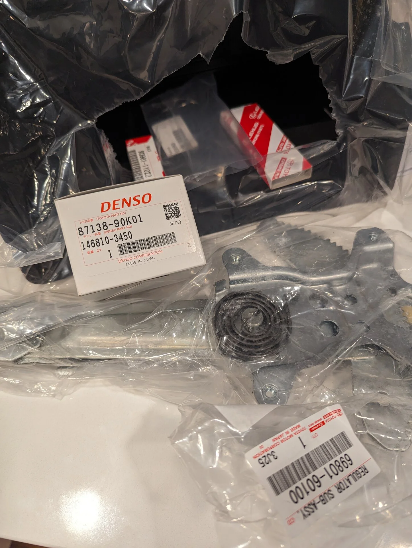

New arms, new caps, new short-side wipers, and an interim set from Bosch which I'll use until the Toyota factory long-side wiper shows up. Thanks, @cruisermatt 😉

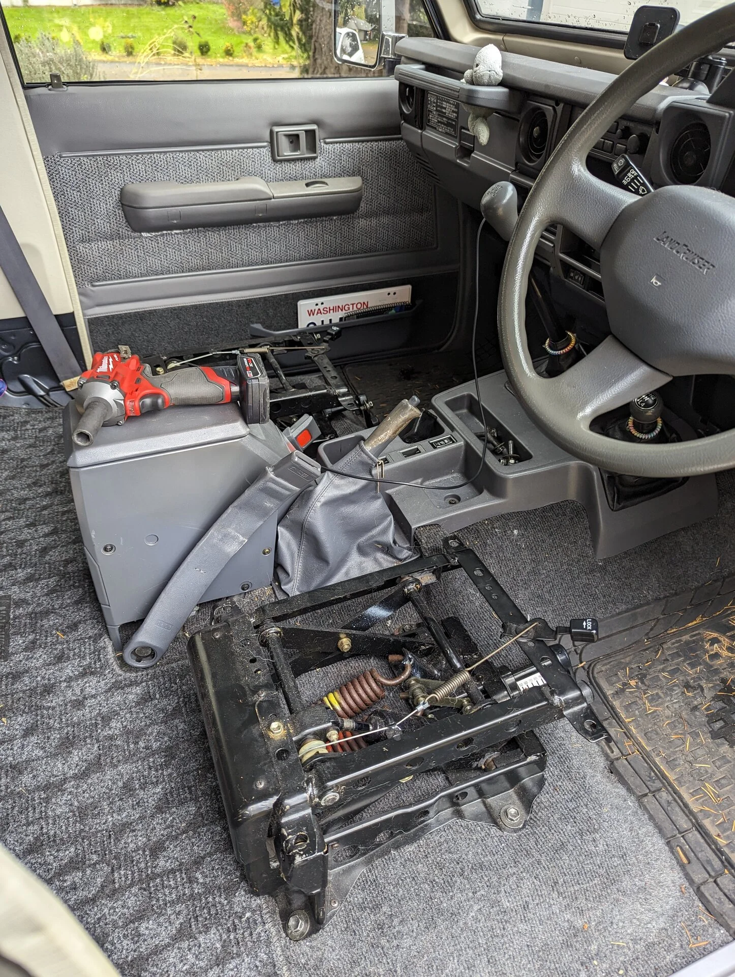

Also: seats are being pulled tomorrow to be dropped off on Saturday morning, and this probably the only easy opportunity I'll have to replace the worn hinges with the better set from the Prado seats that I bought...so: anyone know the easiest way to take a seat apart to get the hinges out?
Pictured: Record-fast shipping, but I gotta start making better life choices.
That box is...uh...pretty heavy. Even the small box is heavy; I think my secondary rack-support system project just moved up on the schedule.
Pictured: So much more room for activities.
I think I'm going to replace my parking brake assembly while I have the room to do so, and maybe the center console lid as well; I have both of them lying around somewhere, waiting for this exact moment to occur. Also, I seriously need to vacuum...but yeah, as of this afternoon the stock seats are out and I have my Prado seats on the workbench, where the latter of which are slowly being vivisected. More pictures later. Maybe.
