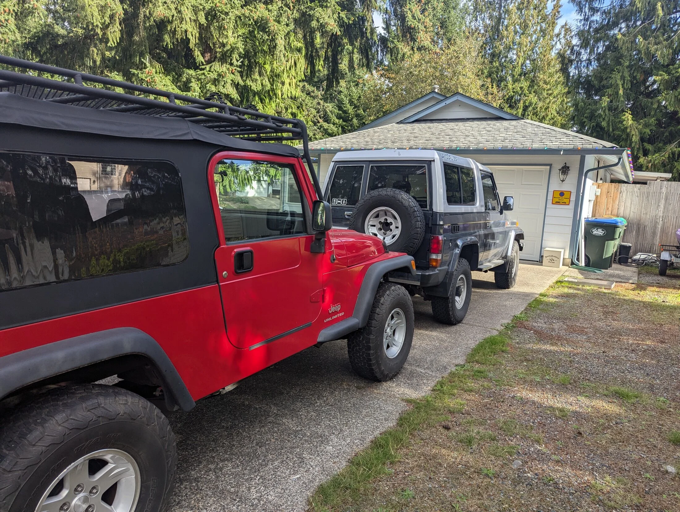

My driveway got crowded.
Pictured: Why do I make such bad life choices? Why?
Before anyone asks: no, I didn't just buy the exact wrong kind of LJ. On the contrary, I did the only thing worse than buy it: I kept it.

Is this a long wheelbase Jeep? Or is it just the camera angle?
From the looks of it, it appears to be a pre-Fiat example. Is it?
Just curious.
Juan
It's a TJ Unlimited, more popularly known as an LJ. 104" wheelbase, with most of that length added ahead of the rear tire. Thus, the wheelbase is about 10.5" more than the standard TJ, at 93.5".
Correct, by five years or so. Fiat began their purchase in 2009.

It is always nice to have extra space.
Pre-Fiat means it is possible to work on it. It could even make a good daily driver.
The extra interior space is welcome, but the real strength of the LJ comes in the overall wheelbase gain; climbing performance - especially when you're playing on ledges - goes way up, with very little loss of departure angle. When built correctly, they're extremely capable. They also do well for light overland work.
TJs are starting to be a niche vehicle, these days; the majority of the parts that are now available - aftermarket or OEM - are for the Fiat-and-ever-after chassis. JK, JL, JT... they're all more recent and more publicly supported; that said, the TJ is massively simpler to repair and modify, and in the US, parts are still everywhere and they're inexpensive. I can even borrow certain parts from Cherokees, Grand Cherokees, etc. and do a lot of mixing and matching to suit my needs. That axle housing that I posted is actually from a '96 Cherokee, and it's a bolt-in swap; I could pull literally everything except the ring and pinion gear from my '04 stock front axle and shove it into that housing, and it would work perfectly. Of course, I'm not going to do that because I make bad decisions, but I could if I wanted to.
Regarding daily-driver potential: it already is one. The girl in question happens to love driving that Jeep so much that we had it moved 3,000 miles instead of selling it back on the East Coast and getting her something here. We also already owned it, so this was literally the cheapest way we could think of to get her a daily that we know she would be okay with. 🤣

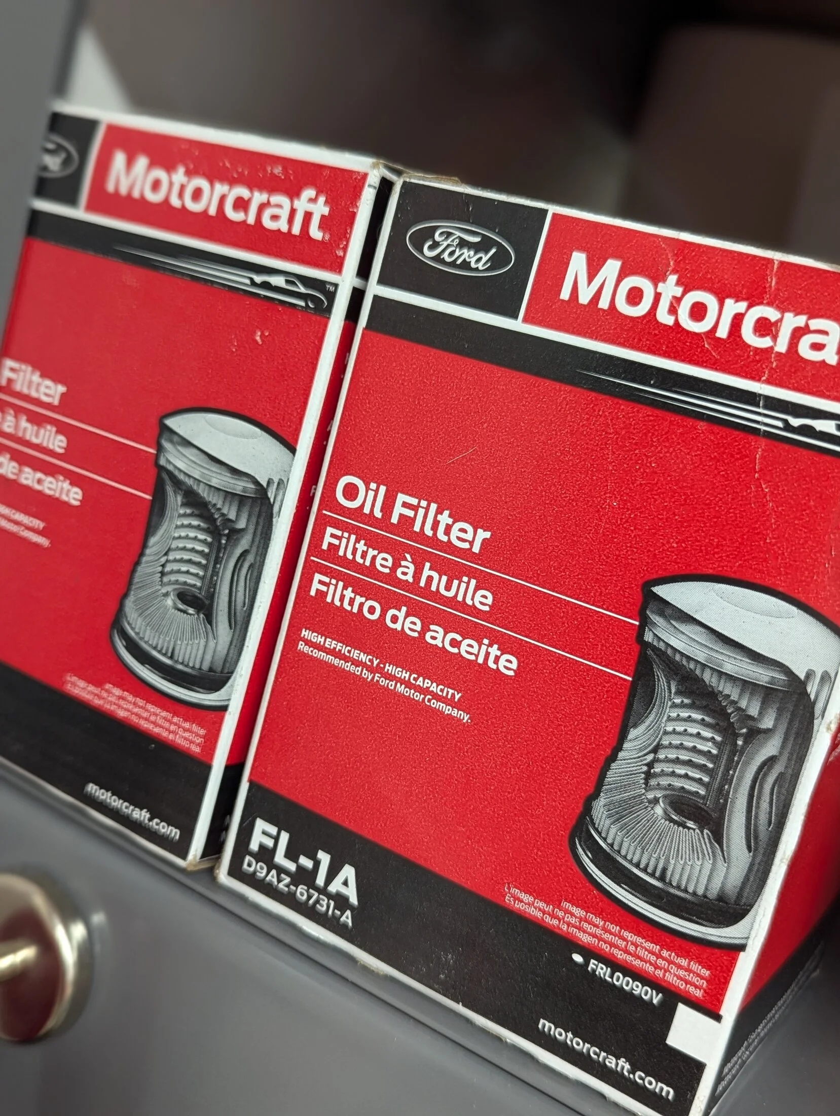

Also, I'm now stocking Motorcraft parts, because Bad Life Choices.
Pictured: Better people have been fired for lesser crimes.
I know what you're thinking, and it's "Did that chimp buy a Ford?" And the answer to that is "No; the chimp sold one...and that was stupid because it was a good truck." As for why I'm stocking Ford filters: they're the same price and of equivalent quality to Mopar filters, and they're usually more readily available...and they happen to fit the Jeep 4.0 that lives under the hood of the Wrong LJ. And that's also why I'm now keeping 10w-30 in the chemicals cabinet.

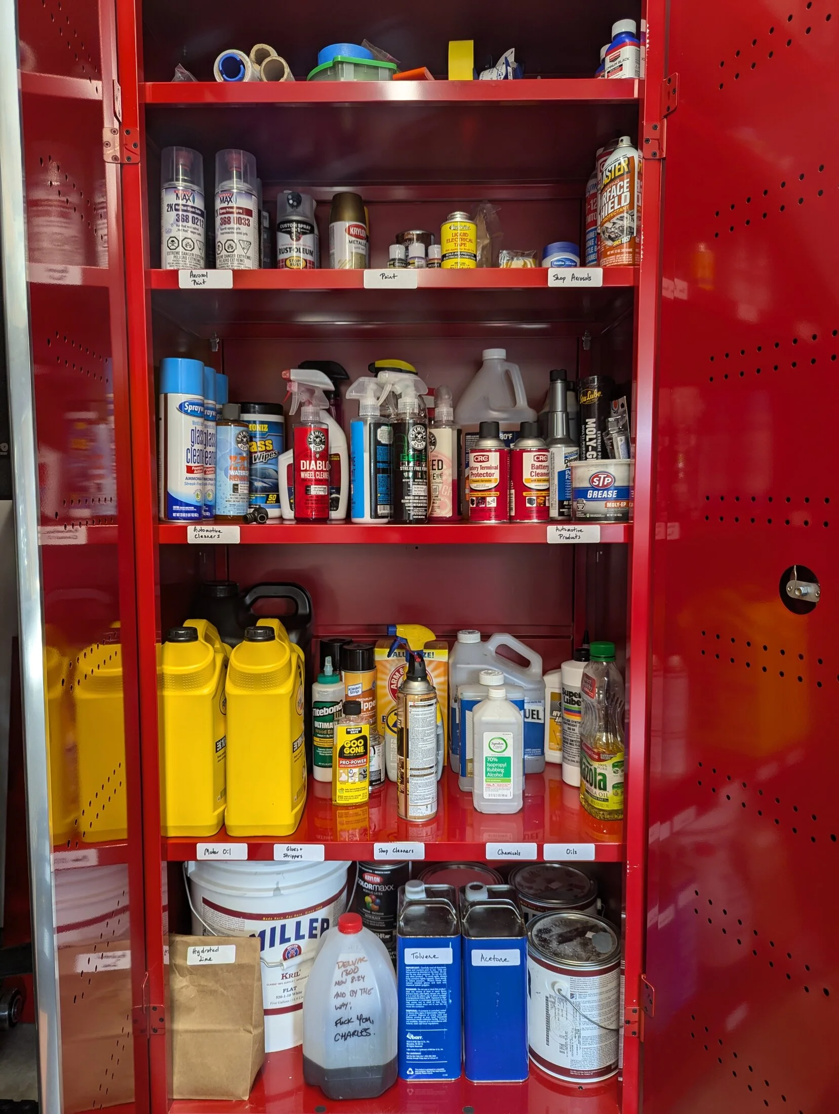

Pictured: It's the only thing in my shop that's actually organized.

Regarding Motorcraft, a friend of mine drives a Ford Explorer. During one scheduled maintenance, a number of parts, including the battery, needed replacement. They were all from Motorcraft. Some were not in stock and had a waiting period. The mechanic suggested using another brand, and my friend accepted. Within six months, many of the replacements, the battery among them, failed. Back to Motorcraft. I chose not to suggest waiting, despite me being rather obsessive about using the parts that the manufacturer recommends -mostly because of a number of nasty equipment failures because of no name brand spare parts, but that is another story.
Your chemicals cabinet looks neat. If I may say so, you are far more organized than you are willing to admit. Understatement, I reckon.
It's the same case with Mopar. People seem to have this idea that the aftermarket is always better...but I see many more failures with aftermarket/budget parts than I do their OEM equivalents.
Despite the unintended and hilarious photo bomb in that picture, it really is the only part of my shop that's regularly organized. I'm chaotic and messy when working, so I have to over-enforce organization, lest my workspace turn into the Trash Heap from Fraggle Rock.

They say that a clean desk is a clean mind, but this is not entirely correct. Work needs, or implies, a messy environment until it is done. It is important, however, to keep the mess under control.
