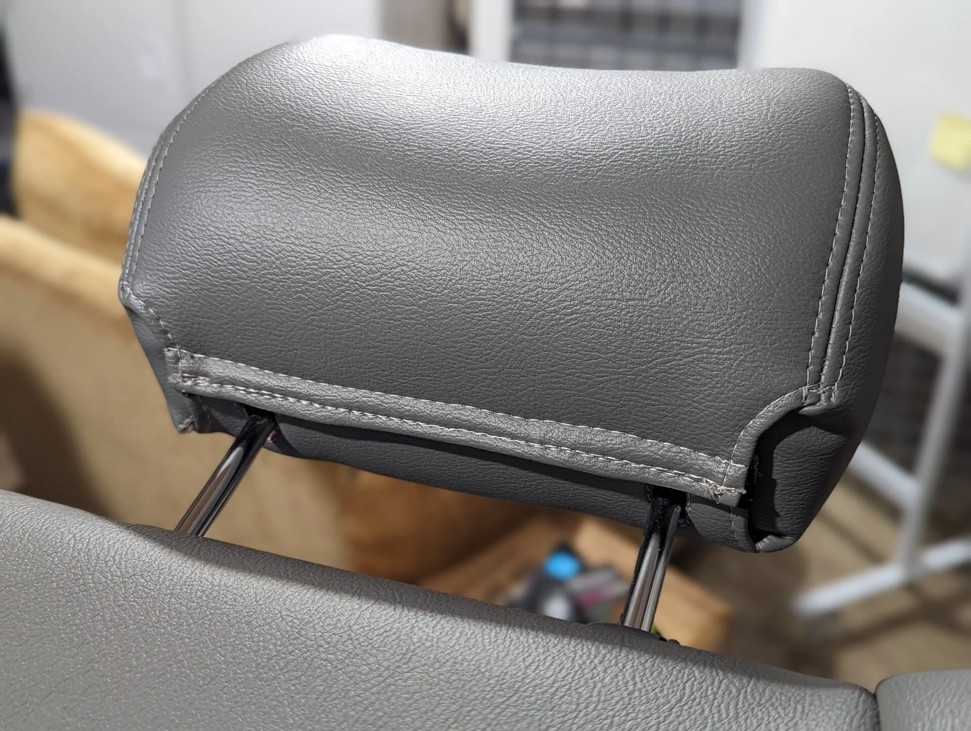

At the risk of having mud flung at me, how did you finish the bottom of the headrests? Looks a little bit unfinished? What do they look like with the headrests raised? I am not trying to nitpick in any way just curious.
The factory headrest covers are basically a fitted bag with a Velcro closure; it's a simple and functional solution...but if you're used to a more modern, sleek or contoured headrest, then they'll definitely look unfinished. In fact, they'll look like they came out of a late-model Ford sedan, complete with legit velour and hair/fur of questionable origin.
Pictured: Old and busted.
...see what I mean? Literally a bag with a Velcro closure on the bottom; you can even see the foam through the cuts for the riser bars. That's one of the headrests from my Prado sets, but they're a pattern-match to the ones that I had remade. As far as that set is concerned:
Pictured: The new hotness.
Same basic style, just a bit more obvious on the closure because of the stitching. For me, it's a very workable and affordable solution, and it honestly integrates quite well with the utilitarian aspect of the rig; we could have changed it and polished things up a bit...but that would have also detracted a bit, methinks.

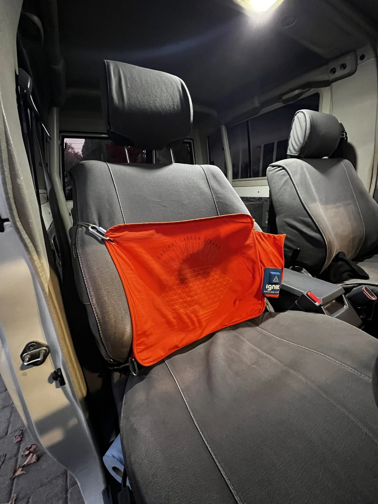

Also, I have a quandary...one with which the wiring gurus in the crowd may be able to help. Here are my observations:
  • I poked around under the center console and found something interesting; I have two connectors with functional pins - at least, as far as voltage is concerned - out of the five connectors that are present. One of them is a two-pin in which each pin goes to ground; the second connector is a four-pin, two pins of which have 28.2V and the other two of which have nothing, as best I can tell.
  • The switch in the aftermarket seat heater kit only has four wires; I don't have a wiring diagram for the harness, but I'm guessing that they're for High, Low, Ground and the illumination LED. I can probably figure it out by looking at the relay and seeing what pins are switching which wires, there.
  • The actual power feed to the aftermarket seat heater kit only has two wires; which are a hot lead (with a small inline fuse) and a ground.
  • The factory Toyota/Lexus switches that I would like to use are six-pin connectors, as already deciphered here, thankfully.
As best I can tell: two input wires and four switch wires roughly equals the six total wires that I have on the factory Toyota switch. My quandary is this: how, exactly, do I convert from the aftermarket harness/switch to the factory six-pin Toyota seat-heater switch? I think I can do the following, but it would really help if someone would check my logic before I catch things on fire.
  • De-pin the existing below-console connections to create a single connector with two hot leads and two grounds. (Note: this is the part that concerns me because I have ZERO idea of what those connections are supposed to do, from the factory; all I know is that they're unused at current.)
  • Build a Y-shaped harness that feeds the 24V+/- circuits from the new connector created in Step 1 to both the right and left heater switches.
  • Pending that deciphering the relay in the aftermarket harness tells me good things, I can then de-pin the aftermarket switches and just run those wires to the similar pins in the Toyota switches.
That seems pretty easy, but the part about the illumination is tripping me up. 24V+ from keyed ignition is pretty simple, and the ground is pretty simple; likewise, the Low and High outputs are pretty simple...but the bulb ground and bulb hot aren't making sense. Are those are coming from the relay, in that it's activating a second circuit when either High or Low is engaged? I really need to go look at that thing and see if I can figure it all out; relays frighten me, after having killed about $100 of them learning how diodes work, mostly by trial and error. 😑

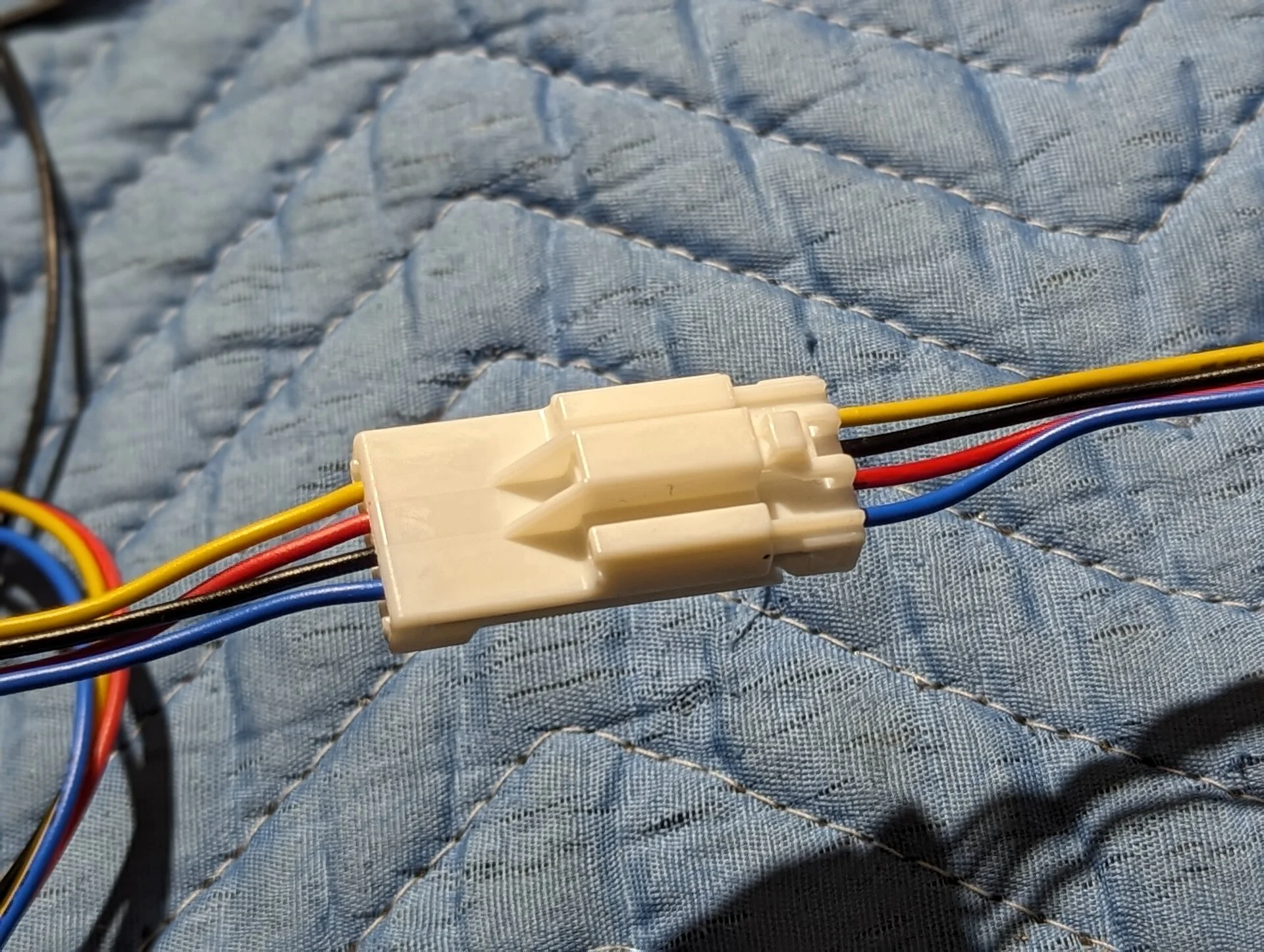

I've been pulling the looming from the harness to trace the circuits and figure out what does what, and the result is...well, it's confusing.
Pictured: Beware the blue wire.
I pulled the electrical tape at the main junction of wires near the relay; there are a couple of jumpers present, which did not go to anywhere near where I thought they would go...and I'm having to visually trace the wires because several of them are the exact same color and definitely not on the same portion of any circuit. But the main source of consternation was the blue wire, which was present on the switch side of things, but not present anywhere else. Conclusion: someone switched wire colors somewhere inside the loom.
Pictured: Now, how did you know about that blue wire, KitKat?
That's the chassis ground leg/branch/nexus, I've discovered; I've no idea why it's black on one side and blue at the switch...and why an entirely different black wire isn't the ground, but rather the Low Heat side of the switch. But that's not the worst of it...

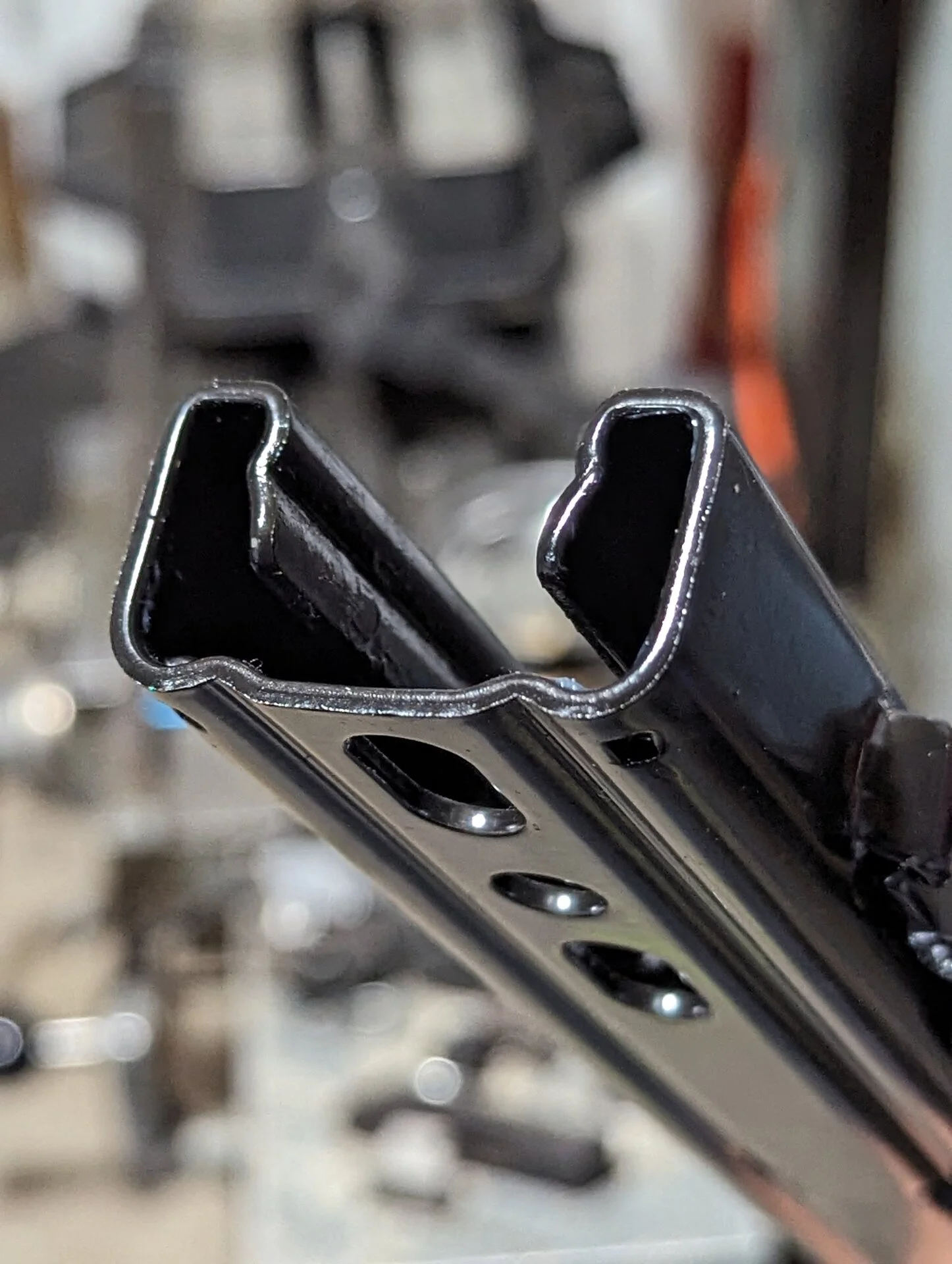

The bad news is that I'm going to have to replace one of my seat tracks; I thought it was just a bit worn and loose, but it's actually missing one of the interior bushings that hold everything in place...so the slider is moving in directions that it shouldn't. That being said...
Let's just say - hypothetically, of course - that I wanted the seat to slide a tiny, wee, insignificant bit further forward than it does at current. Like... maybe another four inches. Would that be even remotely possible, should the things that look like stop-pins in the seat tracks somehow find themselves removed? I can't figure out what those little things would be, if not internal slide stops.
Pictured: Shown at image center.
I'm reasonably familiar with most slide workings from some job skillz in a former life...but this one: not so much. I can't really see into the top of it or pull it apart - thankfully - so that causes me to think that it's assembled by being slid together, and then it's held in place by a stop pin. So...would this be the stop pin?
To be honest, I don't see that there's even another 20mm of travel to be gained by removing that pin...but I'm playing a game of fractions with creating sleeping space in the rear, and every bit helps.

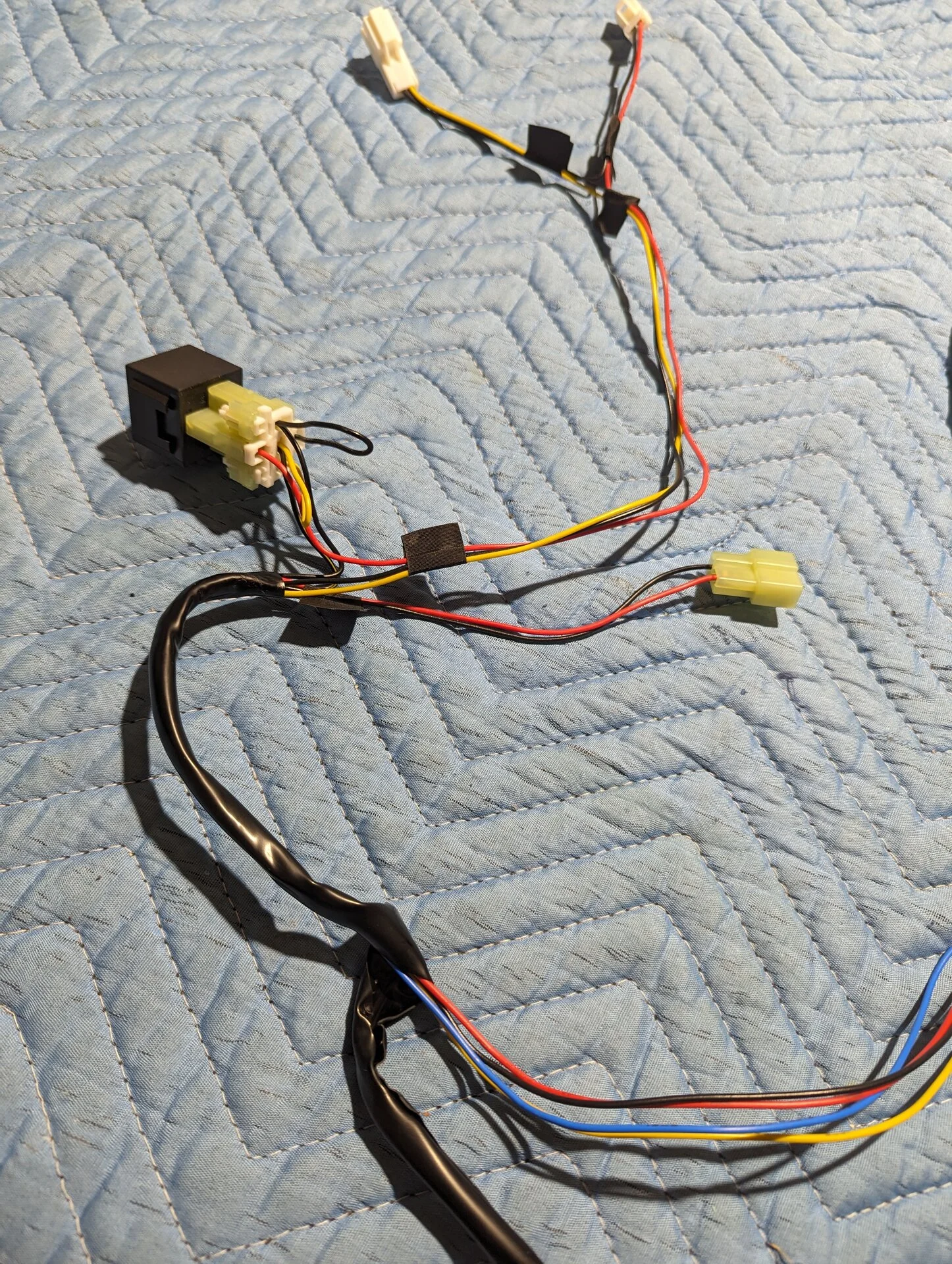

I have my changes to the seat heater harness mostly diagrammed and sorted; the main issue turned out to not be the different switches, but the different power inputs. The aftermarket harness is pulling both power and ground from a single source and then splitting those paths as needed...but that's not actually needed: it's just being done in order to create a two-connection installation. This is exceptionally simple, but - of course - exceptional simplicity is completely wrong and we simply cannot have it...so we're going to slice everything apart and do it correctly, which is a word that here means "in as complex and unnecessary a fashion as we can divine at present, because we do not like ourselves."
Pictured: "The self-loathing...it's over 9000!" *crunch*
I never seem to get organized. Le sigh. But for realsies, the harness kind of needs to be re-done in order to make this all work cleanly:
  • Power is coming from a four-pin connector under the center console, the bulb circuit is a two-pin connector adjacent, and the relays for the heaters are going to mount about three inches away from both of those connections; this arrangement requires approximately 117" fewer inches of wire than is currently in the aftermarket harness.
  • Roughly sixteen inches of wire are needed between the relay and the seat-side heater-pad connections, and those connections are themselves somewhat awkward due to the pigtail lengths of the stock wiring; the connectors basically want to occupy the same space as the hinge cover, which is almost entirely sub-optimal...so I need to do a bit of cutting and repinning there, as well. Those alterations will cut another foot or two of wiring out of the mix.
  • The switch circuit needs almost five feet of wire despite being only 30" away from the relay mounting point; it has to tuck up and behind a bunch of stuff in the lower part of the dash, and that tuckage sucks up a lot of length...but the chassis ground doesn't need to be part of that equation. In fact, the spiderweb of grounding wires within the harness doesn't need to exist at all; each of those grounds can be pulled discretely from the chassis itself, should I prefer it.
  • Lastly, the wire colors in the harness really don't make sense. Between the two pads, the relay and the switch there are about six different paths that need to be addressed, and the factory harness uses five different wire colors...but those wire colors are almost used at random. Example: the ground circuit is variously composed of black, blue, yellow, and black/yellow wires. The low-power out is a black wire, and the high-power out is a yellow wire at one point and a red wire at another. Keyed ignition is black...I think. It's so hard to follow that I literally drew a color-coded diagram on my dry-erase board, and even that is confusing.
The end result of all of this is the masochism depicted above, so I'm just going to rebuild the harness as needed. This being said: I can't change some of the wiring and there's no reason to change some of the rest, but the problem areas will be neater if I re-color them as best possible while I'm cutting and splicing. I'll get into all of that in a future post; for now, the wire and connectors are ordered, so all I have to do is wait for them to get here and then I can get moving on it, and in the meantime I can get my relays mounted and start working on other things. Speaking of...

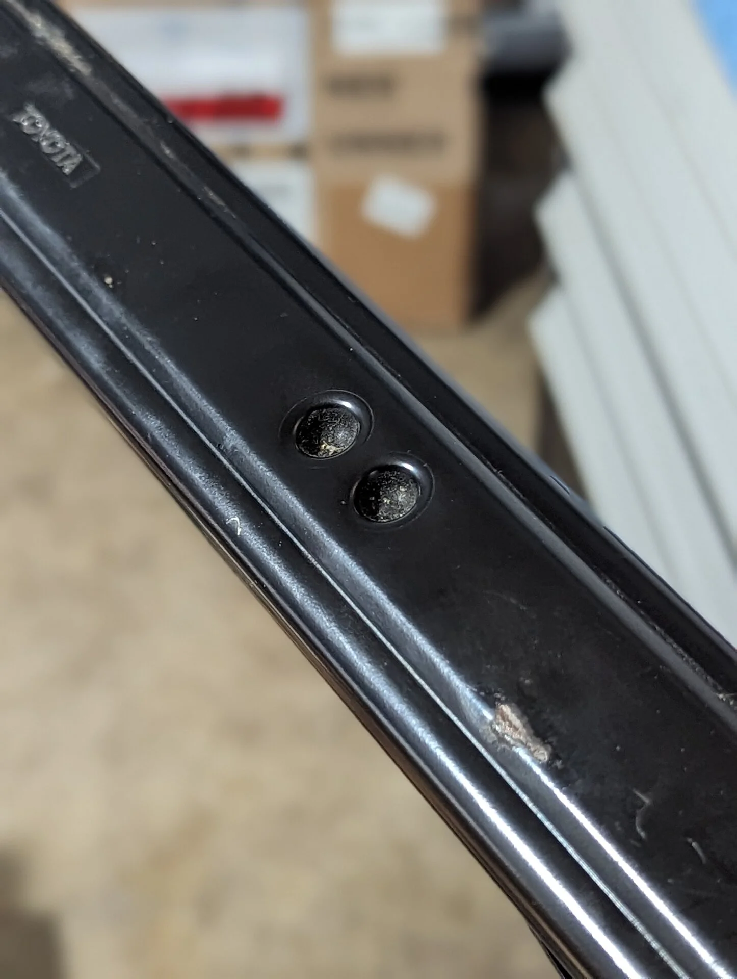

I went ahead and ordered the Corbeau slider aforementioned; I don't really want to raise the passenger seat by an inch, but the height change is still worth an easy and removable experimental solution to my seat-sliding quandary. Also, I have roughly determined - a phrase which here means "guessed-at with basically no factual data to back it up" - that the suspected stop pin in the factory slider is not, in fact, what stops the internal track sliders from over-traveling. In reality, it's these two depressions that handle said task.
Pictured: Which means the pin is useless, now that I think of it... 🤔

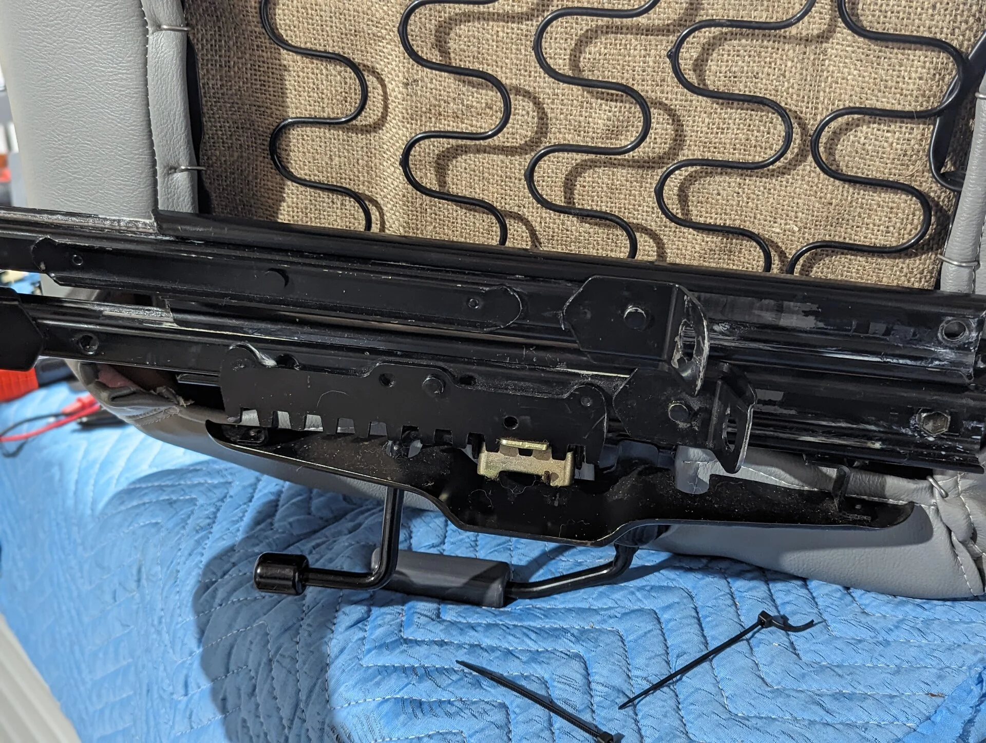

At least, I think they're slide-stops; I'm honestly not sure. They're the right shape and in the right place...but: they're also not what actually delimits the seat travel...and if I was actually 1) smart, or B) observant, I would have figured that out before now. The actual limitation is on the other side of the seat at the locking track; not only does that portion have to positively engage with the locking catchment in order to secure the seat in any given position - thereby introducing a limitation on travel in and of itself - but that side of the slider mechanism has somewhere around 30mm less travel than the non-locking side, because reasons.
Pictured: Well, doesn't that just complicates the f*** out of things?
Both of those slides are at their maximum travel extents in one direction. Likewise, they're indexed to each other in terms of mounting positions; the holes are lined up, as is visible on the right side of the image...and in the middle of the image, we see the difference in travel limits. What's interesting to me, though, is that the locking side has two detent positions that remain unused; my only conclusion is that the pressed-in detent stop in the top of the slide - again, that's a theory - is preventing those last two positions from being engaged, because more reasons. However: either move or remove the detent, and more travel is possible; theoretically, one could create the same amount that's present on the non-locking side...which is almost entirely unhelpful to me because I don't need the extra 30 European inches of rearward travel that this mod would offer. I need that travel in the forward direction...and I need it on the other seat, as well; it's good info to have for others, though...so if you're still reading at this point, we've learned something together.

So: I'm in a quandary yet again, by failing to do the proper research... because I'm about 99% sure that I can't return these sliders. Thus, I am left with $85 of scrap steel unless I can find a way to use them...so it's looking like a welding project. That's no big deal in and of itself, but I don't have an easy way to replicate the contour of the metal that forms the upper part of the slider mechanism...and of course I'm the kind of person that gets annoyed with that kind of thing. I'll post pictures here in a bit, after I have a cold beer and tell myself that I'm not as bad at this as I seem to be. 🤬
Pictured: "It don't come easy; you know it don't come easy..."
This is the end of one of the Corbeau sliders, which shows the cross-section of the outer portion that needs extending...and it's admittedly about ten times stronger than a piece of C-channel with a retainer flange bent into it, but right now I'd really prefer the simpler profile. So, ideas:
  • Find a second set of these and literally slice them apart for the extra three inches of metal that I need to make these work correctly and look nice, and then weld that in place.
  • Find some scrap steel and bend up an extension bracket that slips over the sides and flushes with the top mounting surface, and do the same welding thing, albeit with some rosettes involved.
  • Make a solid steel extension bar that slips inside the channel, and which bolts into place; two threaded holes and one unthreaded should do the trick.
And that's really all I have, at current. The pedantic part of me wants to cut and splice and weld and do this the hard way; the pragmatic part is already looking through the pile of bar stock.
Thoughts?
