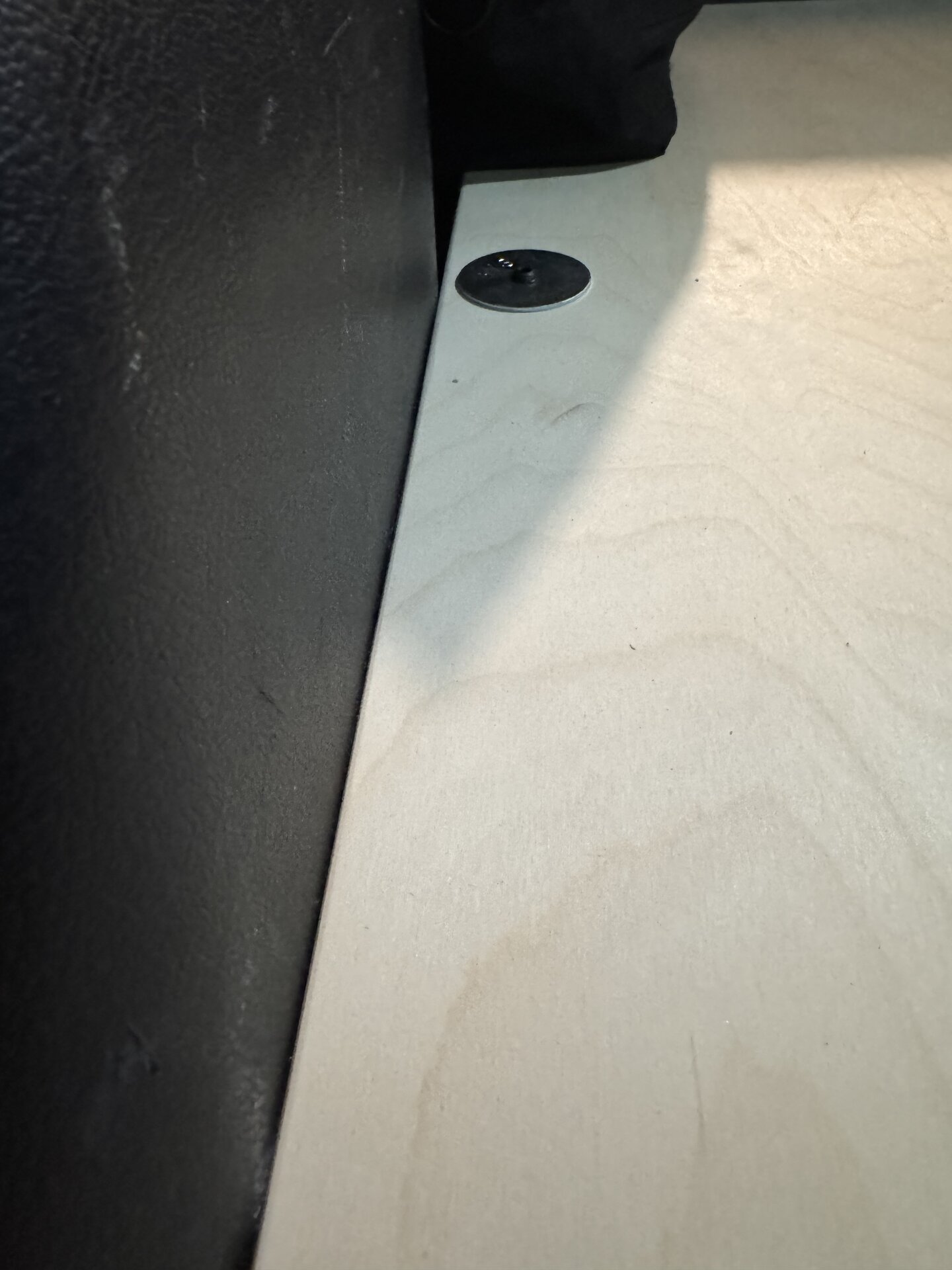

What's the depth measurement of the top of your platform? I am considering undeleting my second row and want to see if that's feasible or not without having to take everything apart and re mock it up.
Platform top is 43”w X 36”d. I maximized the space so it’s about 5/8” away from my table folded up and maybe an 1/8” from the seat backs slid all the way back in the standard upright position. Its about 1/16 from touching the wheel well trim on either side. I’ll probably round off the edges with a router after I add the laminate Im planning on covering it with.

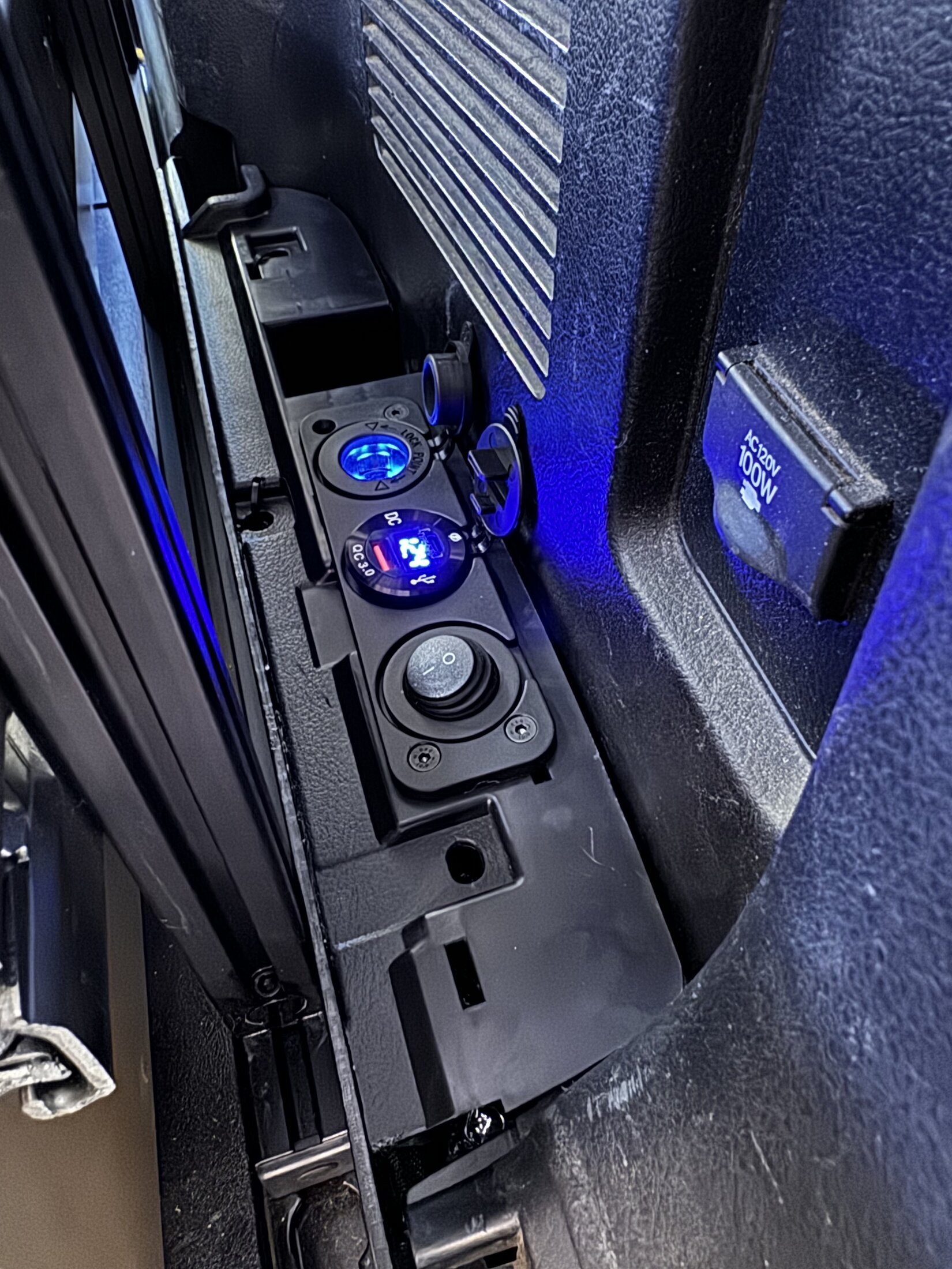

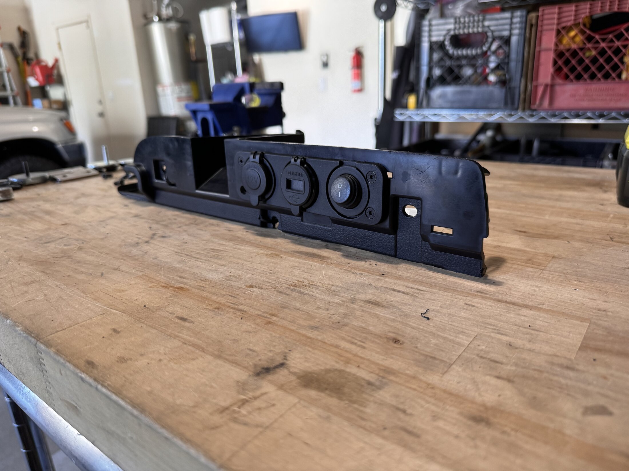

I was wracking my brian on how to build a side wing that would hold my power setup in time for my trip this weekend when I realized how easy the third row seat side wings would convert into a power panel.
I just removed the carpeted top (a few screws) used a 3 hole power panel as the template and grabbed my hole drill. Super easy and has the added benefit of hiding the cabling in the area the harness lives anyway.
