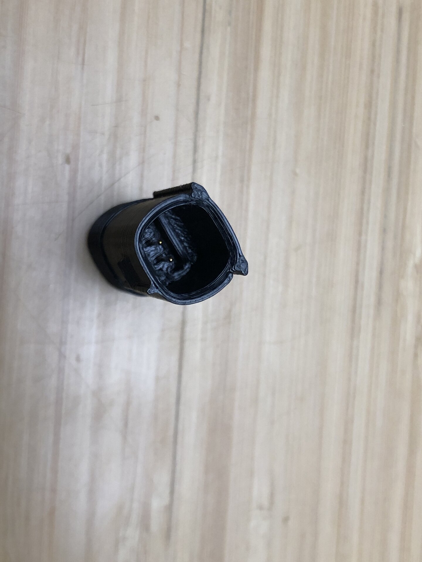

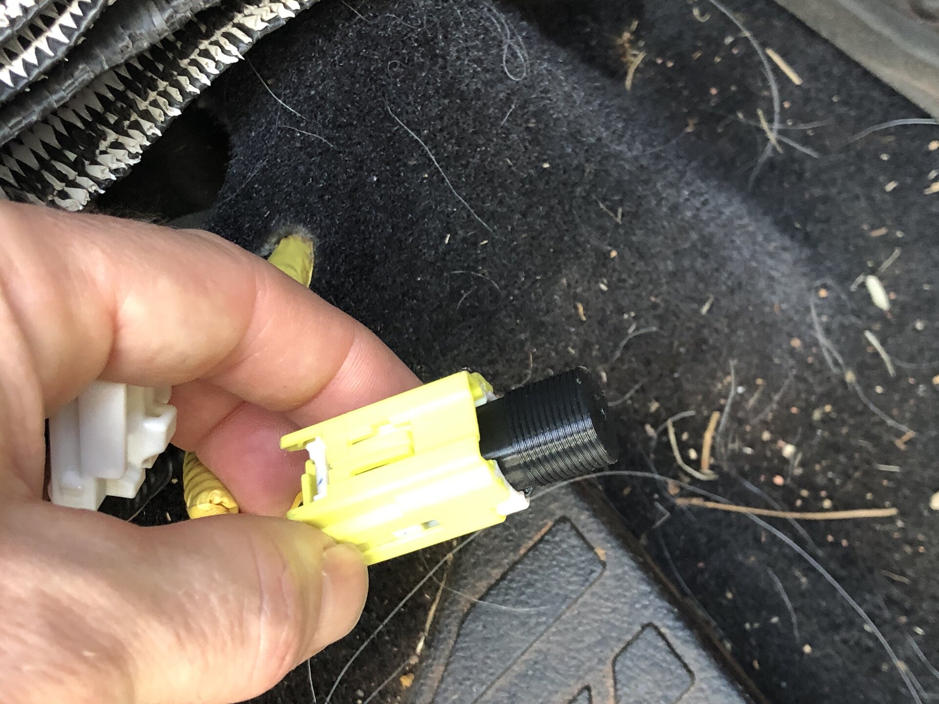

If you leave a seat out you might want to look at one of these - Airbag Simulator/Emulator for Toyota & Lexus - Brad's Hacks - https://bradshacks.com/product/airbag-simulator/
Airbag dongles. No wiring up your own resistors. He 3d prints the seat side of the connector and inserts the proper resistor to kill the dash light. $30 and zero minutes instead of $15 in parts and an hour of assembling and soldering! Going to make a separate post when I get a sec.
