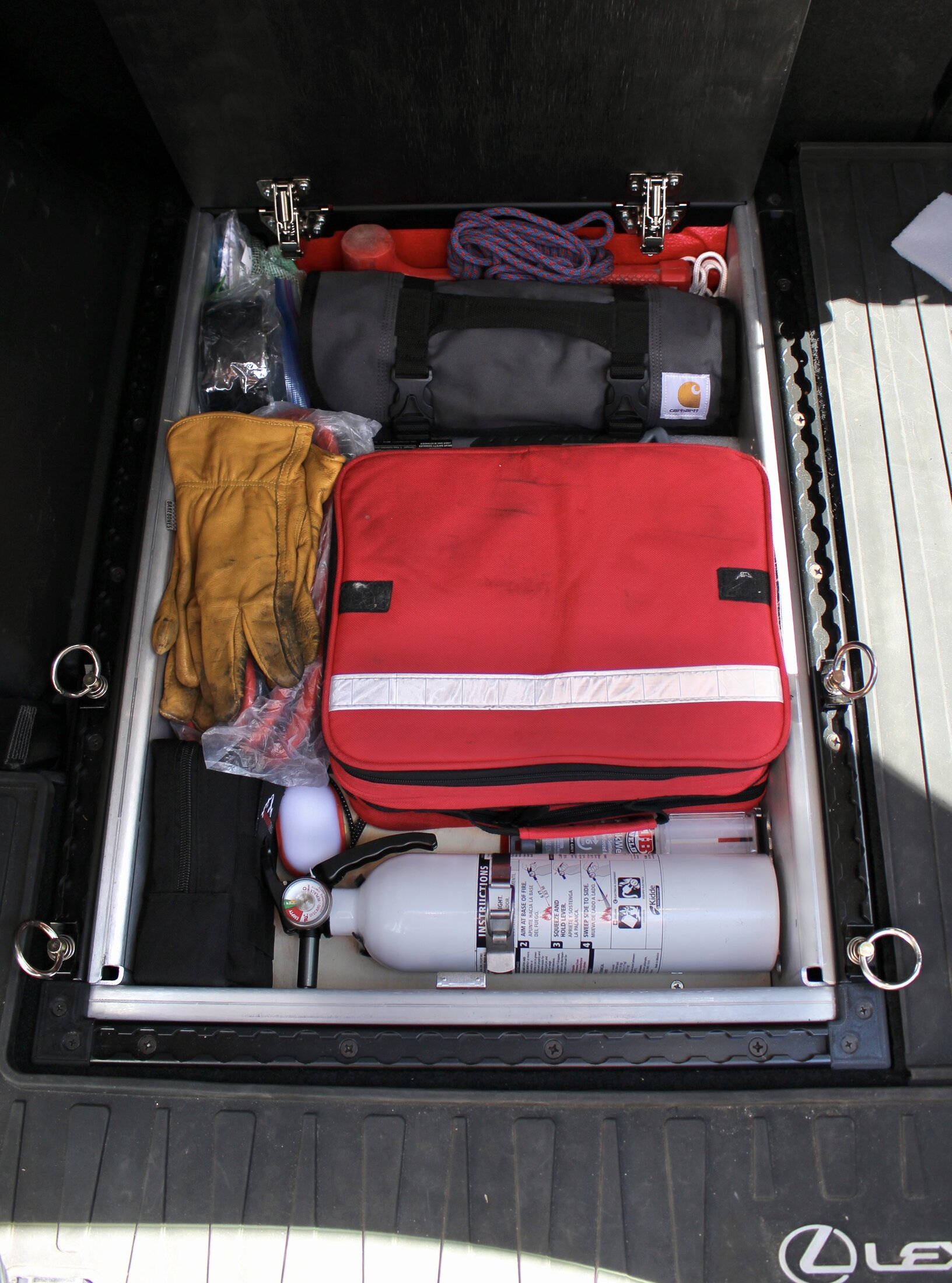

What a couple weeks. Road trip through southern Utah was amazing. Cargo cache worked perfectly to keep our basic emergency supplies, small cooler, inflator, 5-gal water jug, and (half-of) our camping "toolbox" secure during mild to moderate off-roading. This past week has been the often inescapable post-vacation scramble to catch up on "work" work.
Regarding the cargo cache, I've spent the past few days working to determine safe load ratings using online research, calculations, and FEA simulations. What I've found is that the aluminum structure is a bit more limiting than I hoped but still feel it's adequate for many people's uses, including mine.
Using the mfg. working load limit for the door latch (and a generous safety factor), the calcs show that the hatch door latch can contain 50 lbs of evenly distributed, un-secured items even in challenging off-road conditions. Probably pretty difficult to find 50lbs of things that fit in there. Regardless, securing heavy/hard items to the floor or walls of the cache would be the safest, quietest, and least abusive.
Total payload limit, inclusive of items secured on top and in the cache, varies depending on road conditions and driving style (based on g-loads). The load limits take material fatigue into consideration and assume evenly distributed cargo.
View attachment 3878945View attachment 3878947View attachment 3878946

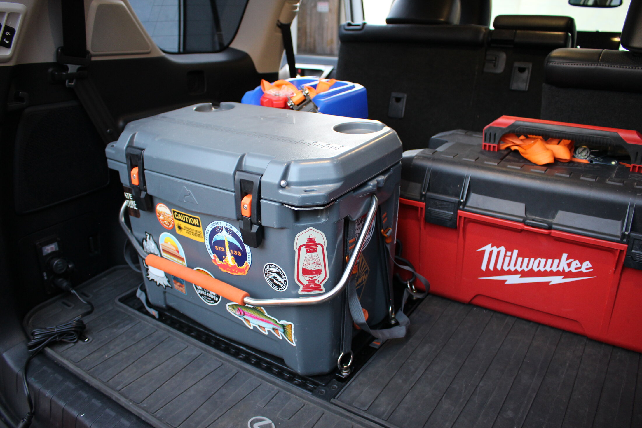

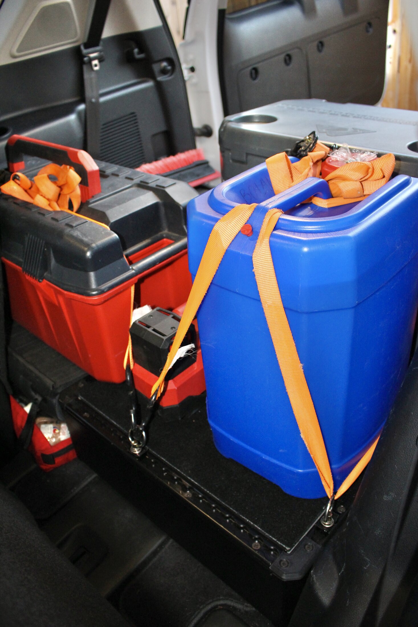

Our family goes off-roading, camping, and road tripping in the GX with 2 kids and a large dog and we have a topper that I put on when we need it.
Storage is a struggle, and I've been wanting a better way to keep the cargo in the GX organized and secured. Not to mention, some tools and supplies I'd like in the GX at all times.
I've looked at the various storage solutions out there but most remove or effectively disable the 3rd-row seats. I also want something that is easily reversible if it ever comes time to sell.
Not finding what I wanted, I decided to develop something.
Self-imposed constraints:
  • Retain full height, flat cargo area for hauling stuff about.
  • Add tie-downs for securing heavier items (cooler and water jug).
  • Keep one 3rd row seat operable for the periodic shuffling of kids and their friends to and fro.
  • Keep one side of cargo floor low for hefting dog into back (90lb lab has decided he will not jump in the GX, even though the jump is well within his abilities).
Here’s what I’ve come up with:
