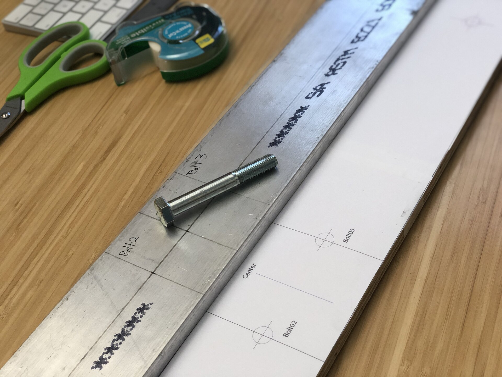

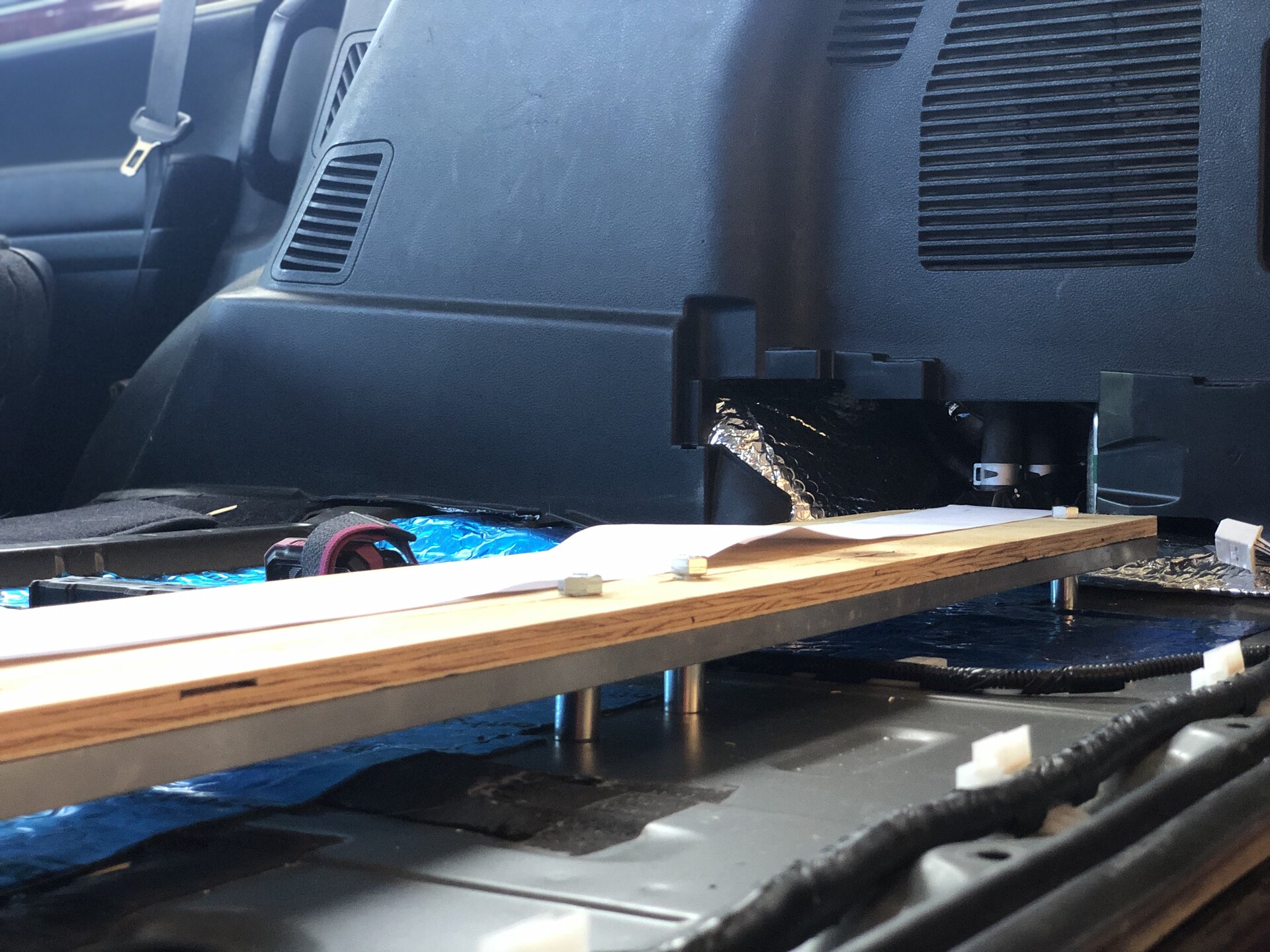

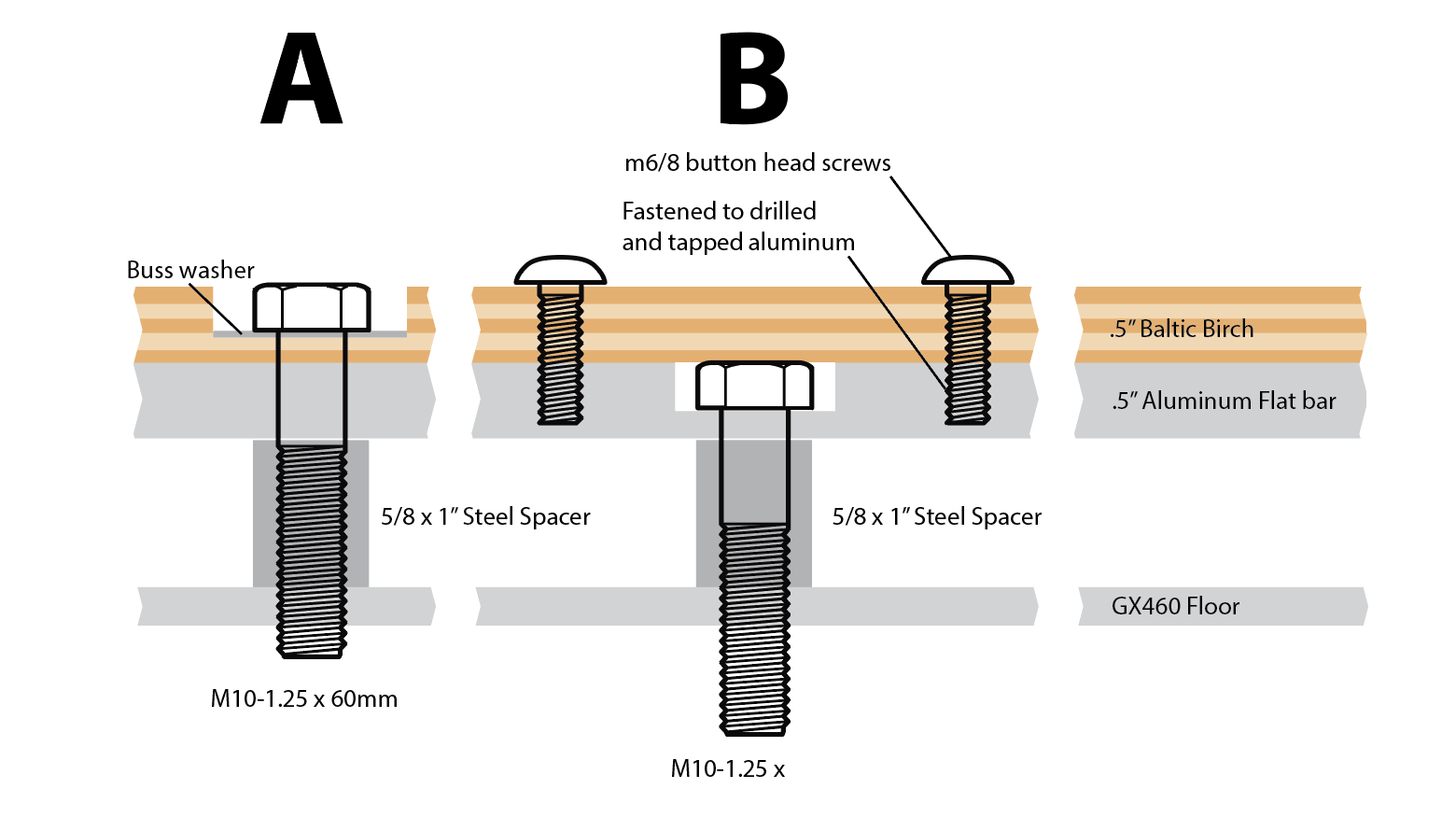

What do you guys think. Approach A or B? I'm using a .5"x3"x40" aluminum bar across the factory seat anchors to support the plywood and tie other stuff into (future drawers, etc.).
With 'A' It would be easy to recess the bolts into the plywood but then I'd have to deal with the recesses filling up with crap and the reduced strength. With B I could just recess the flat bar and then use smaller button head screws into the aluminum bar.
Any of your engineers know if tapping into .5" aluminum with m6/8 steel bolts advisable? Is aluminum strong enough to tapp and hold the wieght of a drawer system?

The rear plate I made was more like option A. Makes it nice when you slide things in to not have it catch on the way in. Thankfully most loads that get put on the floor are compression loads. Unless you plan on bolting down some heavy stuff to it I'd stick with A.
"B" depends upon how many bolts you're planning on using. If it's just 4 bolts, then no. If you're using a bunch then that'll work find but you are using more fasteners.
Personally I'd opt for "A". Reasons:
  • Less hardware.
  • As Thed351W mentioned, nothing protruding above the surface.
I really don't think there's a strength issue if you use enough hardware with option "B".
And if you're really concerned with the counter bored holes collecting debris, then get some cheap caps for the c-bores: McMaster-Carr - https://www.mcmaster.com/products/plastic-end-caps/

The flat bottomed hole in the bar for plan B will be hard to make unless you have access to a milling machine.
I'd probably just do A. I'd drill the pocket with a spade bit and then use the center hole from that as a locator for a pilot drill to make the through hole. When drilling a hole where depth is important I put tape on the bit where I need to stop.
I built my platform similar to your design A. I used flat socket head cap similar to these : M10X1.25 Fine Allen Socket Flat 10.9 DIN 7991 - https://belmetric.com/m10x1-25-fine-allen-socket-flat-10-9-din-7991/?sku=SF10X1.25X30&gclid=EAIaIQobChMIy-G8xY-t_gIVTSqzAB0kygXTEAQYDSABEgLkq_D_BwE
Paired with a countersink drill bit you can have the head sitting perfectly flush with the platform.
I was actually thinking about going the same direction as another option, but I was worried that the counter sunk opening would be less strong than the dado opening with a bus washer. That would be a whole lot easier than cutting recesses for bus washers, though…

I have a very simple wooden setup like B actually. Wooden slats as spacers, this allowed me to use the stock seat bolts with their large heads, and the thinner 1/2" platform material. Then T-nuts in the bottom of the spacers for the platform to bolt down to. I used countersunk flat top phillips head machine screws for a flat surface.
Actually did my first version like A as its simple, and I was using 3/4 ply so the bolt heads could countersink and then it was carpeted.
Design A seems more practical and such.
Well, I think you’re almost all in agreement. A it is. That will also allow me to easily swap the center bolts out and add a bracket to connect my T-slot frame to the truck in the center.
Getting the drill press out this morning. Appreciate you guys chiming in.

It may be too late, but if you used some flat head machine screws instead of button heads for option B, you'd have no recess or protruding screws. You can just countersink them in the plywood.
