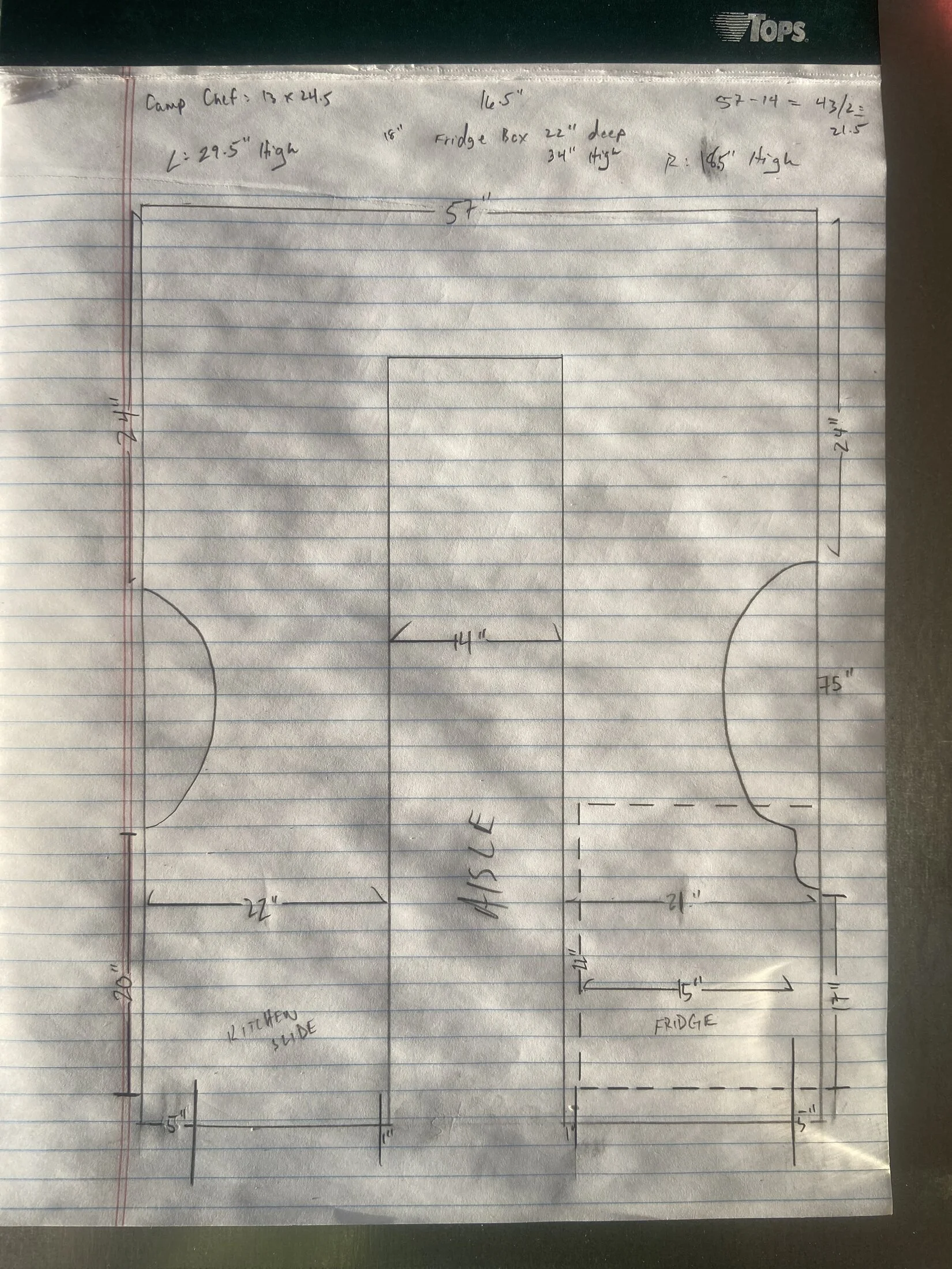

I'm starting to do my fitout build.
Lots of 80/20 on the way to my location. I'm using this on the floor : Luxury Liner Pro™ Sheet - MLV + Foam - https://www.secondskinaudio.com/sound-blocking/luxury-liner-pro

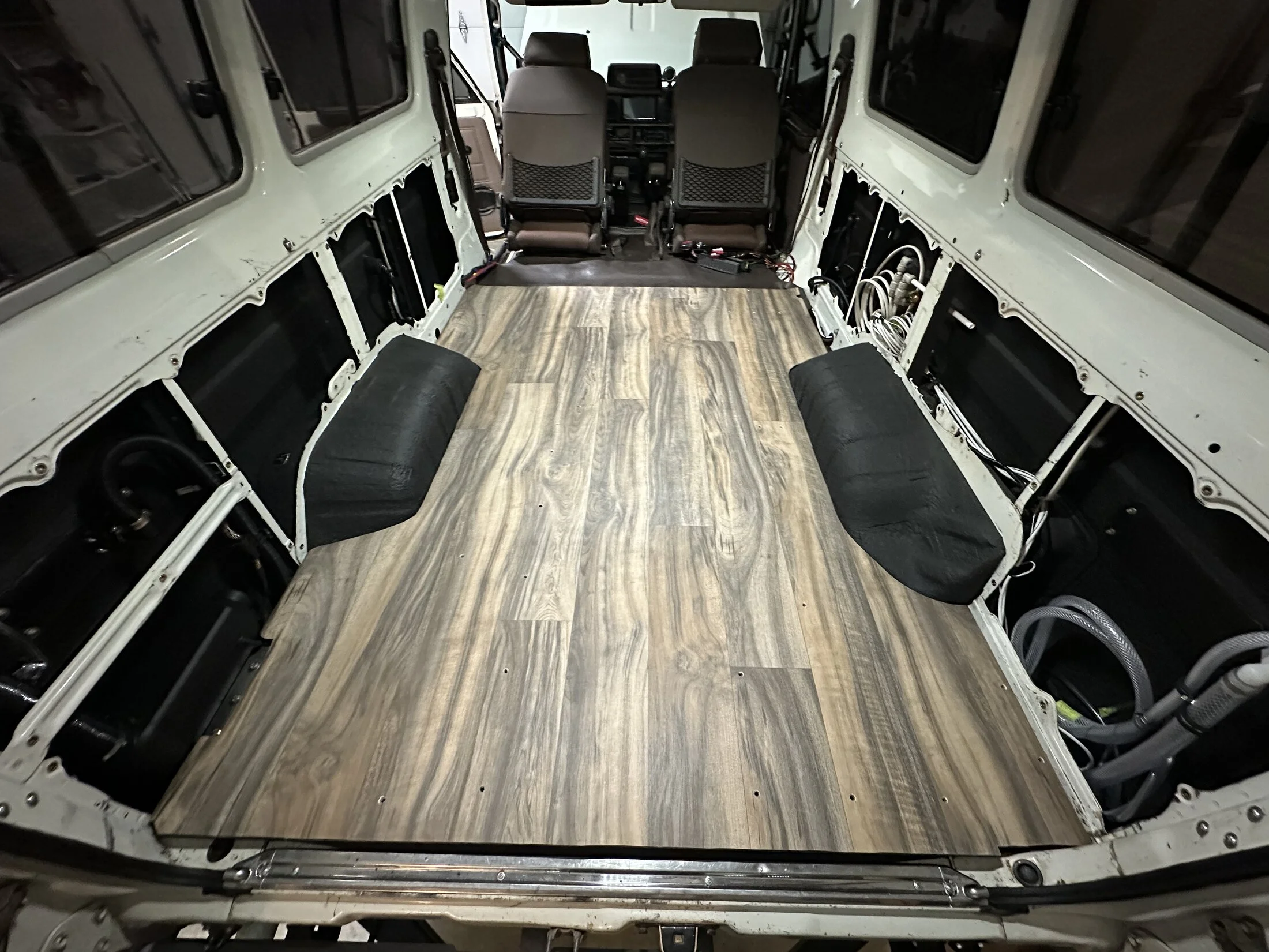

What is everyone using for flooring? And how are you attaching it to the vehicle floor?
Left side will be a slide out kitchen on a 60" long slider. Right side will have the fridge. Not sure if I should have the bench seat in the back on the right or left side.
Need to incorporate a trelino toilet, but not sure if I should do the U shape or have an aisle to the front seats.
Electrical cabinet will be behind the passenger seat

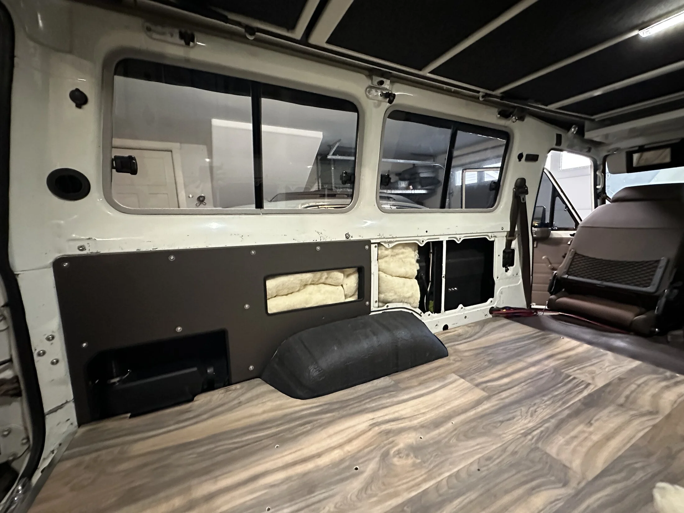

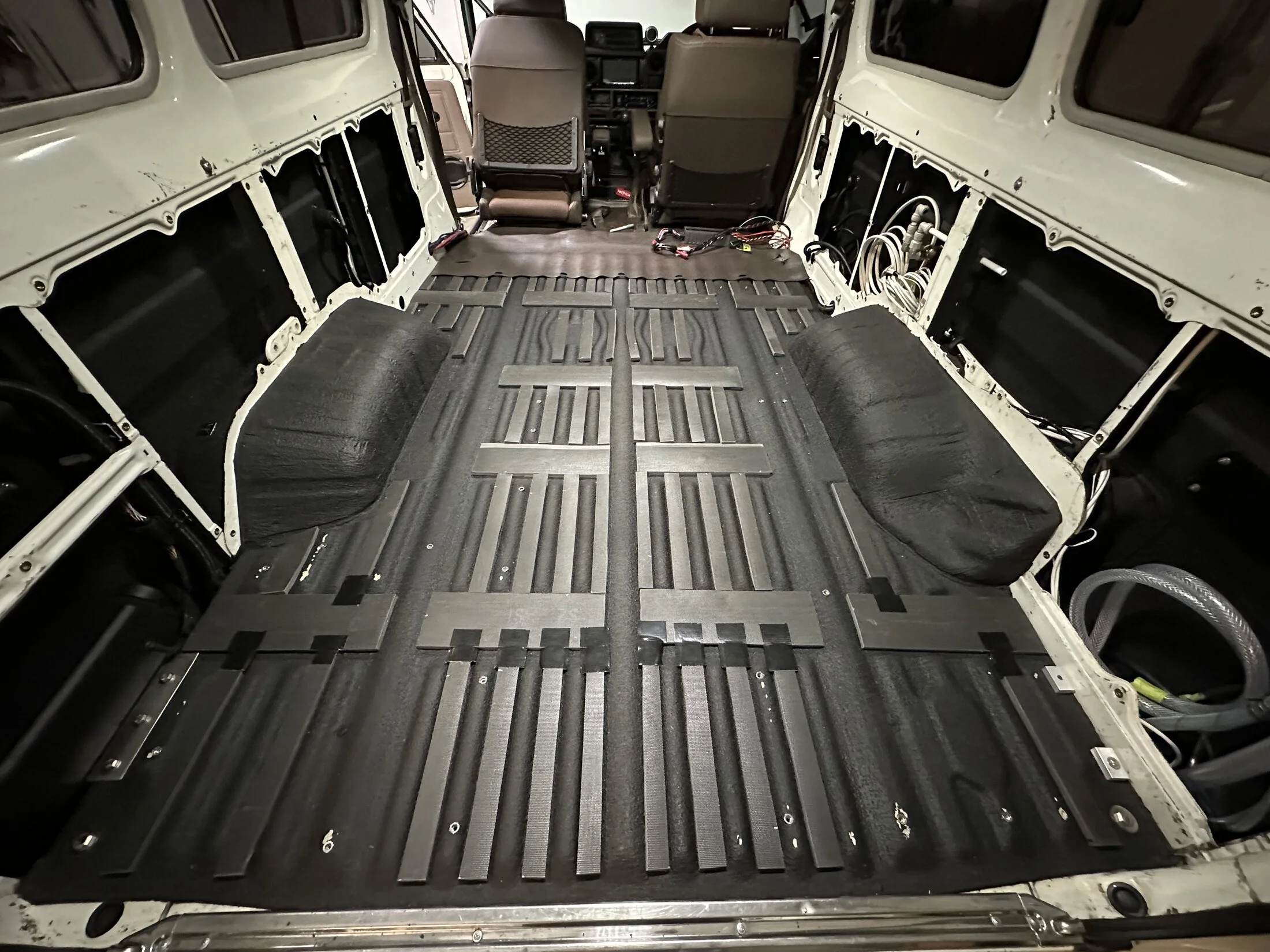

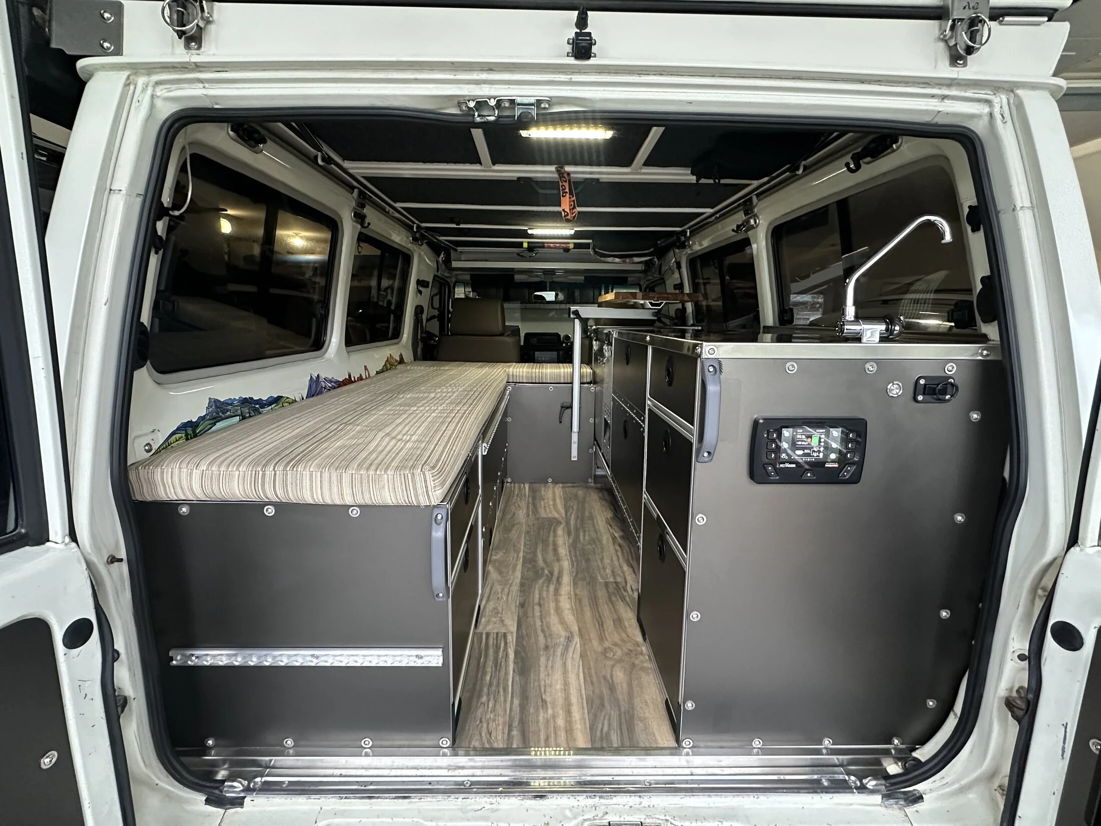

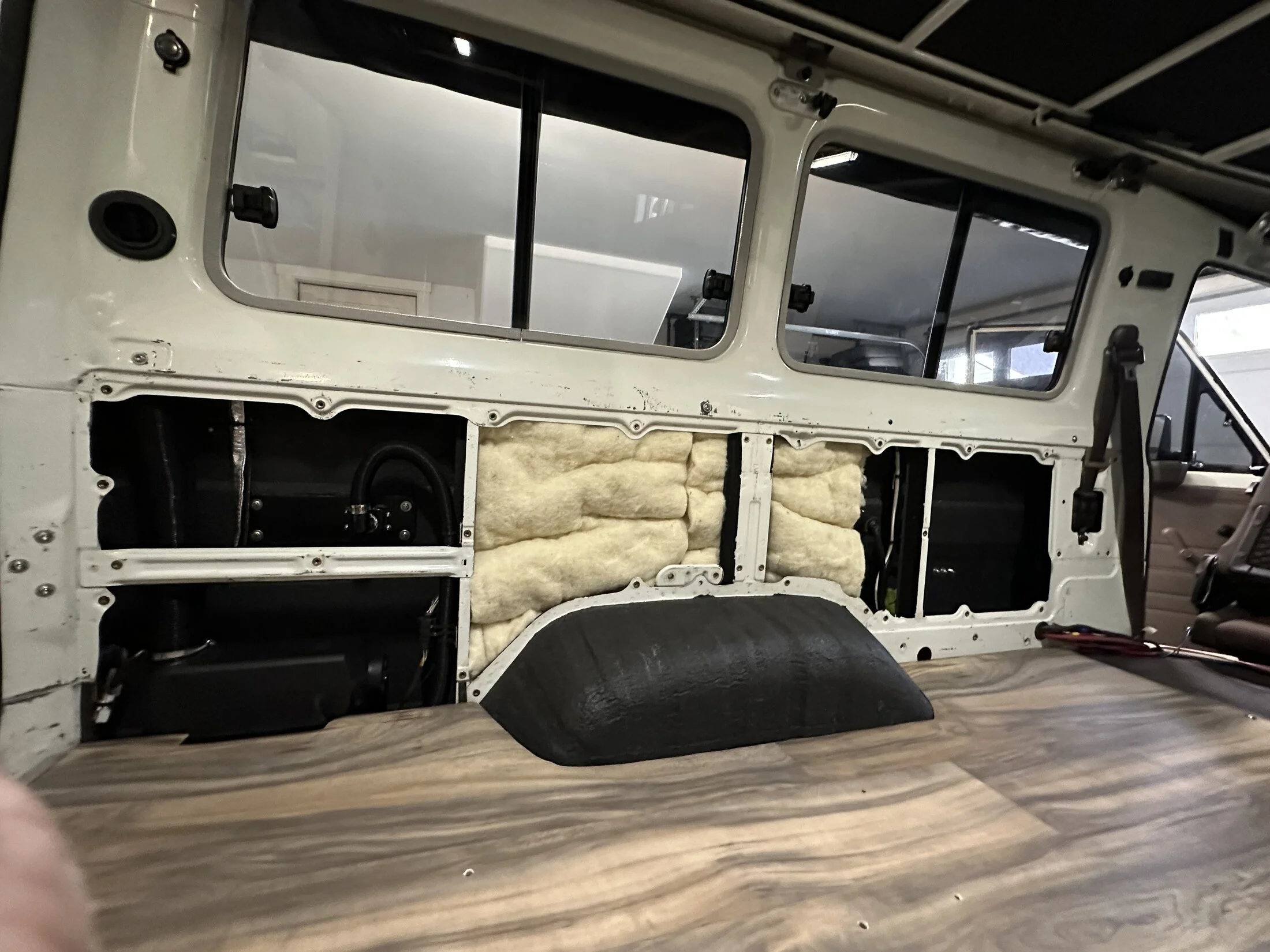

I used 1/2 inch plywood, which I sealed, then used a single sheet of vinyl flooring glued to the plywood. The intent was to create as much of a sealed interior floor as possible, with only the holes through the vinyl and plywood being only place for water intrusion from above.
I used stainless steel 1/4-20 riv-nuts sealed around the edges with Sika 291 sealant. Anti-seize used on the stainless steel bolt threads for anti-galling protection. The 1/4-20 bolts went through my extruded aluminum cabinet framework to securely attached the framework and plywood to the Troopy floor.
For sound deadening I used Second Skin sprayed on the floor and inside the walls. Walls were then filled with Havelock wool batts for added sound deadening and insulation. For the floor, I also added strips of Luxury Liner Pro for added insulation value, but left gaps in the flooring for breathability in the event moisture was to form, it had a means to ventilate (hopefully).
18 months post build completion and I wouldn't change a thing. Cabinets have been rock solid, no rattles or loose junctions. Vinyl floor is soft and comfortable to walk or kneel on and the clean-up is easy and practical.
18 months post build completion and I wouldn't change a thing. Cabinets have been rock solid, no rattles or loose junctions. Vinyl floor is soft and comfortable to walk or kneel on and the clean-up is easy and practical. View attachment 3762796View attachment 3762797View attachment 3762798View attachment 3762799View attachment 3762800
