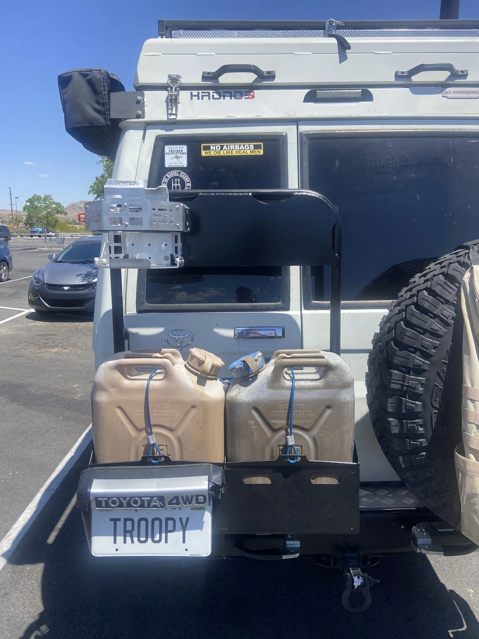

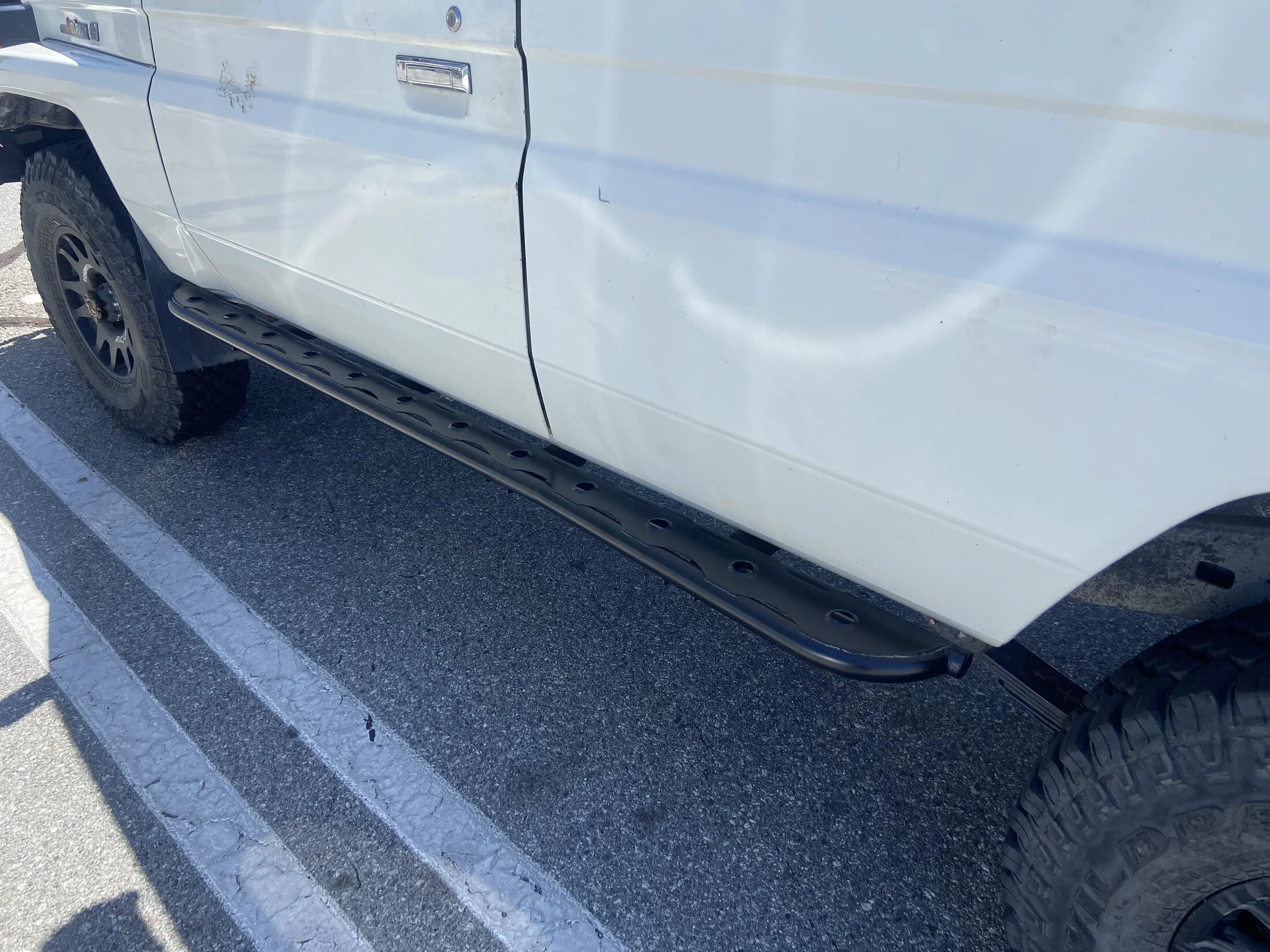

Sliders look great and I also had them add a small panel on my rear swing out to hold my propane tank and eventually something else.

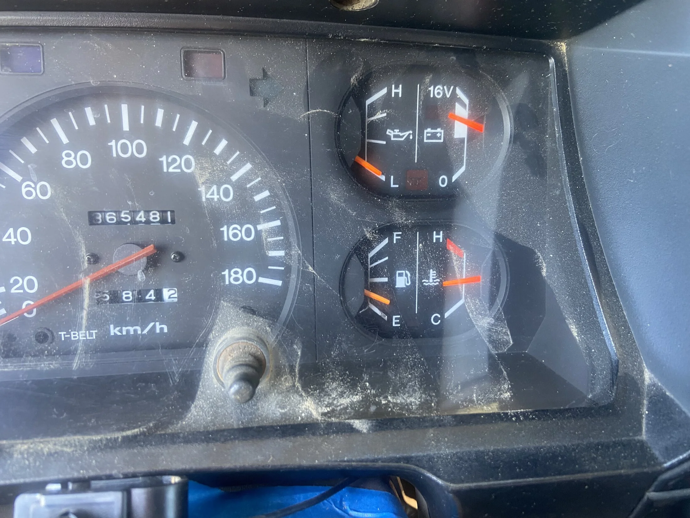

Now my power bastard 1FZ alternator is no longer putting out too much voltage and the air filter, battery light, and parking brake light actually turn off 🤣.

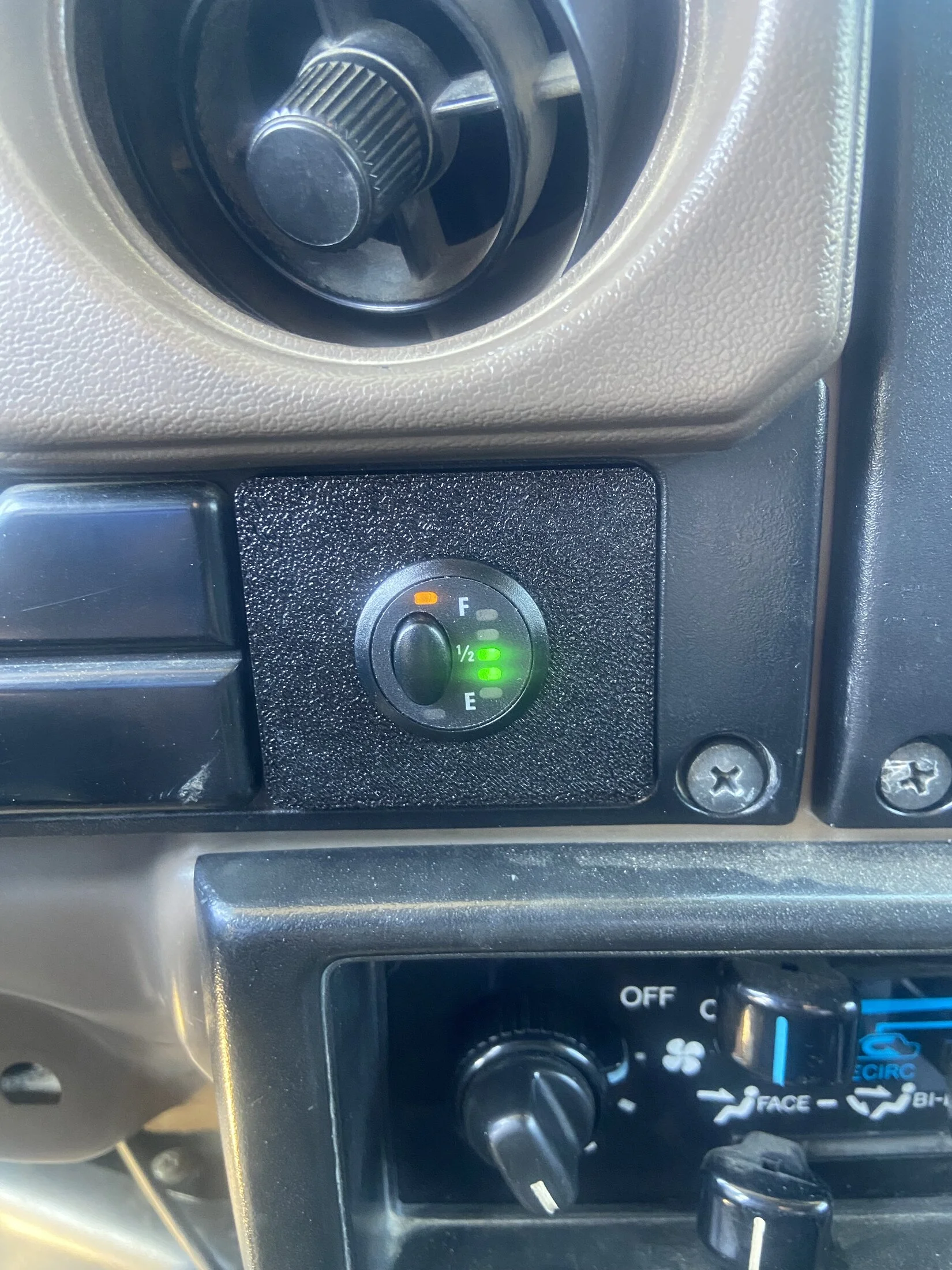

Also tested the aux tank - fills great. Quarter tank to full in about 45 minutes.

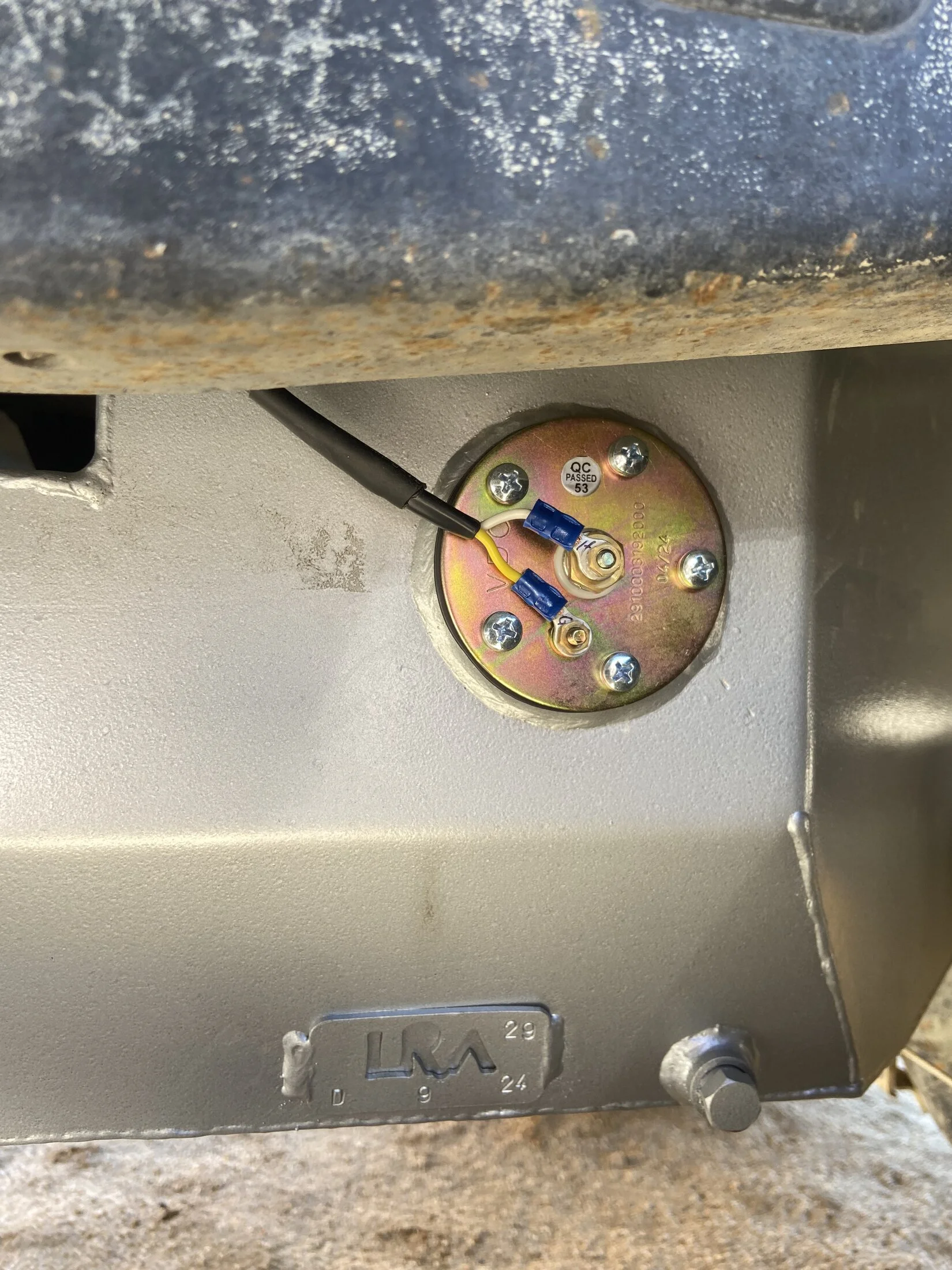

Also, anyone else with an LRA aux tank? They told me this connection doesn't need to be covered and is "fine without a covering".

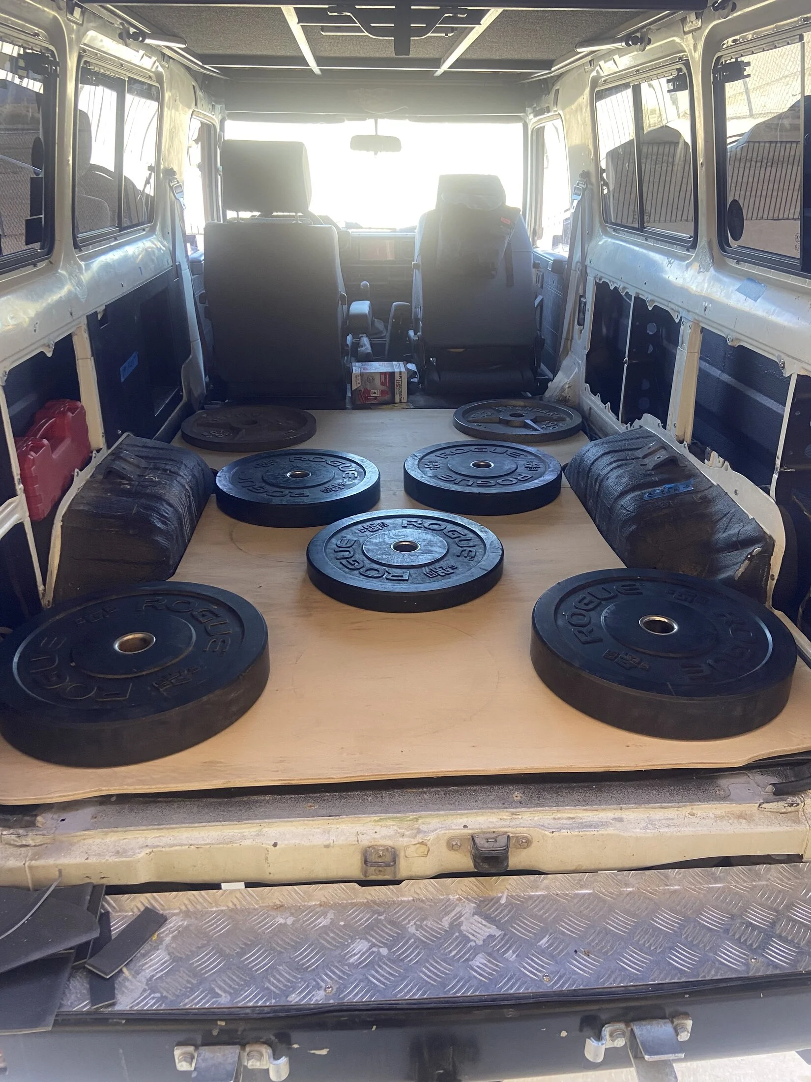

Subfloor installed. Interior fitment starts next week!
Two sheets actually. Width of the troopy is like 51 inches so a 4x8 won't fill it.
Did you glue, dado, or biscuit the two pieces together?
Nope. Just butted them against each other. The seam won't be exposed as I will put flooring down the aisle.

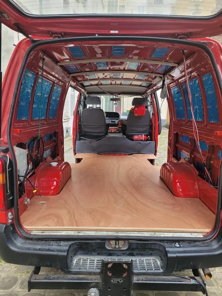

5x10 sheet plywood can be found at specialty shops, ones that mostly cater to boat builders and cabinet makers. They are pricey and may not be worth the expense for a "floor", but if you wanted a continuous panel it's out there.
This site has options:
And result can be really nice
1745450694062-png.3891103
But it has to be noted that it's a total PITA to manipulate that big of a plywood sheet and you always need to be 2 to move it or install it.

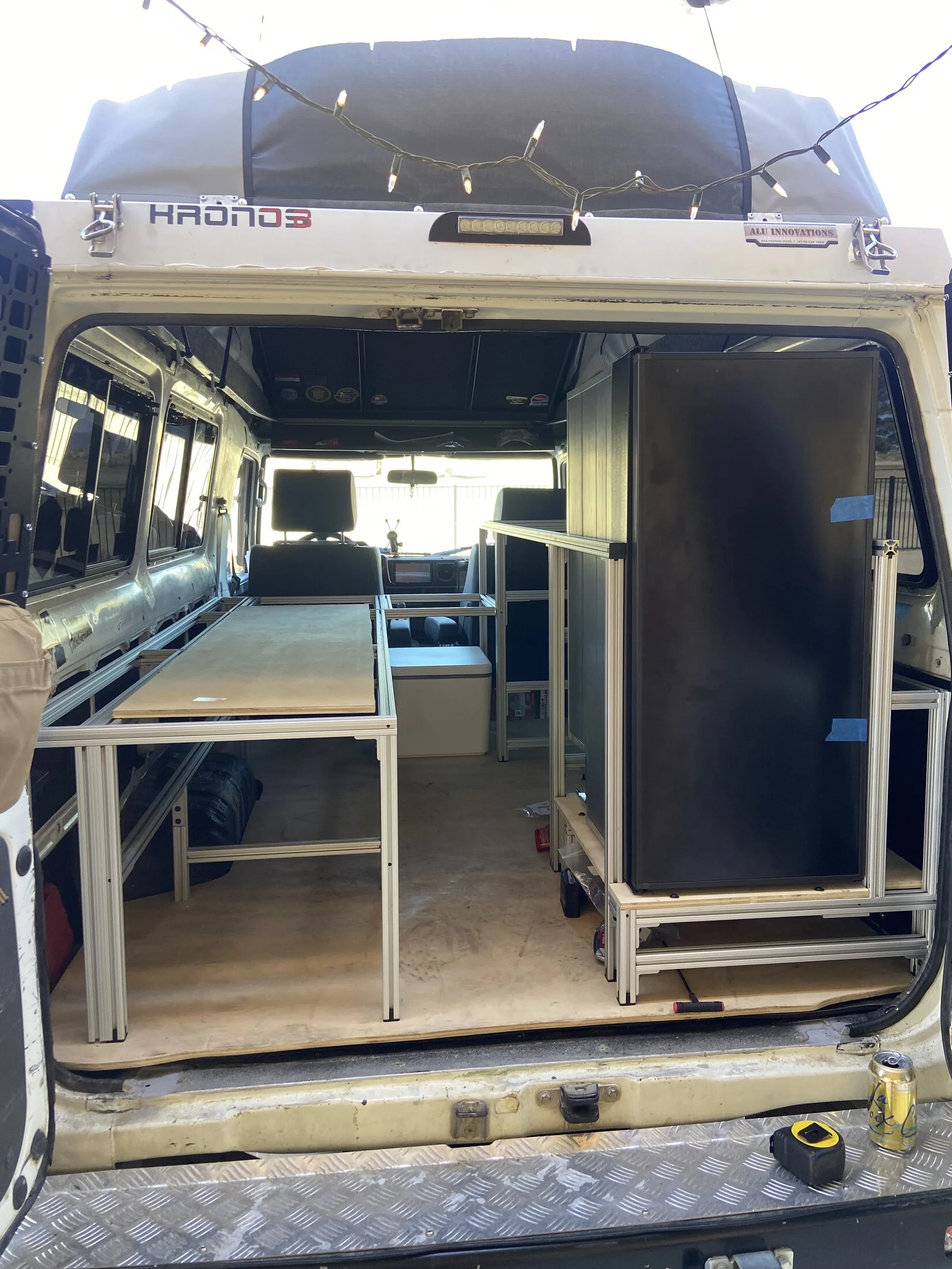

Great news. The two most important parts of my build out, the toilet and fridge, both fit in my modified 8020 setup.
Nice. But that LaCrotch...?
Are you going to secure the 8020 to the floor or wall once you've got it all sorted, or just rely on gravity to keep it in place?
What's the volume of the fridge? Looks big.
Composting toilet by trelino. Mainly to have it and not need it.
I'll secure the 8020 to the side panels and the floor.
Fridge is an Indel B, 86 liters. Has the danfoss compressor everyone raves about. OFF Indel B CR86 Cruise 3.03 Cu.Ft Refrigerator - https://www.heatso.com/86-liter-off-indel-b-cruise-refrigerator-freezer-cr86/
