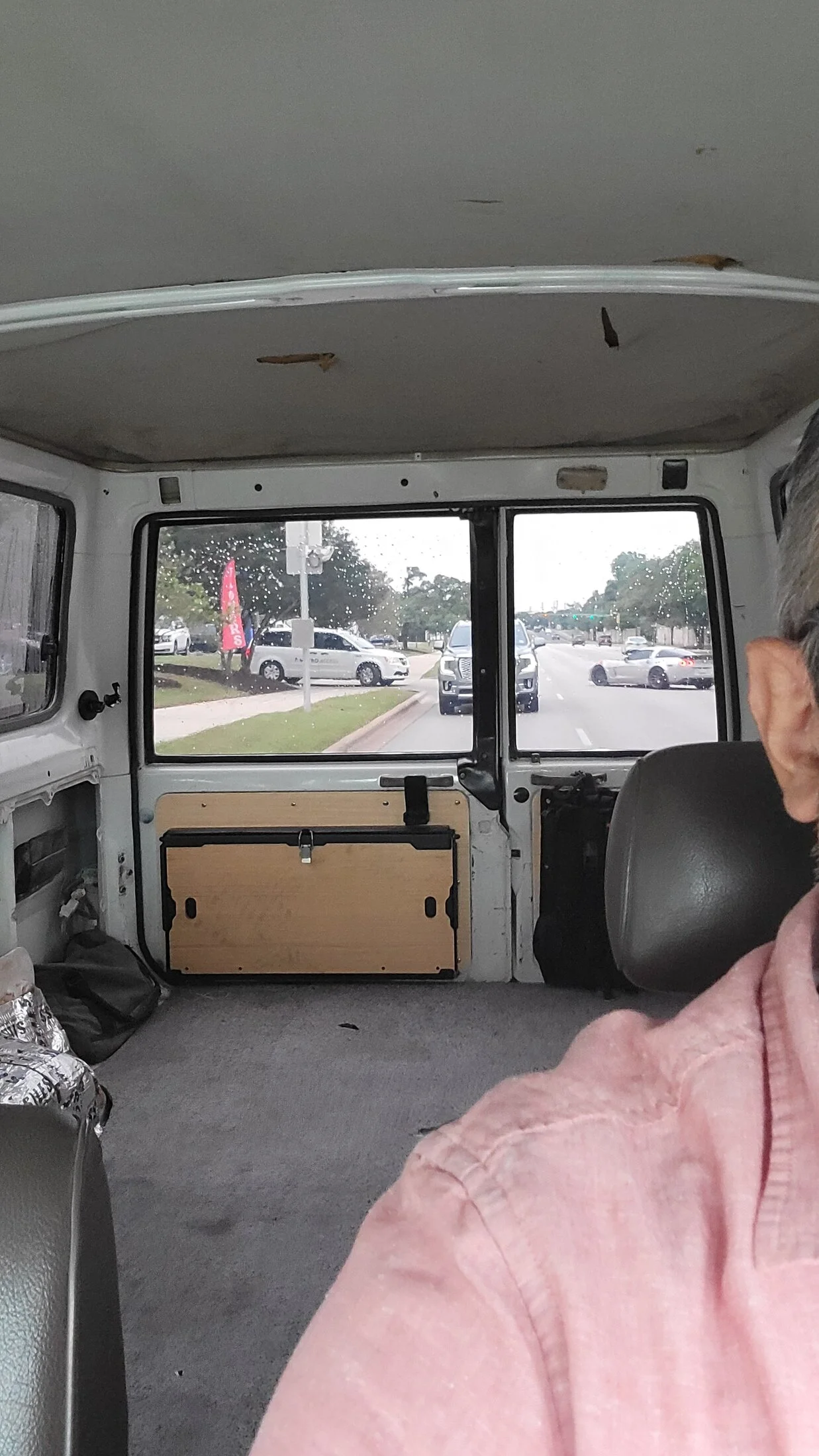

In an effort to conceal whatever I'm carrying in the back (like my mountain bike) and to also help with the heat I decided to get ceramic tint. Darkest in the back and legal limit up front. I also got the cheesy unibrow on the windshield. LOL!
View from the inside.

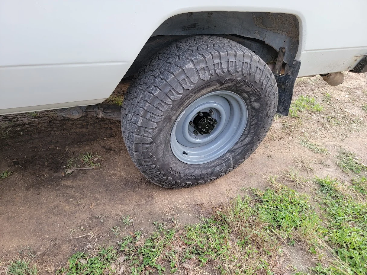

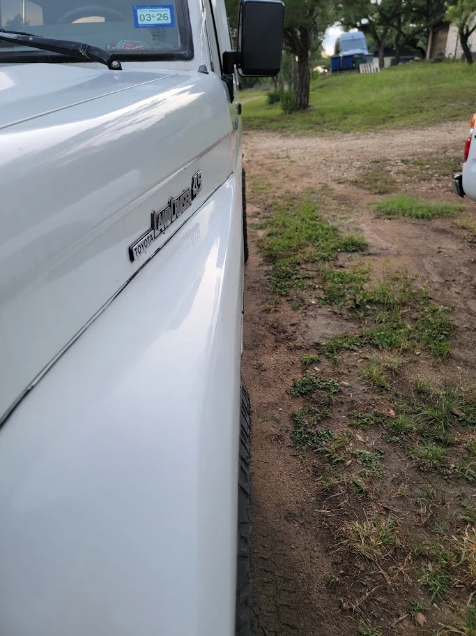

I was having some bad rubbing issues with the 285 tires on Smooth Vintque 16x7 wheels with 4" backspacing and noticed a post by @wngrog 'mentioning that he had the same setup and used spacers in the back. He said that they weren't necessary in the front. Since my truck came with spacers in the front, I moved them to the back like Nolen and the rubbing is now gone and the wheels are now pretty flush to the fenders.

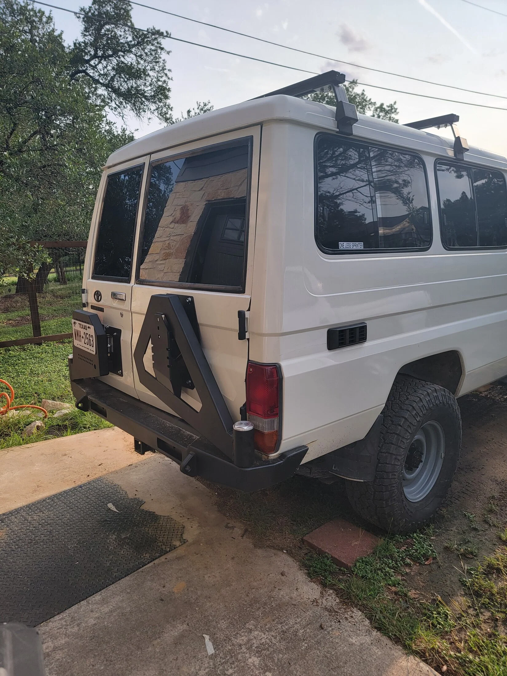

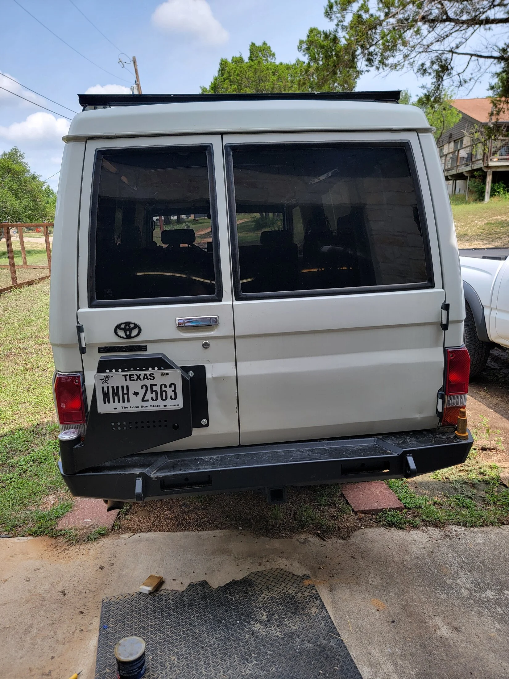

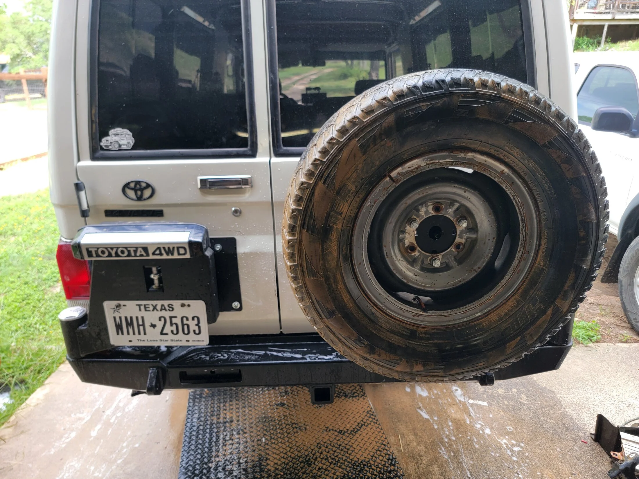

Got one side on. I need to figure out what Jerry can holder I'm going to run and also how to mount a light for the license plate.
Yes, I freaking dinged the right hand door on the damn swing arm pivot. Ugh.

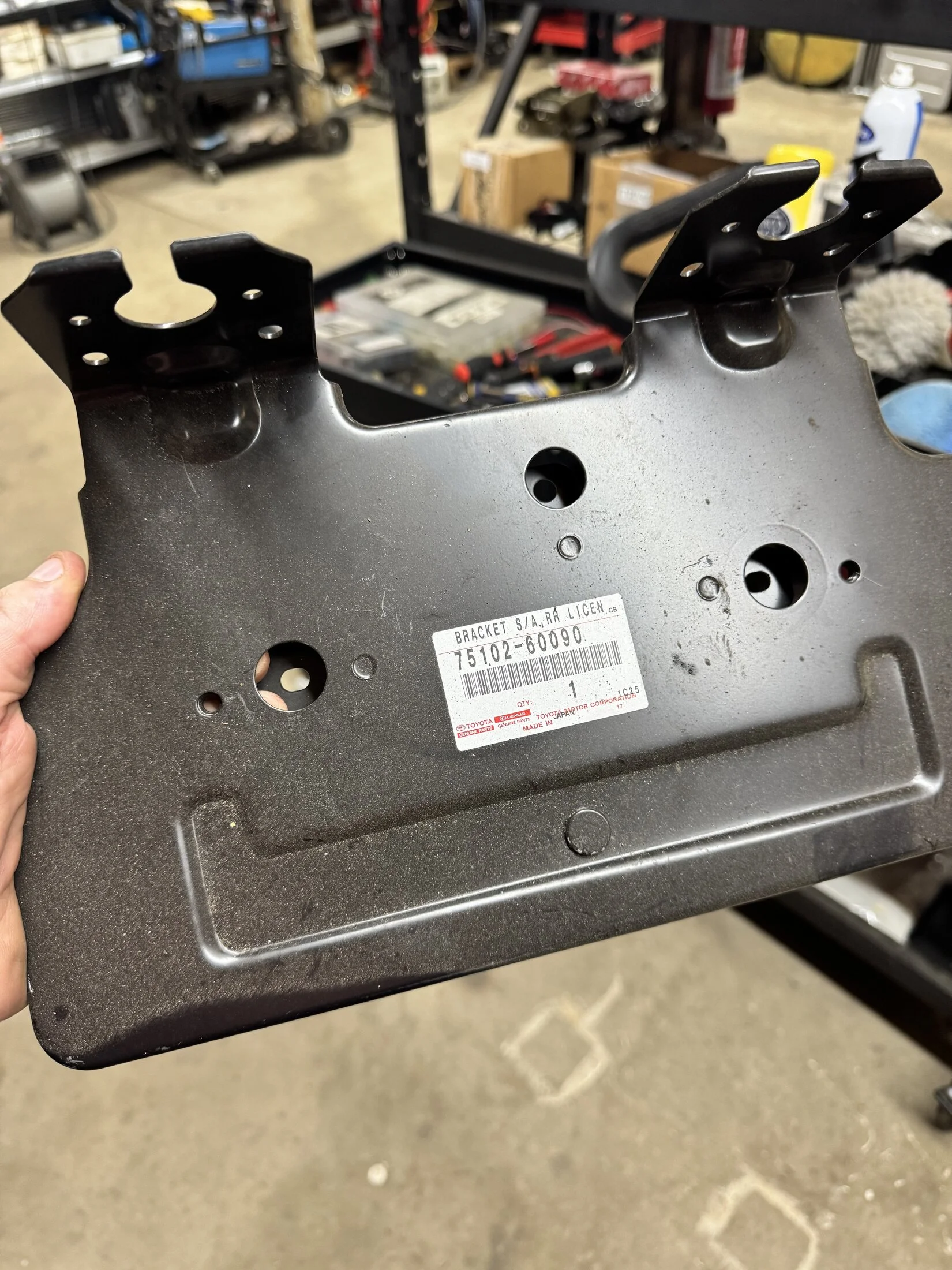

I think you could run the OEM 70 series Toyota tag holder, light assembly on the swing out. Just need to extend the wires and route them.
Different bumper, but I have the same ding on my door from the spindle 😂

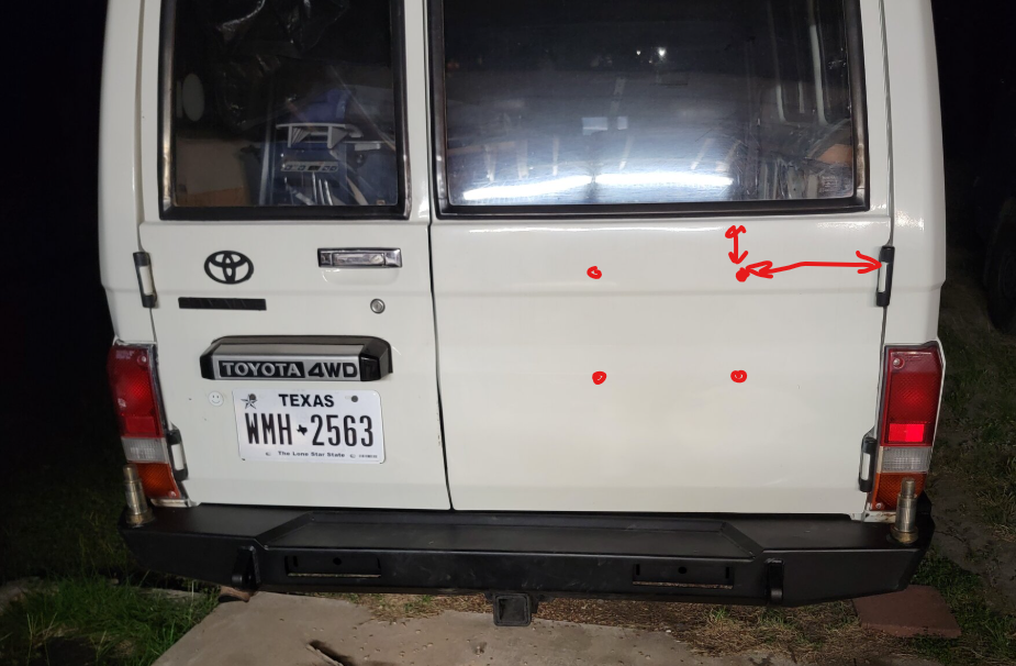

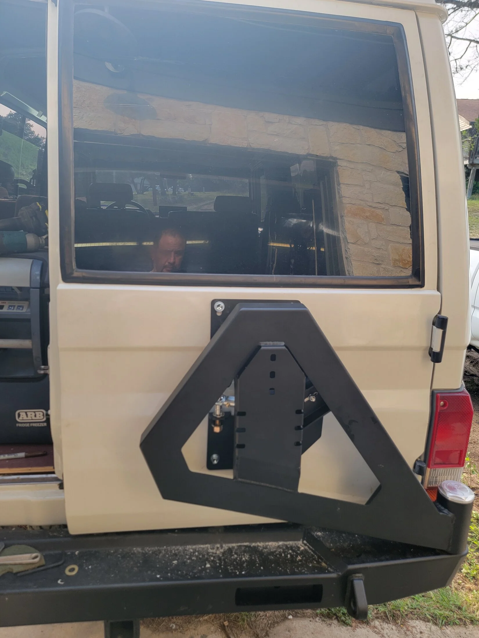

Does anyone have the dimensions to the tire carrier mounting holes? My truck didn't come with a tire carrier on the door and I need to install a plate for the Cruiser Outfitters @cruiseroutfit swing-out.
I can help you with that tomorrow morning but this door is too weak for a spare bracket. I believe it has some supporting behind the sheet
Like a dumbass, I forgot to remove the spare tire before installing the new bumper. I struggled this morning but I got it out. Damn that split rim/285 combo was heavy! Got the license plate light bracket installed temporarily before the fuel can holder gets here next week.
