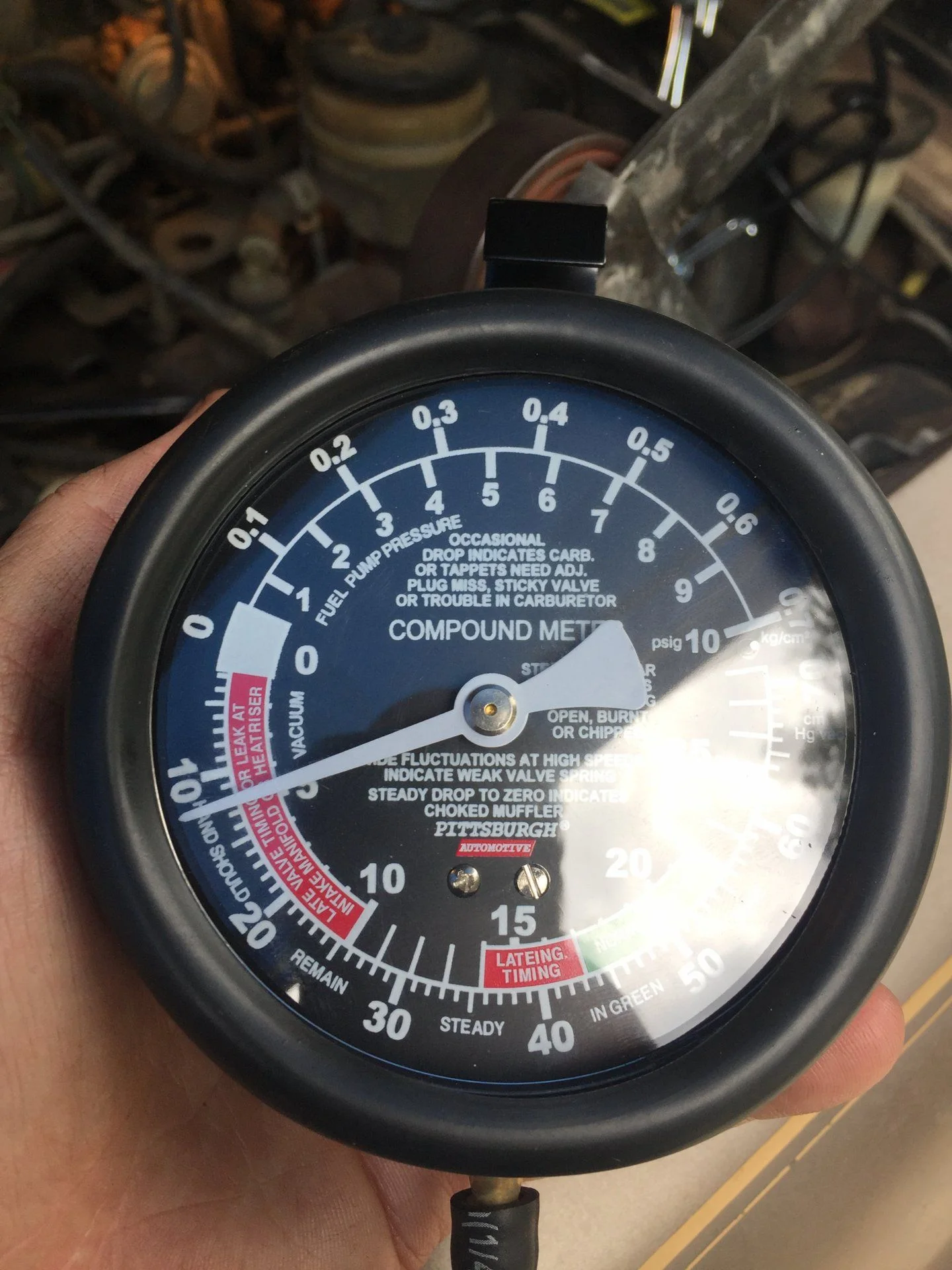

I did a vacuum gauge test and as you can see it was spot on perfect! I couldn't be happier. I adjusted the idle on the carb to get it around 800 RPM's and she's running like a champ!
Hmm, that's an interesting port to use. I always use the one off the brake booster finned thing. Looks good tho. I'm a little green. :)

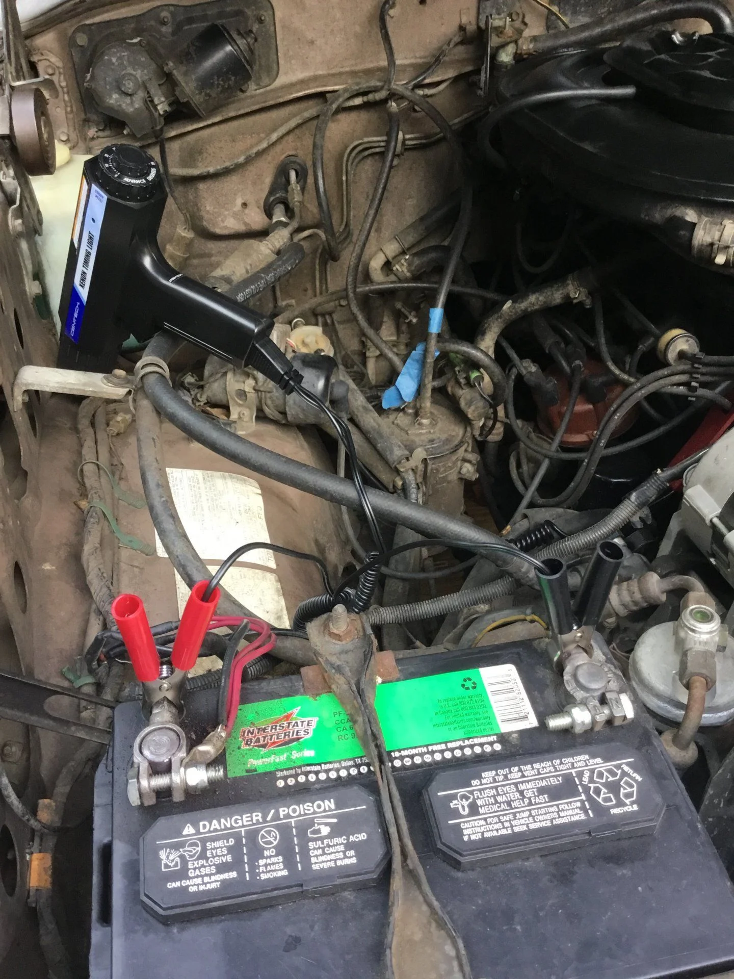

Thanks to some great help from @CaptClose tonight i adjusted the timing. It was set at 3 degrees BTDC instead of 7. I got that fixed and it's all set. It took me forever to remember where the cover was for the flywheel viewing area so I captured a pic for others that may have trouble too.
Also, for others that may be adjusting the timing the bolt to loosen to move the distributor is below the distributor on the right at 2 o'clock when standing on the passenger fender. You loosen it and the whole distributor rotates. I thought that bolt was to just hold the distributor on and not to adjust it so I didn't try it forever. Finally got it.

You think this pipe could be it? You can see what my vacuum gauge is reading in this pic. Pretty big honkin leak!
