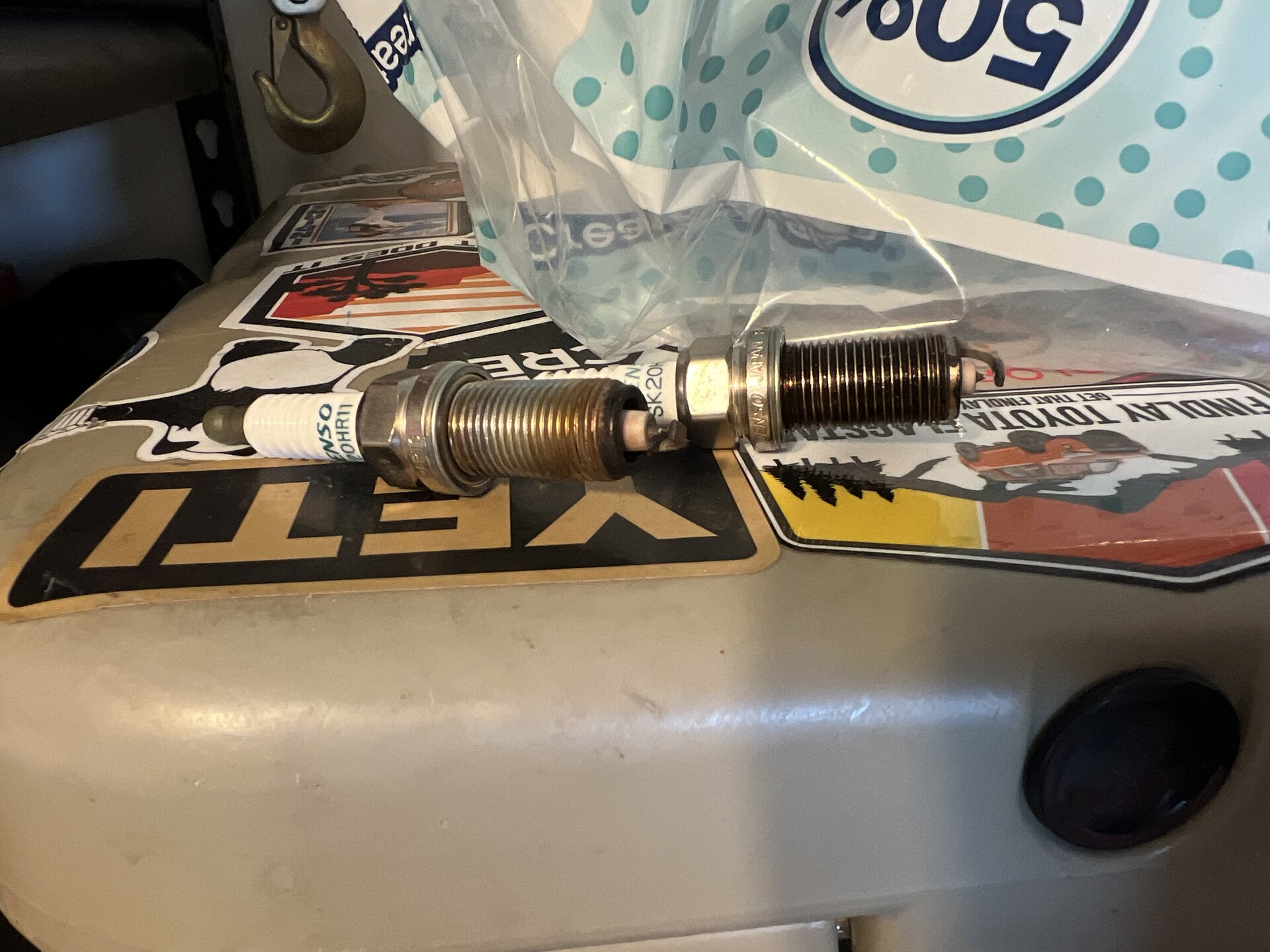

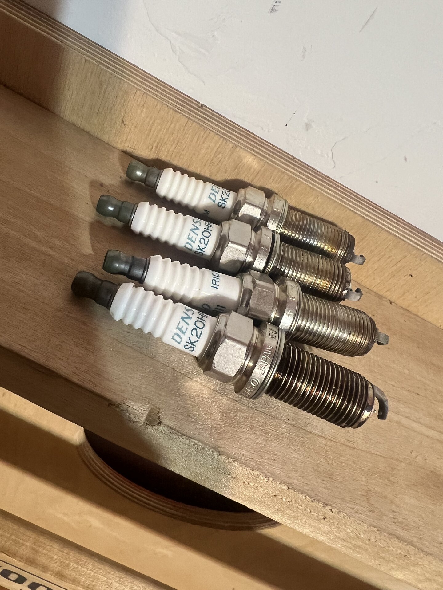

Like the title indicates - I found oil coating the threads on the spark plug in cylinder 7.
I did find a thread on here saying that is known issue and seemed to indicate changing seals may not remedy the issue - what says the wisdom of the forum? Anyone else encounter this?
Rig is a 2017 with 103k miles. No codes, no driving symptoms.
Drive on.
The "issue" is when the spark plug tube starts to fill with oil. In that case changing the gaskets at the top often doesn't resolve it, the problem is where the tube is pressed into the head. See some of @Taco2Cruiser writing on the subject for more details.
I'd bet most of us have some oil on the threads and it doesn't cause an issue at all.
This can happen due to a failed tube seal around the spark plug, but the risk of messing something else up to do the fix is not worth it (this is not an easy repair by any stretch of the imagination and most shops will not do a good job to fix it). Put a new spark plug in and drive on. The inherent mating of the threads to the head with the spark plug will make sure no oil gets into the combustion chamber when the plug is in.
