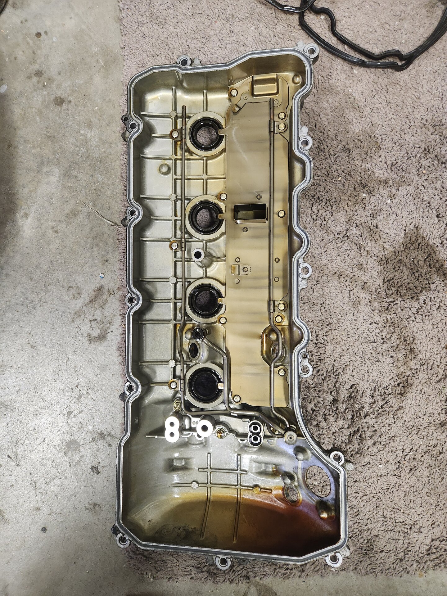

Finally got all the parts together and going to give it a go! Knocked the valley plate leak out a couple of years ago and no issues. This one seems like a much easier job. Dealer wanted $2700, which is a crock of s***! 2011 with 200k miles 5k oil changes and everything looks really good and clean! About 1.5 hours in will wrap it up tomorrow have an ocd issue about making sure things are clean lol!

200k with that little varnish means your or the PO's oil choice and change strategy is working great.
Have you owned it from new? Any idea what oil brand & viscosity was used?
Bought it back in 2013 with 30k miles. I've been using Mobil 0w-20 up until recently went to 5w-30 due to age and miles. Will be using Schaeffers 5w-30.

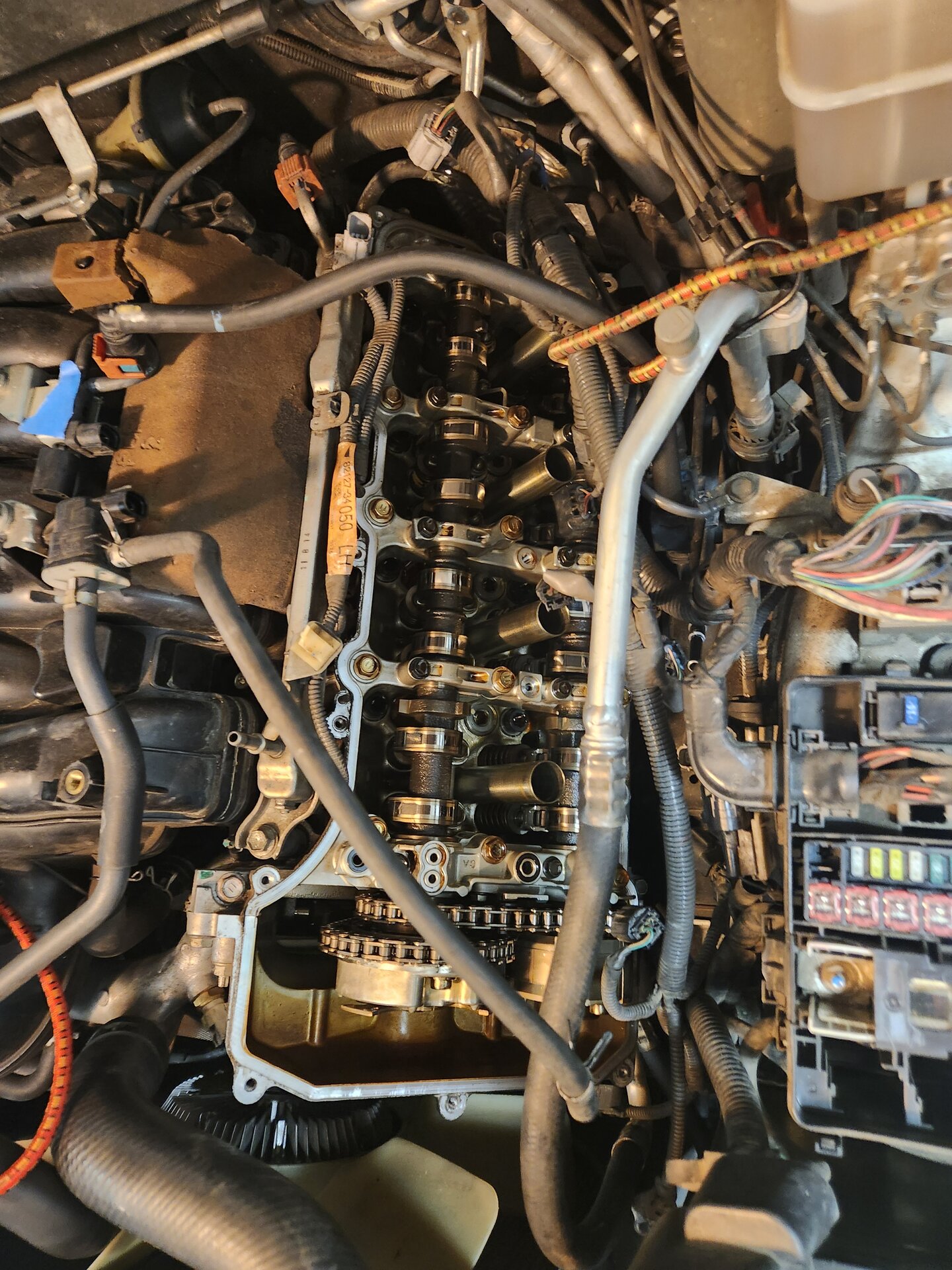

Finished up the driver side. In all about 3.5 hours including cleaning the valve cover and parts. I would expect an experienced shop to knock out the job in 2 hours. How do they come up with est $1350 per a side. It's insane stealing!
Anyone know if the driver side is easier or tougher? I know the air box has to be removed, but other than that anyone know? Thanks in advance.
Thought I would add. Found oil in plugs 1 and 2 driver side. I cleaned them out and did not find any oil in plug 1 and no new oil in plug 2. Gaskets were all hard as a rock. Probably could have waited buy glad to have got it done with new gaskets. Will do passenger side this weekend. Went to 5-30 due to age and miles about 500 miles ago. Overall happy with the outcome so far.

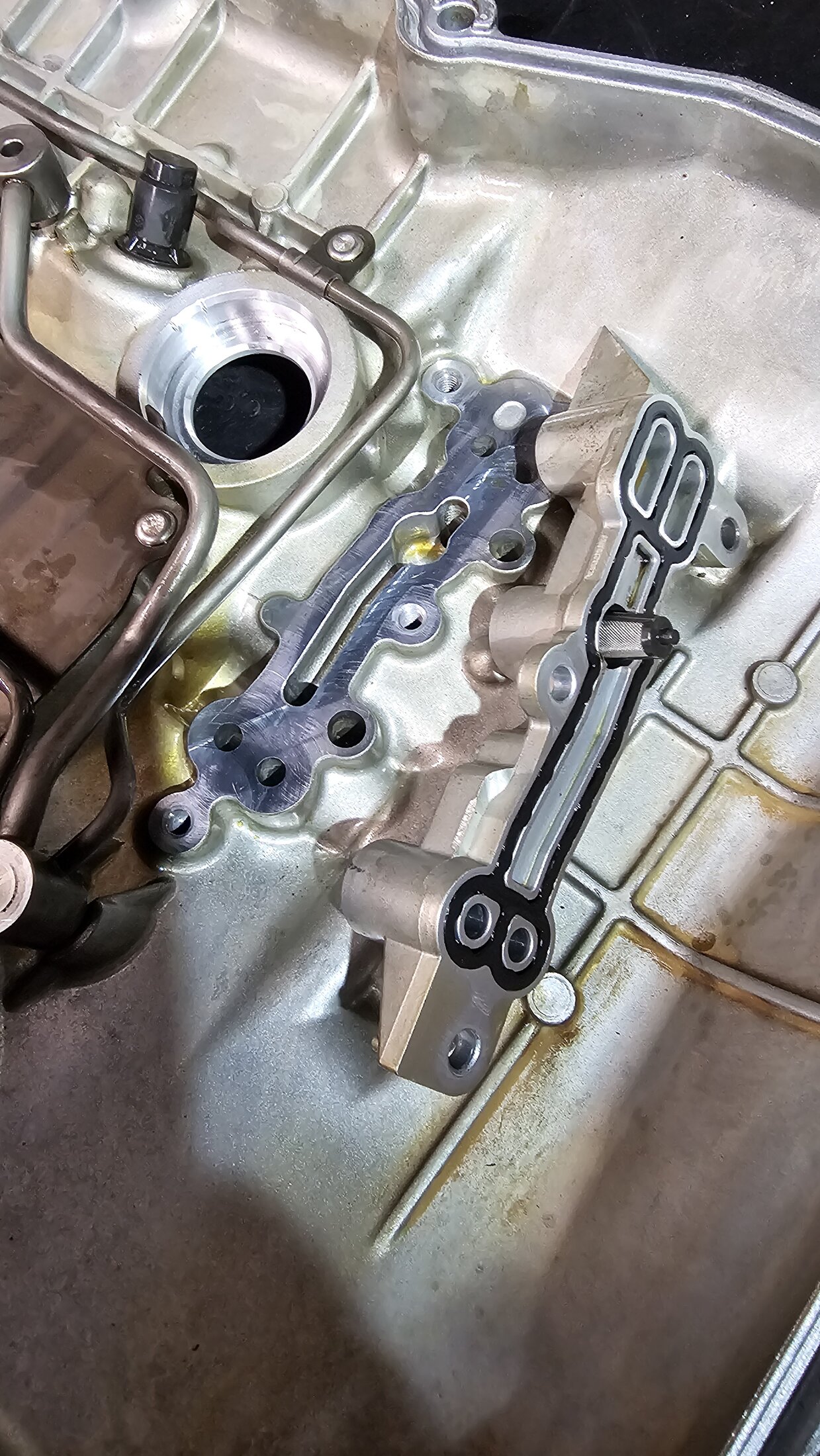

don't forget to clean out the vvti filter on the underside of the valve cover, and replace this special O ring for the housing

Is this something you were having issues with? Or another consideration with oil in spark plug threads?
