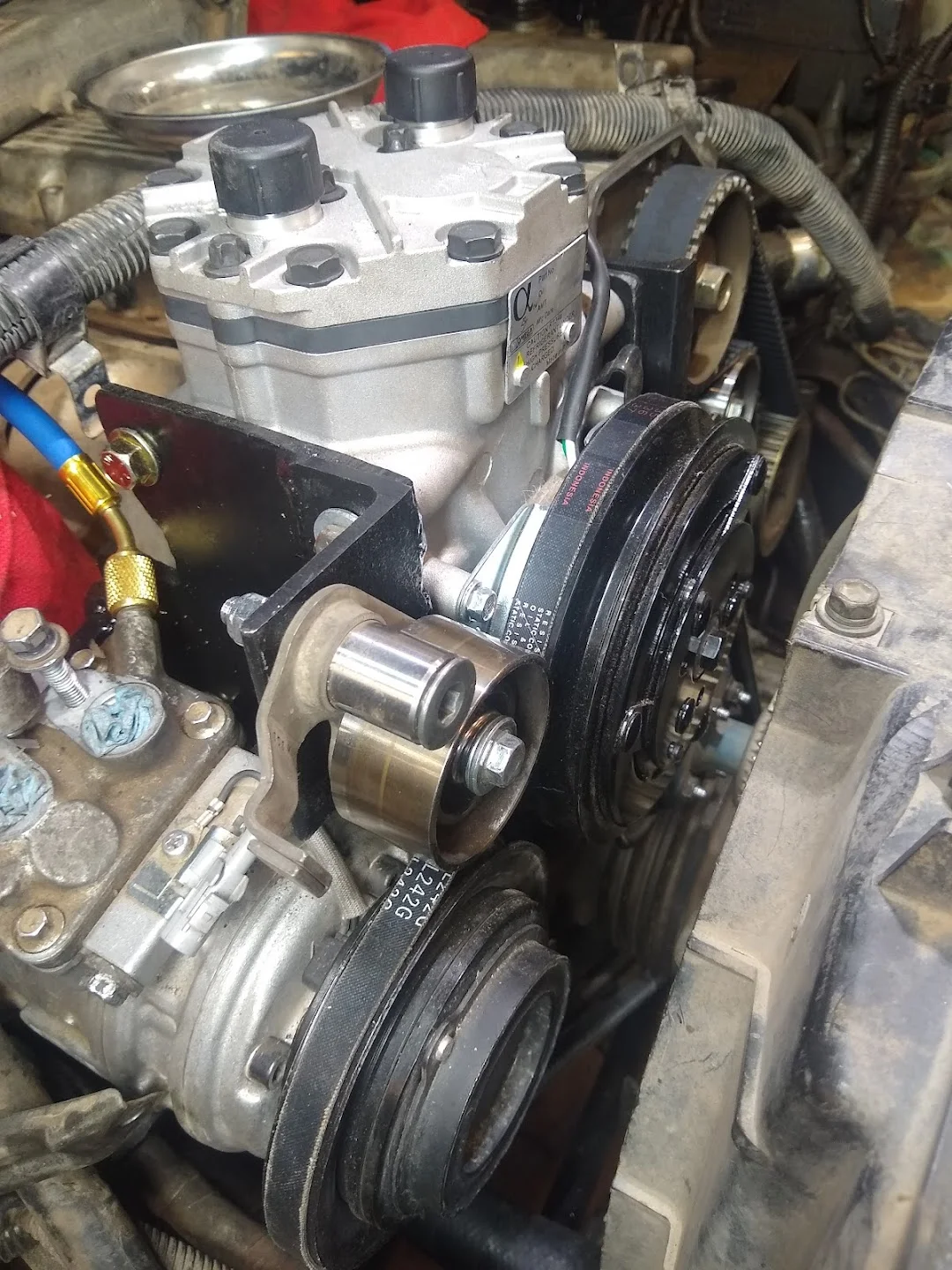

Bit of a thread bump but just trying to gauge if there’s any interest for a York 210 conversion kit for a 1HDT/1HZ 80 series which retains the aircon compressor?
Im just in the process of building a kit for my 80 series....
Cheers
Did you ever make a kit? I’m looking for a bracket that retains the AC compressor and will work with a 1HZ-T. Thanks
I made 2 “kits” for a couple of locals but to be honest it was a pretty time consuming thing to make... i found the biggest issue was stuff moving as it was welded. Just means it takes a lot of time to get perfect, and not many people want to spend the money i have to charge on “a simple steel bracket” that would make it worth my effort.

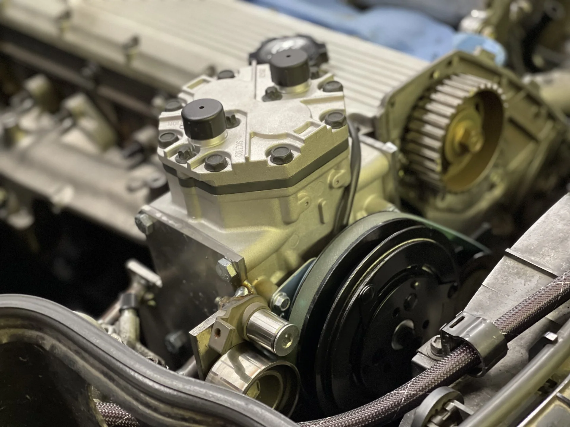

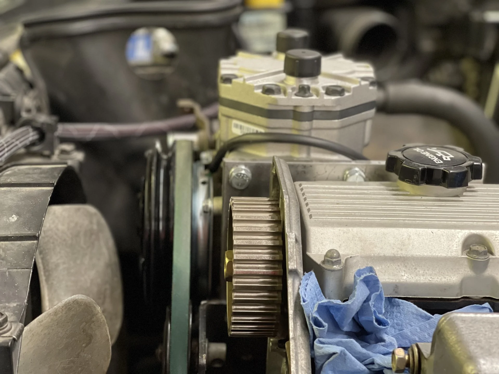

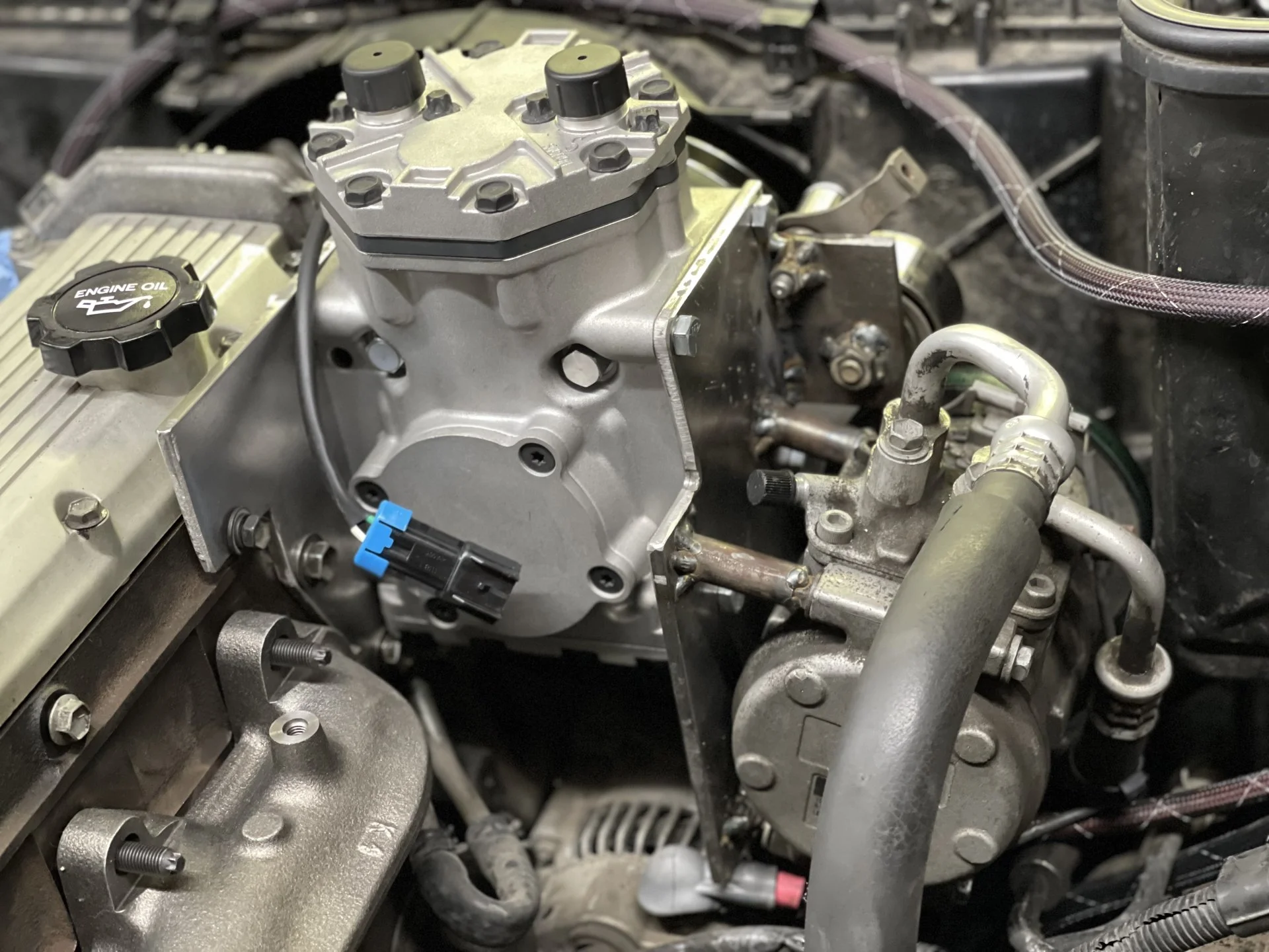

On my 1HDFT I also changed the design and put the York compressor where the alternator goes, then fitted a LS1 alternator to the top of the motor. That way I got a cheap 140amp alternator upgrade and as it’s up high much less chance of failure. Was a fair bit of work, but works brilliantly....

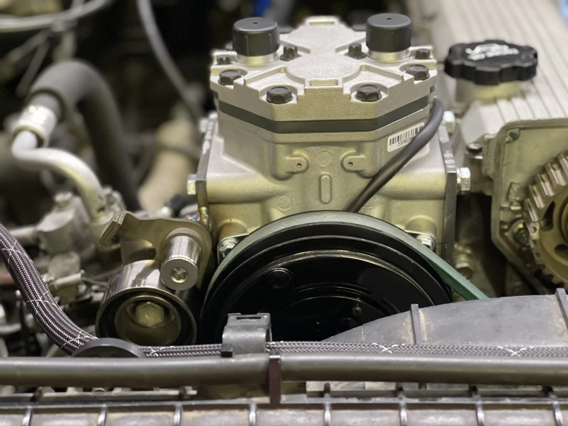

YES!!!!! That's pretty damn elegant, nice work: A flat plate to attach to the York to the block, then another flat plate to attach the AC compressor (with some goofy angled spacers which I'm sure were really easy to figure out/weld). You've got the stock adjustment pulley in there, and it looks like you're using an old timing belt tensioner to make sure the AC path has enough bite with a little 90 deg angled plate to secure it. I just happened to be doing prelim research for my timing belt job so I recognized that part, brilliant man!!!!
Thanks. Went a couple different paths with pulleys but ultimately decided to keep it original possible so that it plays dual purpose. Finding an OEM belt will be the only hurdle.
BTW the angles were needed to clear for JUST in case you convert to 134a and just in case you go top mount intercooler. 😜

@NLXTACY I'm working on my own version of this right now, would you mind throwing up a pic of your tensioner pulley design that's in front of the timing case? I would have waited for your kit but I needed to do my timing belt, replace my radiator, and my AC high pressure line developed a leak so the other repairs lined up too perfectly to wait! Quite a project, that's for sure.......
Almost there! I will post a full writeup once I get the new AC lines and have everything 100% complete.
Here's my full install thread!
@NLXTACY Do you have those custom AC adapters?!? The AC line replacement has been a nightmare, but it does work with stock for now. Also, is there supposed to be an o-ring or something under your York inlet/outlet fittings?!?
