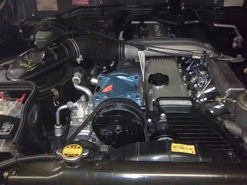

Yeah, I saw that one. Contacted them but they could not provide me any photos of that the mount or unit looks like. I have so much crap going on under the hood that I need to see it before I buy. And the dude was not particularly interested it seems. All I wanted was a pic of the mount. To this day the best answer I got from them was "Yeah the vehicle is too old so no photos." To which I replied "Open the faken box and snap a pic you faken c......" Im a bad bad man :hillbilly:
I scoured the web for a photo but all I could really find was this one and its not one of their mounts.
They replied that their mount goes on the other side. THE OTHER SIDE OF WHAT????? The ac compressor? The motor??/

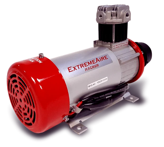

Recently I did a 37 fill test
Brand new Viair 450 8 1/2 minutes for 0 - 50psi
10 year old Puma under 5 minutes 0 - 50psi
With a ton of rigs running 37's and up there is a need for hi performance air.
We are also a distributor for Extreme Outback and arguably the fastest 12/24V compressor available and a belt driven compressor will easily beat it.
