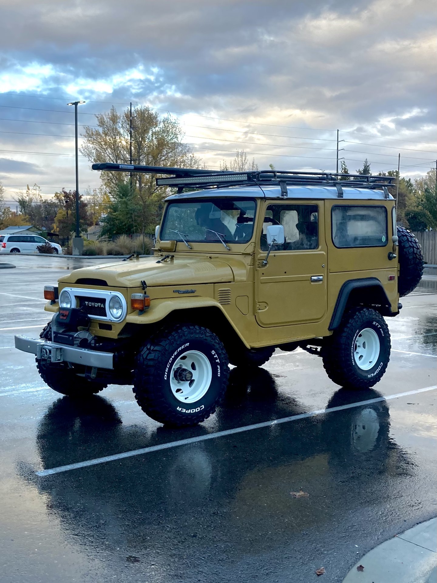

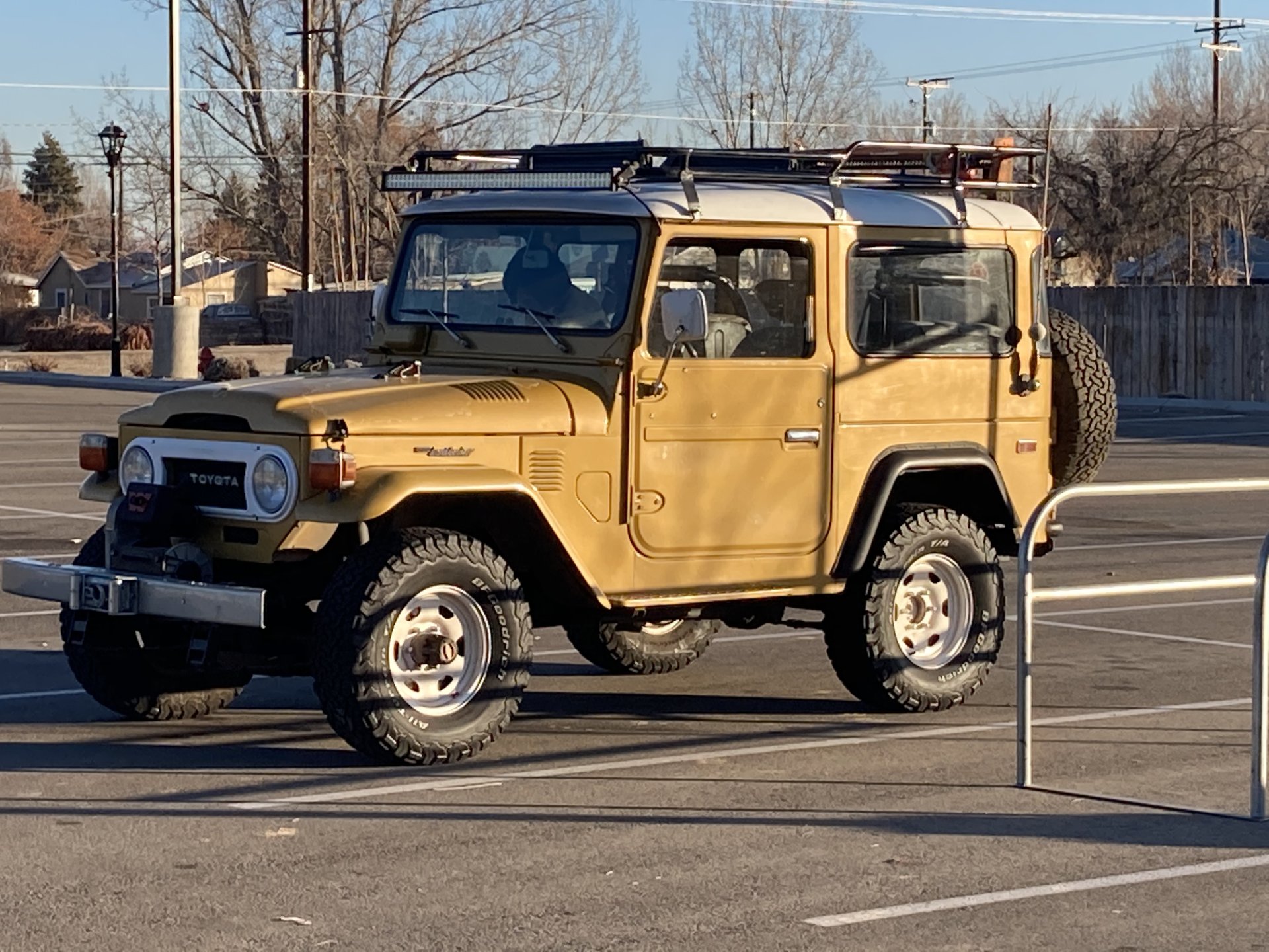

My pics don’t help a ton, since the rear fender is cut out, but you get some idea ….
Stock height with 31x10.5r15 on OEM 15x6 rims
E945207D CCFF 461F AFC4 5DECC2A52942
with Old Man Emu (OME) 2.5”ish lift. Same wheels and tires as above
A60CAC50 7244 4EDE B693 7EB9AAC6C5AA
Now 33x12.50r15 on 15x9 wheels
3F84D64A E0E4 417E 837F 7B5C412B8784

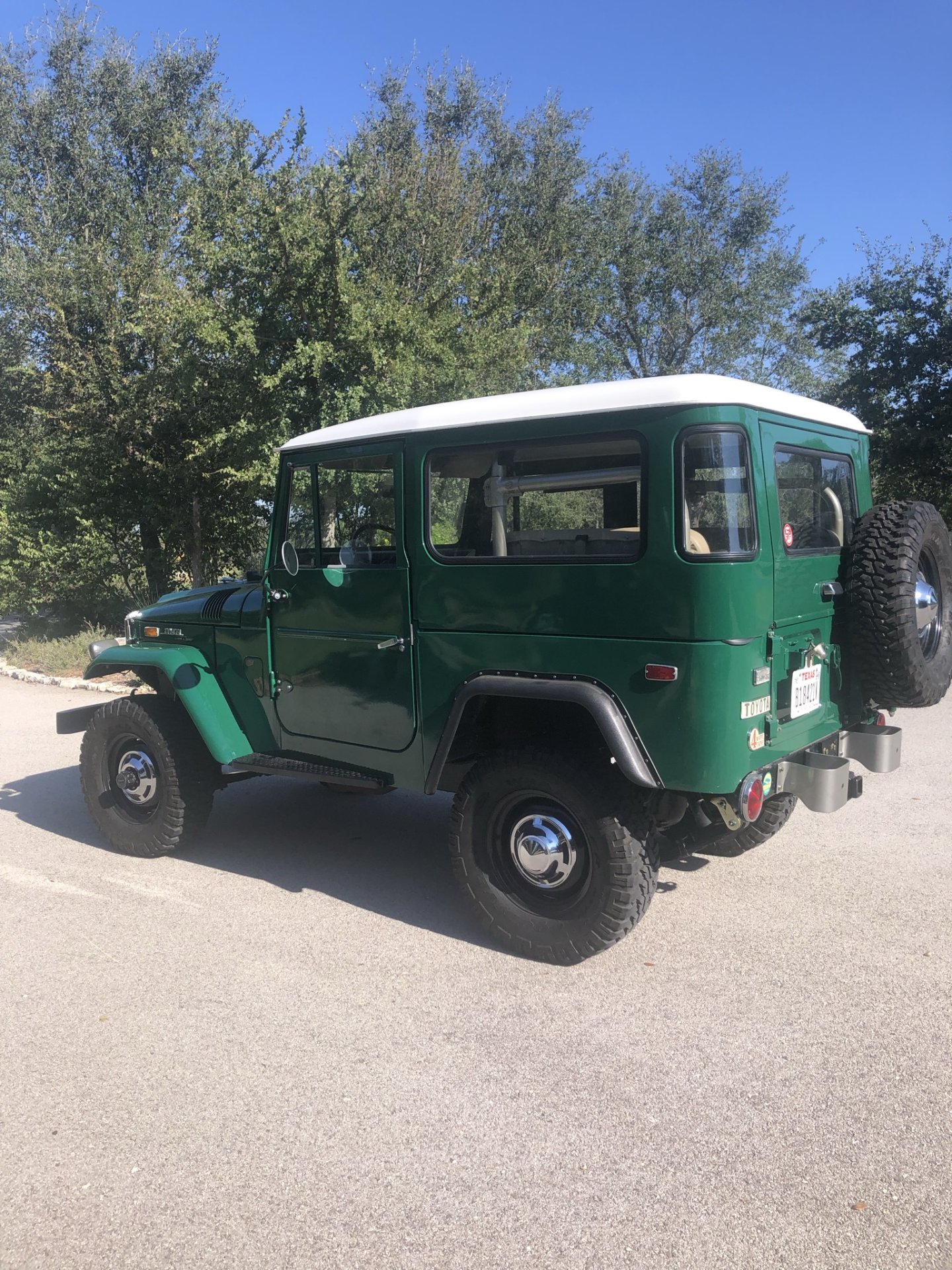

If you don't go with a lift, 30X9.50R15's fit nicely. This is a shot of my mostly stock '76 FJ40 with FJ60 wheels and 30X9.50s - and original 46-year-old springs. I just received my OME suspension kit on Thursday, will eventually go to either 235/85R16s on 70-Series wheels or the new Kenda Klever 33X9.50s on the FJ60 wheels.

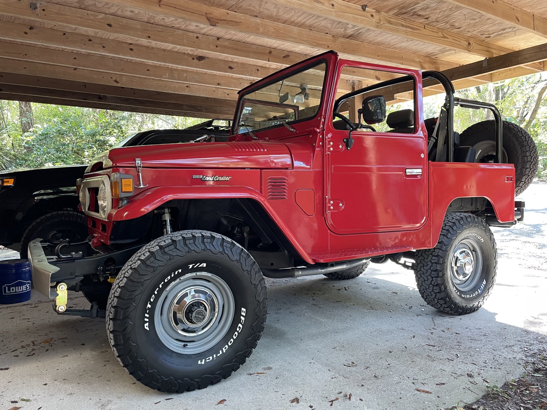

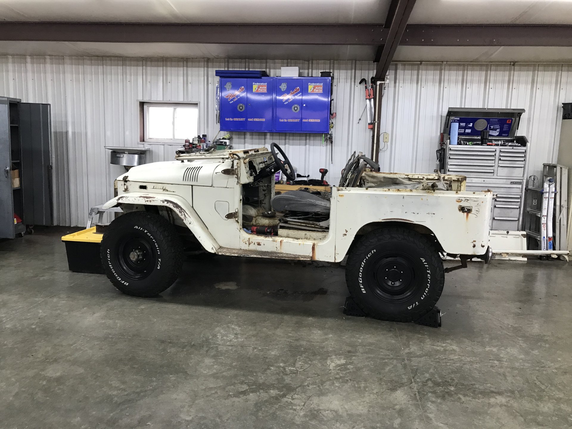

-15” wheels with a 2-2.5” lift with 33x10.5x15 tires.
The vehicle came with American Racing wheels 15x8 IIRC.
73 40 Front
73 40 Side
My old truck was a basket of issues related to the tire purchase. In my youth, I squandered what I had on BFG Mud Terrains, then tried to make them fit the vehicle. Rubbed on drag link. Rubbed on tub corner behind driver (lost part of a tire knob that night after install). Then installed lift springs, still rubbed. Street manners were horrible. I really don't think that the 40 is heavy enough to make those tires conform to the shape of the ground under them without running way underinflated (think beadlocks and low psi). I really wish that I had not asked for Mud or Pirate 4x4 advice when I built it, as I had never experienced a stock 40, in good order, as a frame of reference. I eventually had to move the back axle on the perch 1". Had I had some 31" All-Terrains at the time, I'd probably still have the vehicle, but I couldn't get away from the idea of upgrades, so, I ran out of time, space, and energy. The last that I heard, the vehicle was chopped up and made wider on a different frame.
