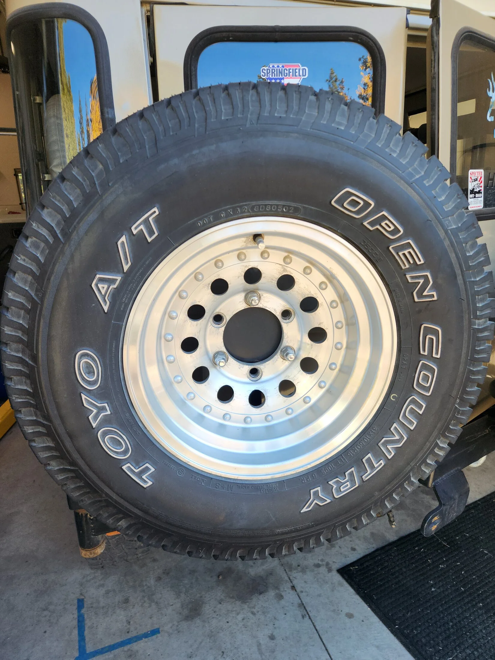

My 77 currently has Toyo Open Country ATs on it in 31 10.5 15. They are old and worn, but the spare is barely used, also quite old. I was thinking of just going with the new version of the same tire and buy 4 vs 5 and leave the spare in place. Does that make sense? Most of the use will be some dirt forest service roads while we camp and some around town all 4 seasons. I'm wondering if I'm being stupid trying to save $225 bucks and should just buy 5 new tires and rotate them periodically.

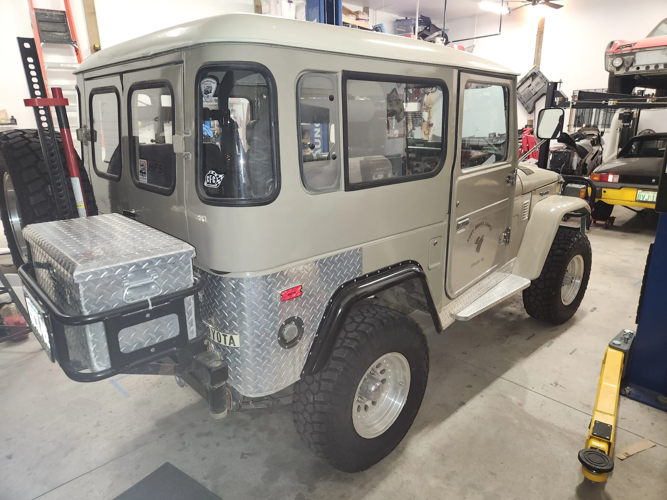

Second question, powder coat the current wheels? Since I'm doing this, I'd like to clean the wheels up. While I'd love a more stock look, I don't want to spend the money on new wheels. But I could have these powder coated to a darker color closer to the original or a dark grey or black. Thoughts?
22 years is quite old for a tyre, but if it looks in good condition (not hugely perished etc) then I'd be inclined to save the money.
You could even use the savings towards a few cheap used steel wheels so you have multiple spares either for rough tracks, or for when you send your nice wheels to be painted and want to keep the truck rolling in between.
I find multiple spares very handy.
Old tires deteriorate quicker with exposure to UV light. The spare may work fine to get you out of a pinch. I'd be concerned if I had to use it for any length of time. You want to powder coat aluminum wheels? You could probably clean or polish them, then sell them and apply the proceeds to new or used stk wheels. They look to be in good shape and a desirable size.

Regarding the wheels, the cost to powder coat the old wheels will probably gets you half way to the cost of OEM steelies. If it were me and I was trying to save money, I'd probably just leave them alone while keeping an eye on the classifieds for something I want.
If you want more original wheels, powdercoating those is going to run you $75-125 a wheel locally. You can buy a brand new oem wheel AND hubcap for that money. They’ll be black, but easy to paint before and ask tire shop to be careful. I rattle canned mine and no scratches when they mounted the tires. I just ordered a stock wheel for the spare on my 60 and it was $99 shipped through Decatur Toyota on a sale.

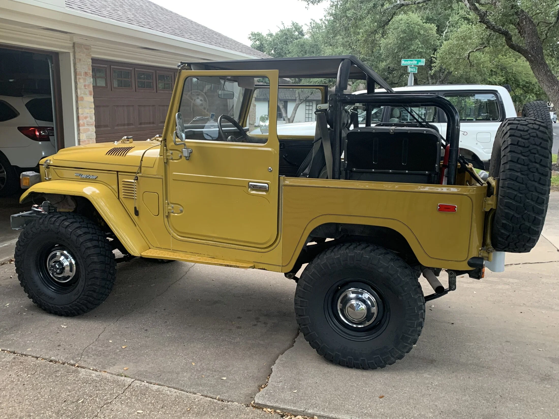

Stock steelies and hub caps all the way... with 33's with that 4" shackle lift. A few bucks more for the tires but you will get rubber overdrive, an extra inch of ground clearance and a smoother ride than with 31's, I was very surprised how much I liked 33's over 31's.
So if I went with the stock 15s, I can get 33 by 10.5s and they will work well? I also see 16s out there as an option.
Keep in mind that powder coating can't be fixed when it gets chipped (and it will); paint can.
I looked closer at the wheels today and they are 15 by 8s. A wheel still currently available. I think I'm just going to clean them up and go with the 33/10.5/15 option in an AT tire and buy 5 new ones. Right now most likely the BF Goodrich KO2. I'd love to get the City Racer 16" tires but the $1,400 plus $455 shipping is just not something I can justify at this point.
No issues with either the 15 or 16 inch wheels and a 33" tire.

I was hoping for some paint. Like an originalish gloss grey analog from a rattle can? My factory steelies are sporting ACE-brand grey primer. Easy to fix scratches because it is easy to sand and touch-up.
If it was my call, I'd say do a flat grey primer for the diamond plate, and a gloss grey on the wheels, minus the front hubs, rear hub caps, and acorn nuts. Or use the factory enamel color on the diamond plate. This way, the original vehicle stands-out amongst the aftermarket wheels and diamond plate skins.
