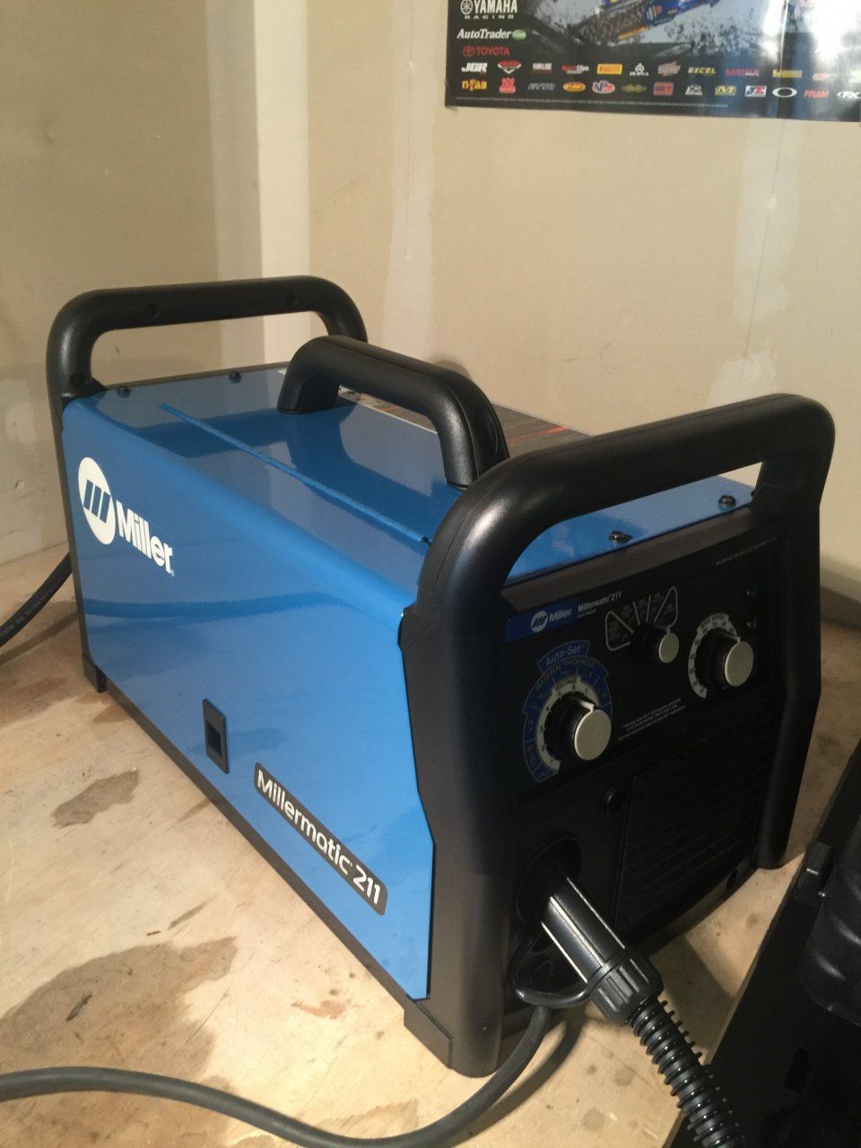

This was my birthday present from my parents. Can't wait to get it on a bottle and start learning a new skill. Hoping to make some new bumpers and sliders for the 62 once I get good.
211 is a good machine for most everything.
Get a bottle of 75/25 and a roll of .030" ER70S-6 and start playing.
J
Am I better to rent my bottle or buy it? I'm looking to get one tomorrow. Praxair is the local gas supply to me, any experience with them?
Not Praxair. I use Norco and Airgas for all my gas supplies. I rent my bottles. (7 of them) I pay 6-9$ per bottle per month.
Get a big bottle (K or T size) same rental price and less swap out time. Little bottles are good if you don't plan on welding much, but for learning and the projects you quoted... a big bottle is the way I'd go.
First project should be a welding cart, if you didn't get one initially. They are usually cheaper to buy than to build but it will get you some hood time.
J

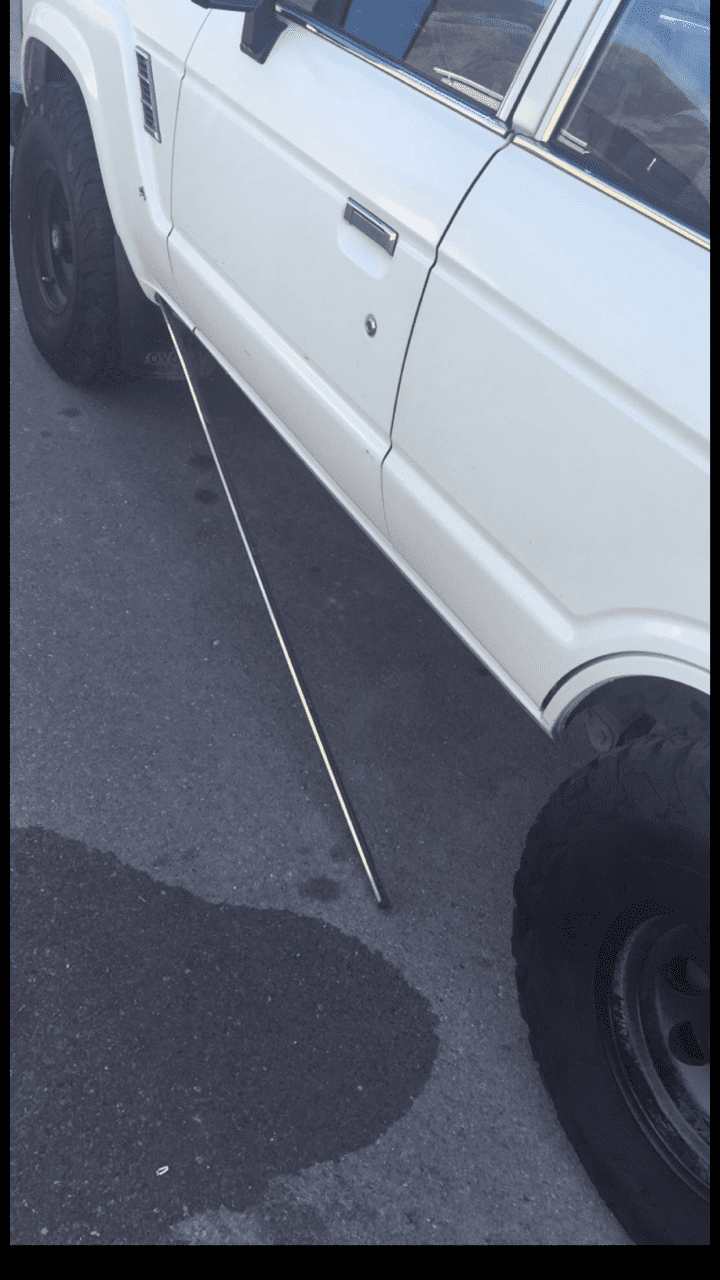

Does anyone have a fix for falling trim? I know some like it gone, but I miss mine. Do you think 3m double sided tape would suffice? Any one else with experience on the matter?
You can still buy the OEM clips for it.
No way! Could you give me a link or a part number???
I ordered them from @beno . Not sure of the actual part number. I'll look around for the bag they are in.
