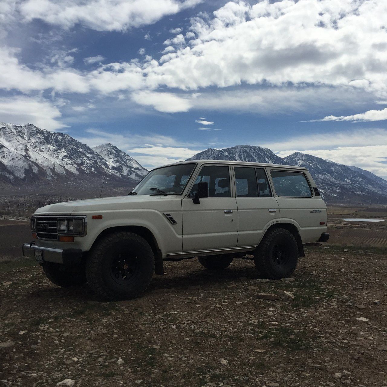

Your setup right now will take you just about anywhere you want to go for exploring/expedition. I've got the same setup you have, 33s, 4.10s and a 3" OME and it's perfect. No need to regear or go SOA. Keep it simple.
Also, what weight did you go? I am thinking I'm going to go heavy just because I don't want them to sag.
Mine is medium front and heavy rear. I have a full rear drawer setup in the back and a rear bumper/tire carrier and the heavy OME is perfect.
I need to add sliders as well, that's a good one to put on the list.

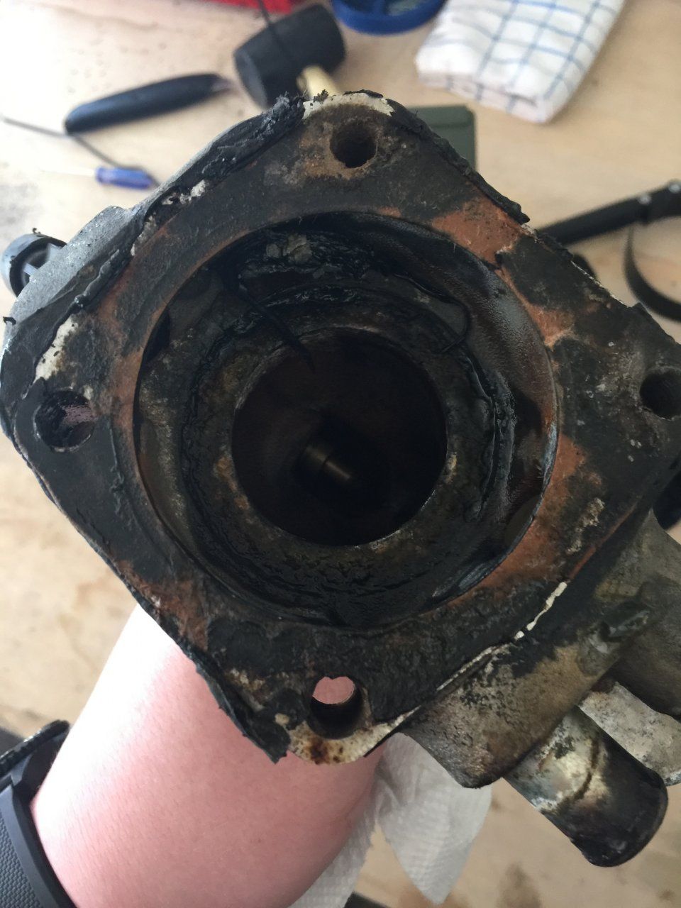

Well yesterday I decided I wanted to replace the thermostat. Ever since I stored my cruiser every time I drive it it will get warm. I figured I would start with the cheapest option which is the thermostat. While in there I discover the PO must have never used coolant, and really never used distilled water.
And unfortunately that wasn't the resolution. Yes I burped the system after i was done and I topped off the coolant. This was after running for about 5 minutes or so. When I drive the temp gauge goes right down almost instantly. The fan moves a ton of air so I don't think that is the issue, what else could it be? I got the radiator flushed about a year ago when I first got it.
If the temp goes down when moving, so you only overheat when idling or in stop and go traffic, your issue is the fan clutch.
