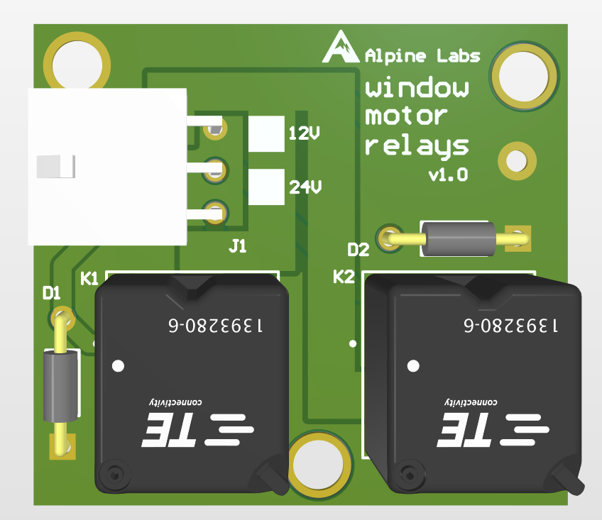

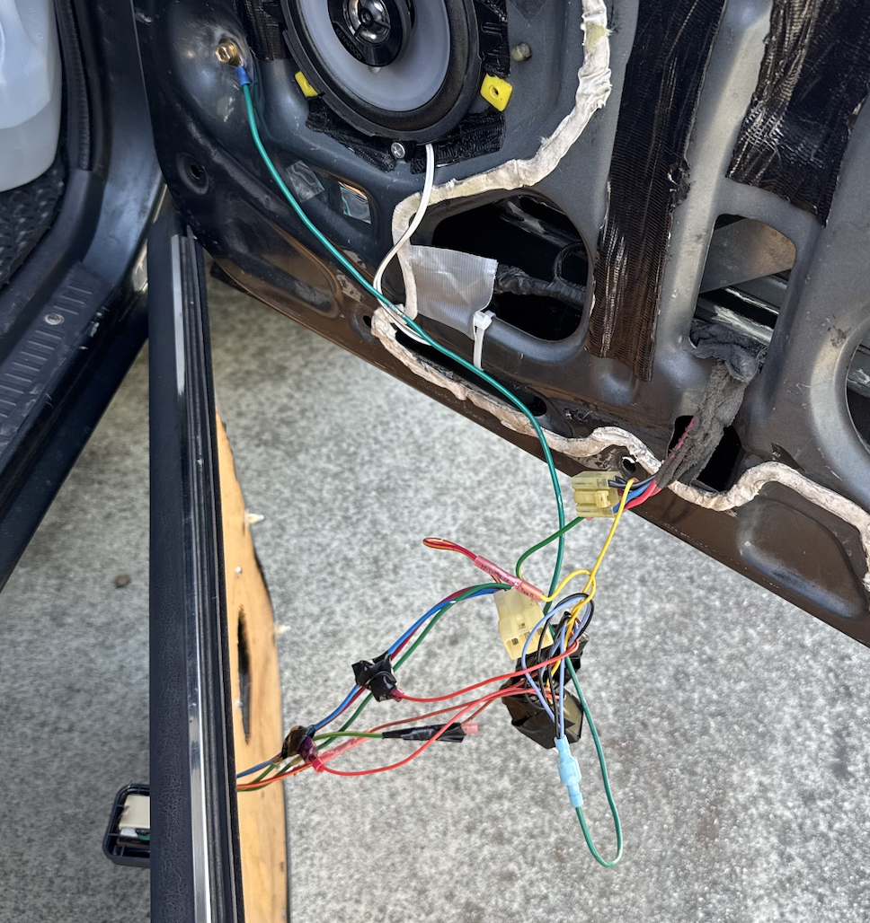

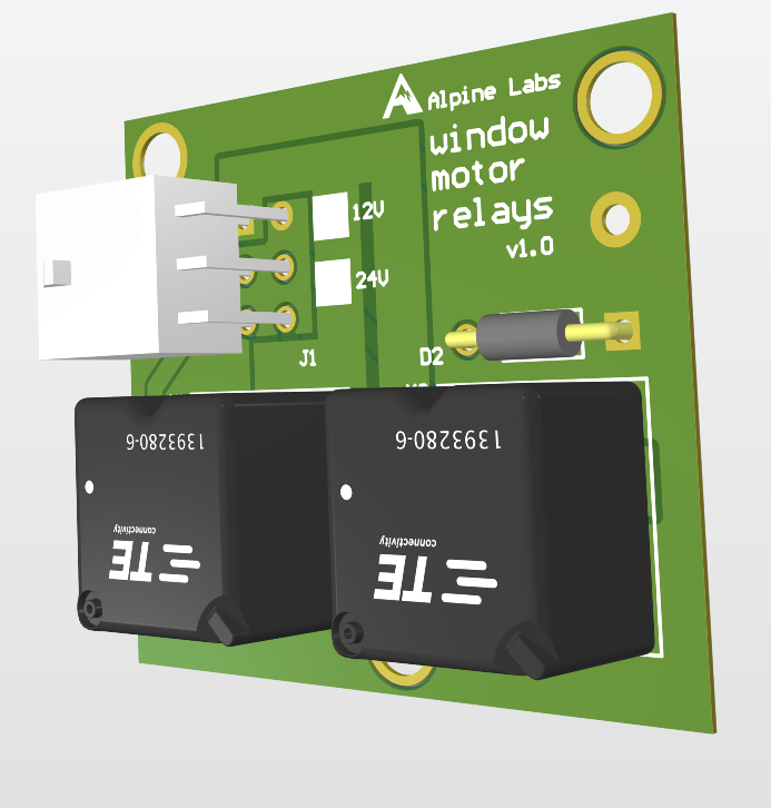

Inspired by this thread and the wiring mess I found in my truck today, I decided to design a small (37mm x 33mm, and 20mm high) PCB. Here are some eCAD screenshots - going to get some boards fabbed and tested in my FJ62. This mod will reduce the current passing through your switch contacts from ~7A to ~40mA (0.04A), which means contacts won't arc / pit.
Boards include:
  1. flyback diodes to protect against back emf from the coil discharge on switching.
  2. a side mounted molex connector on there so that you don't have to solder anything - just need to pin in a connector.
  3. automotive grade relays - the relays I chose are capable of sustaining 20A each, so they should last a long time.
  4. 3x 140mm mounting points so you can zip tie or mount to something. In the shipping version I'll probably reduce the hole size and 3D print a little enclosure box...for prototyping I want zip tie access :)
Going to modify the design tomorrow to support a different relay that has both a 12V & 24V coil version, so that I can solder in whatever people need and send them out. If everything tests well I'll implement these in my truck and sell them if anyone is interested.

Can you describe how the installation goes? Soldered in? Plugged in? Are they mounted in each door, or all located inside the driver's door? Thanks - Steve
I’m thinking I’ll make a video. Or at least pictures.
They’ll be mounted in each door. They’ll be installed via crimp style mates. You don’t want to solder wires together for automotive situations since solder joints can crack. Crimps are actually more robust for vibration over the long haul.

Update for everyone - the third rev prototype boards arrived. These have the following changes:
  1. Thicker copper (2oz vs 1oz)
  2. 4 layers - with large redundant copper fills on 3x layers for the current carrying traces that go to the motors
  3. Fixed the relay footprint so it sits on top of the board (as intended) vs. mounted on the bottom
#1 and #2 weren't necessary but figured why not. Board area is the same as the prev prototypes. I'm out of town for a few days so I'll bench test this this weekend, make a wiring harness, and then hopefully have it in my truck on Sunday for real world testing.
