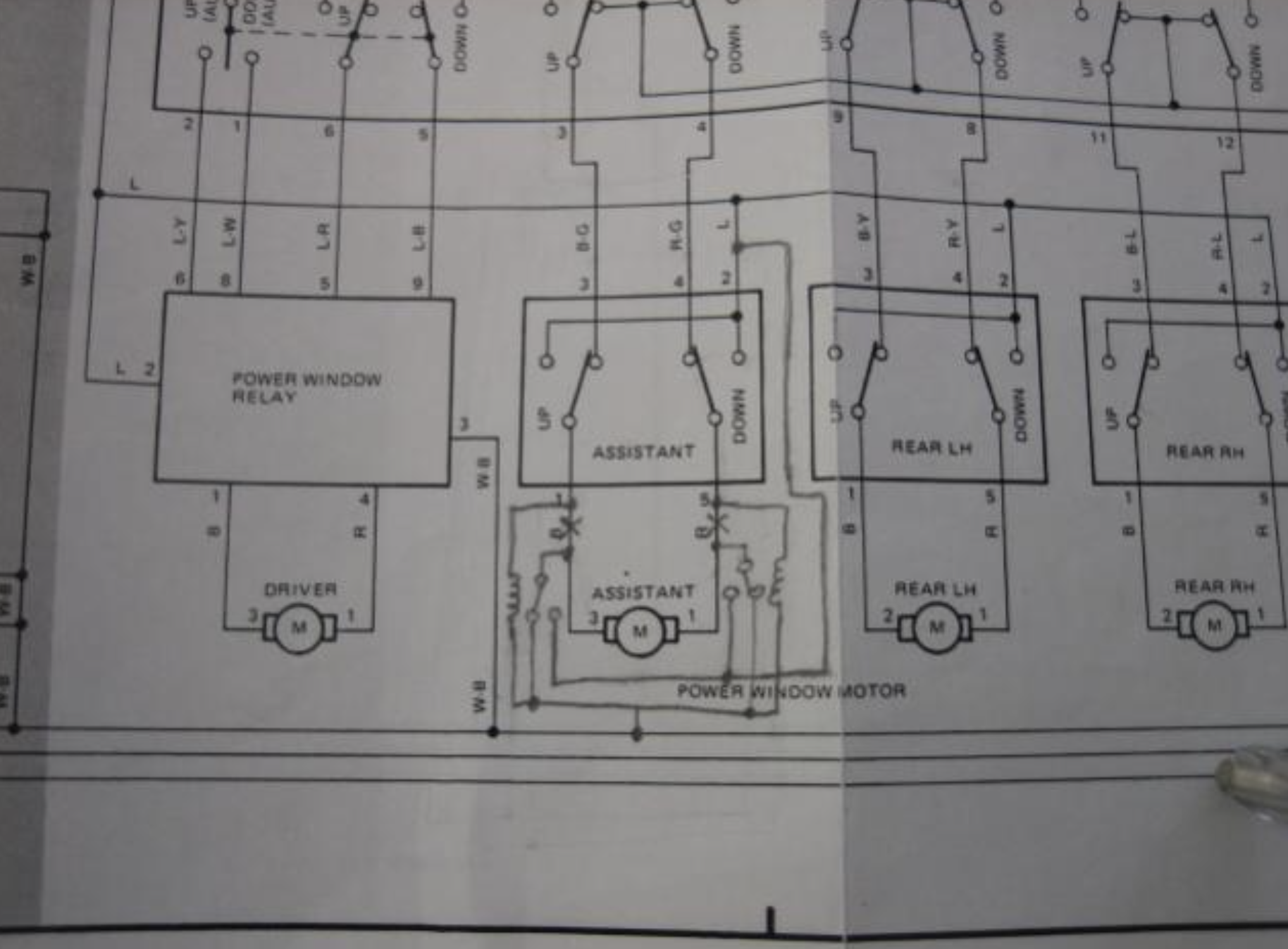

Building on the great work by @slcfj62 and borrowing his diagram, the board effectively does everything written in pencil in the pic below.
I can design a factory replacement window relay control box if that's of interest to people.
What I posted does not have door lock relay functionality built into them, though I can also design that if it's of interest down the line.
Let's start with this project, get it working, and then happy to explore other ideas!
