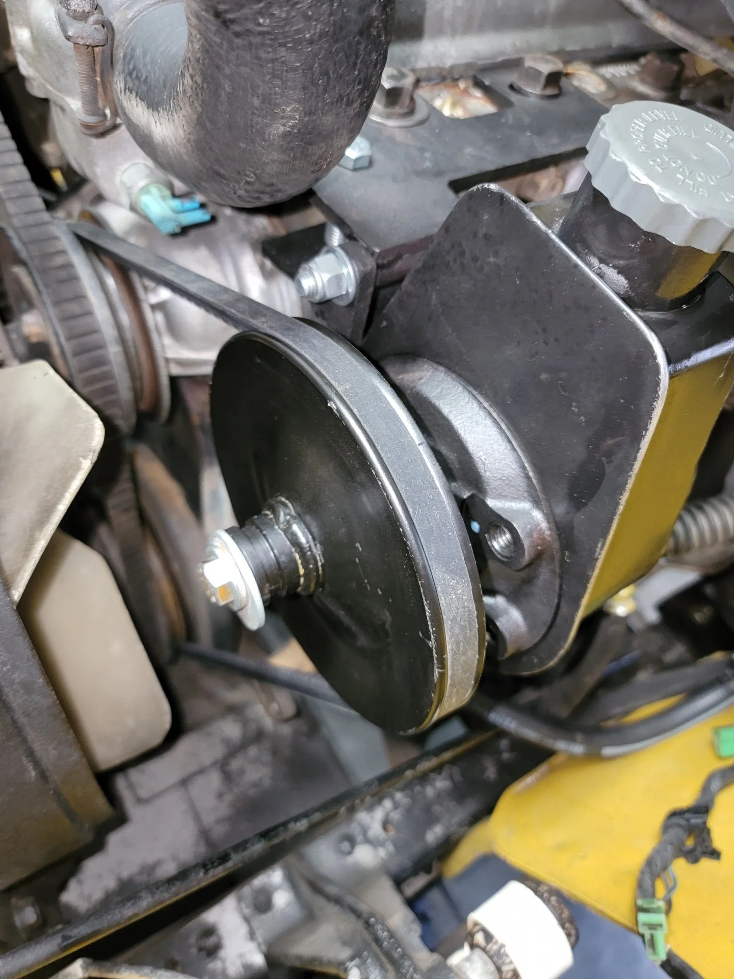

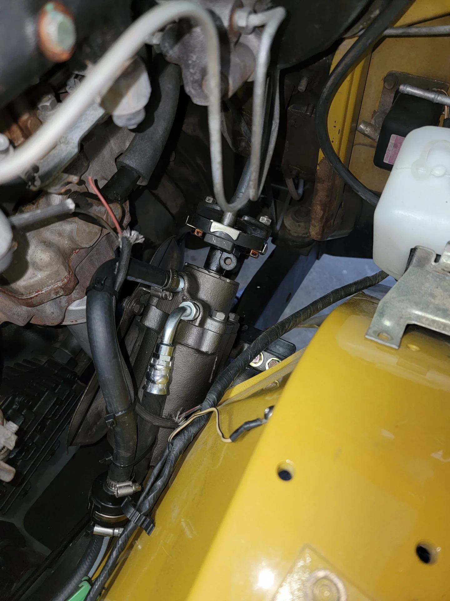

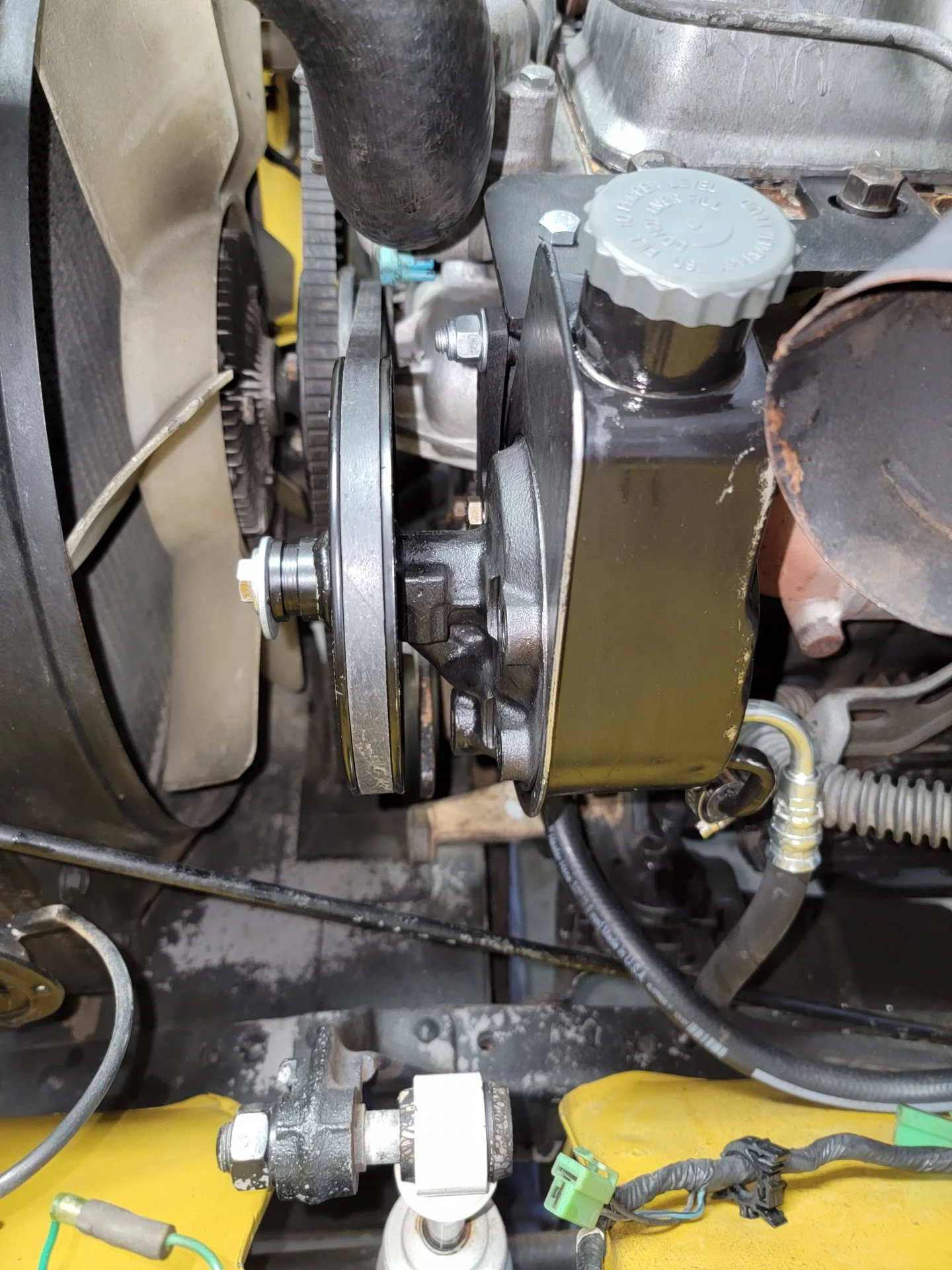

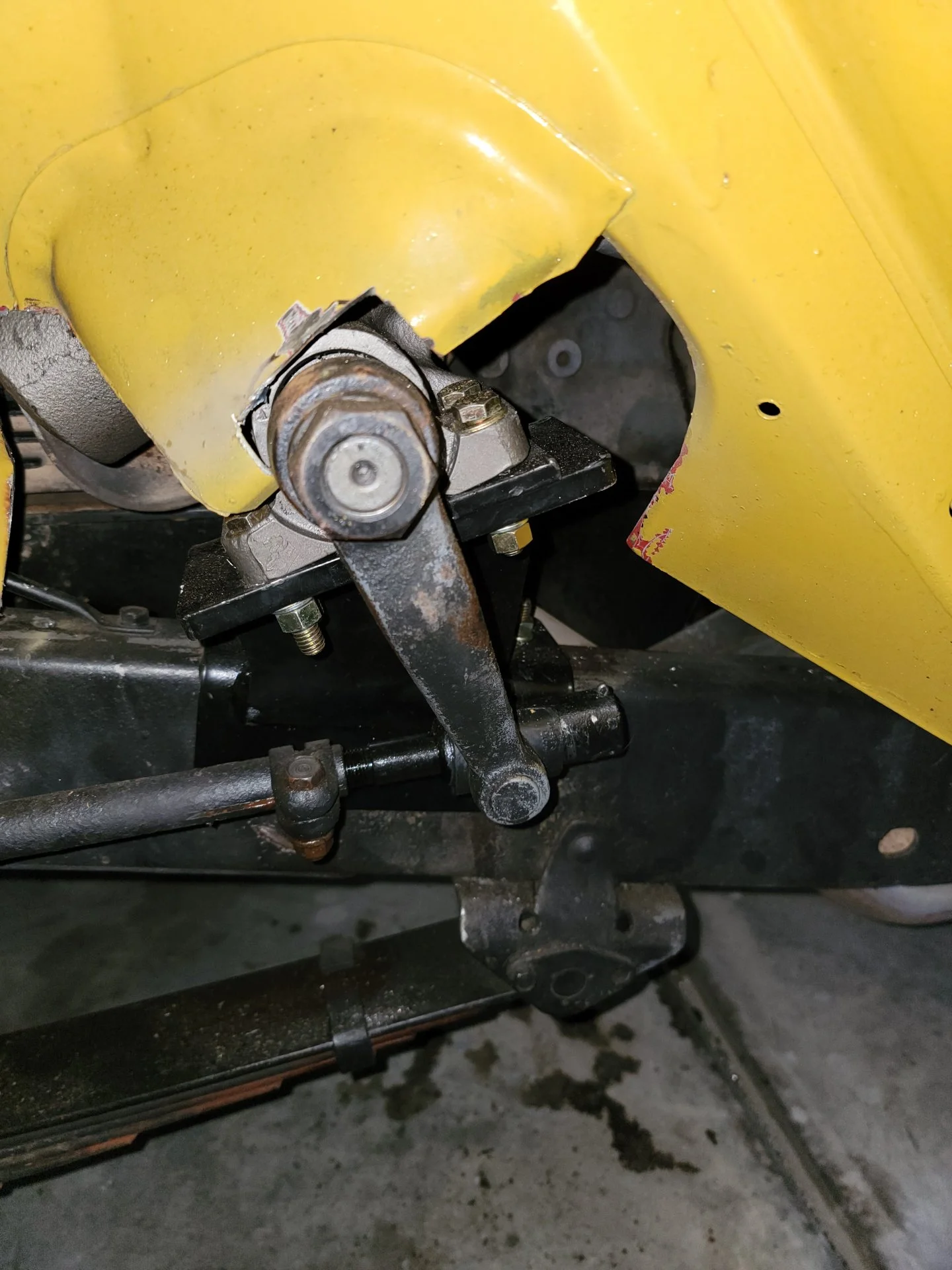

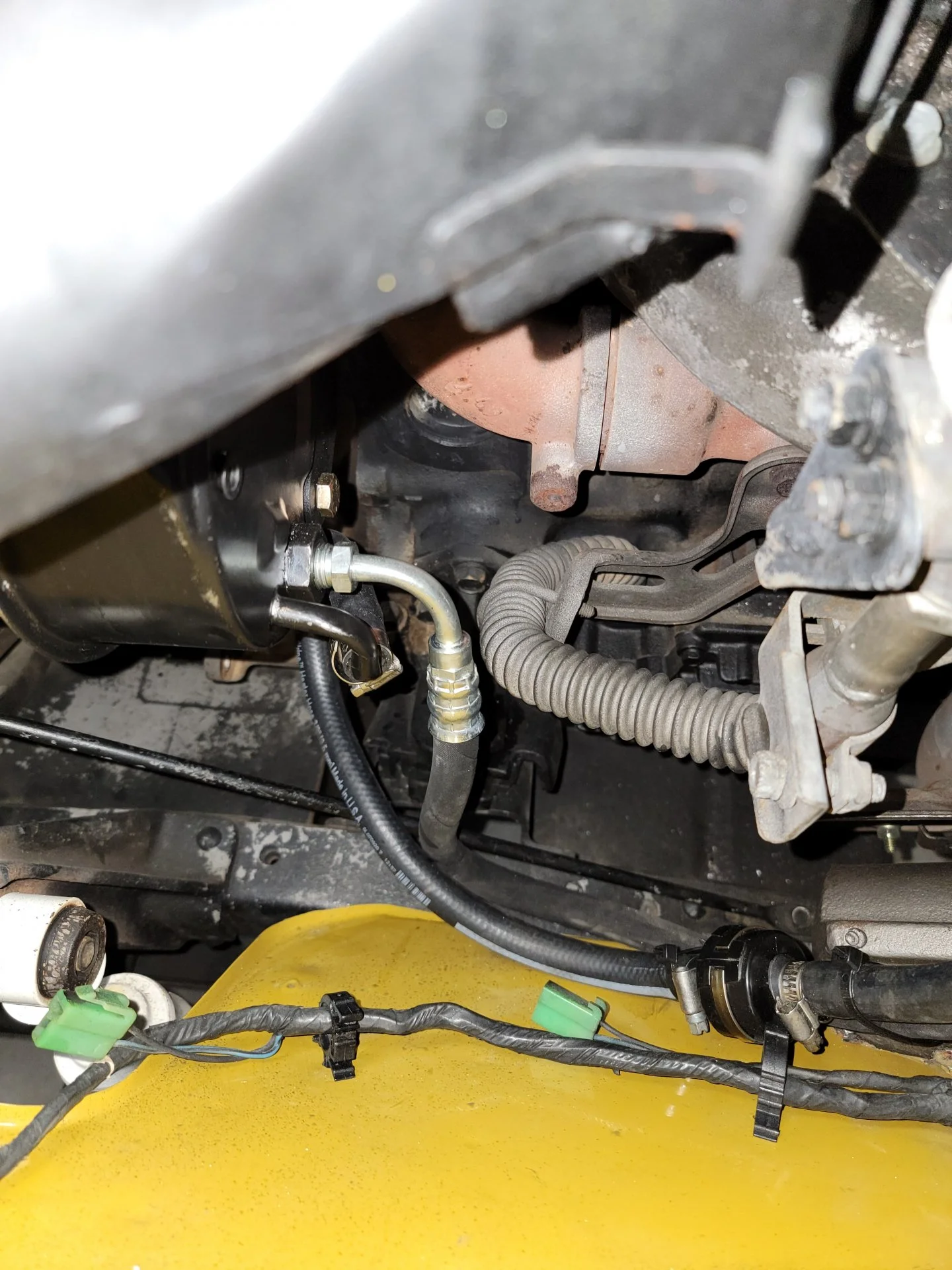

I just installed a mini truck pump on my 77. jtoutfitters brackets and their saginaw pump. steering box came from buyautoparts and looks great.
I bled the system before start up by jacking fronts, turning lock to lock and filling up. Then I ran the truck and checked again and took it for a drive, wheel does not go back to center after turning on its own, feels mushy and not much better than stock. when parked and I turn the wheels, engine on, it squeals as soon as I get a 1/4 turn. 31" tires.
in-line filter is going the right direction. No leaks in system, oil is not frothy. Pump lined up on driveline correctly.
Did I get a bad pump? Is my belt not tight enough or too tight? Should I used a non-ribbed drive belt?
Thanks.
