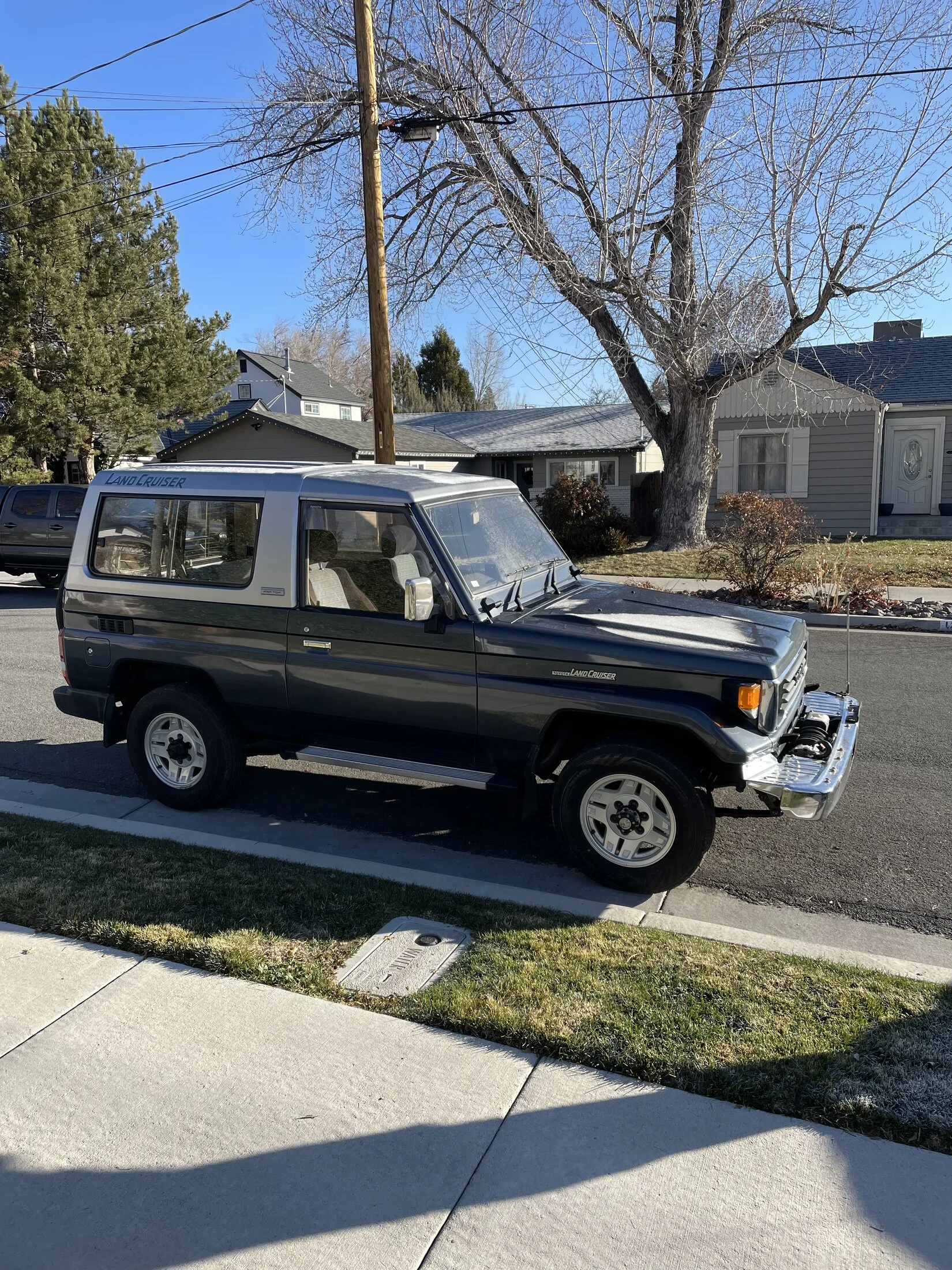

Hi folks
I just picked up a mostly stock 1992 73 series with the 1HZ (Japanese market, already imported to USA). I’ve always admired cruisers and after spending a lot of time in Central America for work I fell in love with the 70 series. This is by far the oldest car I’ve ever owned and my first diesel so I have a lot of learning to do.
I like how these things look stock so all I’m planning on doing is a 2” lift and some bigger tires.
I’m curious to hear from 70 owners and 1Hz owners what parts I should expect to replace, any reliability upgrades, consumables that are hard to get, etc. Since I frequent Central America where the BJ70 and 1HZ hilux are common I have the opportunity to check junkyards and shops for parts assuming they’re not LHD specific.
Thanks in advance for any knowledge!

Welcome! As I am sure you will soon discover, folks will NOT believe a word you say unless there are PICTURES!!! (Tongue-in-cheek) But we do love pictures.
I would start with anything rubber on the vehicle, especially if it is original. Fuel lines, coolant hoses, belts. You do not state the mileage, so if it is under 100,000kms, I would also replace the timing belt if it is original. Having a maintenance history would be gold.

Thanks all for the tips and the thorough write up on common rust spots. Luckily car is complete with all mudflaps and garaged in Nevada. I’ve ordered timing belt, tensioner, fuel, oil, air filter and I’ll be inspecting for rust and what lines have been replaced already. Car sits at ~115000kms. Here’s a pic and bonus picture of Honduran Red Cross troopy I saw last week.
Just documenting my work here.
Car received with 112,260 kms. Allegedly no work done since being received from Japan about year ago
Sticker in engine bay reports timing belt changed at 69,000 kms in 2021 (Ordered new one anyways and tensioner)
Batteries have been replaced
None of the hoses feel squishy or sticky
Rust is extremely minimal
